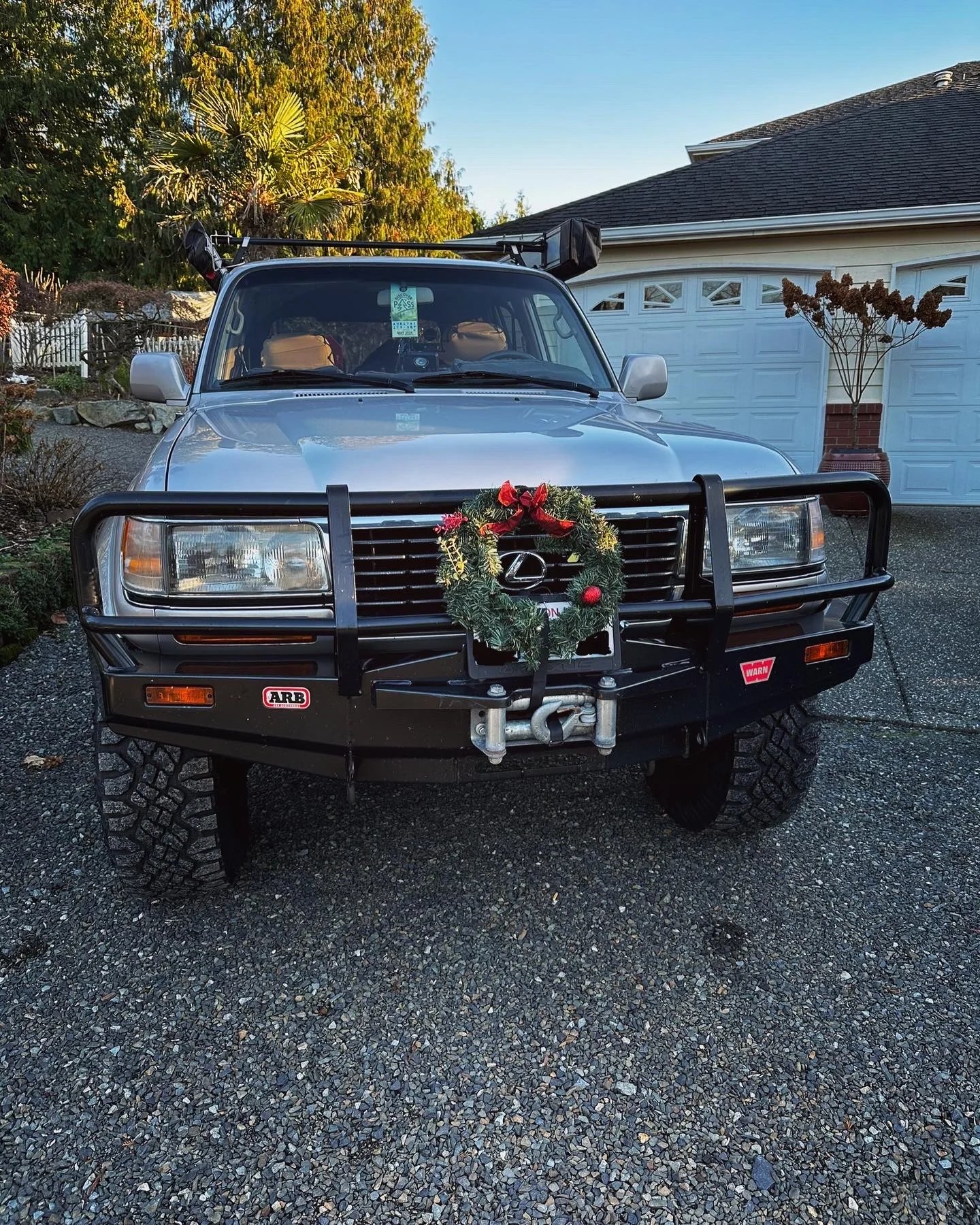

The ARB is made specifically for the M series of winches by Warn, this means that pretty much any other winch is gonna be a guess whether it fits, some people have to get creative, some just add some spacers, etc but if you want pure plug and play then M-12000 is the way to go. I have both the ARB and M-12000 and purchased and installed the winch separately from the bumper.

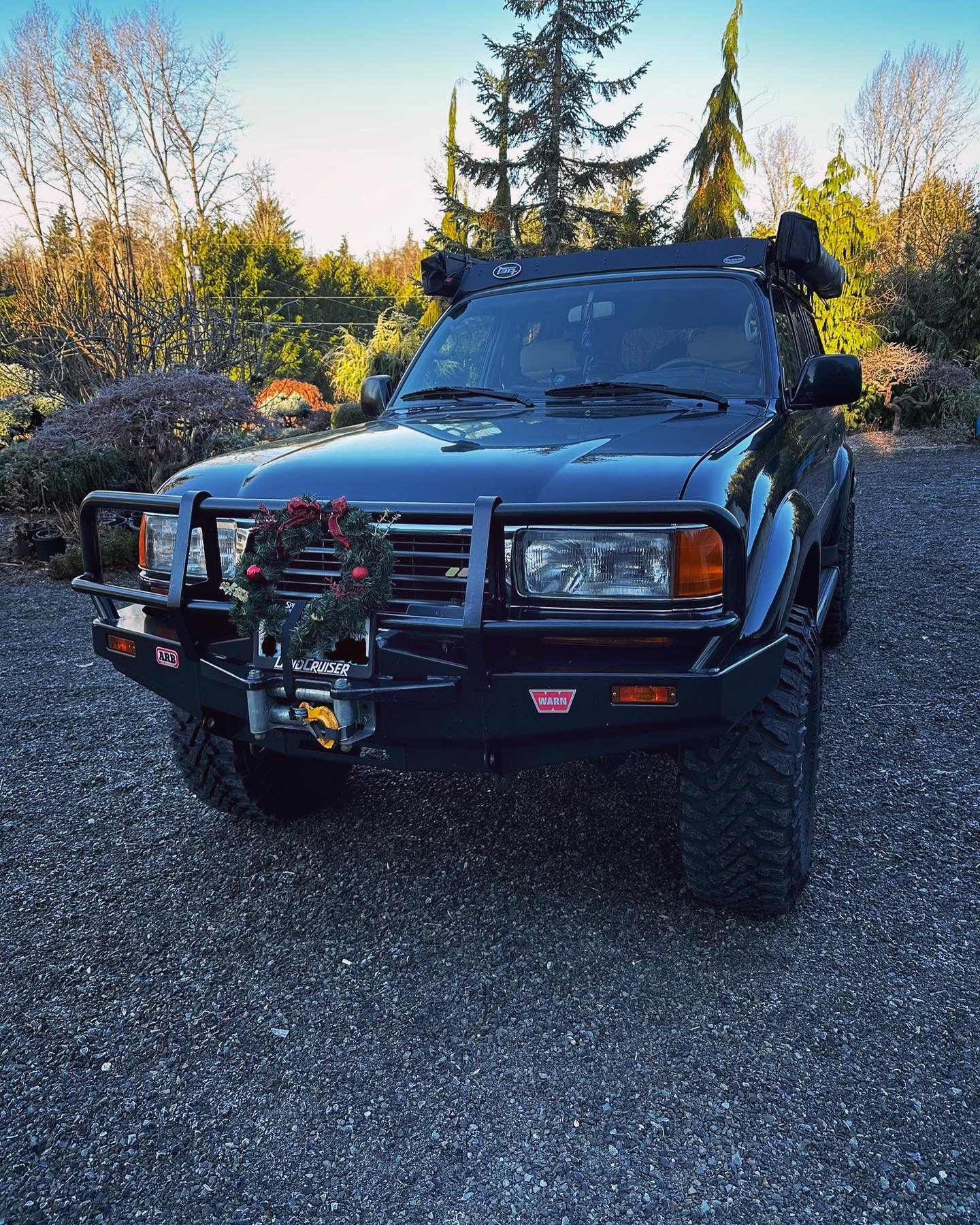

I’ve had great luck with Warn winches on my other Toyota’s so decided to use them on my 80’s too. Running an M12000 on my ‘97 and XD9000 on my 96.
