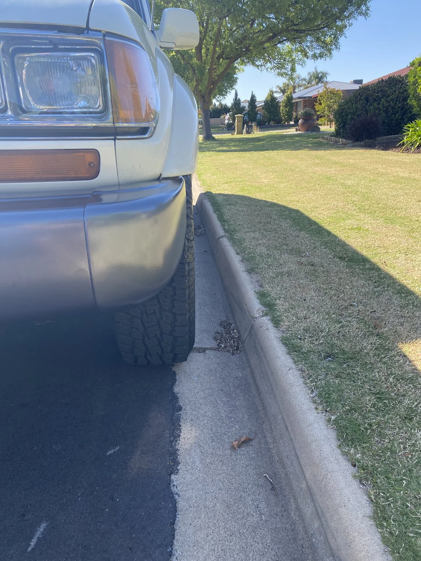

Hi all
I have a 95 GXL Rugby World Cup Edition 80, and over the weekend I removed a damaged alloy bullbar and installed a stock front bumper.
The bumper’s width is noticeably less than the vehicle’s width with the flares.
Do the stock bumpers have adjustability with the side ends? I don’t believe the flares to be wider than normal.
I’ll post up a photo and measurements shortly.
Here’s a photo. I’m assuming the bumper sides can be adjusted.

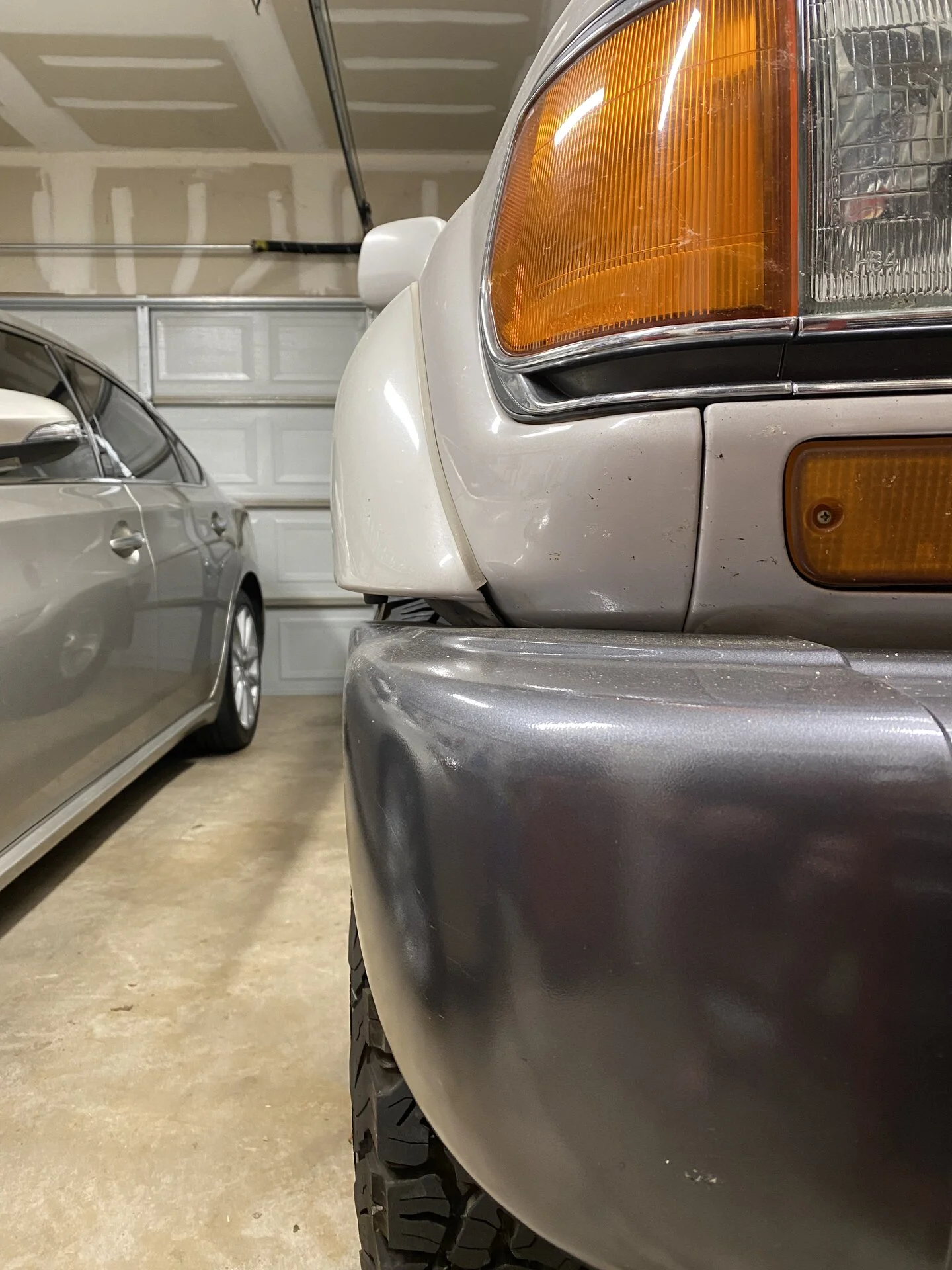

I just replaced my existing original front bumper and L and R extensions (end caps) with new OEM parts. There is no adjustability to them. Here's a shot of mine:
Could the OP's bumper be off a non-flare truck? Or for a truck with less robust flares? North American spec trucks were pretty much similar flares from the factory, but there is more variance overseas.
I ordered the L and R extensions off of PartSouq. You will want to make sure that the two bumper supports/stays are not bent, which can throw your front bumper off-center from the grill and headlights above it. One of mine was bent, so I used a small sledge hammer to tap it back its original form.
The end caps you have may be from a 1991-1992. The flares on those years are more narrow.
Yes, you need end caps from a 1995+.
The 93-94 versions also have a chrome strip on top (depending on market) as well as the front bumper.
