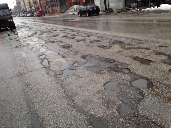

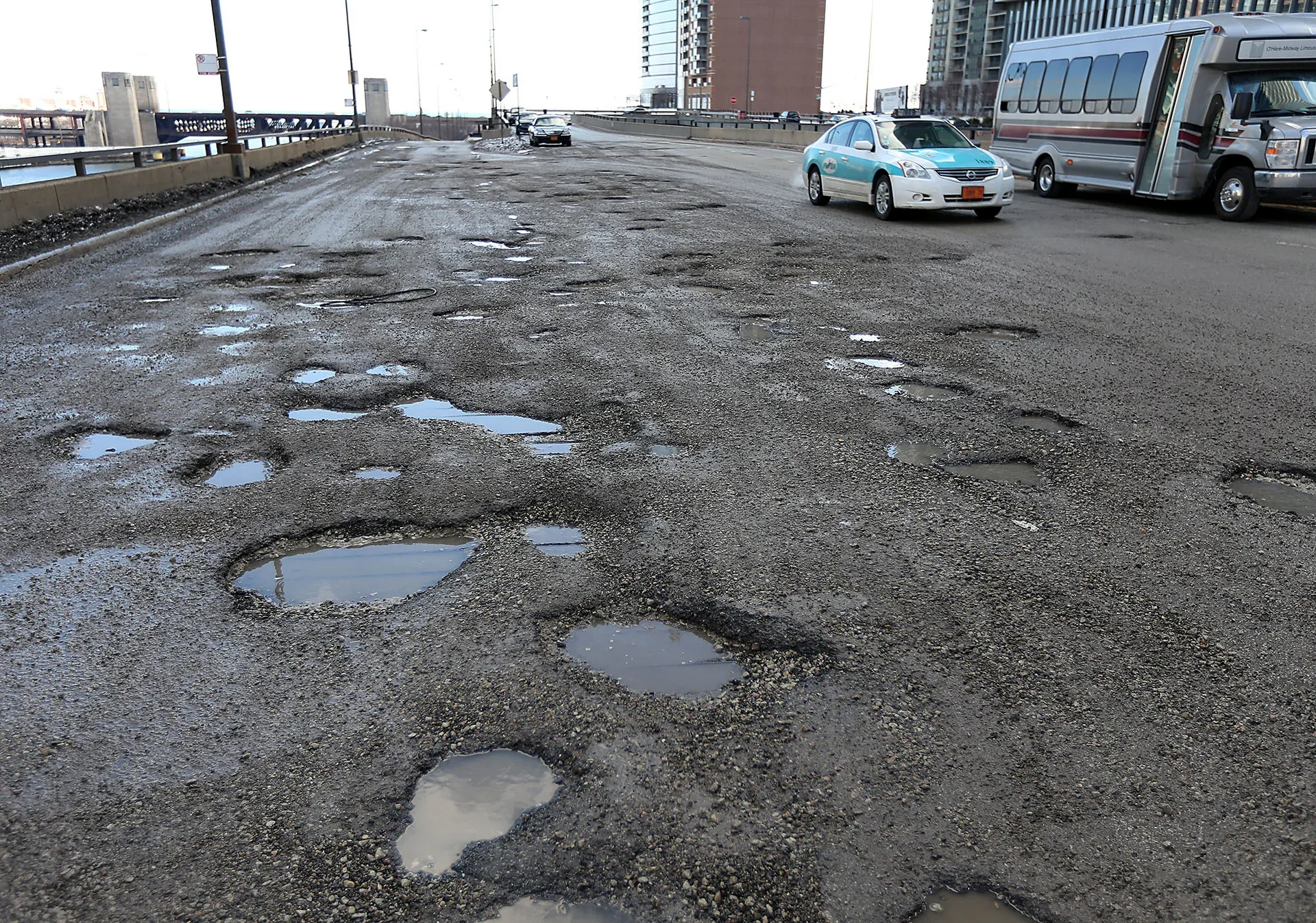

Chicago (especially) and the adjoining suburbs are just abusive. The city really beats on suspension. I mean, this kind of stuff below is NORMAL here. At least they finally milled the "speed bumps" on Lake Shore Drive - strips where the asphalt had spiked upwards because of frost upheaval pushing the pipes upward so at the 40mph speed limit your vehicle would literally leave the ground for a split second and would feel like a boxer punching you in the steering wheel over and over.
First photo is the merge lane from LSD to upper Wacker

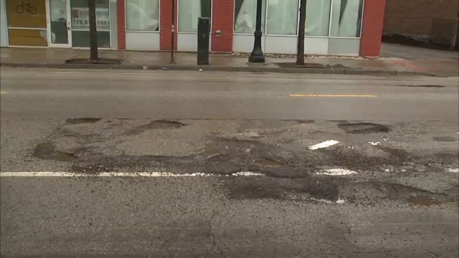

Note sure where this is (maybe west loop) but it's also typical. It will be "fixed" at some point by overfilling the potholes, but then it's still an uneven bumpy mess for years until they finally mill and repave.
