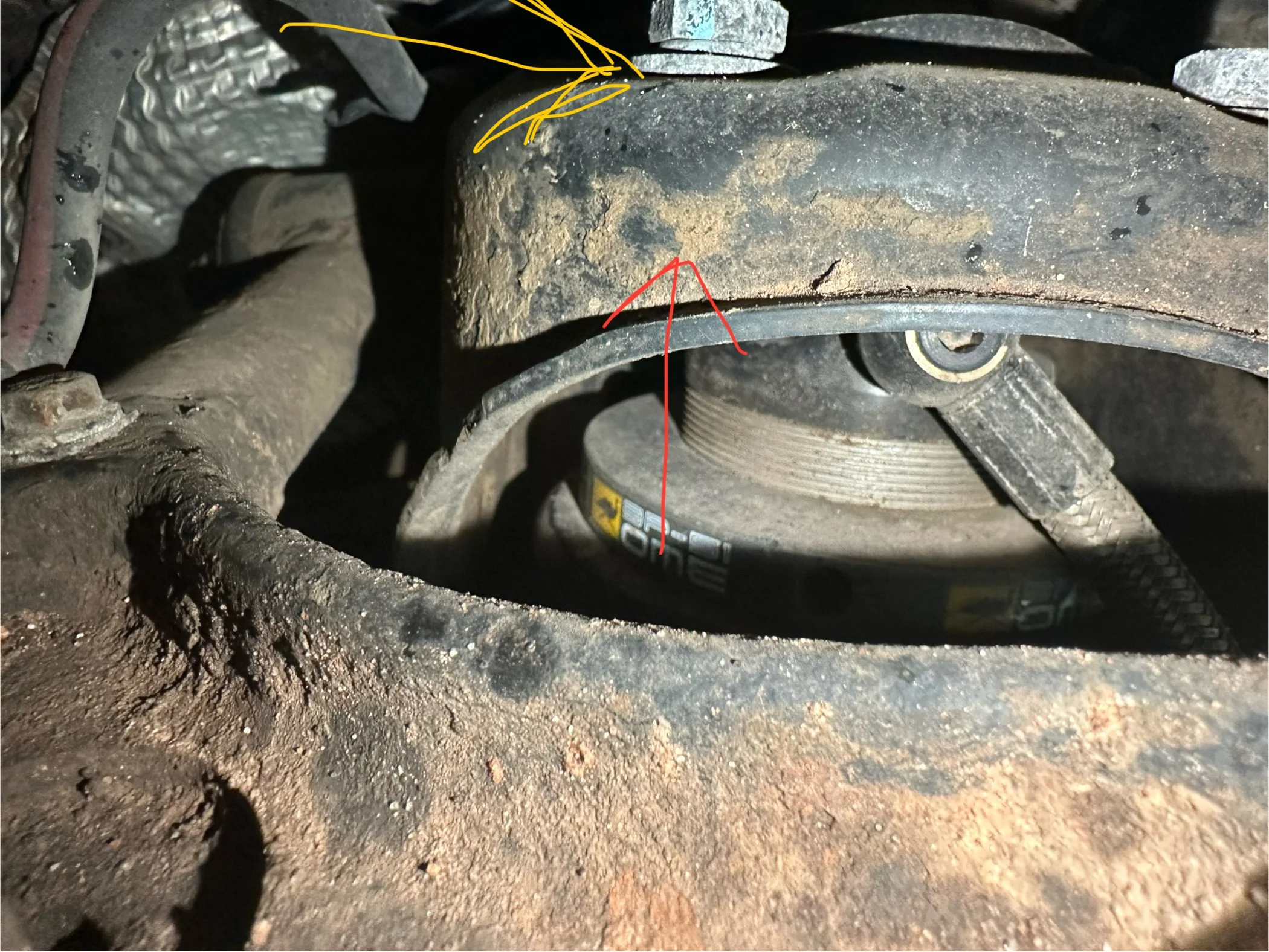

Use an inspection mirror and a light to look at the top of the washer/bushing stack of the front strut. You are looking for dust, dirt and road gunk evenly applied by natural causes. You should not see any displaced dirt on the painted surface, shiny metal or black carbon like dust around the bushings and washers.

Do not lift the tire off the ground at all ! Just throw an old towel over the tire its easy to see the top of the strut with a mirror and light.
The easy fix for trouble shooting purposes is just add another 1/8" shock washer with the same diameter hole on top of the the stack. This will increase the pressure on the existing rubber bushings holding them in place. Just make sure both washers clears the shoulder of the threaded portion and the nut bottoms out to take the proper torque.
The extra shock washer can be removed if the noise is still there and all looks good in that area. The nut may need to be replaced if its rusted to the threads. EP grease on the threads is a good way to reduce galling.

When you say add to the top stack, do you mean where the yellow arrow is, or do you mean drop the coil over and add one to the red arrow (underneath)? Im assuming yellow, just confirming because I didn’t do the install myself
Disregard. Thats a good photo. I don't see any indication of movement from those mounts. The cross pin that is out of sight would leave some streaks down the side if it were not secure.
