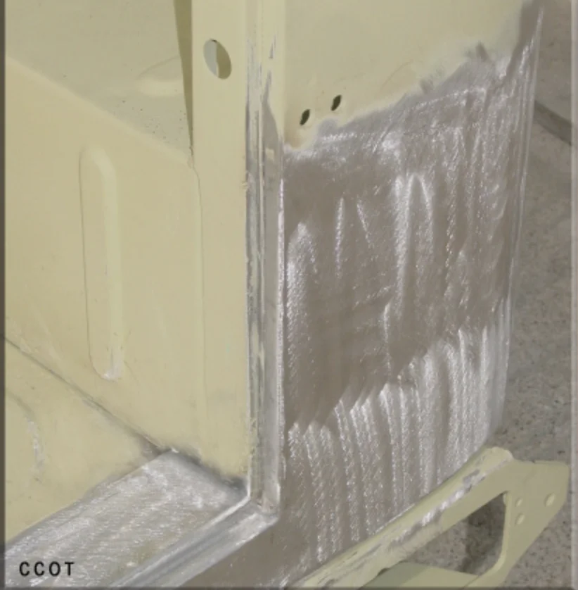

I'll bet the new metal had a protective coating that required more than a scotchbright pad.
That's what I have been thinking.
I did use a metal prep before I laid down the primer though, I guess it needed something more.
It appears there's no adhesion at all. I'm no body or paint expert by any means. The metal needs to be sanded per the primers instruction sheet. On plain steel you have to knock down mill scale and use the proper grit for adhesion.
I agree 100%.

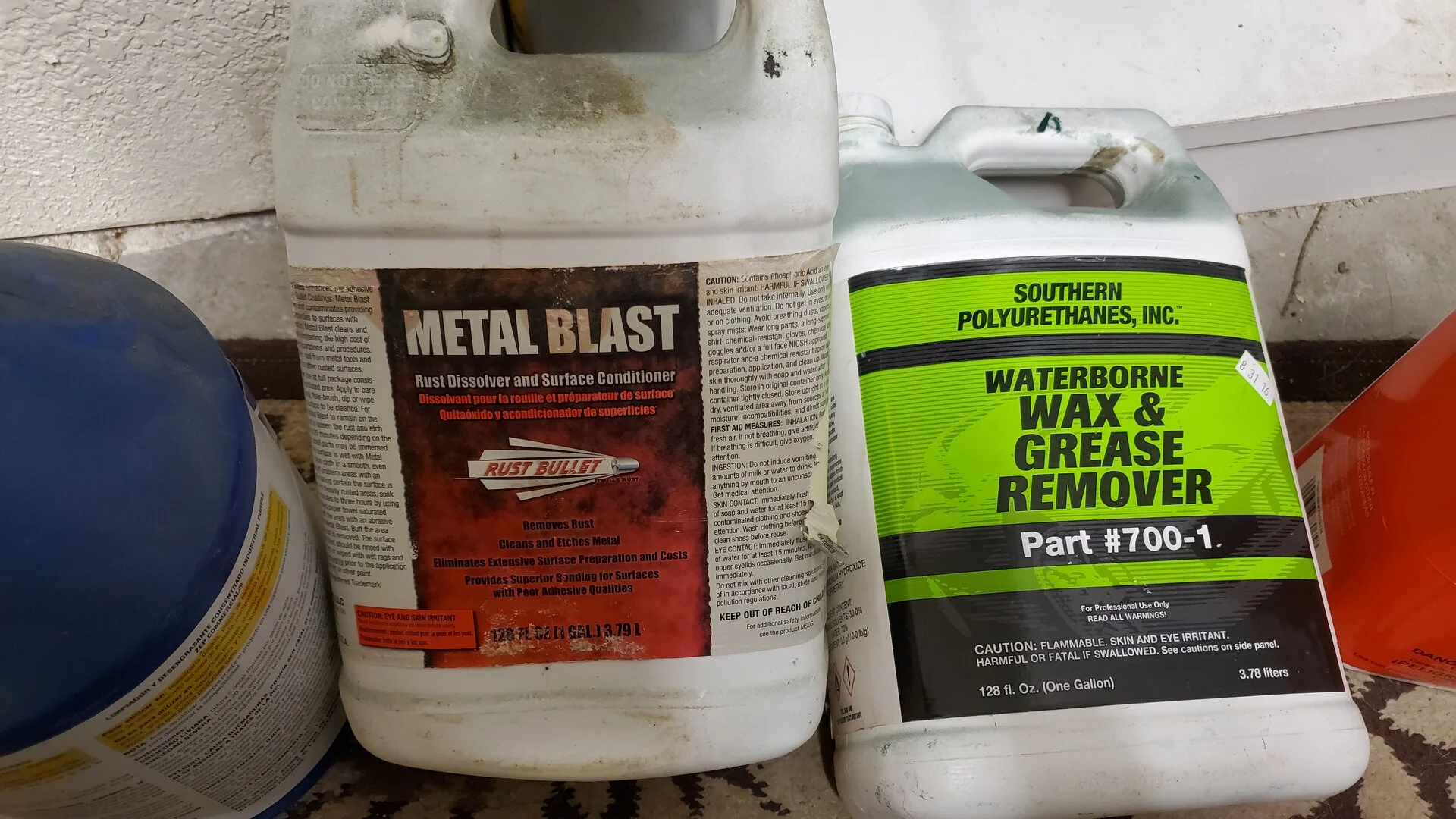

And I'm also about 99% sure I prepped the metal per the instructions for the epoxy primer, from SPI. I even have their metal wax and grease remover that I used prior to shooting primer.
If I remember correctly I used the Metal Blast product from Rust Bullet to prep, and then the SPI wax and grease remover.
Being a glorified amateur at anything resembling body work I tried to be meticulous about the prep.
After reading the tech sheet from SPI, I may not have used the Metal Blast from Rust Bullet before I shot primer. I know I used the Wax and Grease Remover from SPI though.
Now the question is how much did I scuff the bare metal, and with what grit sandpaper, or did I use a coarse scotchbrite pad.
I'll have to take a closer look at the exposed metal now to see if I can see any kind of sanding profile, or pattern.
It never appears like that from the factory. Look under the master cylinders, perfect paint strip, no sanding. Maybe Fluid Film is made from recycled DOT3?
I'm still not buying into the FF having caused that paint to fail. Reading through the FF tech sheets and SDS I'm not seeing anything that causes me concern. Plus that spot I have never really saturated with FF because it's not a seam or a susceptible area prone to rust. I use a can on half of the rear sill and a rear wheel well alone, if the FF was the culprit here I would have huge issues in the rear of the tub.
I also rub FF on the paint around the doors and parts of the tub that have rock chips, bare metal areas, if the FF was a contributing factor I'd think there would be paint failures in these areas.
At the end of the day I think it was piss poor paint prep. If you'll remember correctly I was under the gun getting ready to move when I was at the painting stage.

I knew I cut myself short on some things that I wanted to improve on when I had the tub off, but I really don't feel like I took any shortcuts for the sake of getting it done quickly.
I checked my experiments with Fluid Film. Everything also checks out, wheelbarrow, hub cap with some kind of liner on rust. Plus the factory paint on my axle seems to not mind it. So, it remains in the arsenal.
I would degrease, but not actually cut into any mill scale by sanding or media blasing. Mill scale is corrosion resistant itself, so it is protecting what is underneath, and not impossible to get something to adhere to. I'd rather the paint fail, than the steel under it, but, that probably isn't the reality of the auto body industry. Steel has complex crystals, and when you attack a little you are affecting quite a bit of other material.
Maybe if the cold weather is making things flexible stuff stiffen up; could it be like dry ice removing the tar insulator from the floorboard? The enormous flakes puzzles me.
What I find interesting about that is where that flake is at is the bottom of that Real Steel floorboard I welded in. Everything else around my 40 seems to be fine. Even the other Real Steel products.
Later this year I'll get under it with some tools and pick it back to where it has bonded properly, maybe then I can determine if it was something I did improperly with that bare steel, or something broader.
