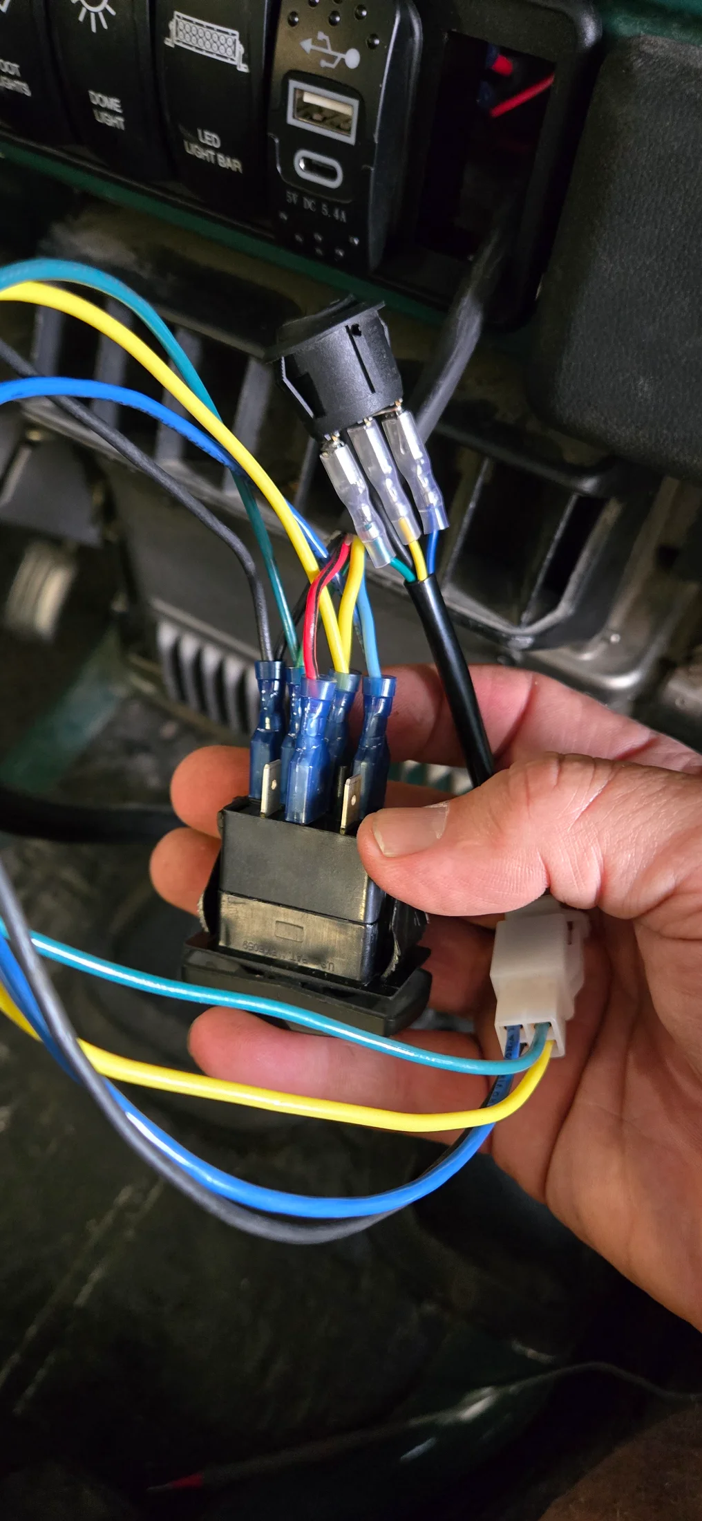

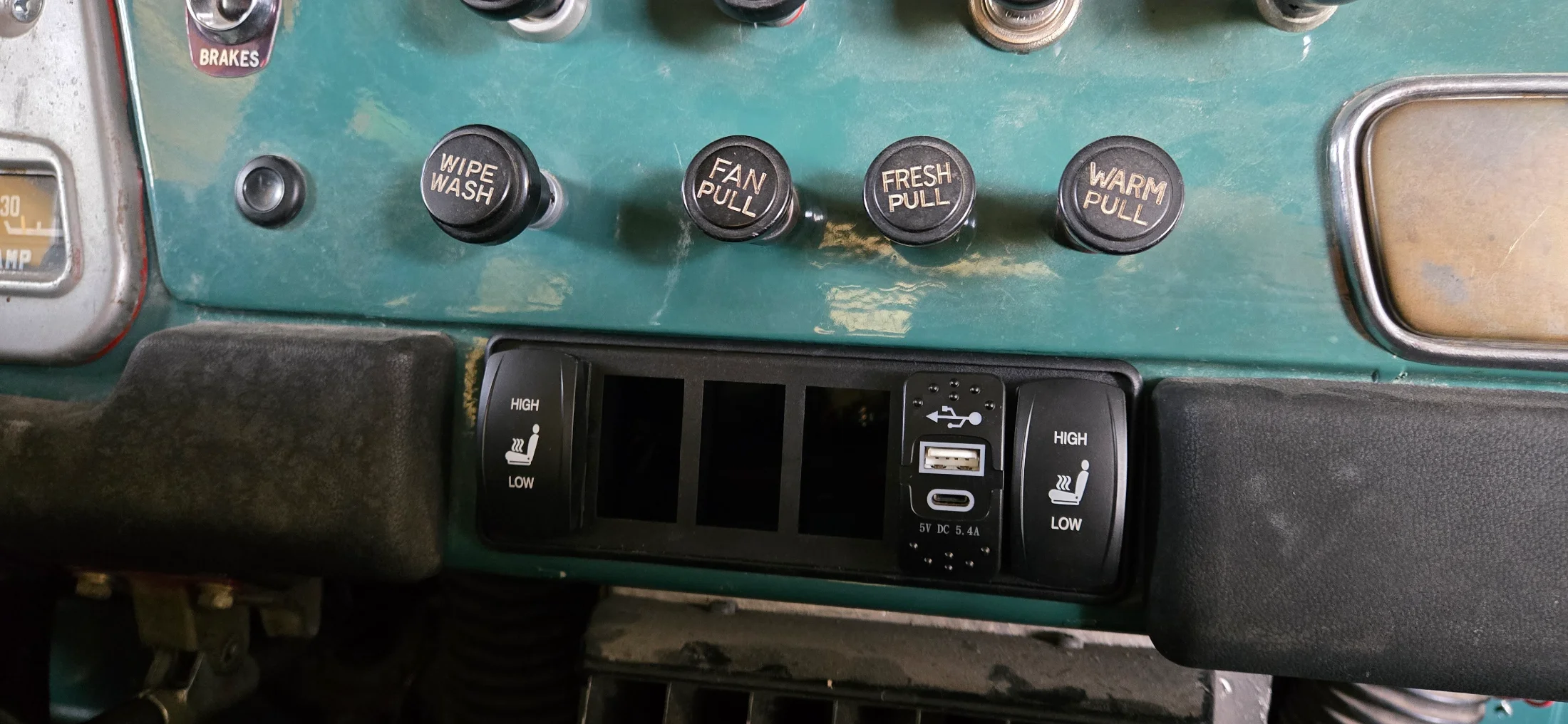

The fun began when I wanted lighted switches. I had already decided on the V series rockers from Carling.
The seat heater wiring design runs the 12vDC power supply to a magic black box under the seat, from there a 3.5(ish)vDC switching circuit goes up to the switch. Hi-off-lo switching circuitry (SPDT).
That wouldn't work with a 12vDC light in the Carling switch, after reviewing some wiring diagrams on their switches I figured out i could run with a DPDT (double pole double throw) switch would work. Using one set of contacts for the heater switching, and the other I brought 12vDC to power the lighting circuit in the switch.
View attachment 3986091View attachment 3986093View attachment 3986094

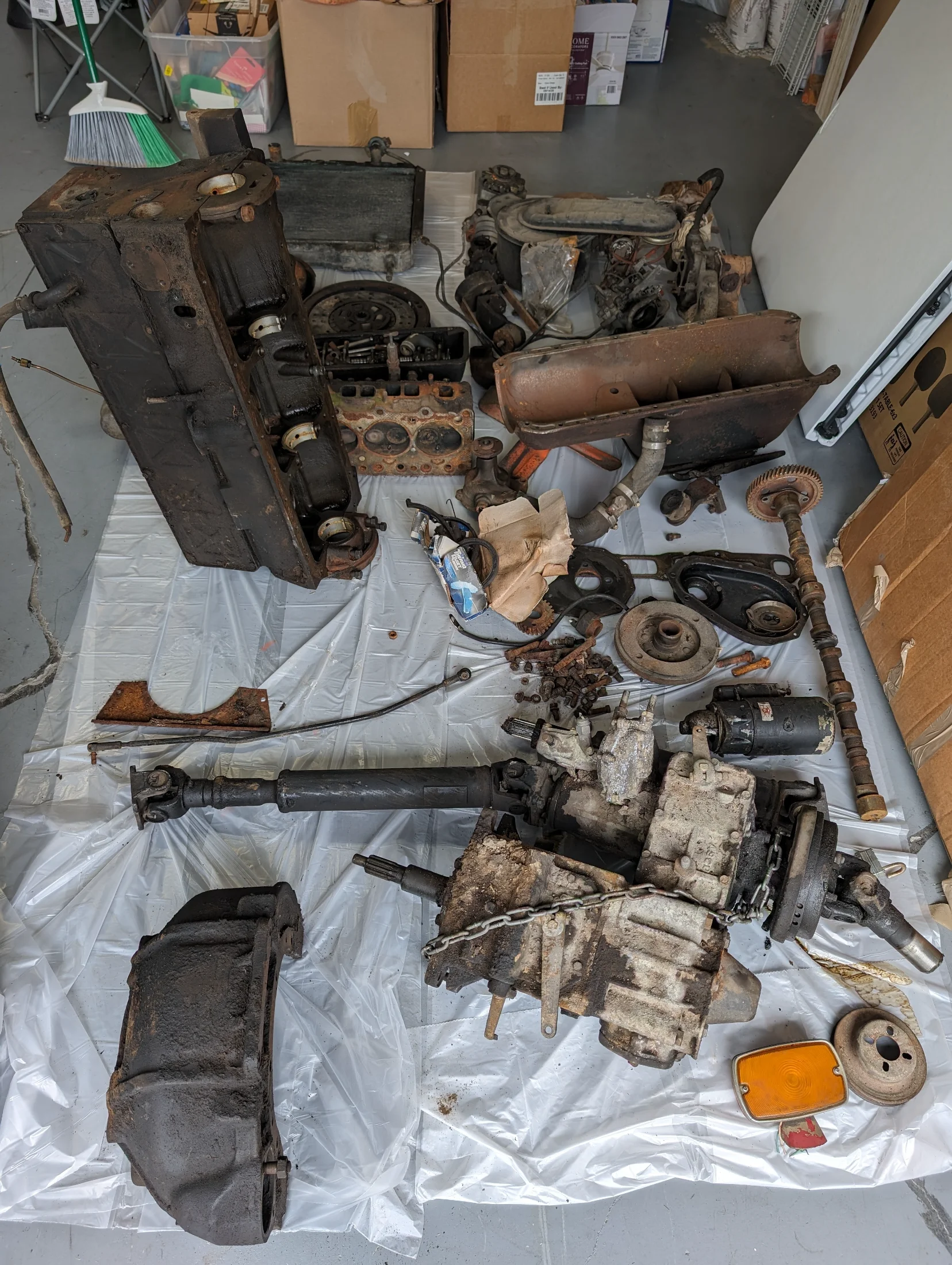

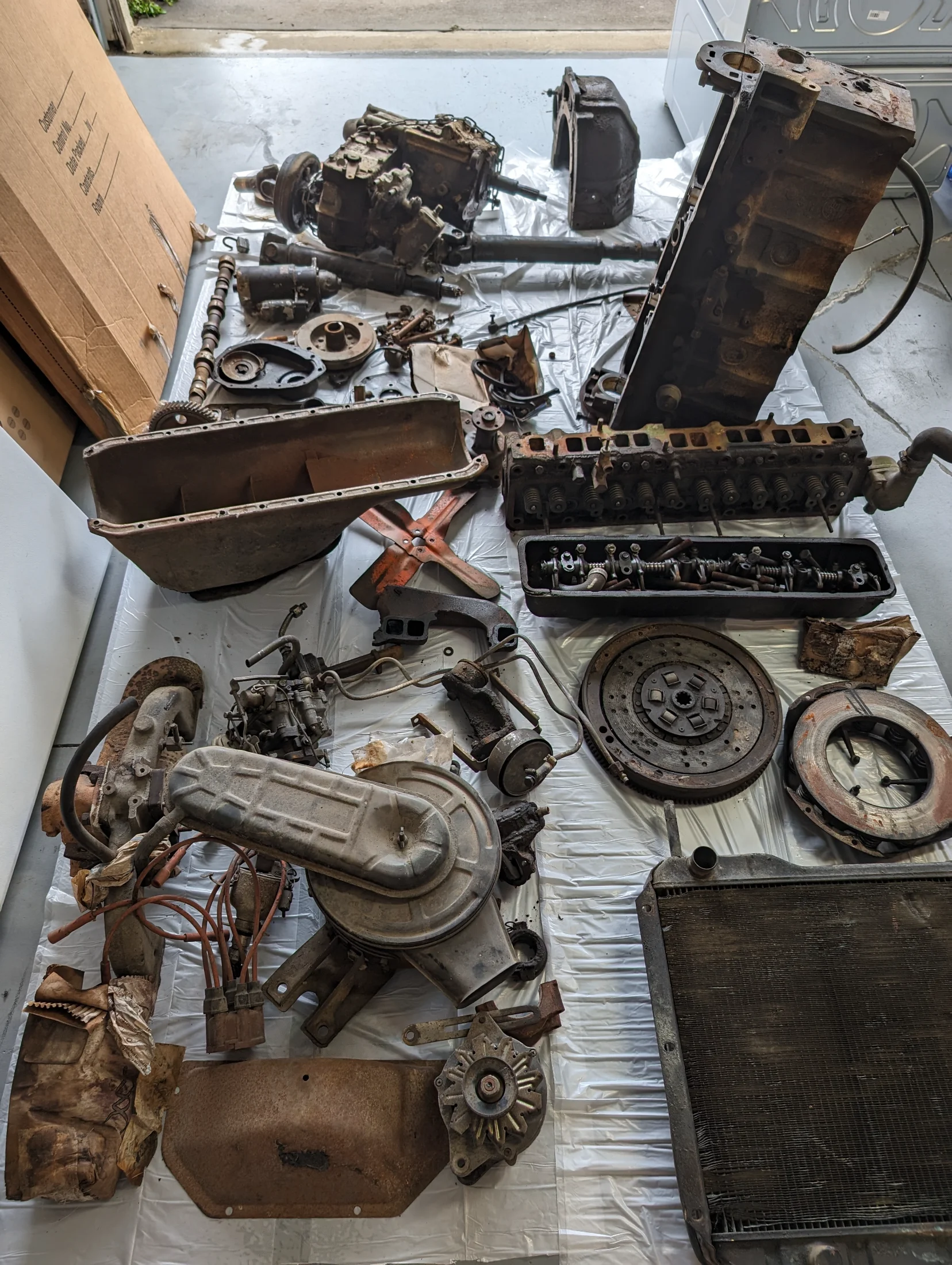

A PO of mine had installed a T shaped shutoff valve between where the heater hose connects and the head so they could shut off any heat from there. Cheap & easy solution. Someone pointed it out to me when I posted pics of the parts that we unloaded from the back of the 40. If you pinch zoom in on the head in these 2 pics you can see it:

Once you figure it out, you could probably make some money selling those nicely labeled wire harnesses. Looked great to me. 👍
