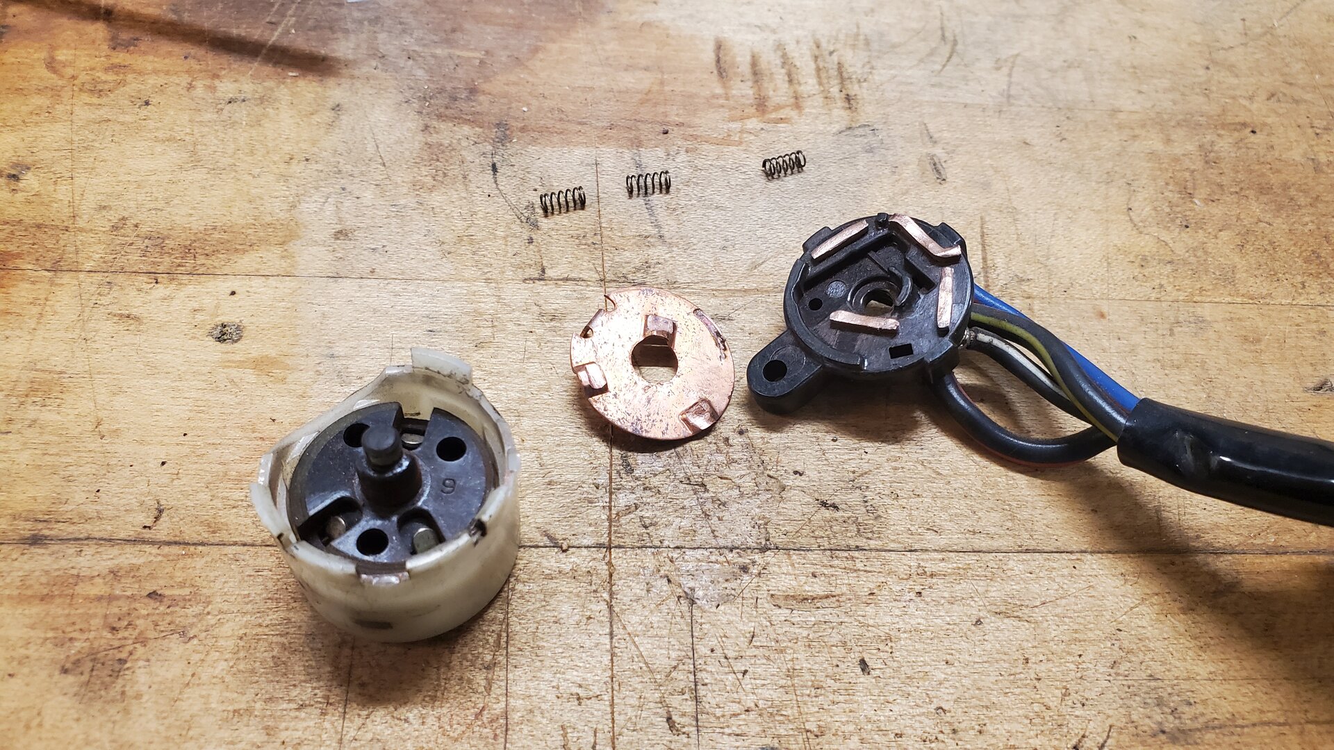

A normal person would have pulled this out, called @ToyotaMatt for a new one and did the plug and play thing.
On the other hand, most parts on these rigs are robust enough to rebuild or rework enough to get by for another day.
I'm the type to rebuild things.

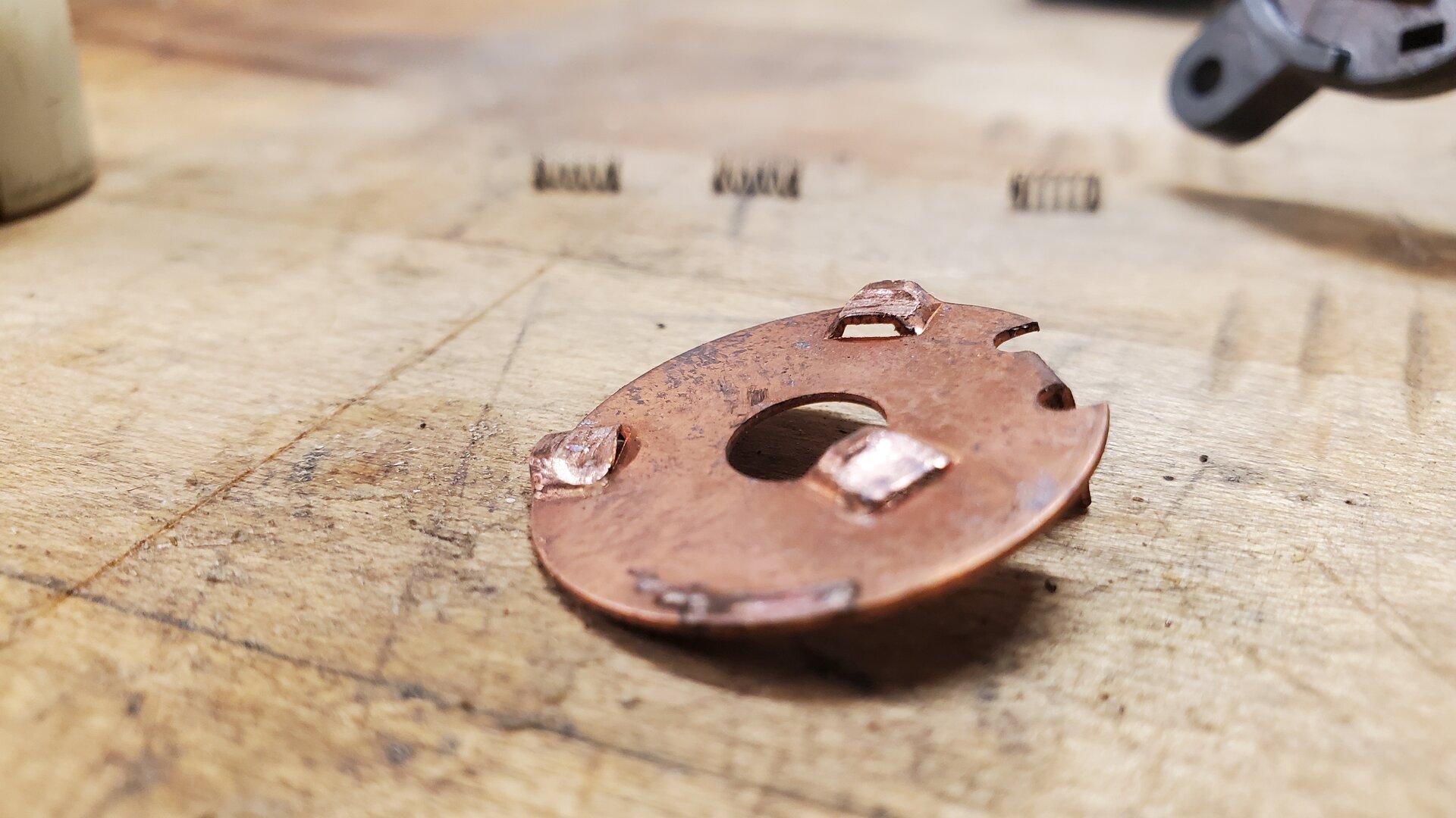

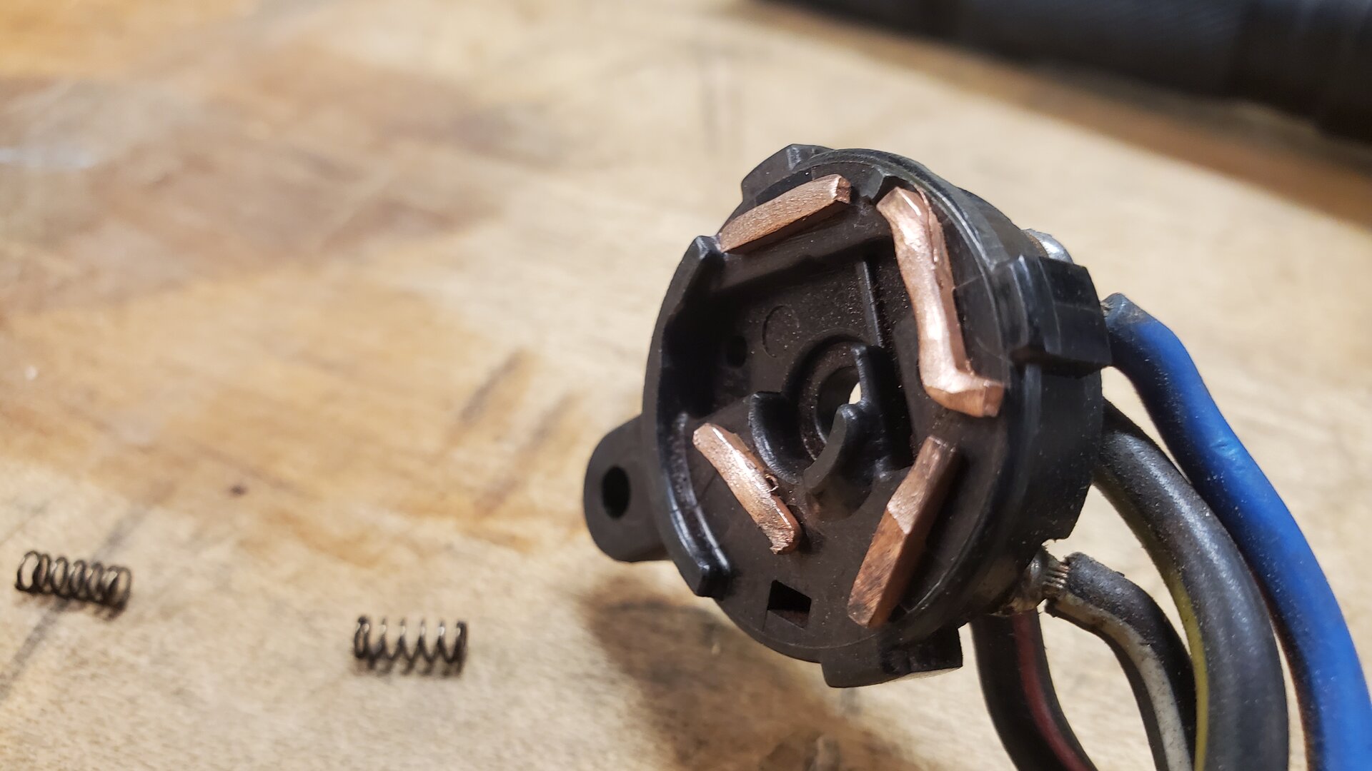

Here's the guts out of the ignition switch from a 74 for anyone that's interested.
I was having problems with the ACC firing the starter when switched back to ACC. Occasionally the switch was hanging up in the start position in cold weather.
I'm pretty sure I fixed both for the meantime.

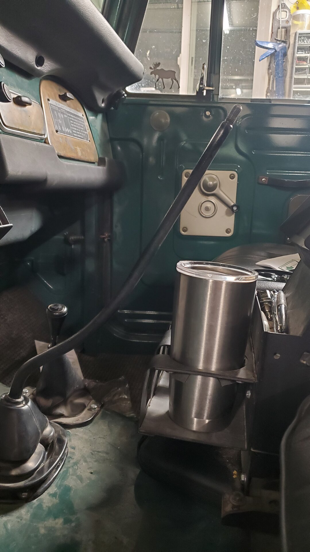

I also pulled the most PO thing that I think I've done yet.
The gear selector has always hit my cupholder on the Tuffy console.

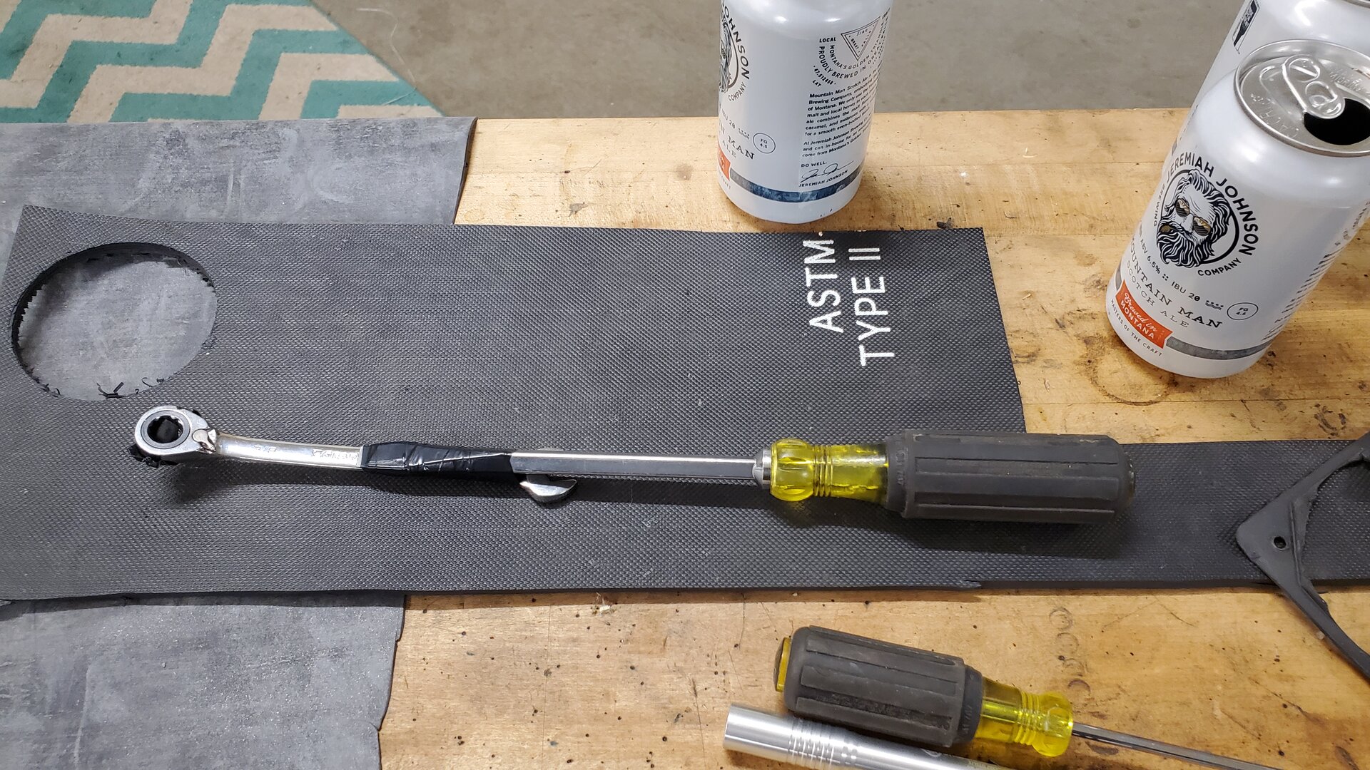

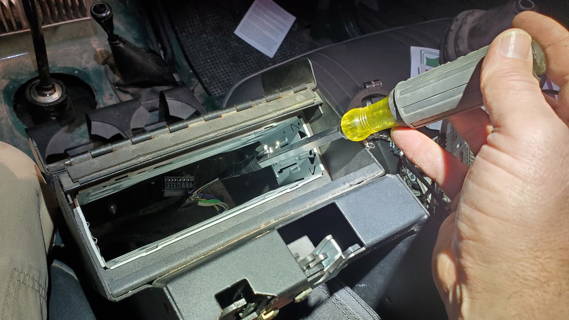

A little love in a 1/2" EMT bender and I solved that. Personally, I would have rather used a hickey bender, but I had to use tools on hand.
@BMThiker would approve of some ghettofab tools to get into the radio slot of the Tuffy console.
Here's the guts out of the ignition switch form a 74 for anyone that's interested.
View attachment 3226211View attachment 3226212View attachment 3226213
are you sure you don't want to call ToyotaMatt ........ 😆
I'm definitely going to need a new switch one of these days, you can see in my pics how worn the contacts are. I bet it dropped an old school salt packet worth of copper dust out of the housing when I pulled it out.
Nothing last forever.
your method was sound there / is sound , the ROTARY copper contacts get MOON craters in them from the spring loaded detent balls , and that's the point of no return ....
that can be dangerous if your spring loaded start feature step wont return automatically , to the KEY ON position by it self , you might hit a Giant Sequoia tree out on your compound game trails , or worse a grizzly out of season .
then you could wind up just like Mr. Ferguson from the AMC show HELL ON WHEELS , after his entanglement with his switch and a Grizzly Bear ........:confused:
and we don't need all that going on here in TECH .... :D

You got a patent pending on your new SST?
Improvise, overcome and adapt does not = “Ghetto”… Well played..🏆👈😎
