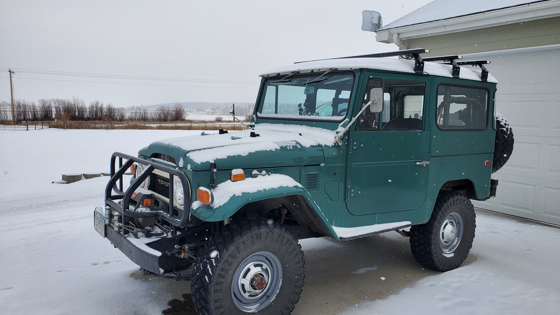

I noticed a different kind of puddle under my 40 yesterday when I was plugging my truck in, decided took at it today. The hose clamps around the Gano filter were all pretty loose. A quick turn of the trust yellow Klein nut driver and it felt good, poured about a half gallon of coolant in to top it off.
Might as well start it to circulate some coolant at -5°.
Cold kills batteries dead.
I'd also like to bitchslap the dirtbag that put this hose clamp on like this.
Oh. Wait a sec....
I had a minor leak this morning on my lower radiator hose. I'm using original hoses, but, I switched out to band clamps with worm gear because the wires were basically shearing the hose. I don't recommend doing what I did. Anyway, I wonder if they loosen up over time, mine was kinda loose? Also, I wonder how much force a Gano filter will take before it gives up? I'd say that your motor is healthy enough to not wear one. On mine, I just watched the rust flow thru it for the most part, but, the opaque 5/8" filter on the heater line was a bit more catching of stuff. A several gallon sample run thru a coffee filter on the bench didn't reveal much on mine, I bet it is still stuck, or whatever.
Just make sure your coolant has enough freeze protection for your current weather.
That's why I popped the hood today, I was fearing a popped freeze plug. Last time I checked the coolant was good to the -30° ballpark.
