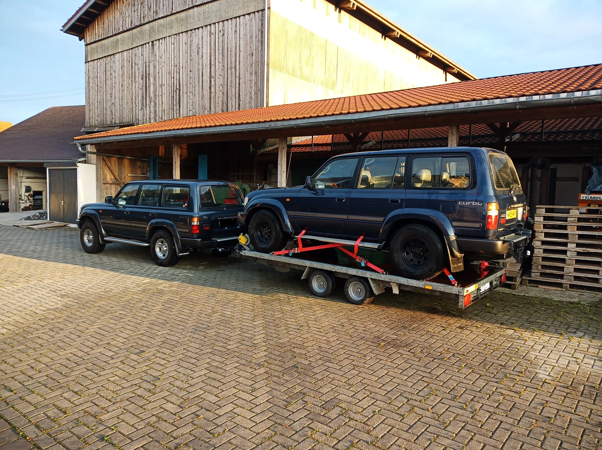

About the Cruiser: A few years ago, before Brexit and import taxes, a good friend of mine bought a rusty, but mechanicaly sound HDJ80 from England. 96 model, 300k miles, lots of rust, triple locked, AC, 3rd row seats, all the gimmicks. Half of them were broken, but that's something for another day... Oh, and did i mention the rust?
Anyways, that car sat in his barn for few years, because it was No. 25 on a long list of projects, collecting dust and more rust, because the stupid barn started flooding one winter.
A few months ago he offered to sell it to me (he's got like 4 or 5 other cruisers and a heap of other cars that want attention...) for about what he payed four years ago, dirt cheap for todays market value in Germany. Of course I said yes immediatly, despite having no space and time whatsoever for another project car.
A few weeks later i was able to get it home.
So now i owned another wonderful Cruiser with loads of work to do to get it registered and road legal.

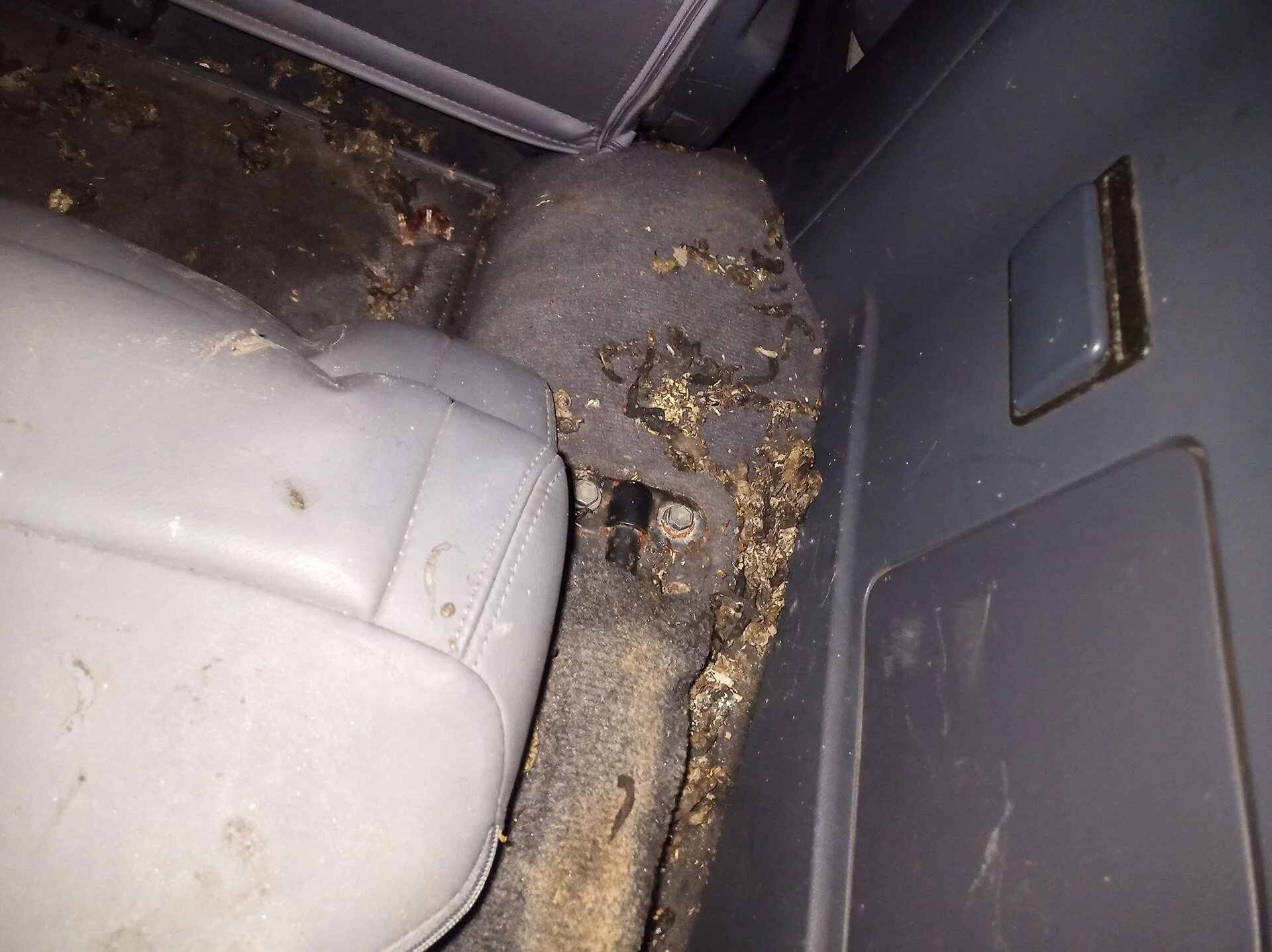

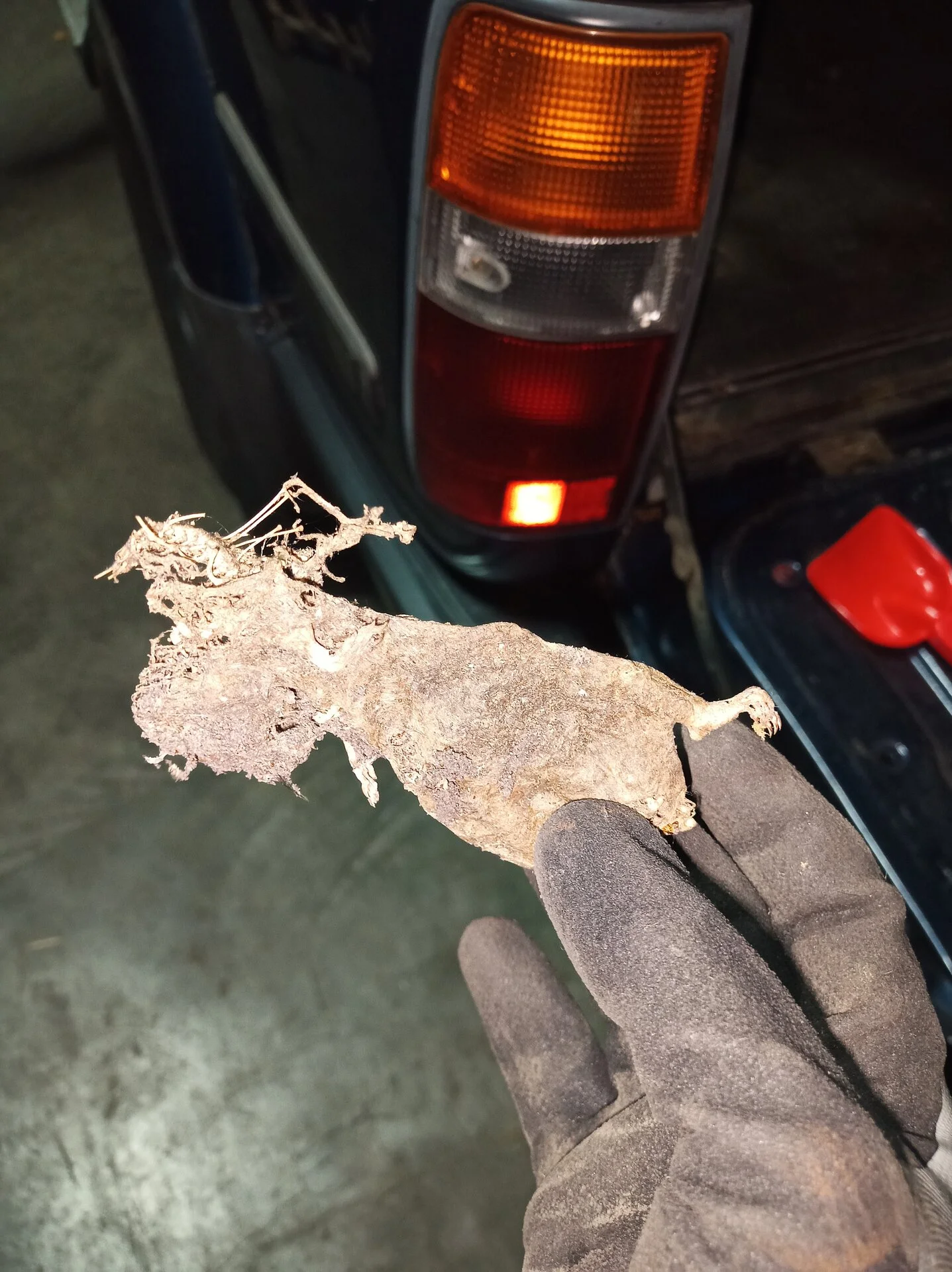

One of the main Problems, besides the rust: a weasel (Mustela nivalis) decided to reside inside of this majestic vehicle while it was stored.
At least no rats and mice entered the car alive...
I ripped out the (mostly broken) power seats, the absolutely disgusting carpet (at least the part of it that wasn't used by the former tenants to build a nest behind the dashboard) and started cleaning. I wanted to get the car into a state that you could at least sit in the drivers seat and breathe properly without getting sick.

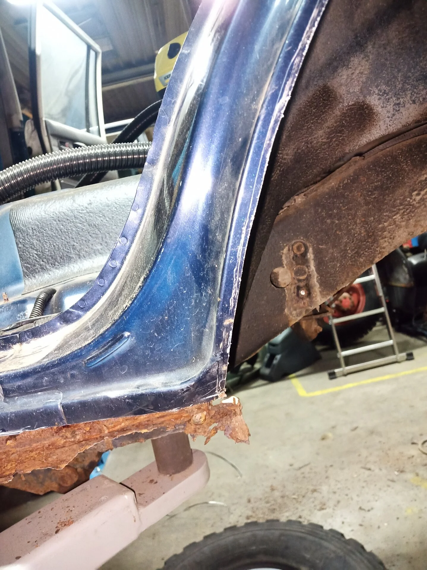

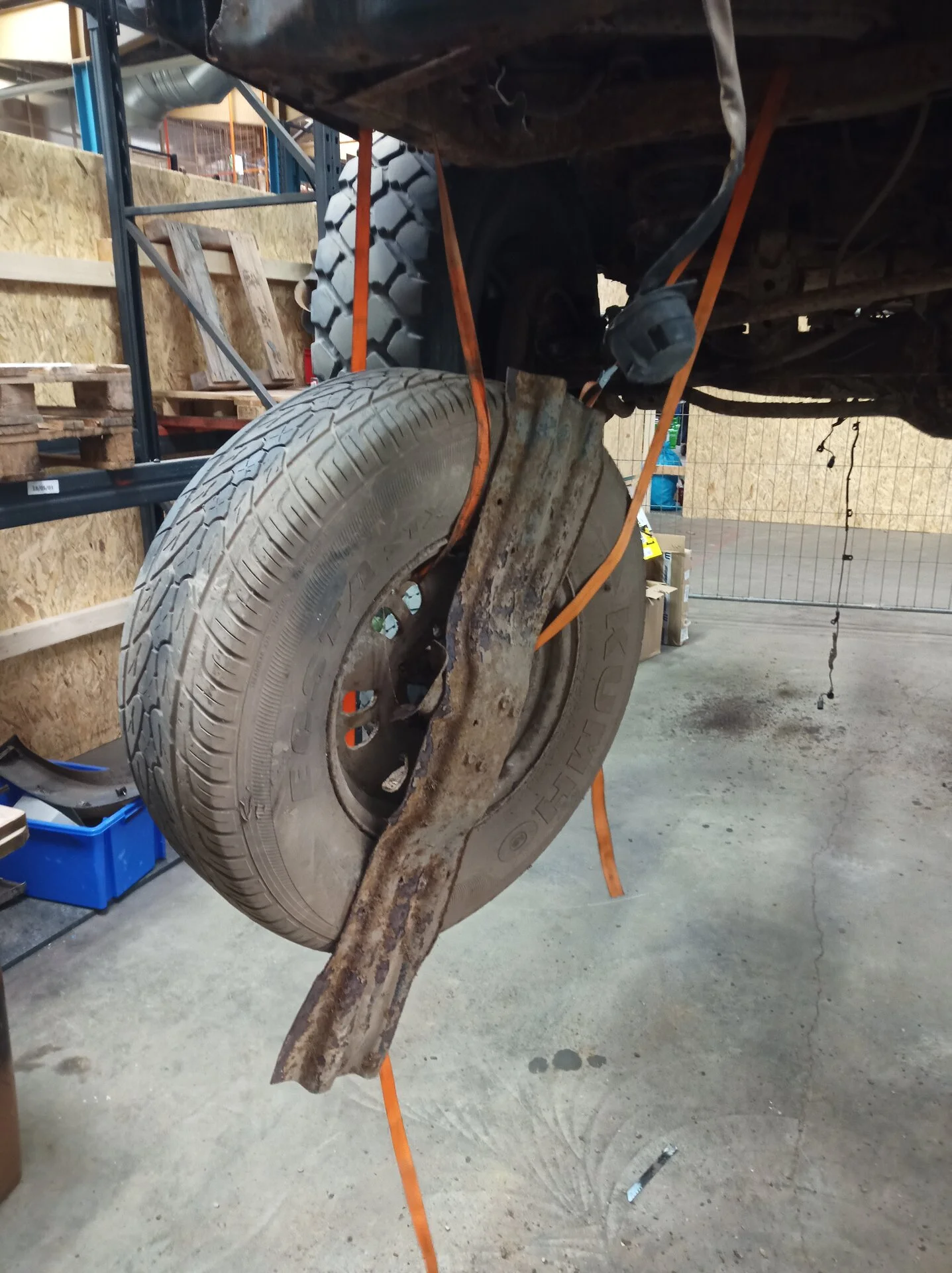

Quarter panel chop incoming.

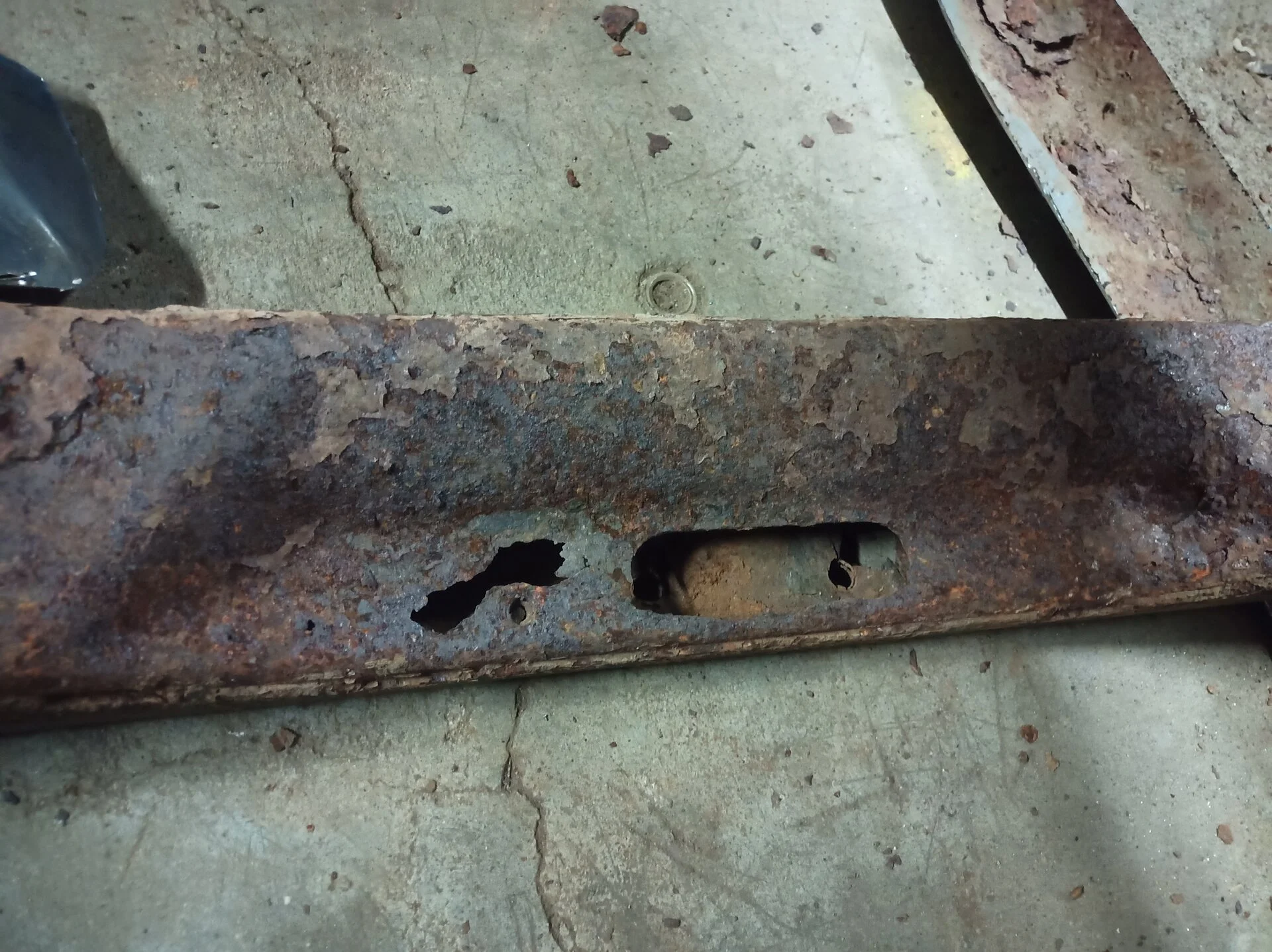

Rear crossmember was also way to crusty for a proper repair, so i'll have to make a new one. At least that gives the opportunity to increase the rear approach angle.
Yikes, that rust is painful to look at.
Sadly that's how half of the cars that age will look in a northern climate with salted roads. I also believe the PO owned a boat and dipped the 80's ass into the sea frequently. The front half of the car is in pretty good shape, but all that was left of the aftermarket trailer hitch was rusty flakes covered by traces of powder coating.

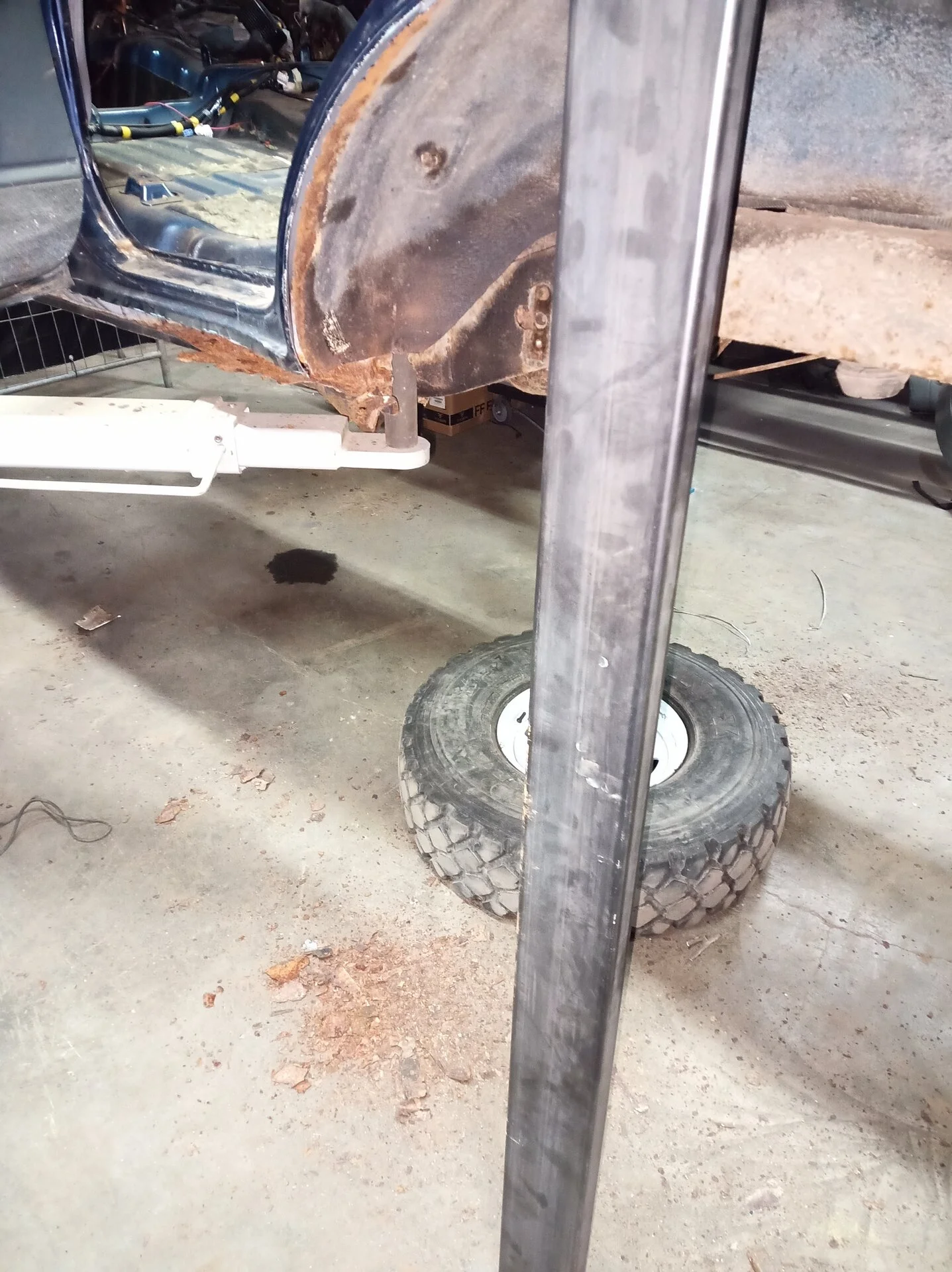

I want to keep the nightshadow pearl for now, i'll just touch up the repairs with zinc primer and some rattlecan paint. Plan ist to replace the rusted out rockers with some 120x40x3mm tubing as a base for future bodymounted sliders and add steel bumpers front n back.

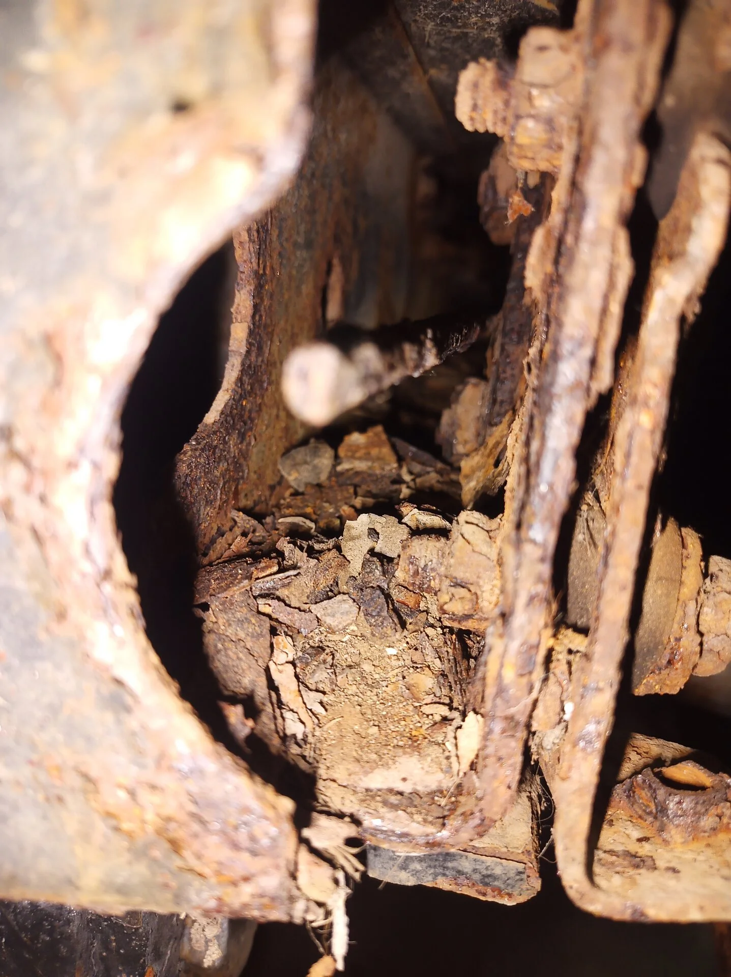

More effin' rust!

New rocker panels, i'll build them tomorrow. Stil fighting with that stupid flu.
that's really bad rust. Make sure to check the inner fender hangers.
The ones in the front? They're fine. Most of the rust stops miraculously in the middle of the truck. As I said, I think the PO owned a boat and sunk the back half of the car regularly.
Oh I see. Its just a very common spot and difficult to see which ultimately manifests to a rusty driver's firewall / floorboard.

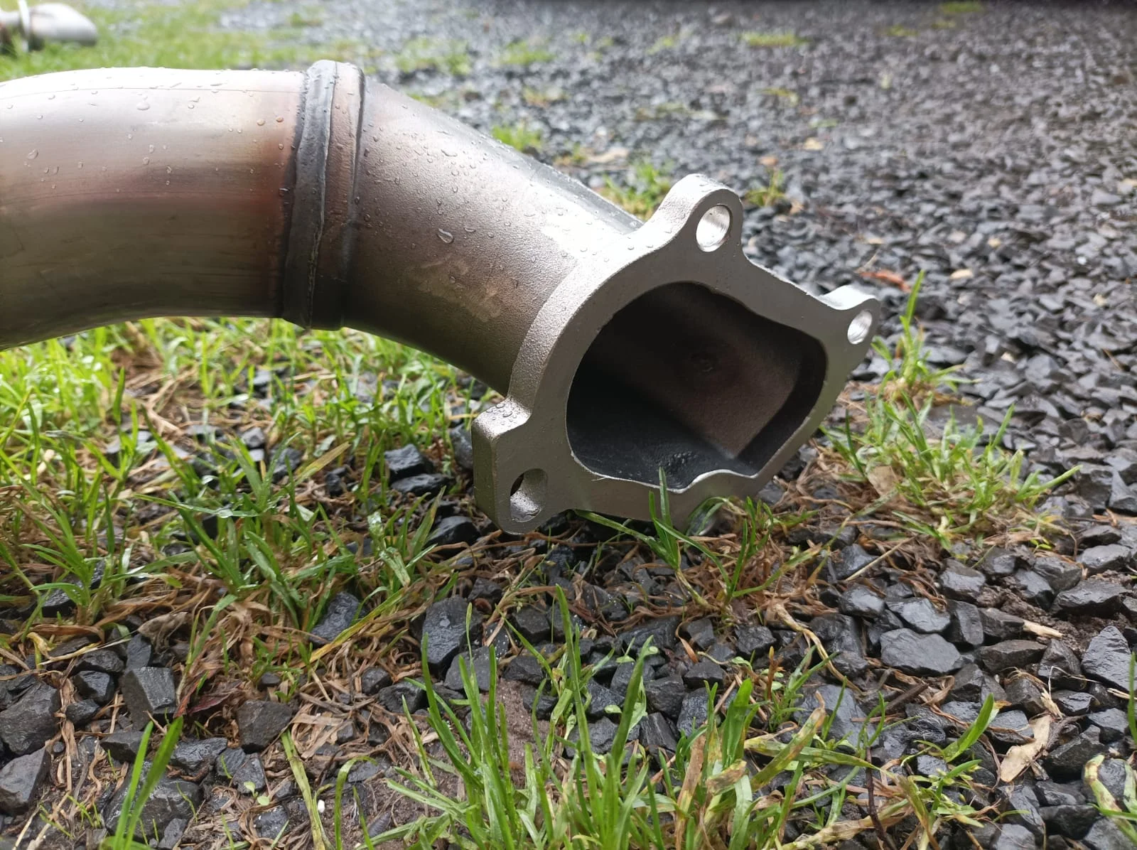

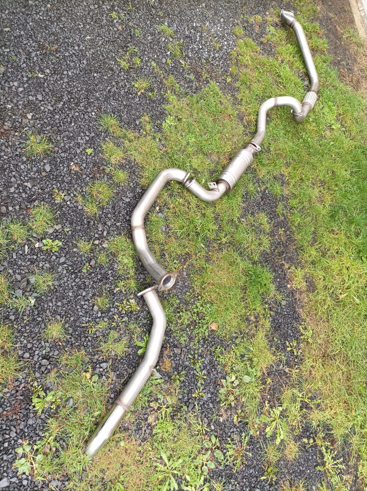

Can you provide a link to exhaust manufacture? Thanks

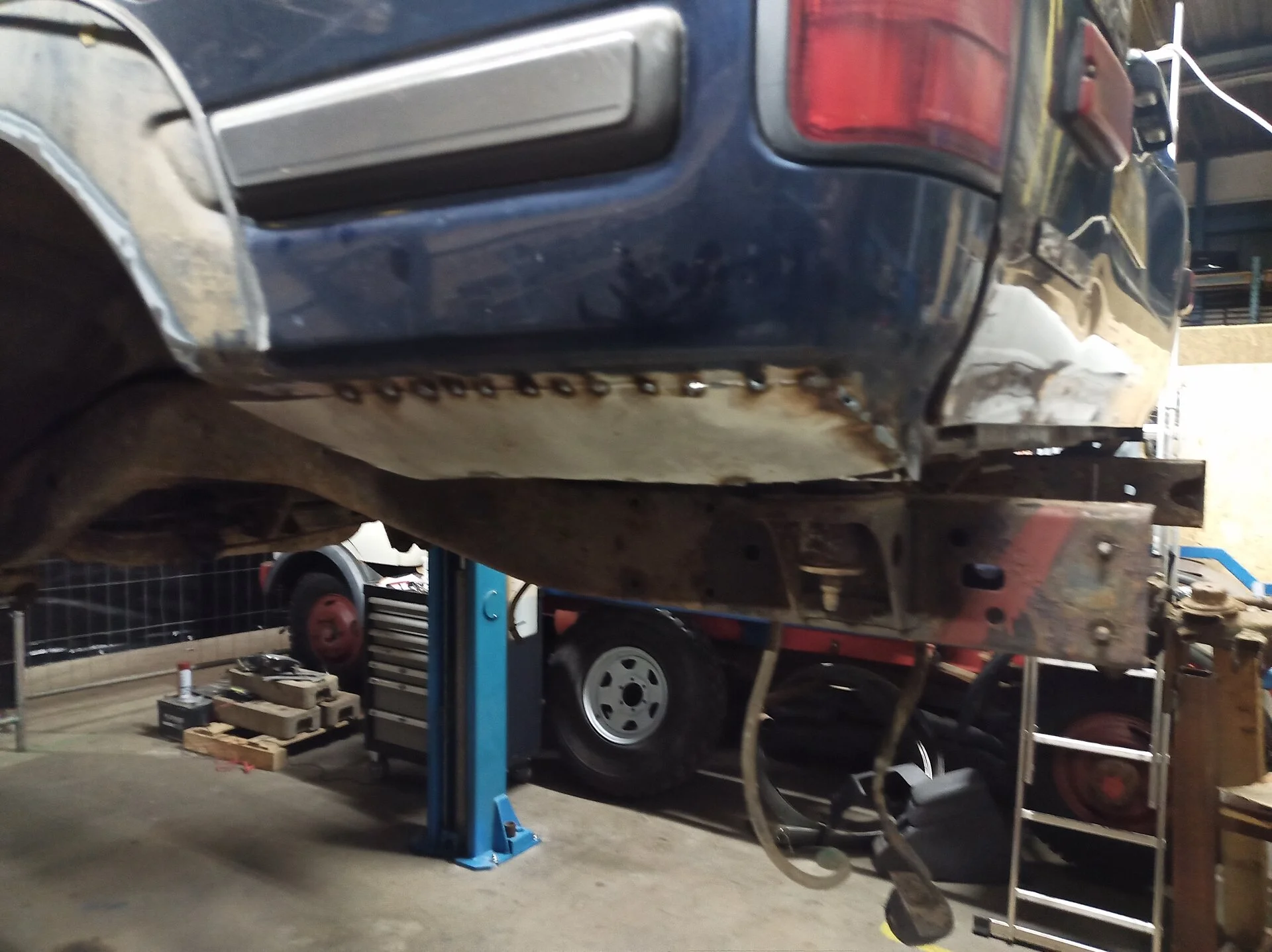

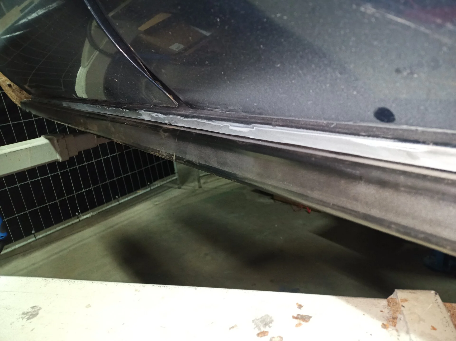

Rocker panel replacement on the way. 35mm more clearence, 3x the thickness of the original. Not pretty, but...

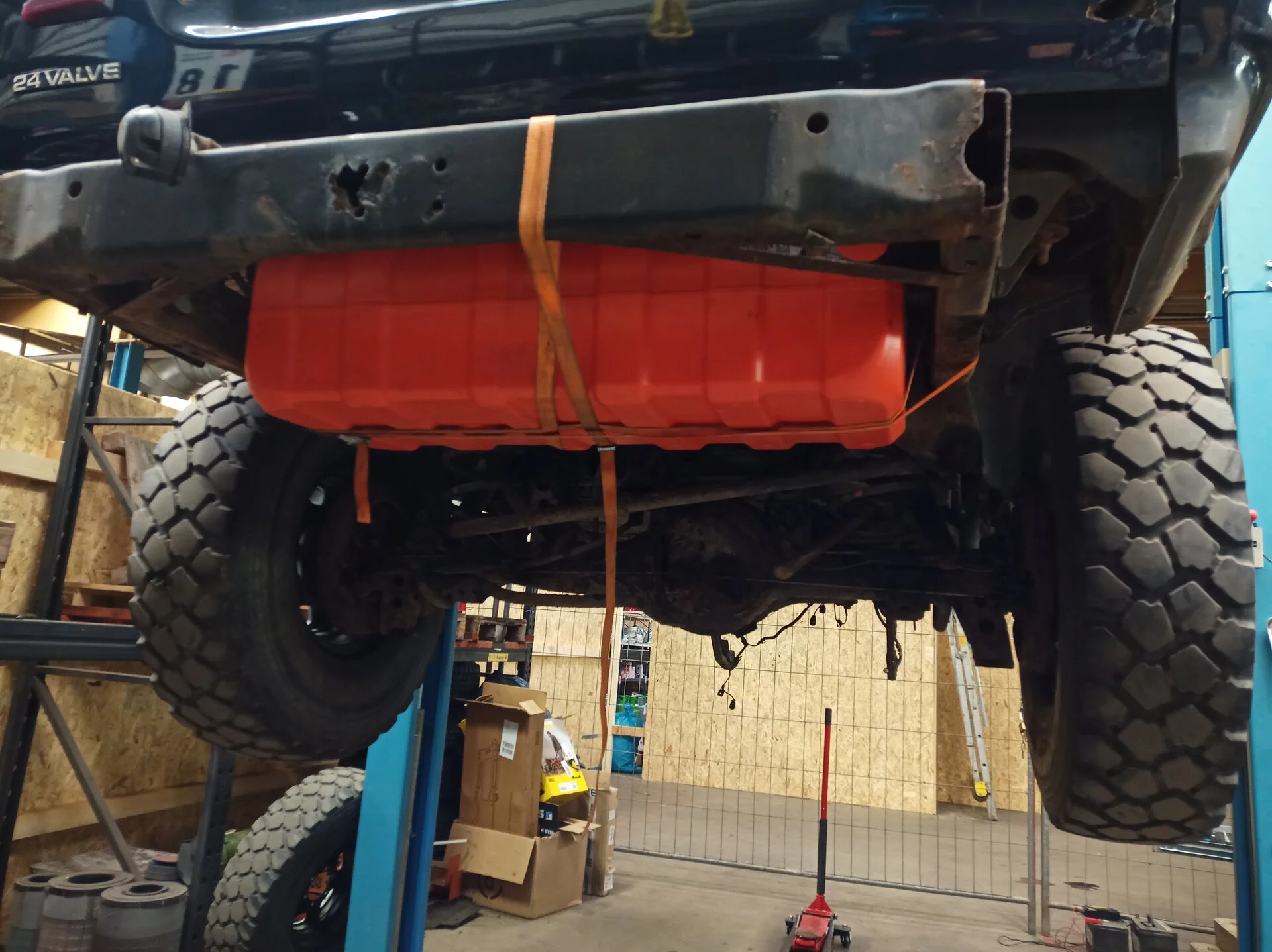

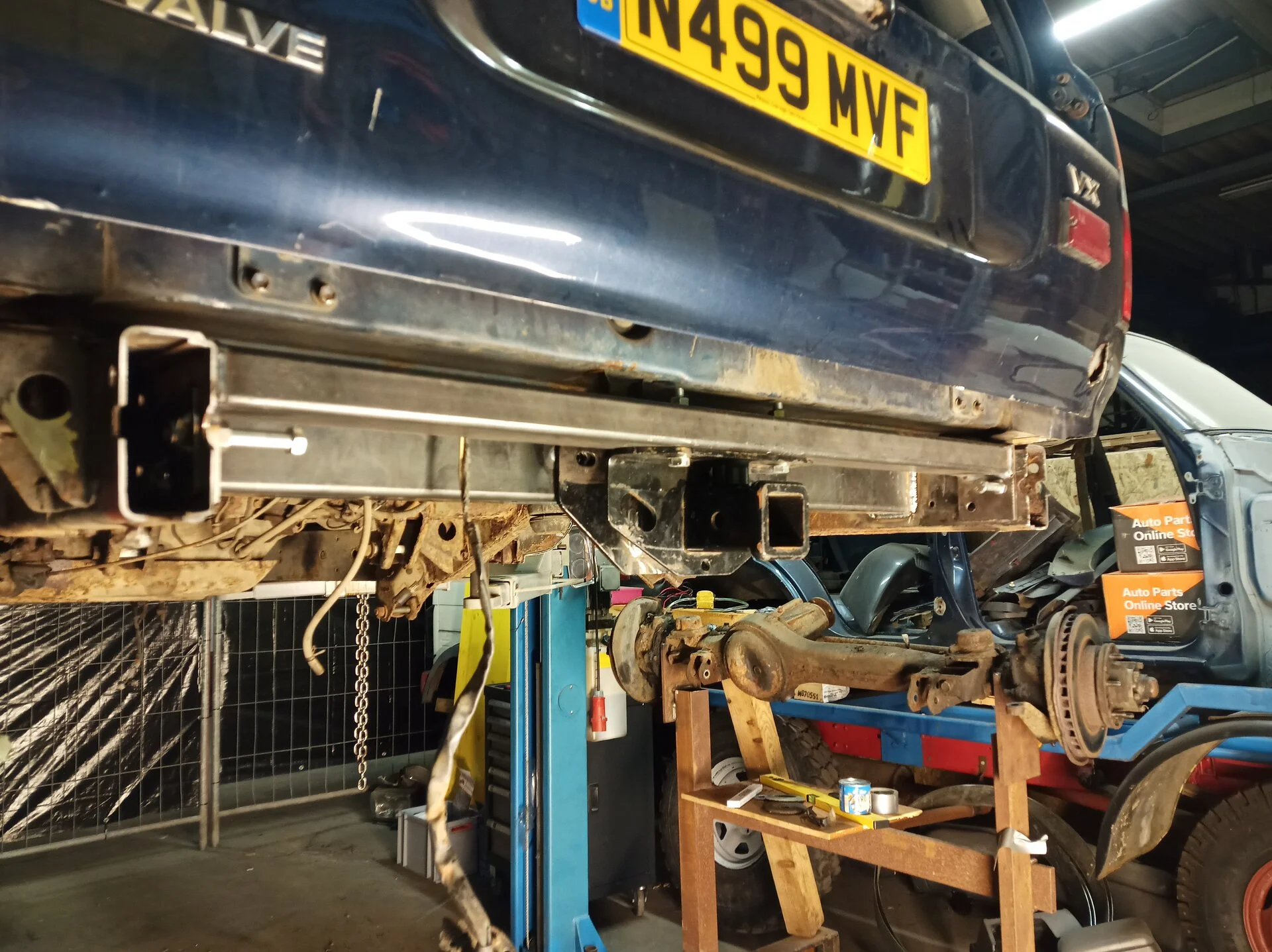

The build slowed down a bit due to family stuff and working abroad. But i finally built a new rear crossmember and a hitch mount.

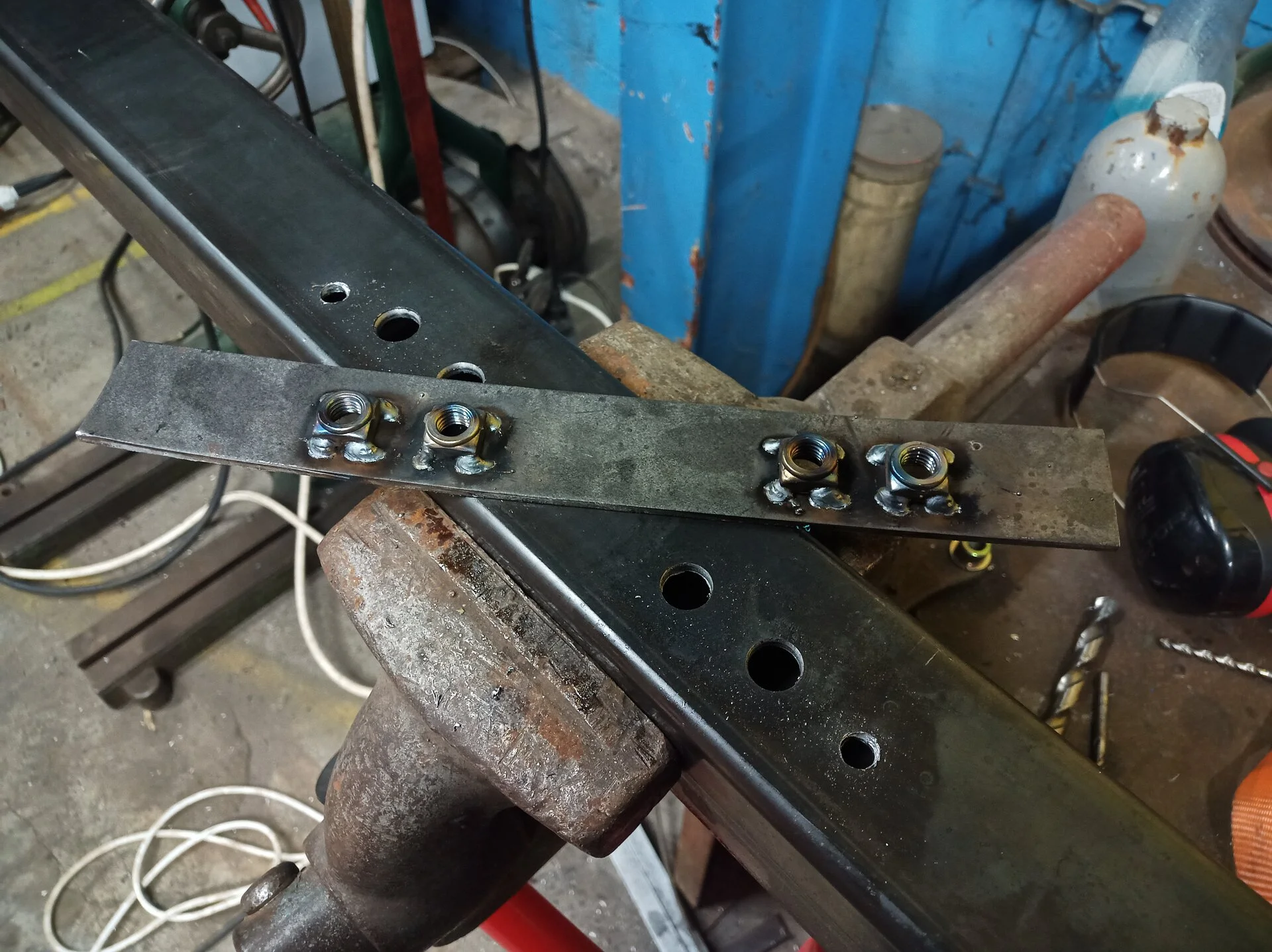

Welded some captive nuts to a piece of plate.
Plugwelded them into the crossmember
Not SEMA-ready, but i don't think it's going anywhere...
I did cut a bit more than 4" off the back of the frame for more clearence in the rear.

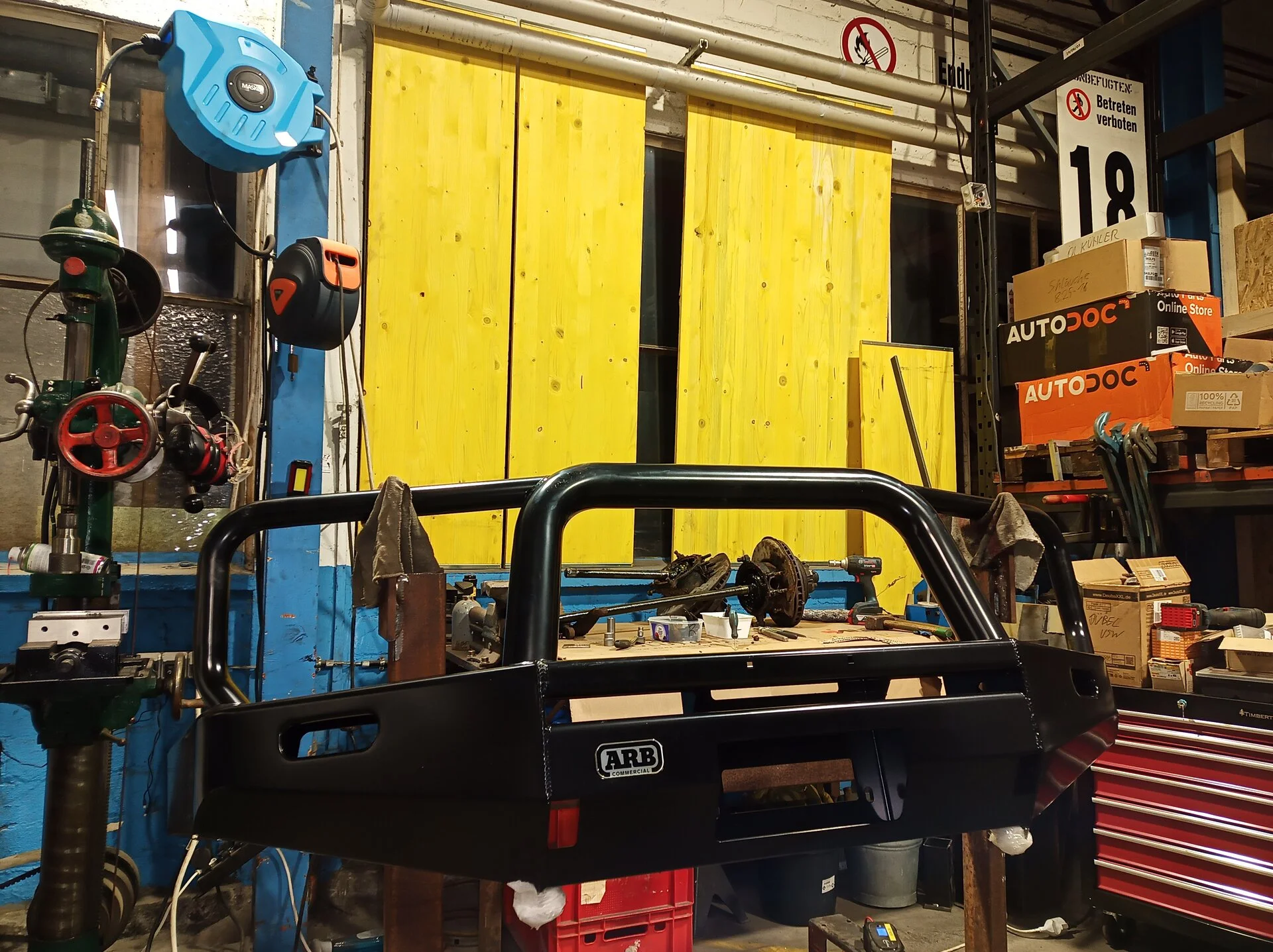

I got a great deal on an ARB for my Hilux though. A vendor in Belgium had one available for nearly half the original price because of "shipping damage" (powder coating on the top bar has some deep scratches...). Yes!!!
For the weasel, I want to go with some kind of Iow profile, lightweight bar. Ob the other Hand I also really like the look of the old school ARB bar on an 80...
