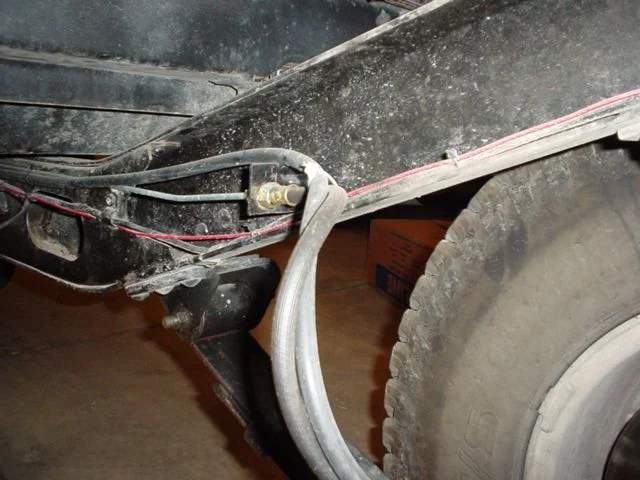

OK. But why is it bad.? If the lines are tightly secured with no leaks, what is the problem?
