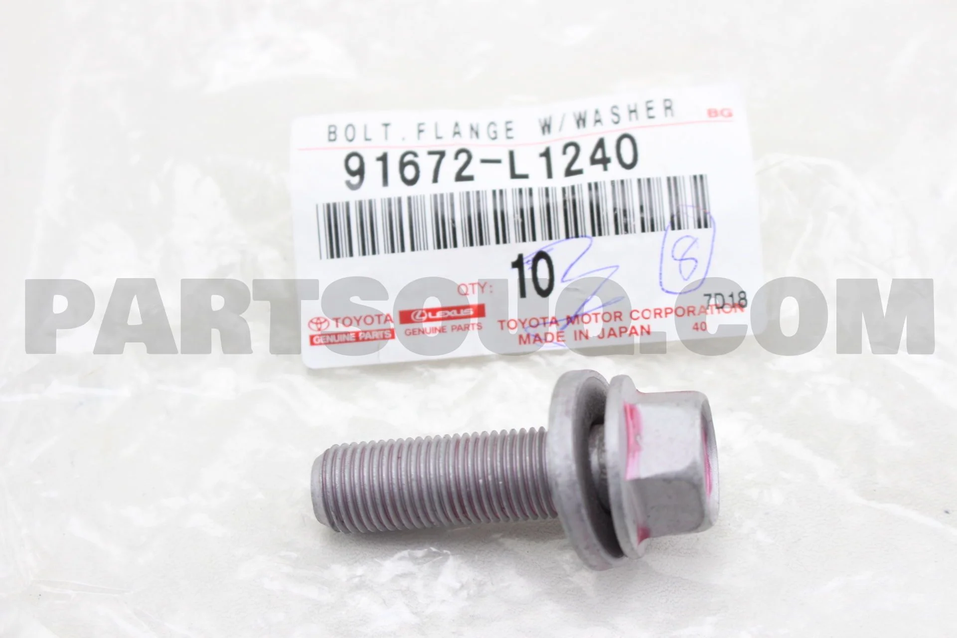

Caliper Bolt for 200 series looks pre-coated, see the red:
The coating, which effectively lubes the thread, may be why Toyota reduced the torque in the 200 series to 73ft-lbf.
The 100 series don't look like pre-coated. But I'll know soon, as I'm ordering some this week.

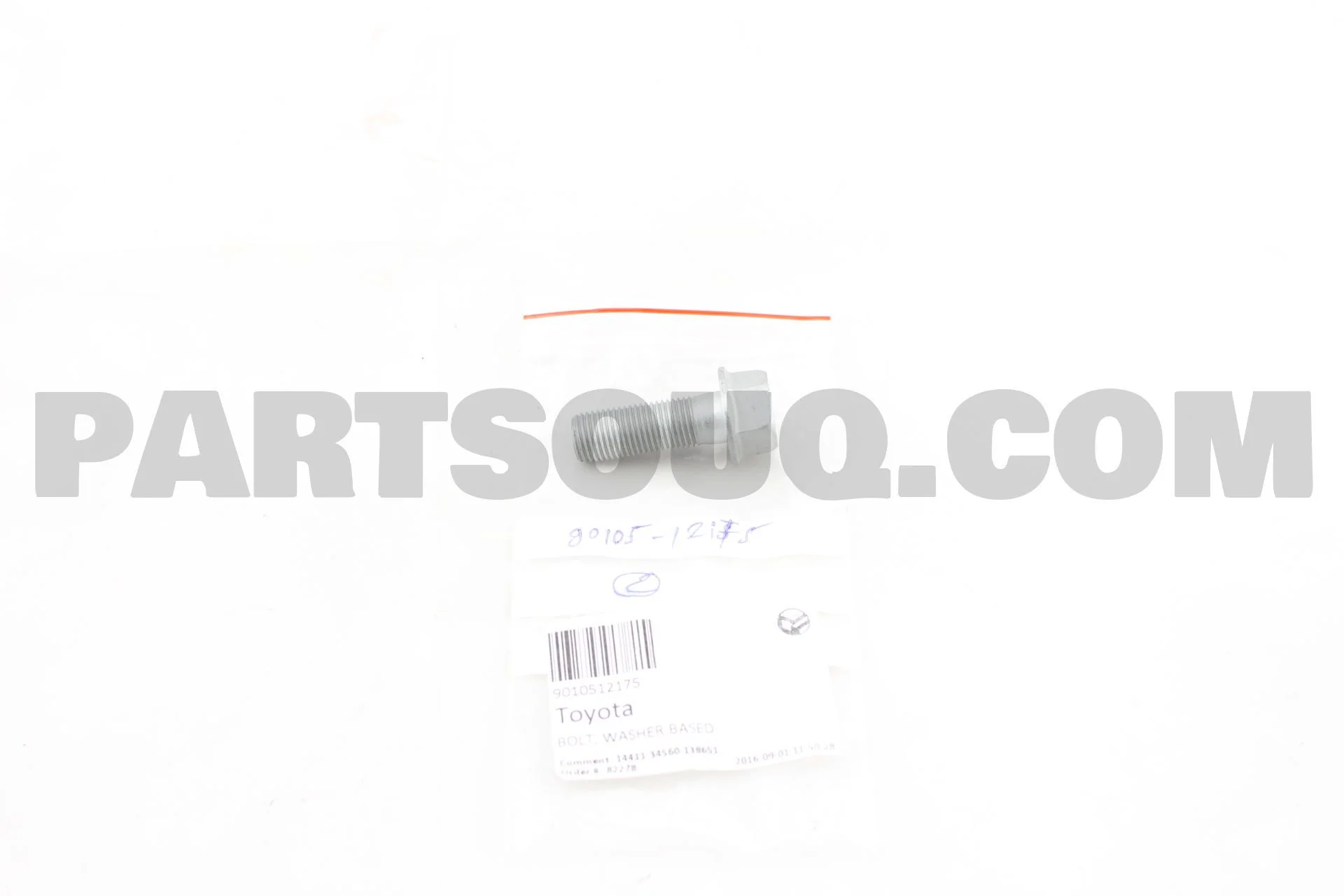

Here's another pic I pulled from Partsouq.
100 series caliper bolt does not look pre-coated.

We may not need washer for fronts as picture looks like they're part of bolt.
