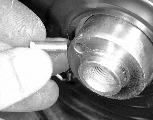

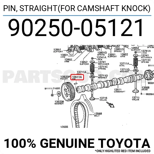

@2001LC Here's the part number for that pin on a 5vz-fe. I cannot confirm it is the exact same size pin as what's on the 2uz-fe, but hopefully this gives you a starting point at least.
Thank you, it does. I'll call my parts guys at Toyota and Lexus in morning a sub that one if nothing else.

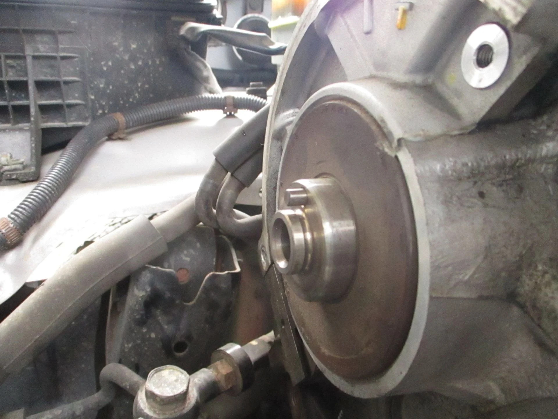

I don't think I took off the cam gear on the 2UZ when I did my T-belt, but in other engines I've always seen that knock pin in the cam gear floating. It's always been a slip fit and a separate part. In the ToyoDIY diagrams I'm not seeing a part number so perhaps the 2UZ is fixed in the cam.
Either way, That pin should have plenty of engagement in both the cam and gear. If it's slipping out enough to allow cam movement I'd expect a canyon of a gap between the gear and cam as though they weren't tightened.
*edit: correction, I did take off the cam gear and the pin did stay in the cam for me.

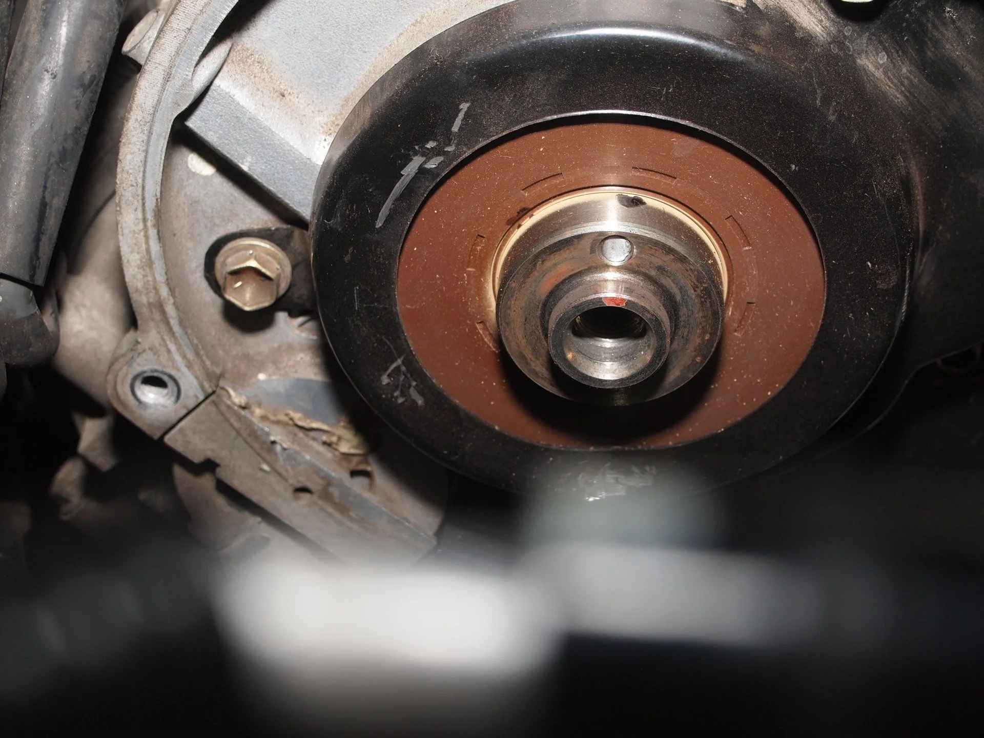

I see if I can see a gap with a mirror. But if this is the problem and knock pin now out of hole. It will be squashed and enlarged. So I need to find another.

The key in crank is in and looks as it should. The knock pin in BK 1 which has compression looks fine. Only this bk2 and this Bk2 knock pin are not as they should be. So this must be it right...LOL.. I hope so!

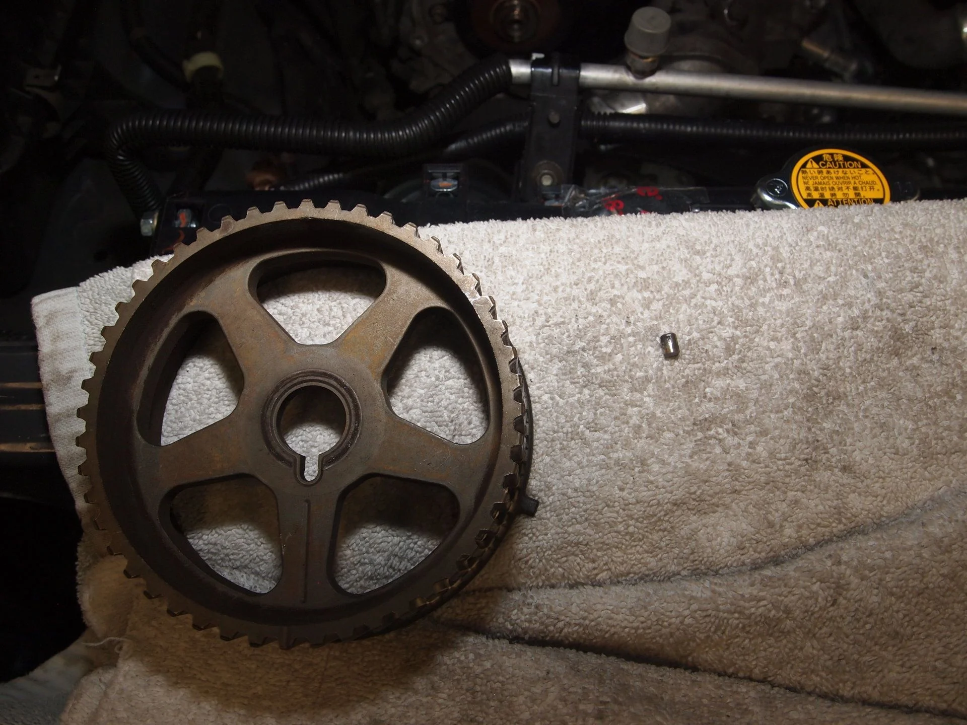

That pin should not be out that far. I don't recall the pins being loose when I pulled my cam pulleys, picture is before I removed the pulley. Clearly set further in. And then next picture is after removal. Yeah, I know the T isn't the timing mark. And first pic is left side, second pic is right side.

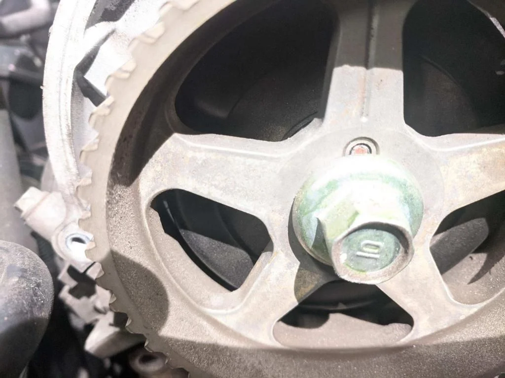

It does seem it is out to far. What you can't see in picture is the washer that is part of the nut, looks stressed at point it's contacting the pin.
The pin @JunkCrzr89 shows from the 5vz is long. Makes me thing I'm wrong. But that pin does look right. If the 2UZ does come out and that long, and is out of the hole. It's bad.
That sprocket will be bent if he torque it on or used and impact wrench.
Pull the belt off and see if the cam pulley is spinning freely with that pin looking like it does could be sheered and not moving that cam bank at all.

Called Toyota Parts. My best regular guy is out, but another really good researcher (a buddy in parts) is searching for clues. They do not show part (knock pin) available. So may be if fixed (pressed in camshaft end). So this begs the question on how it could possible float out.

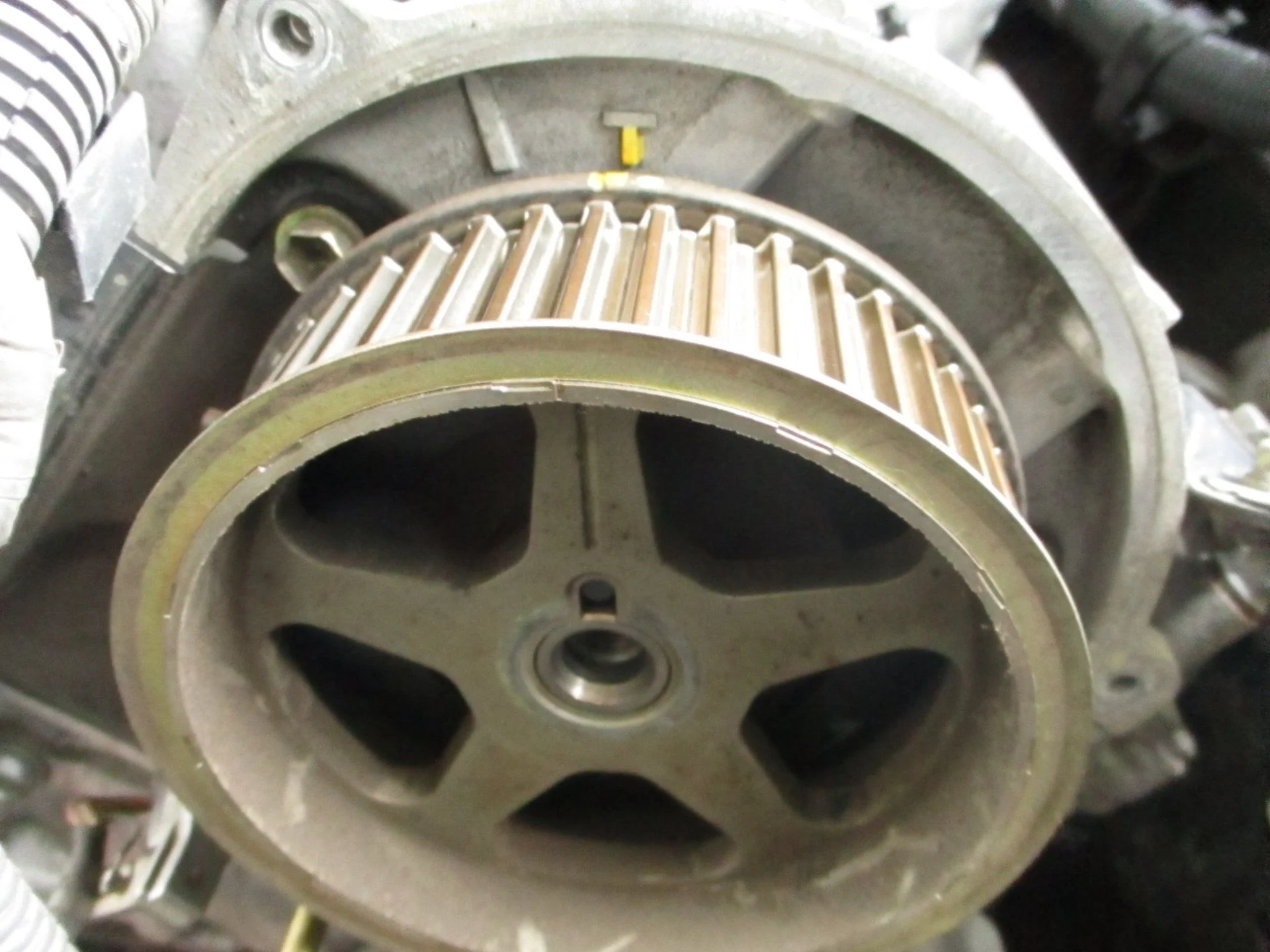

The 5vz pin looks about right, if half in the hole and half sticking out. If that 5vz pin is same as 2UZ, then there's no way it is just out of the hole - it would be sticking out so far you'd never get that cam nut tightened down against the pulley. My best guess it is broke off, the longer piece is now visible and contacting the cam nut, and the camshaft has spun out of position. The cam pulley looks aligned with mark since the belt keeps it aligned with the crank and other cam, but the actual cam is not. Pretty sure that's what everyone seems to be saying.

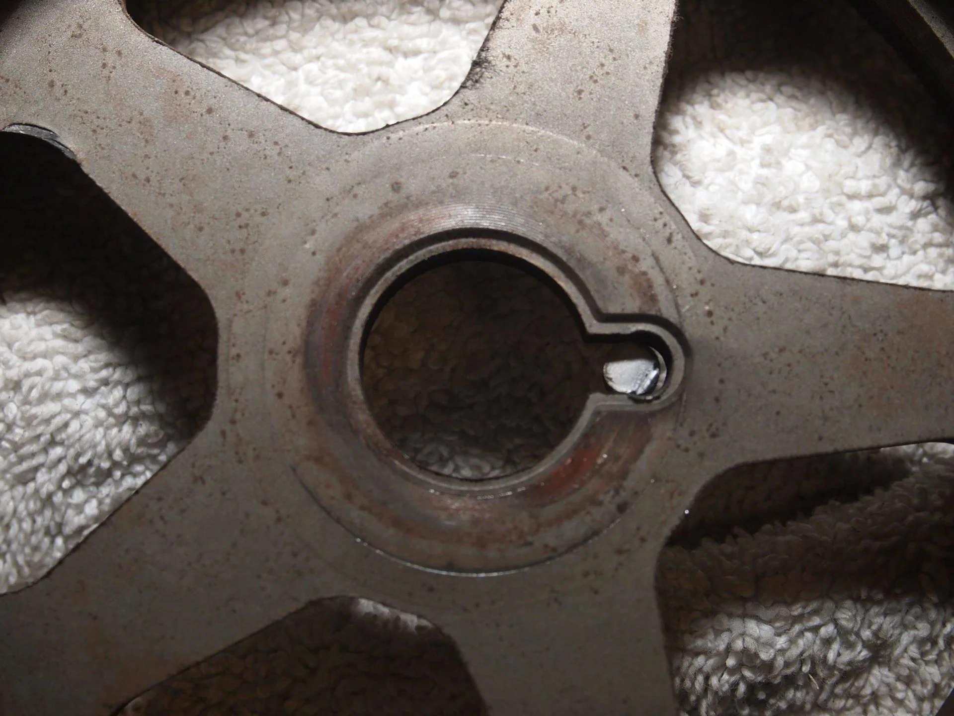

Okay I pulled the cam sprocket with Cairo (owner) here.
To get sprocket off, I wrapped an old timing belt around the sprocket to protect it, and then my big old chain wrench. Then got out big boy, my 3/4" Beaker Bar. Got all ready to muscle it. With Cairo on the chain wrench and me on big-boy. Dank it nearly cam off by it self. really i could have taken off with a 1/4" socket wrench, maybe a pair off pliers. Should have check it first think after I had found other bolts not torque. The mechanic likely put in long day, and was assembling tried.
So once he fired it up, the knock pin sheared.
And so torque held it in place for a while, but little by little the cam slipped backward, making the valves close late and read low compression.
