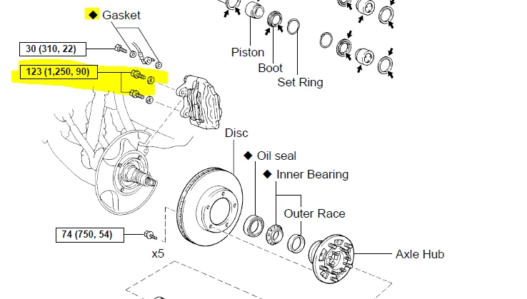

I can't find this in the FSM. Can you please post the page that says this?
This is not in the TIS or hard copy books of the 100 series FSM, in any year I've looked at.
As stated in OP; This was a change made in the 200 series in 2008 FSM.
I've both the 100 & 200 series new front OEM bolts on hand. They are appear the same. Except for the red thread seal on the 200 series bolt (pictured in OP). Toyota also reduced torque in 200 series for the caliper bolt.
100 series ft-lbf: Frt 90, rear 76.
200 series ft-lbf: frt 76, rear 70.

Thanks for calling this out: I think I read it wrong - its the gasket for the brake lines that need to replaced (indicated by a diamond sign).
