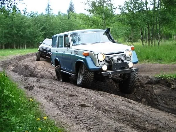

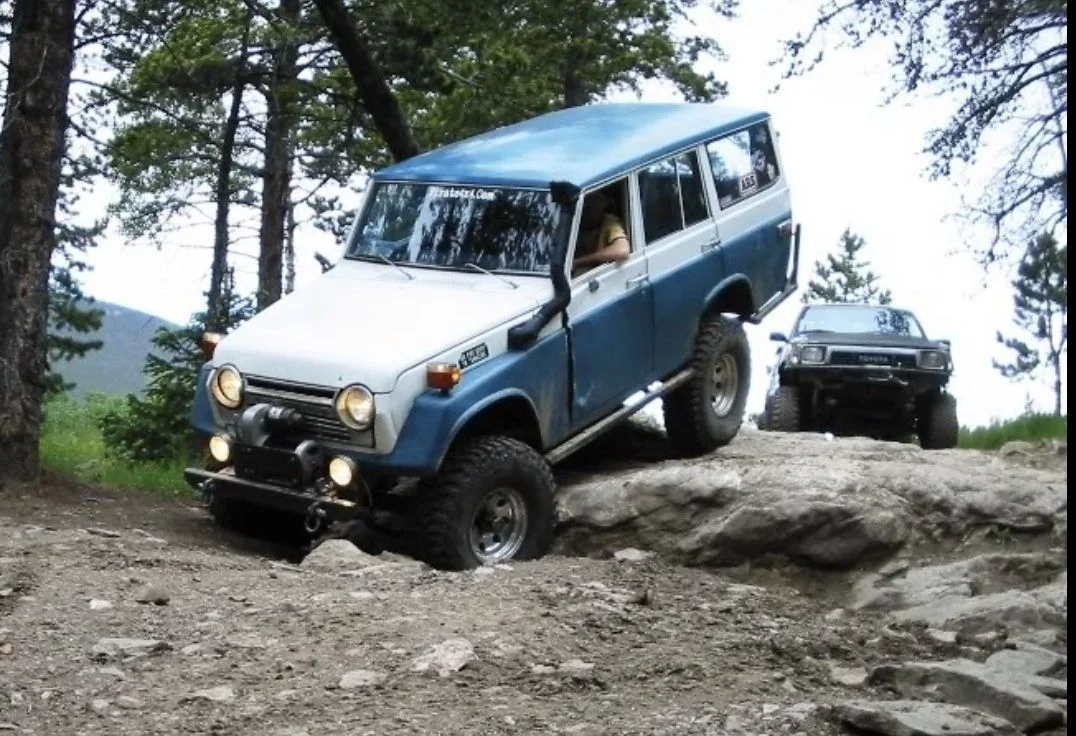

Alcan Springs, since 1982.
FJ Ben ran a set on his old rig.

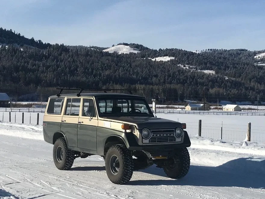

I really liked my Alcans. They rode pretty good and flexed good as well. They were set for 300lbs over in the rear and thus it sat ass high unless you had that weight in it. Personally I would have made the rears a little longer to help shackle angle and ride when unladen, but it wasn’t awful.
here next to my other pig witha man-a-fre 4” safari lift kit on 33s

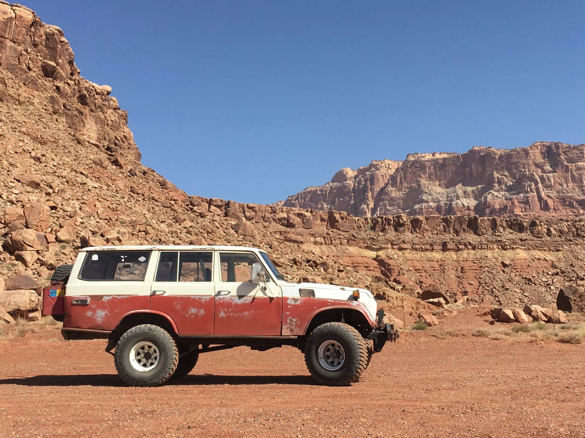

I have Alcans on mine. It rides really nice with the OME shocks. I had them built for 3" lift spring under. I did not have them built for extra weight other than a winch up front. Can't really see in this pic, but it usually has some rake to it, so we'll see if it settles once I add a little weight. It rides really nice, though I did add a sway bar after the lift which improved things quite a bit.
Someone on the forum suggested having the spring 1" longer on the shackle side which I did. I think that was a mistake and I may be getting a replacement main leaf from Alcan. The shackles just seem to tight. I have 1 1/2" extended shackles and they barely fit. Stock shackles could not be installed because they would not reach the eye of the spring. Also my truck didn't lean before the lift, now it does. I don't know what it causing it, but I wonder if it has something to do with those tight longer springs? I had a local rock crawler builder/fabricator tell me that was a mistake to have them built that way - but, it does ride well.
