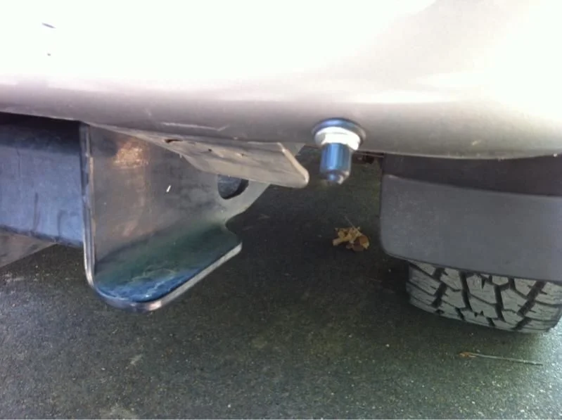

I ran hoses through bottom spring perch, to the sway bar bracket and then through the frame to the back of the bumper. I drilled through the bumper right by class 3 hitch on each side.
Pictured is 20 psi in the bags with no load. The rear is up 1" from normal ride height. I shot it up to 50 psi and it lifted the unloaded truck 2"

Can you tell me what size drill bit used to make the hole for the valve?
I did this install and I think I used a step drill bit. It doesn't have to be precise. This is a super simple install.
I used a 3/4" step bit and had to go back and do it again after the hose was ripped out. I ended up drilling 3- 3/4" holes and making a "clover" type pattern. I grinded the sharp edges down. No problems since.
Thanks for the quick response guys. Last question would be the hole size for fill valve? I'm ordering a bumper from BIOR soon and would like them to drill the holes then Powdercoated from BIOR. Picture attached.
View attachment 1658469 Thanks for the quick response guys. Last question would be the hole size for fill valve? I'm ordering a bumper from BIOR soon and would like them to drill the holes then Powdercoated from BIOR. Picture attached.
I literally just eyeballed the size with my drill bits with the hole I put in my bumper.
