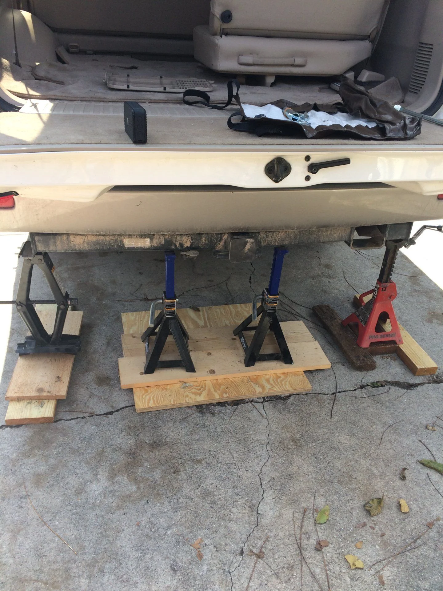

I just got this finished. It ended up being a bigger project than I wanted to get into on a Saturday but it is done. I spent 6 hours working on it. The problem I had was I started with only 3 ton jack stands, the factory jack and only one small block. This setup made it impossible to drop the axle far enough to get the springs out.

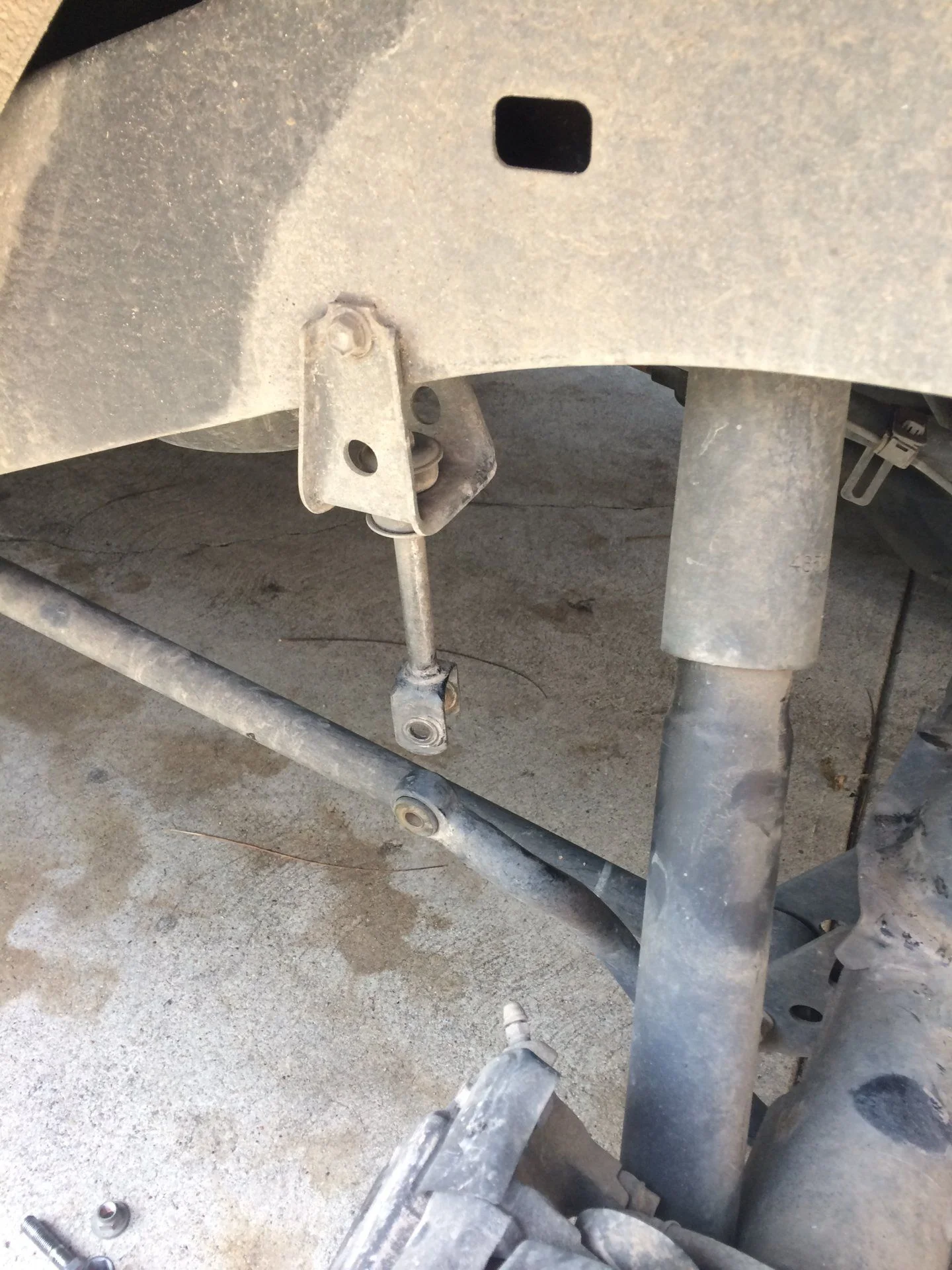

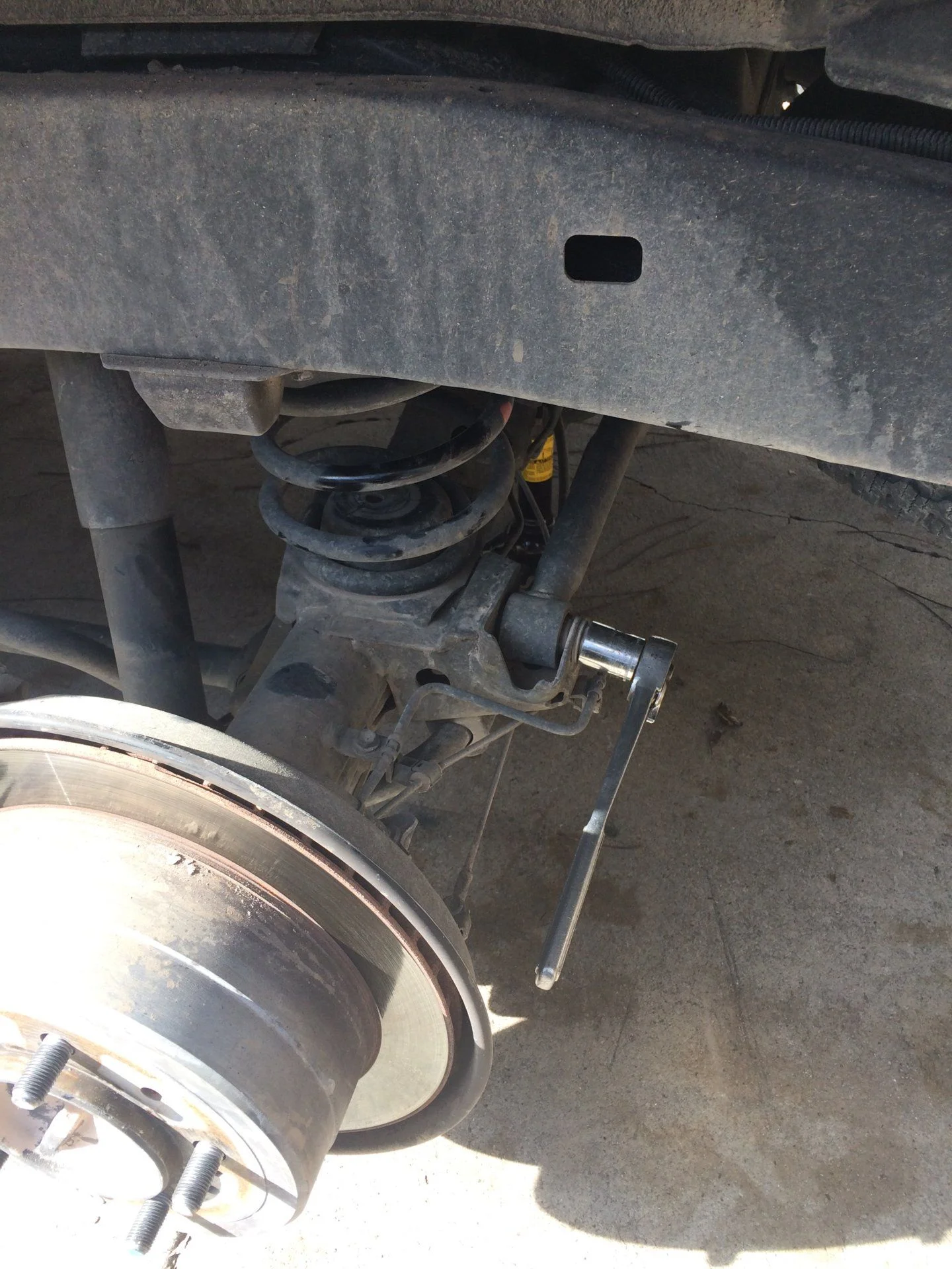

I bit the bullet and spent $95 on a Harbor Freight 3 ton jack. This jack helped me raise the truck but it still was not quite enough to make it easy. I had to use pry bars to get the springs out. There is a brake line that needs to be disconnected. It is bolted with a 12mm bolt in the center of the vehicle.
This was a 24mm socket.

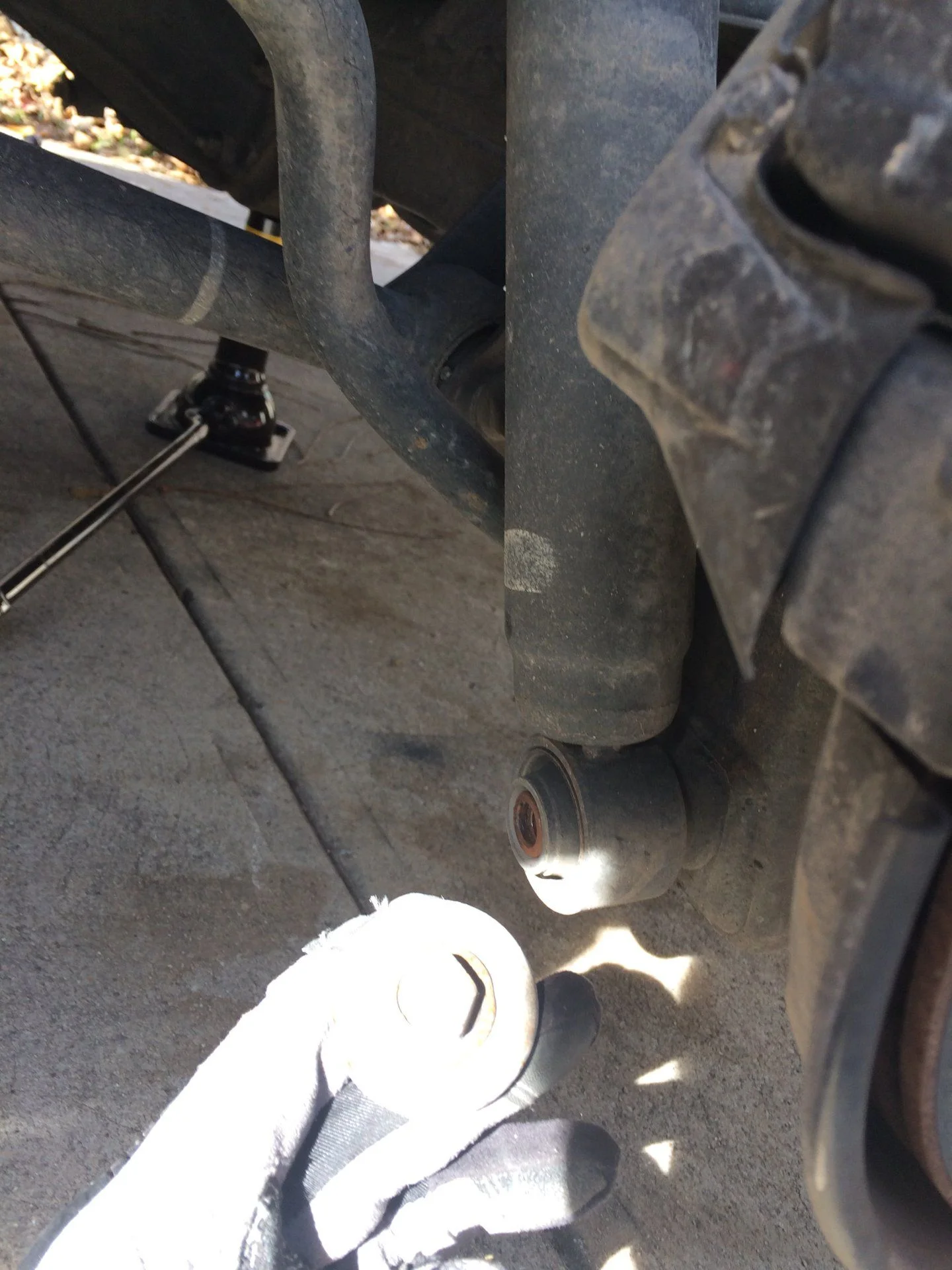

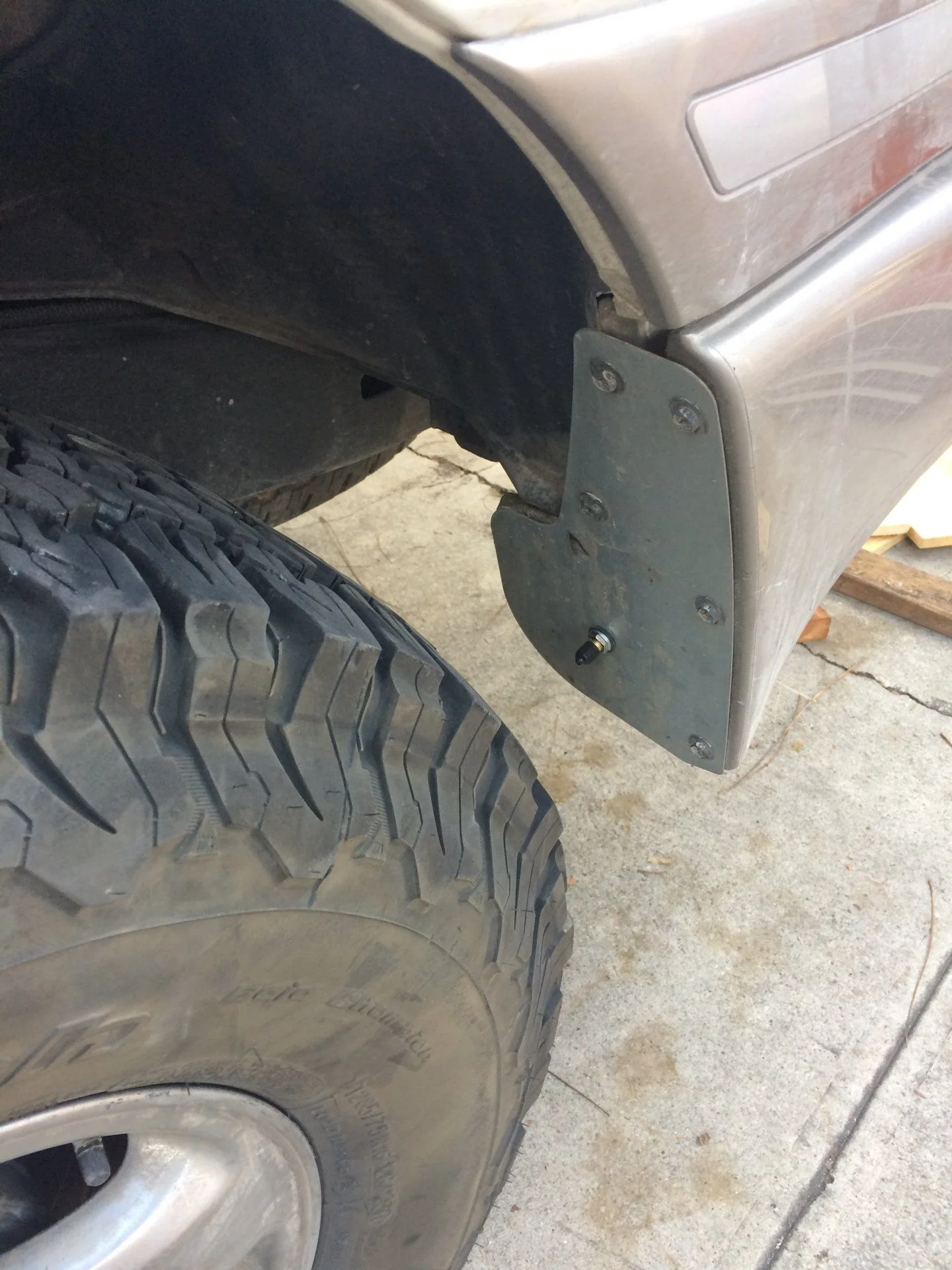

This was the other bolt that needed to be disconnected. The bottom shock bolt was pretty self explanatory. Once I got the new bags in I routed the air lines so they could extend a bit if needed. I used the @LandCruiserPhil mudflap delete kit to mount the air valve. I pumped them up to 15# and took it for a spin. It was definitely a rougher ride but that is fine. I am going to check the pressure tomorrow. The manual said 2-4# drop after install is normal so as long as there is 10# in the morning I will be happy. I will then keep them at 5# when not loaded. I would recommend a floor jack for this project as @marcfj60 cautioned. If not big blocks are a must. All in all if I would have paid someone to do it who knows what they would have done. It seems good shops are pretty tough to find and I now have a floor jack.

A note to others, 6 ton jack stands are probably the minimum for working on the cruiser. Stands are rated for the pair so 3 ton are only good for 3000 pounds per stand. It may seem like enough but when things may be out of level or shift around that loading can be exceeded. There is a post here of someone injured when their jack stand FAILED. Cars weigh about 3500 pounds, 100s start at 6500 and many on MUD are over 7000. The other thing is the height, most are too short, I have found the 12 ton Harbor Freight have enough height for most any work, plus the reserve capacity gives me more piece of mind for cheap Chinese stands.
