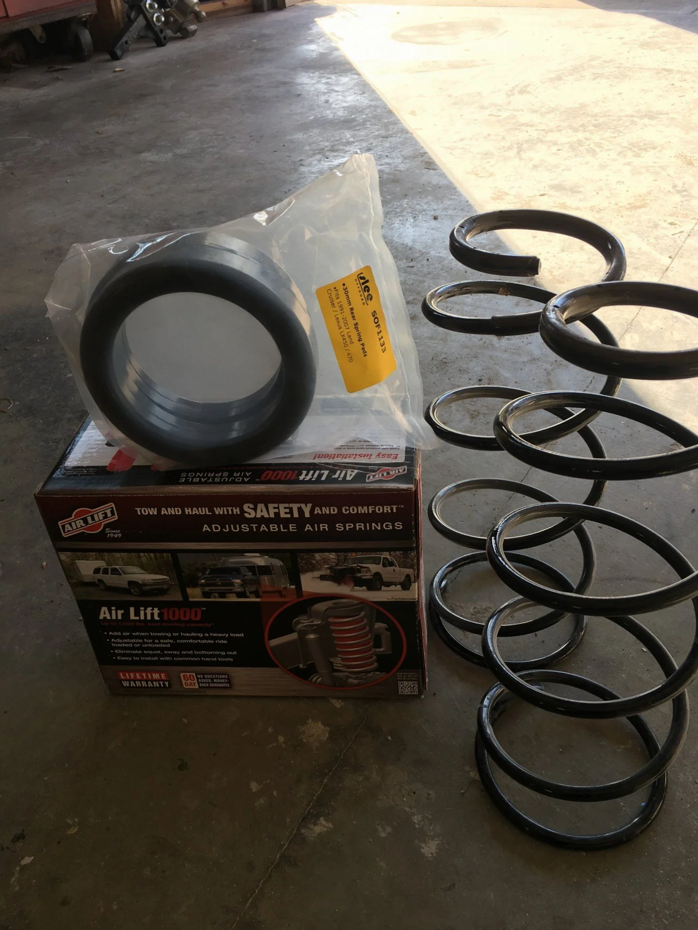

All I did was add the airbags to my '99 with 132k miles. Made a world of difference. I don't replace shocks until they stop doing their job, dampening compression and rebound of the springs. But if you've got buckets of money and want the absolute best suspension, replace all the parts.

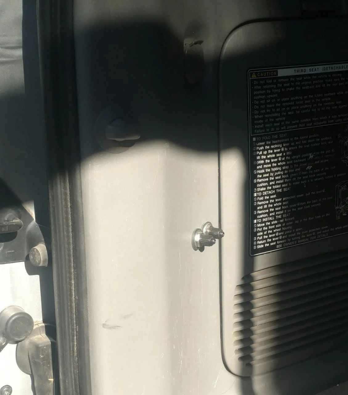

After locating the valves on the back of my 4R's bumper and seeing the dirt and crud accumulate on them, this time we put them in a better spot.
Stole this idea from @titanpat57
Man, wish I'd have looked at the last page of this thread last night! I mounted my valves on the bumper tab, left of the hitch like most others.
FWIW, I ran my lines into a single valve and mounted it high on the plastic inner fender on the driver side rear wheel well that covers the filler neck. I put a cap on it and it has worked well for a year, except that the plastic inner fender is a little flimsy that high up and flexes a little when I apply an air gauge to check pressure or and air chuck to fill it with air.

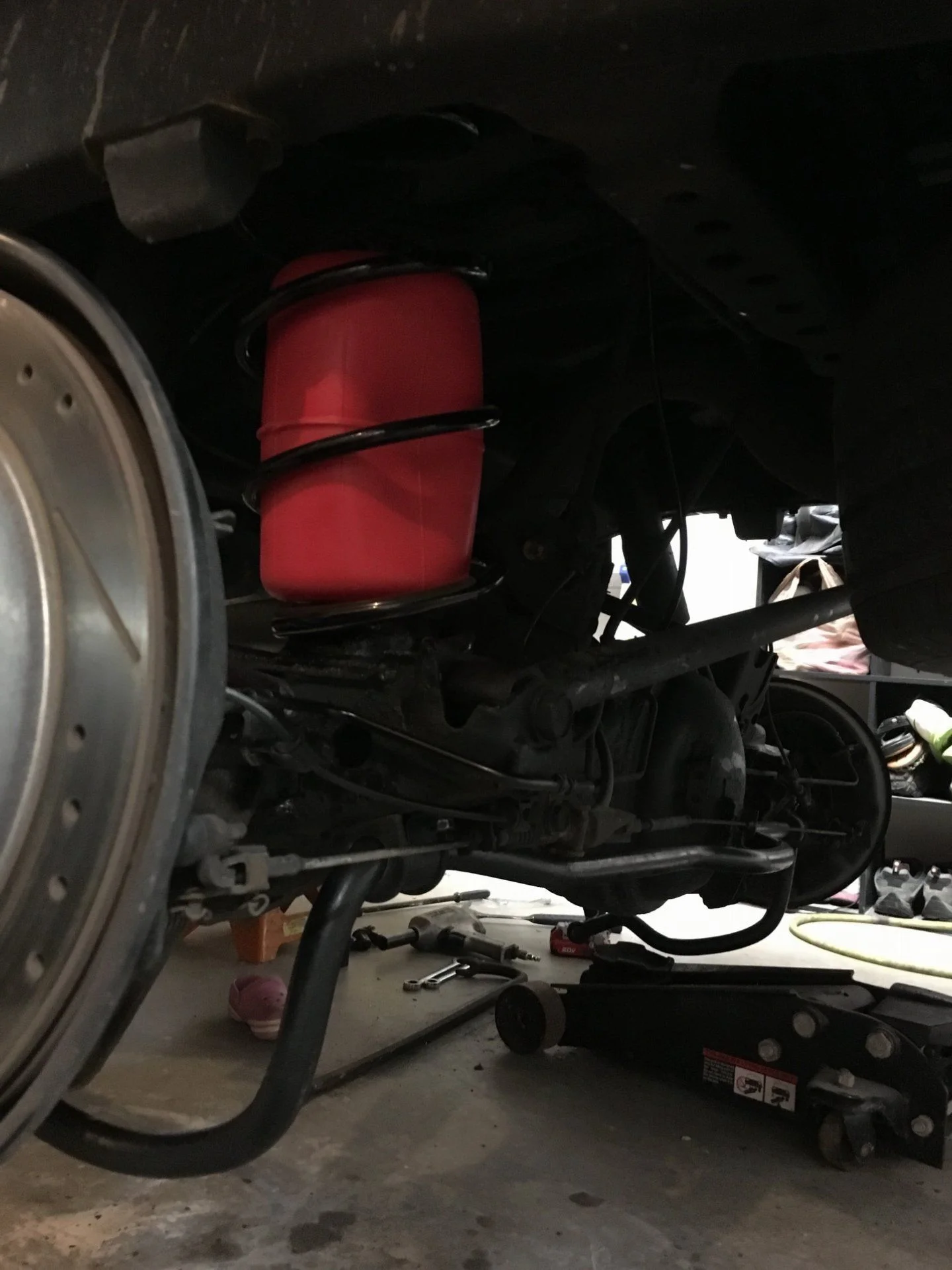

Finally got mine in and connected. Ran individual lines and routed them here. Wanted a clean out of the way install.
First run today with some gear in the back, I'll let y'all know how it goes.

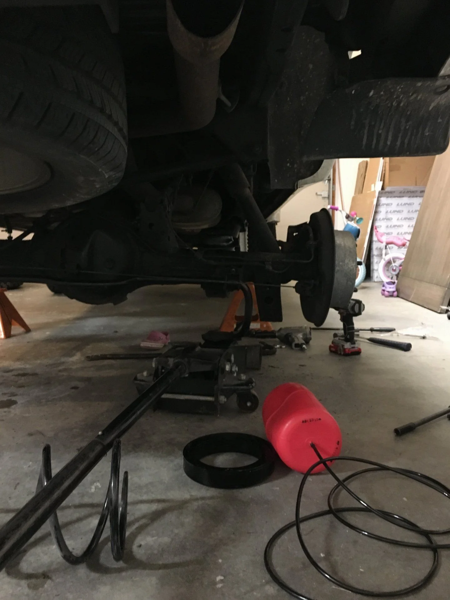

Ok...this super easy air bag install went to hell when I tried to put my AHC shock back onto the lower mount. I've searched, seems like maybe you don't remove your shock if you have AHC and just use a coil compressor to remove the coils?
Most searches on "install AHC shock" are about replacing them. Anybody help me out?
