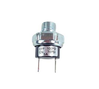

Pressure switch that goes into the compressor manifold. This one is sold by ARB but I "think" any brand will do. This one switches on at 70psi and off at 100psi. Some ARB compressors come with 135/150 switches. And there are choices in between but 70 is the lowest I would go. It will noticeably activate slower though.
The one that the arb brushless compressor is a 135-150 which is great for tires but a lot more pressure for the lockers.
You can run that pressure switch and then do an adjustable pressure regulator on the output for the rear locker. Again, I don't have any evidence this will reduce the chance of blowing the internal ARB locker seals but it sounds logical.

Yes, the one that comes with it is a pressure switch, max 150psi. The adjustable device is a pressure regulator and that would just go between the ARB air control solenoid and the ARB locker. There a different style of regulators... I don't know which one would work best in this application.
The standard ARB compressor shuts off at 150psi. The lockers can handle 150psi according to ARB. You asked what can be done to avoid problems and I said, amongst other things, lowering the pressure might help.

Yes, they are designed to work together but the ARB mini, which is specifically for Air Lockers uses a 70-100psi switch probably due to the limitation of the compressor itself. The ARB twin compressor uses 135-150psi switch.
