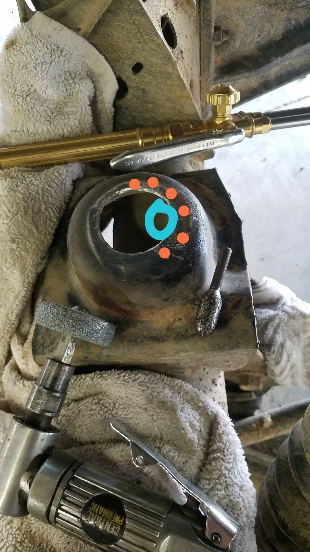

Any reason for the type hole you drilled or Ins it just 3 step bit holes?
The shape was the result of not wanting to have to cut the hole bigger, for a third time without going overboard. And yes, it ultimately was the result of making two holes with the step drill and then cutting out the little bits that remained with a Dremel.

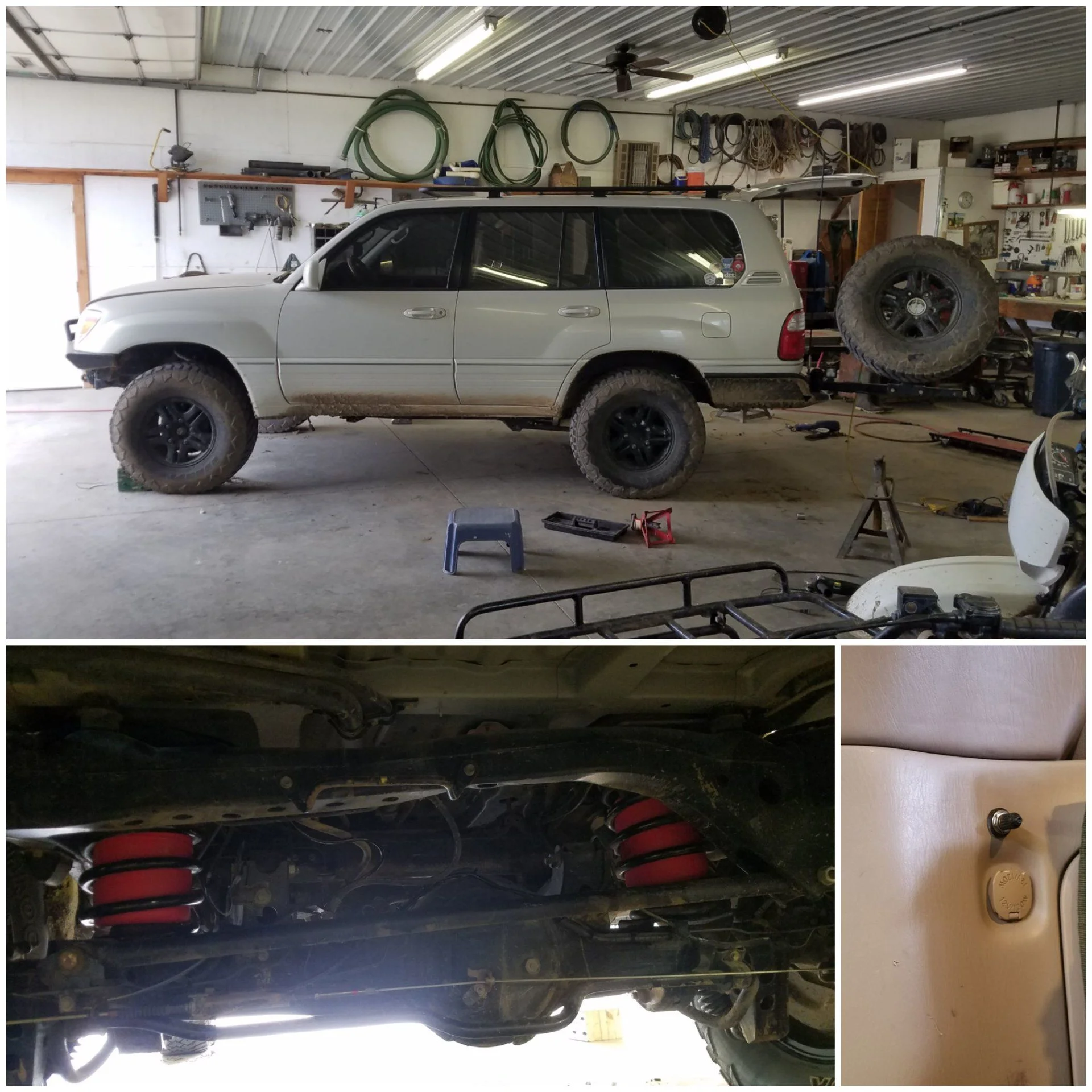

I installed the Airlift 60728 kit on my 2006 Lexus LX470 w/ AHC.
I didn't drill out the spring perch, nor did I remove the springs to remove the bumpstops. I put my vehicle on a 2-post lift at my buddies shop, unscrewed the bump stops, sprayed them with a bit of silicone lube and was able to slide them out from the inside of the springs.
I then installed the airlift bags and zip-tied the air line to the nipple (the included clamps didn't hold as the bags move around and eventually work them off). The system works fairly well and was an easy install, but recently blew a bag.
I'm considering running Timbren bumpstops and Non-AHC springs instead of the airlift bags - they're a solid design but I'm not totally sold on their durability when off-roading. I don't tow a lot of weight, but I do put my 701 Supermoto on a hitch tray which equates to about 420lbs of tongue weight. AHC is able to compensate for the weight even with a JB RTT and Pioneer roof rack, and the truck loaded up with goods, but it won't go into High mode. That's why I decided on the Airlift system, since I assume ride quality would be affected if I run non-ahc springs without an additional load.

I jumped the gun and torched out my lower hole, de-burred it, and sat spring and bag on. Ha, done deal... nope. The air fitting was against the wall of my cutout.
I should have listened to the forum and step drilled the original hole. I had to re-torch the orange area. I did run 5/16 rubber hose out of bag fitting for 10" secured with hose clamps.

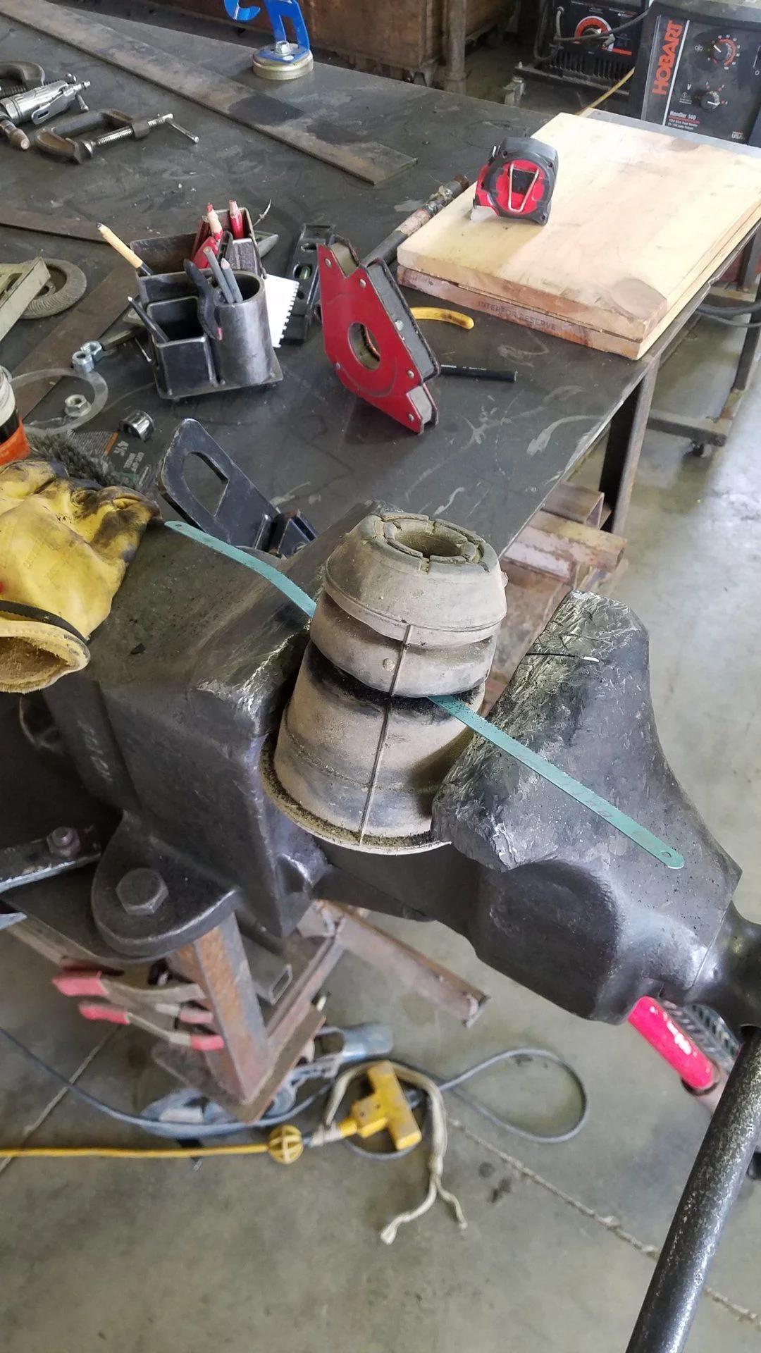

Hack saw broke, so I cut my bumps by hand.

Why cut the bump stops? I thought the instructions said to remove them completely......
That's what I did.

I wasn't sure about the bump stops, some guys pulled them and some cut them. My kit was #60747

The instructions specifically state to remove the bumpstop for the 100 series - these bags are shared by a Jeep and they are required to re-use the cut bump stops. My 80 series from the past required installation of the cut bump stops - maybe that is where the confusion is. I almost reinstalled the cut bump stops myself before checking the installation instructions and catching that message.

And what can happen is when they go back in place will pinch/break the nipple on the bottom of the bag (or at minimum you will have to redo the airline). If you have the metal drilled out enough that might not be a concern with no pressure... but if you only drill/wallow out the recommended amount, especially if you don't get the hole at the exact right spot :bang:, then you may have issues. - The higher the pressure the better the nipple stays in the center.

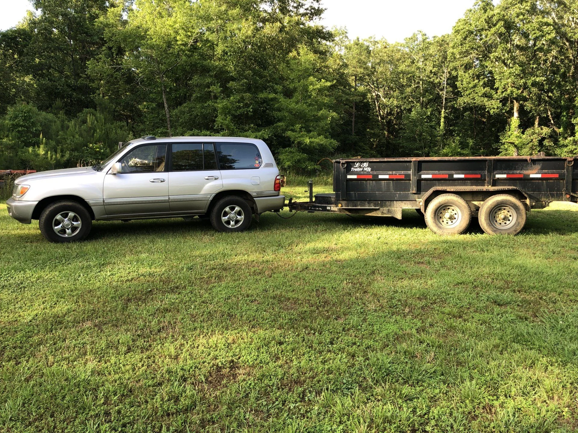

I’ve been using my son’s stock 2001 as my tow vehicle and I need to go get 5 yards of dirt tomorrow again so here’s to making the old stocker a bit safer with that heavy load
25# and the trailer did not squat it at all (and it empty is super heavy)
