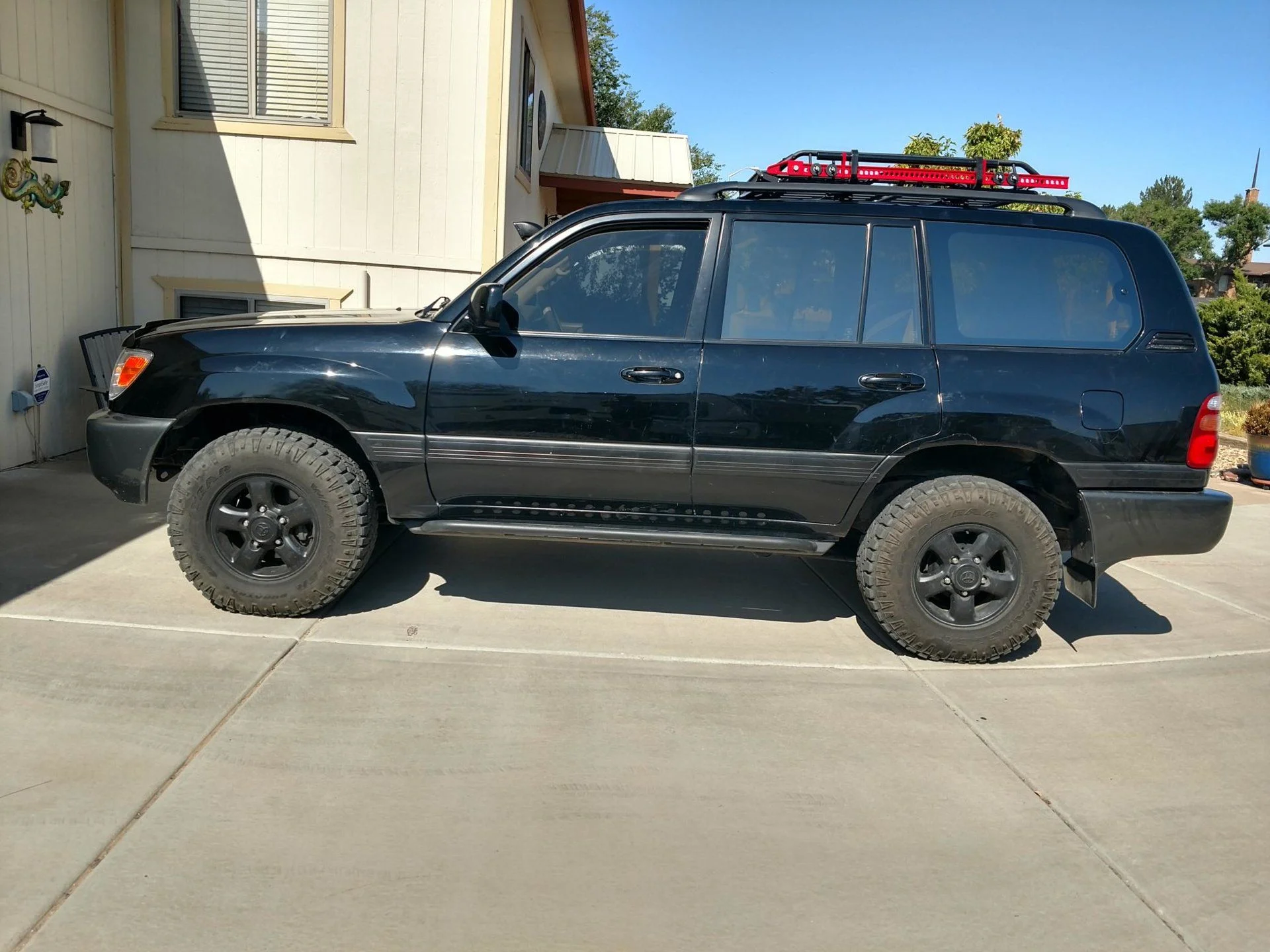

I like how my cruiser sits around town, but when loaded with 2 adults,3 kids, cooler, recovery gear and dog its dekar'd. I have entertained the 30 mm spacers in the rear but then won't be able to fit in the garage. If I go this route and keep them at 0 pressure and when doing a weekender etc. put some air in them, or do you just keep a low volume in them all of the time, then increase with load?
You can see how it sits mostly loaded (no extra water/fuel or spare parts).

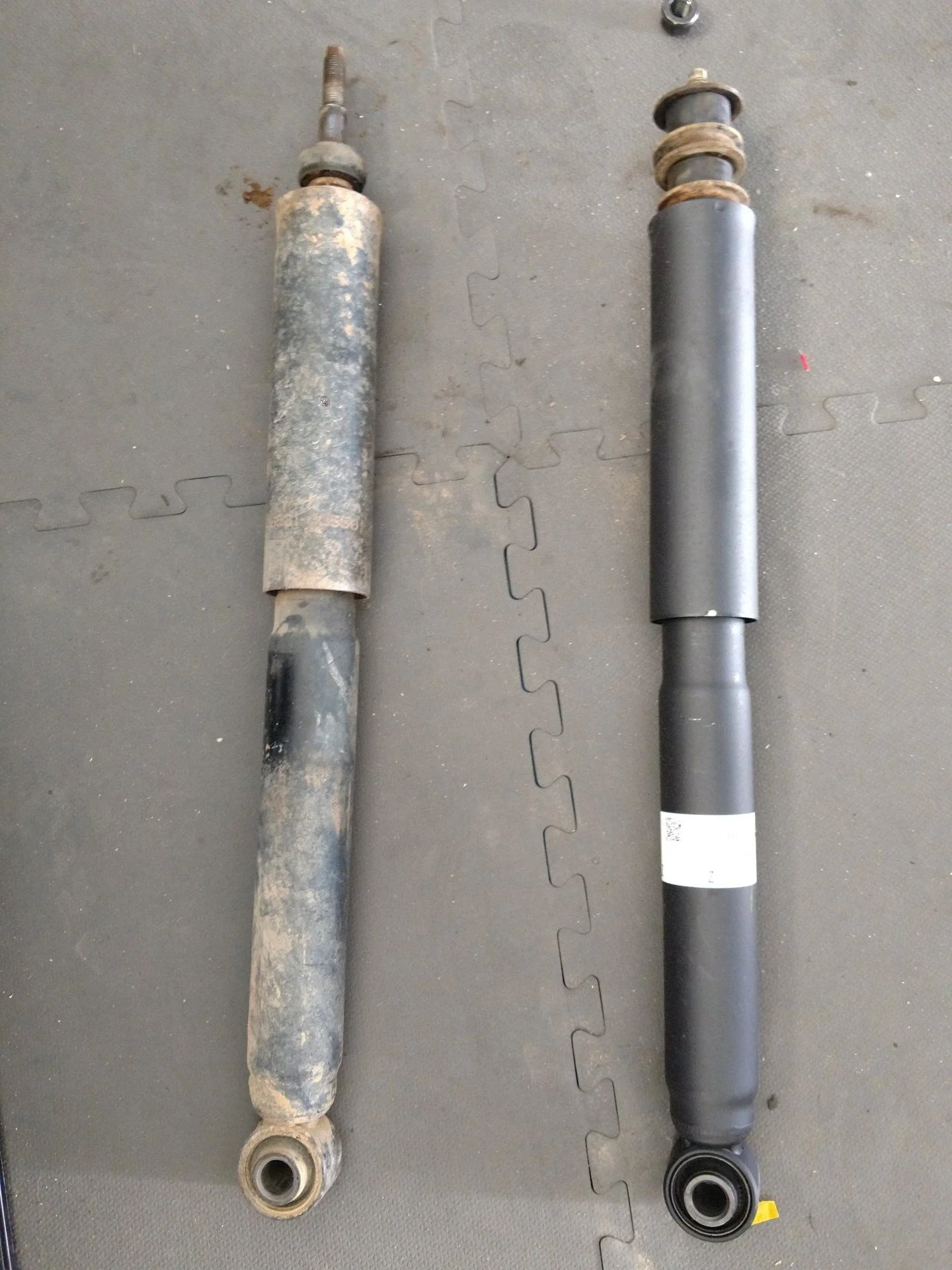

I did the install and replaced the OEM rear shocks at the same time. 22mm ratcheting wrench is crucial. With little to no air in the bags the rig is sitting about an inch higher. Would the new shocks do that or do the springs need to settle again?

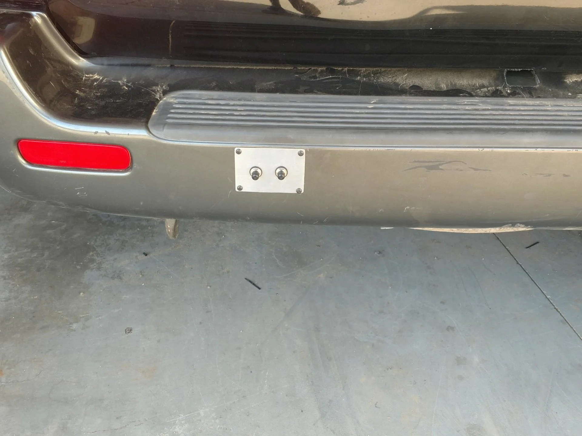

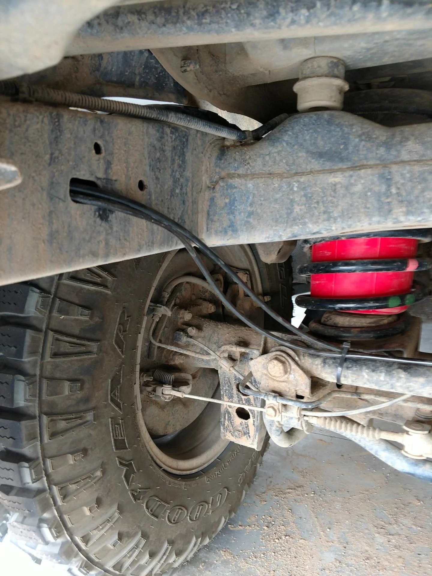

I did some different routing and placement for the valves.
P/O had jammed into something and put a big hole in the rear bumper, and the cover is broken in several lower mounting places. I had previously somewhat smoothed it out with the heat gun. I thought I would just cover it with a homemade brushed SS plate and put the valves through the rear bumper. Not for everyone I know but it fixed an eyesore for me and the valves are super easy to get to with the OBA.
I miss-drilled one of the holes so I will probably make a 2nd plate, but you get the idea. Maybe a matching one on the other side with an air chuck quick connect.
Routing through the frame
This is what it looked like before.
I thought the same and I am pretty sure that everything is seated well. Do the coils need to be rotated a specific way in the buckets? Didn't seem like it to me. For comparison here is the old shocks and the new.

Could be you just needed some time for the (coil) springs to settle in again? I am always a slight bit taller just after putting load back on the suspension.

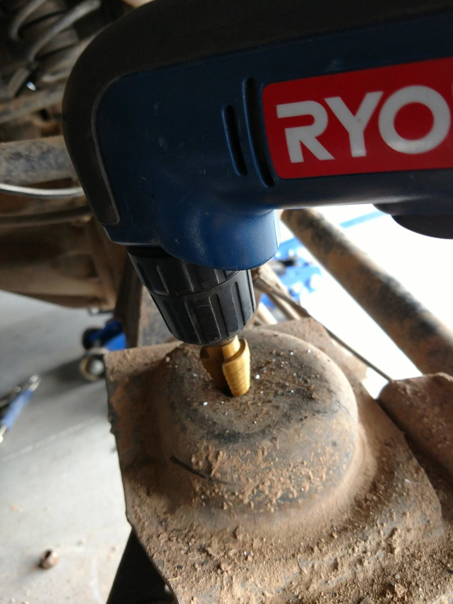

I'll be installing my bags this weekend. A brand new step-bit just arrived in the mail today and we're ready to roll. Still debating where I want to stick the valves at.
Thanks kind of thinking so. Tagged the trim on the garage last night but not today. Good luck, articulating the suspension is pretty simple if you do it right. Step bit made quick work of increasing the hole size. A right hand drill helped as well. If you have not gotten some yet 6 ton jack stands are well worth the investment.
How big did you end up going on the hole size? I'm on my third go round to get the hole big enough to keep from pinching the bag nipple. Currently hole size is 1" but I need to either go bigger or take a die grinder to a section to make it oblong.
I went to 1 1/4".
If you're worried about the hole pinching the bag nipple you could probably install a rubber grommet in the hole as additional protection. Not this exact one, but you get the idea: Amazon product ASIN B000BO9DSA
