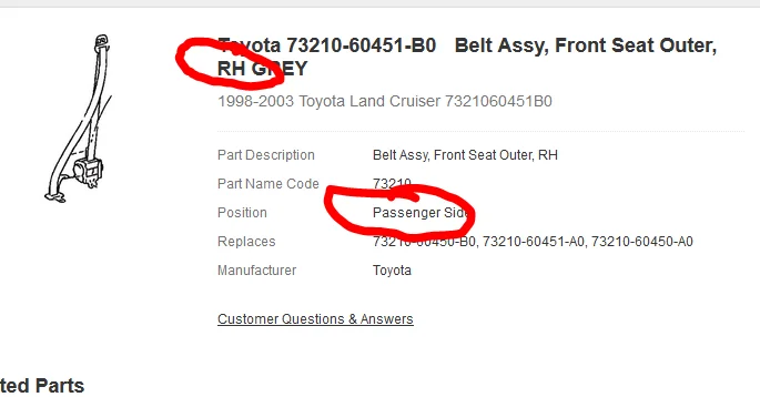

This was the only thread i could find as close a match to my issue.
I have a blinking SRS Dash light and the dealer gave me this part number. Can someone confirm if this is for passenger or driver side?
73210-60451-B0
I need this info so i can send the correct belt to this company. Anyone used this service? How was your experience?

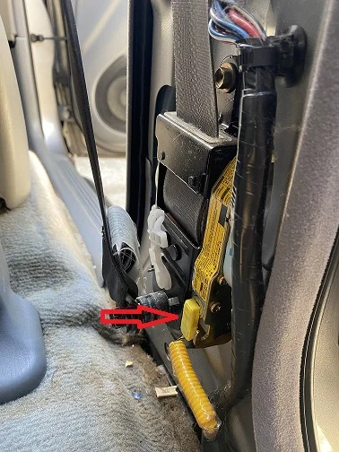

Anyone know how to disconnect this yellow rectangular connector? I dont want to force it and break it.
