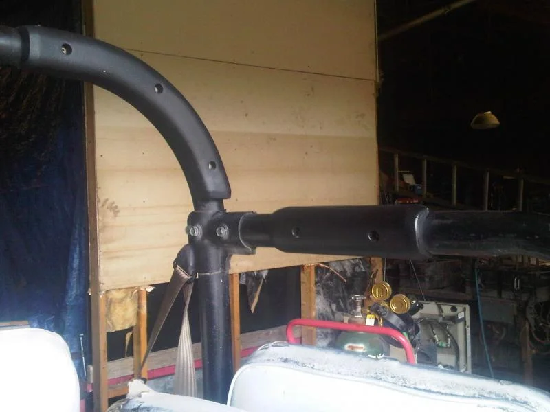

ROLL BAR PADS ARE DONE!:clap:
Put them on the web-site (Click link on my signature line to go directly there). Shipping is included in the price (No PO BOXES PLEASE).
CANADA GUYS: If you guys in Canada want them I am shipping them USPS but contact me with your shipping address (No PO BOXES PLEASE) prior to purchasing and I will let you know how much it will cost. I just did a shipping cost for Priority Mail to Calgary, Alberta Canada and it was approximately $25 USD more than shipping domestically.
Here's what it looks like mounted. By the way don't pay attention to the background or the ugly fj40. We had a flood in 2007 and the factory was 8' under water as you can tell by the oil/mud lines on the wall.

fjgoober, we just installed a SCCA compliant roll bar in my son's Miata along with the padding. Padding has to meet SFI 45.1 safety standards (standards for specialty/performance automotive and racing equipment) and that padding is VERY stiff.
The SFI group was asked about the stiffness "It is about as hard as cured salami. Way more dense that the styrofoam that is inside a SNELL helmet, and several times more dense than normal rollbar pad. Is this right?" to which they replied "Your question was a common one when the SFI Technical Committee on Roll Bar Padding first developed the Specification 45.1 for this product. However, please be assured that the roll bar padding you have purchased is appropriate protection, and it actually needs to be that hard to absorb the energy and reduce injury when a driver’s helmet impacts it."
As such, Sea Knight's preference for a harder pad also speaks to the ability of it to absorb energy during impact. I can attest via personal experience that the comfy foam padding we used on roll cages back in the 70's didn't do squat when you actually did cartwheels out into the field!
Um, people still race fj40s? with factory roll bars?
I've been in several roll over accidents (never in a FJ) and they were both due to loosing control on gravel road, both under 30 mph, and both times the vehicle flipped over relatively gently.
I also broad sided a dump truck in a wrangler one time, and my buddy in the back seat who didn't have his belt on smacked his head into the roll bar.:doh:
So, my basic belief is that the jeep style padding really doesn't help much in an accident, outside of that it softens the blow of you smacking your head on it (with no impact of the vehicle on anything). And most people are better drivers than me, so they won't be actually using there roll bar very much, it's something they're just banging there heads on, which is what that soft light foam padding is good for.
If they are serious about ending upside down or flipping cartwheels, they oughta maybe weld up a full cage.:steer:
