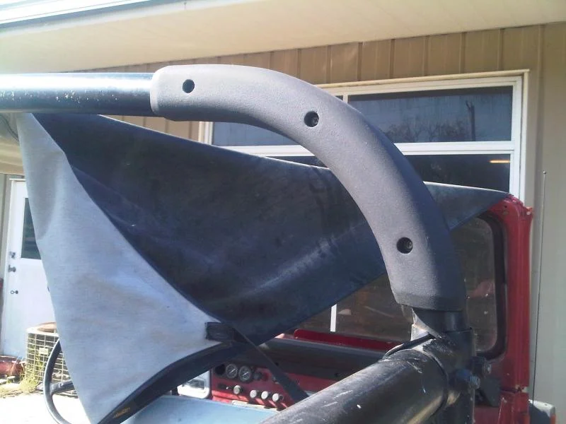

I finally had time to play last night on the roll bar pads. Cranked out a prototype. Still need to texture the molds and work on porting, mold flow etc. Also need to play with the reaction as this prototype was way too dense. If your head hit this it would be like hitting steel! But all in all was very pleased with the results. Holes match up perfectly to my stock "show"/roll bar.
1st picture is back side of pad the other two are mounted. I should have these tool ready for production next week and hopefully on the website by the end of the week. Lots of irons in the fire though.
Great to see these coming to fruition! Definitely a market, I need some.

Thanks Longbow,
I am hoping to have them available for sale towards middle to end of next week.
Will probably sell in sets first as I will texture tool similiar to dash. I won't be able to match texture of OEM part. But then again looking at how the tool texture turned out on the prototype I may not futher texture the tool. Just Kicking some ideas around.
