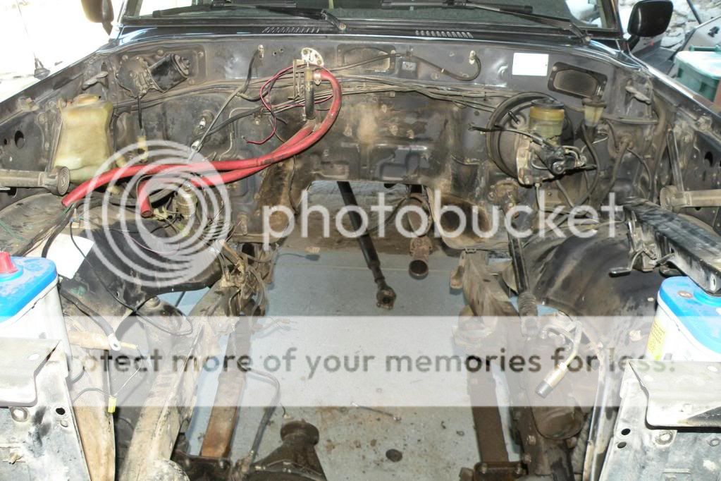

I started on a Tuesday morning at 8:00am and began tearing out the old engine and tranny. Here it is with the old clapped out chevy ready to be hoisted out.
And here is a nice empty engine bay!
Man, Soa cruisers are high! I probably should have lowered the front end by taking the tires off but it came out fine.

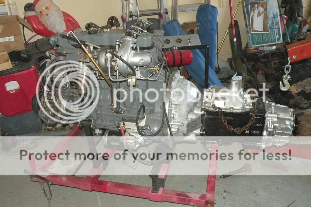

By the end of the first day (1:00AM in the morning) I had the old engine out and the new tranny and transfer bolted to the diesel and the Downey bell housing and ready to go in the next morning.
No jokes about my wifes plastic santa!
