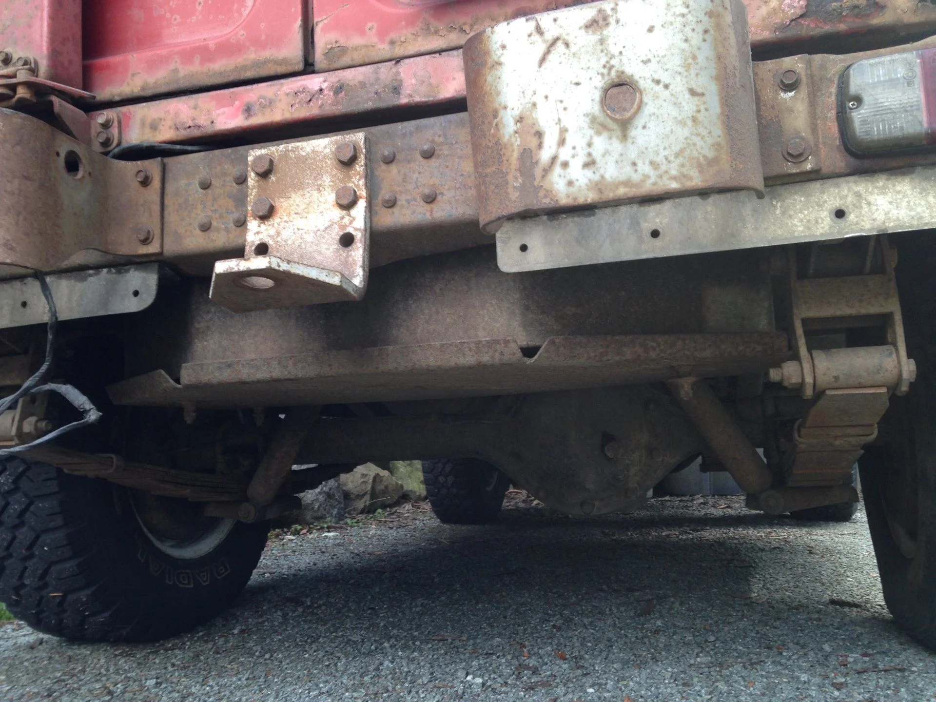

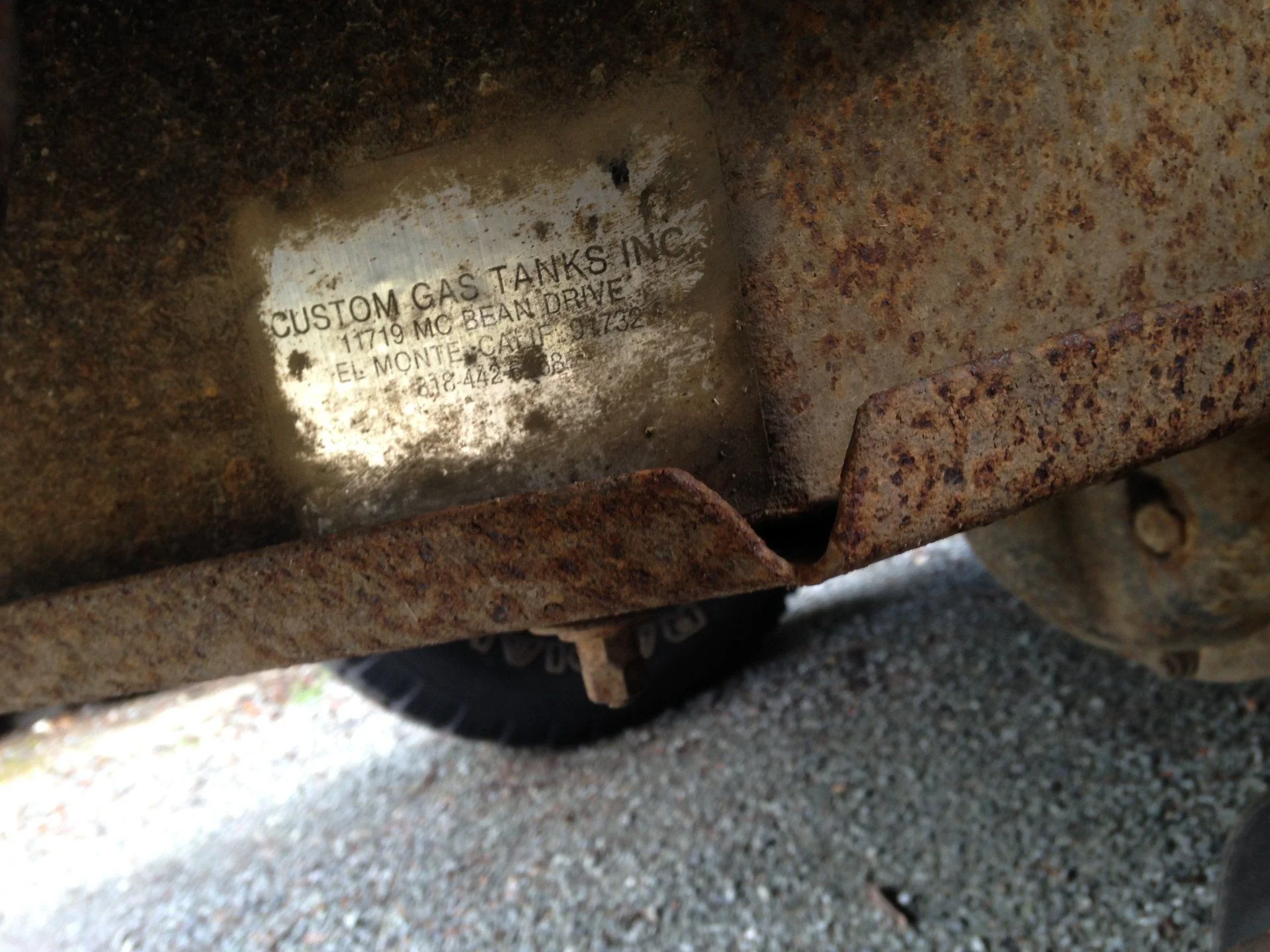

Since your spare tire is on the drivers side on your 1977, you could run my 22 gallon rear fuel cell under the body (behind the rear axle), then run a filler neck out the back side (above the emblems) instead of out the side of the body.
Huh? You got a photo or link for this setup?
Check out ebay #253347498138, but Mud members do not have to buy on ebay, I can just send you a paypal invoice, plus save you 50 bucks since I won't have to give it to ebay- - -easy deal.

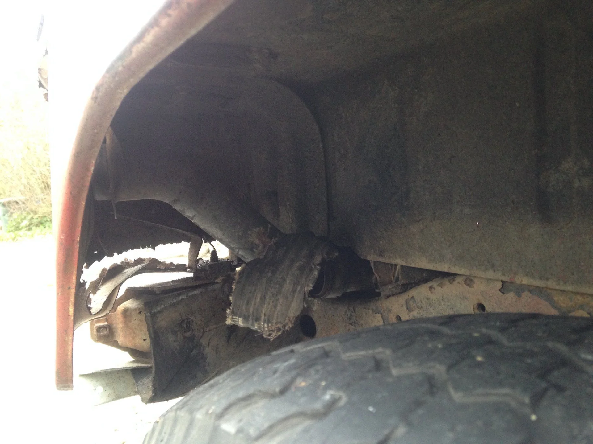

I've just been wrestling with my dual tank setup. Similar to Downey's, but not as nice. The filler neck goes through the rear passenger wheel well. When I bought the truck and had it truck flat-towed to my house, that wheel had a flat and shredded on the highway, taking the filler neck out with it. It was a real mess, also further bending the already rotten sheet metal in that fender. Picture in the well shows how the filler was hanging on by the literal thread, the rubber sleeve attaching it to the tank was shredded. When I replace that fender with fresh metal, I'm going to relocate the filler neck out the back, and shield whatever may still be exposed in the well.
As for how to connect two tanks with one filler; much of the problem stems from the two tanks being at unequal heights. I think it will take some creative plumbing and fuel pumping between the two, including giving thought to how the return fuel from the carb will be routed (which tank will get it?).
You can read how I dealt with the return line problem and issue in my own stumbling rolling "restoration" thread. The link below should jump you to the right page, but you'll need to scroll down to that fuel routing topic:

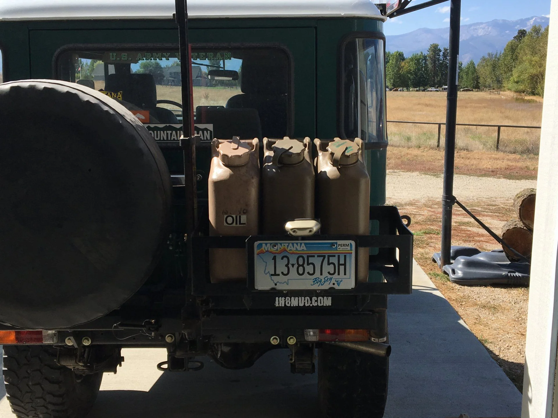

Carry a full tank under the seat, when you run low fill it back up with the extra fuel cans from the back. If I’m going somewhere that I know I’ll pass the gas station I opt for the cooler, if I’m going way back in the mountains I’ll carry almost a full tank of extra gas.
I agree, carry as much fuel as you can in the mountains. I have an old USMC jerry can that has been mounted on my 40 since the late 90's plus if needed, a 6 gallon plastic can as well for a combined 11 extra gallons. Haven't ever needed more fuel than that to date.
I have toyed with the idea of adding an extra tank but came to the realization that it's much harder to give your wheeling buddies a little gas on the trails with a permanently mounted tank. Plus I do enjoy making them fill the can back up when we reach civilization.
