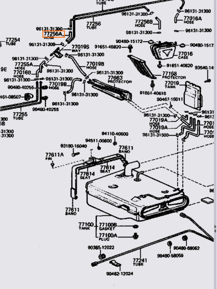

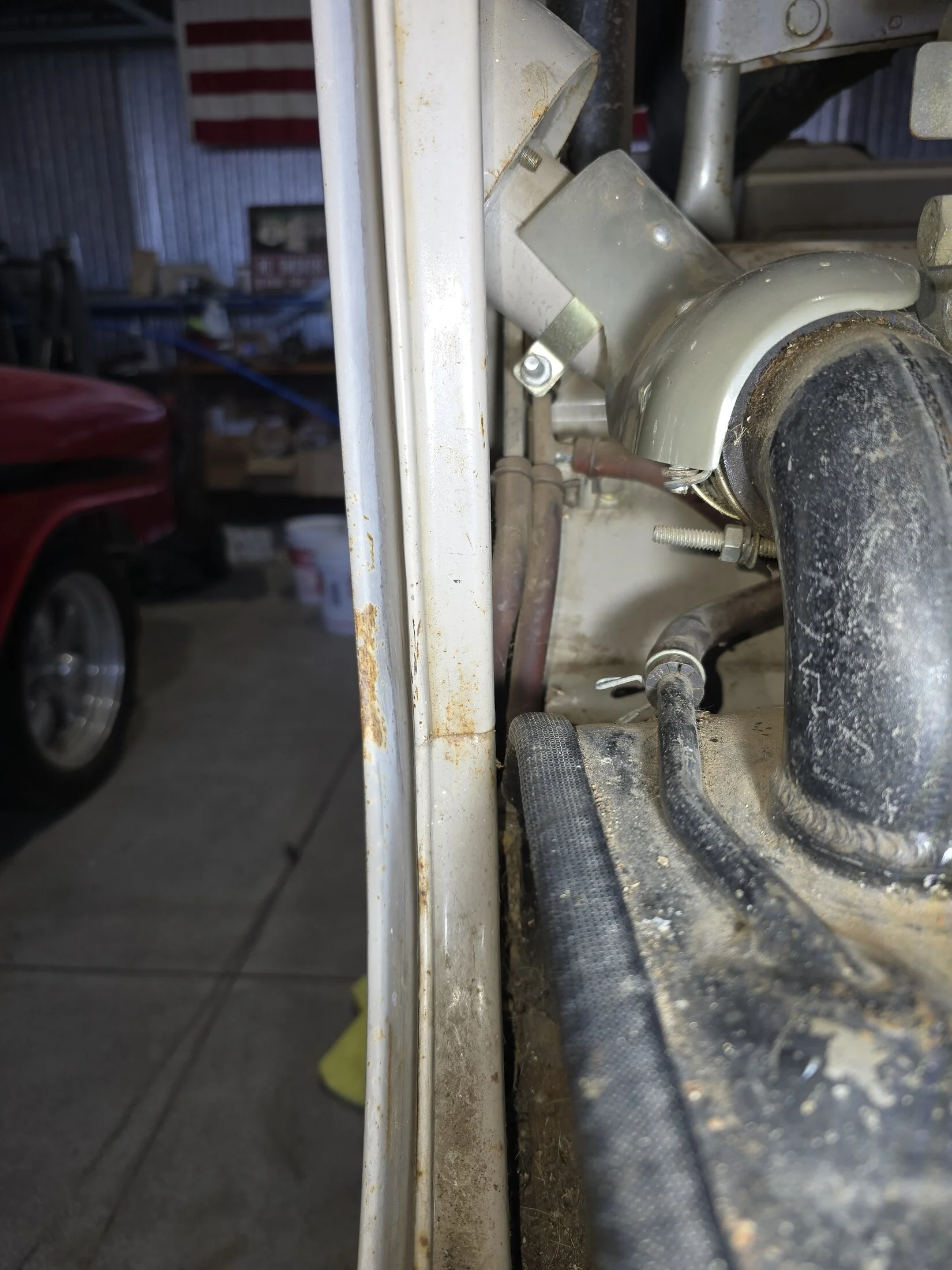

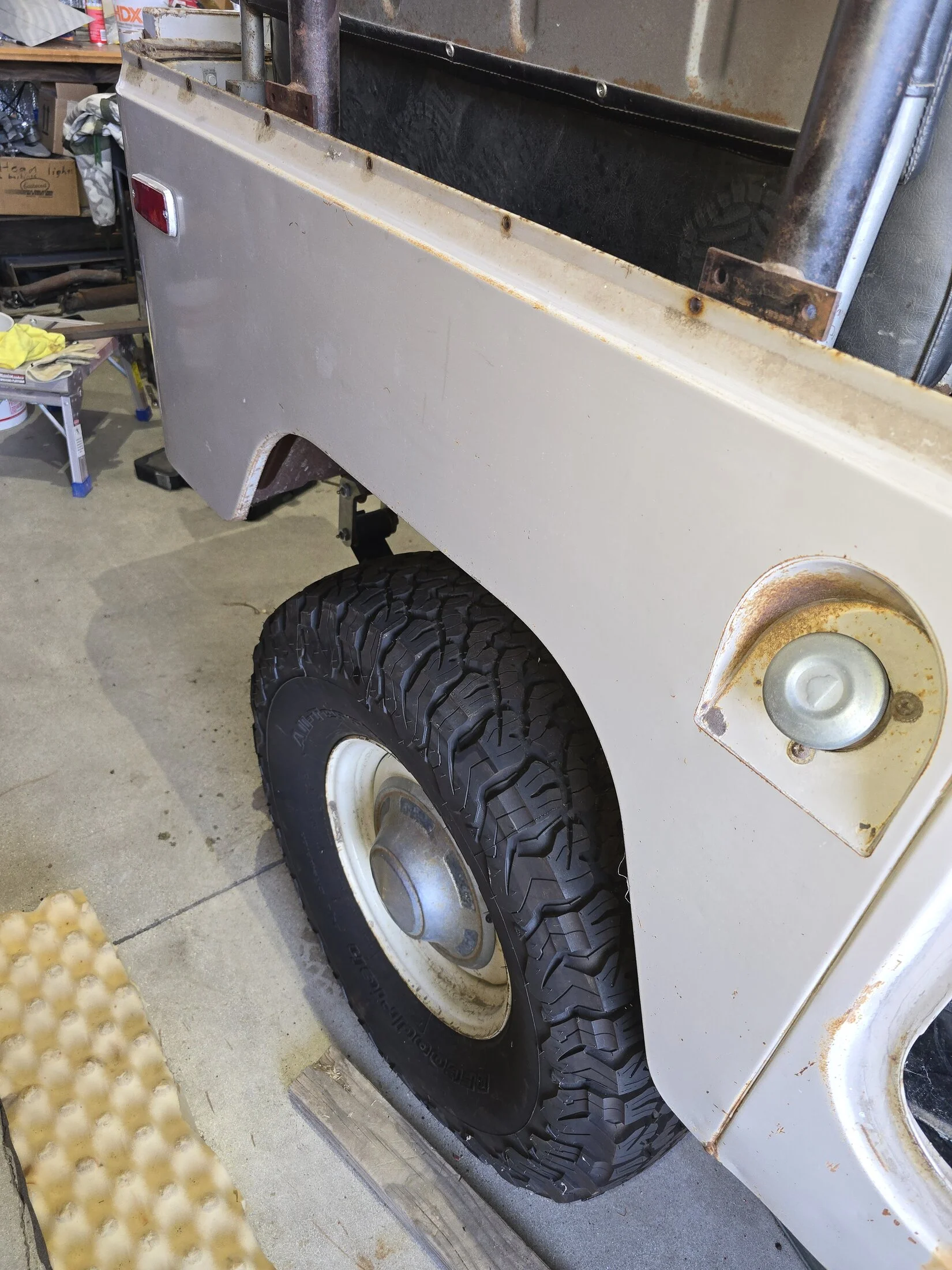

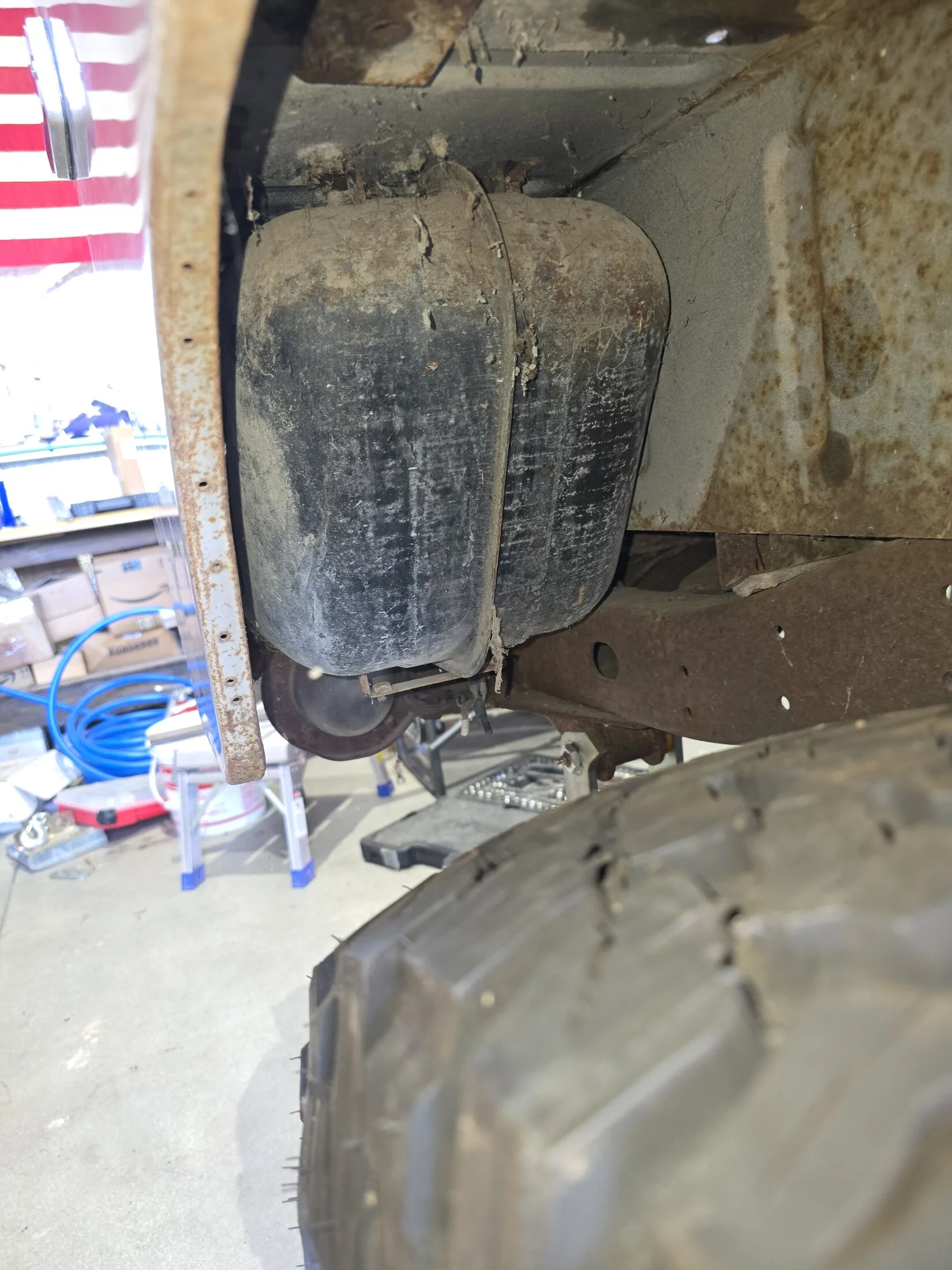

I recently noticed what appeared to be a cover plate behind the rear passenger wheel and fuel lines running behind the same side rear folding seat. My 1971 FJ40 only has the stock passenger side filler tube. To my novice eyes, the installation looked rather clean and appeared to have been done a long time ago. I plan to crawl under it next weekend and trace the lines. Did the dealerships install such items? If anyone has any information on this setup, I'd love to hear it.

my 6/70 has it-OEM. I assumed it was emissions related to the vacuum canister. I recall there are soft & hard lines that run along under the pass-rear seat and under the pass floor board it (reddish in your pic) The other (hard lines) travel up the firewall on pass-side in the engine bay across the top of the firewall to the drivers side where 1 line drops just before the master cylinder and connects to underside of air intake and the other travels over mc to the vacuum switch valve on the drivers fender. (It's not another fuel tank though)
