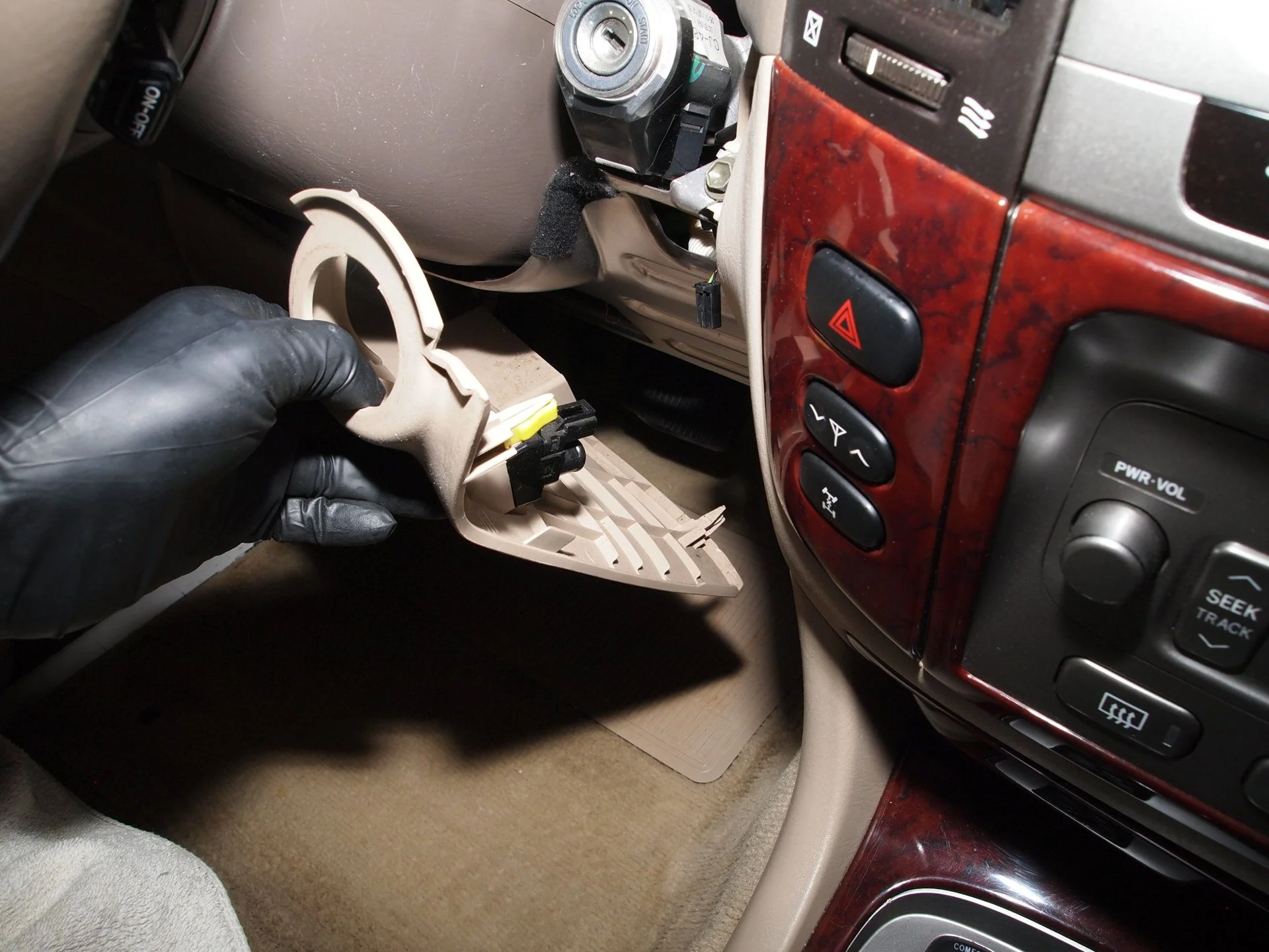

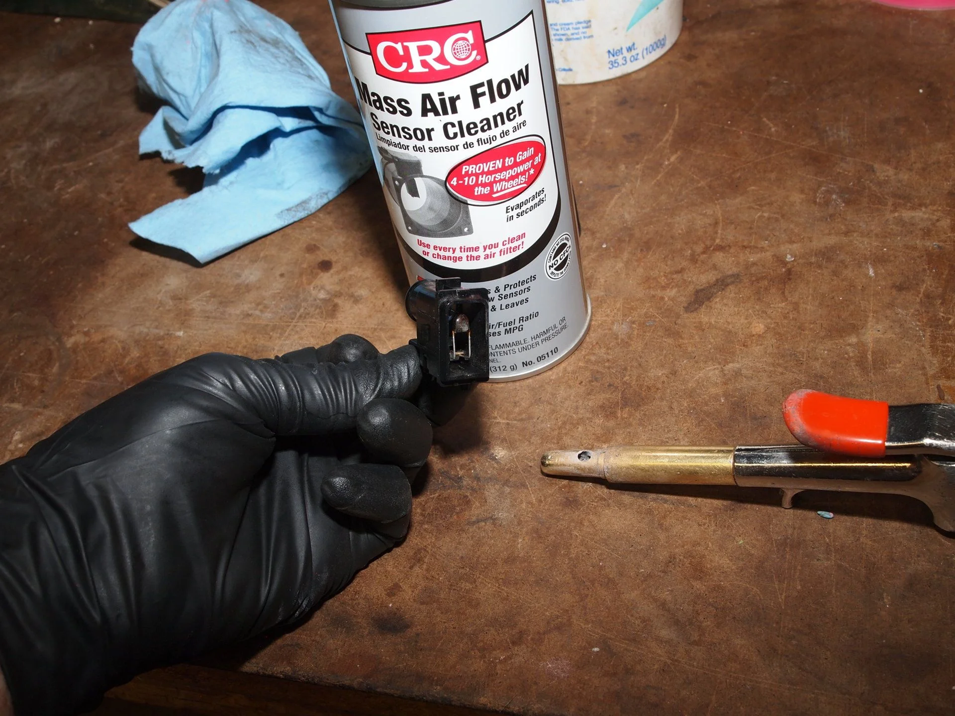

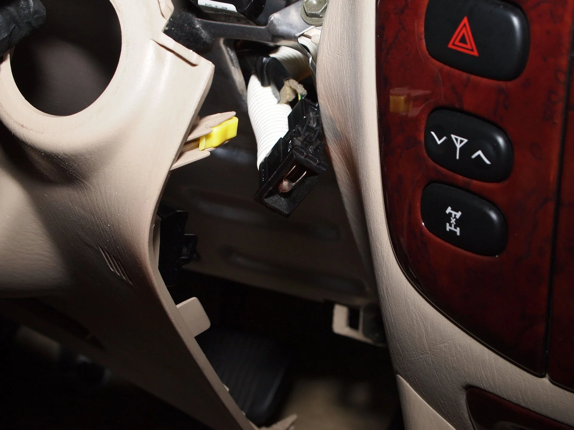

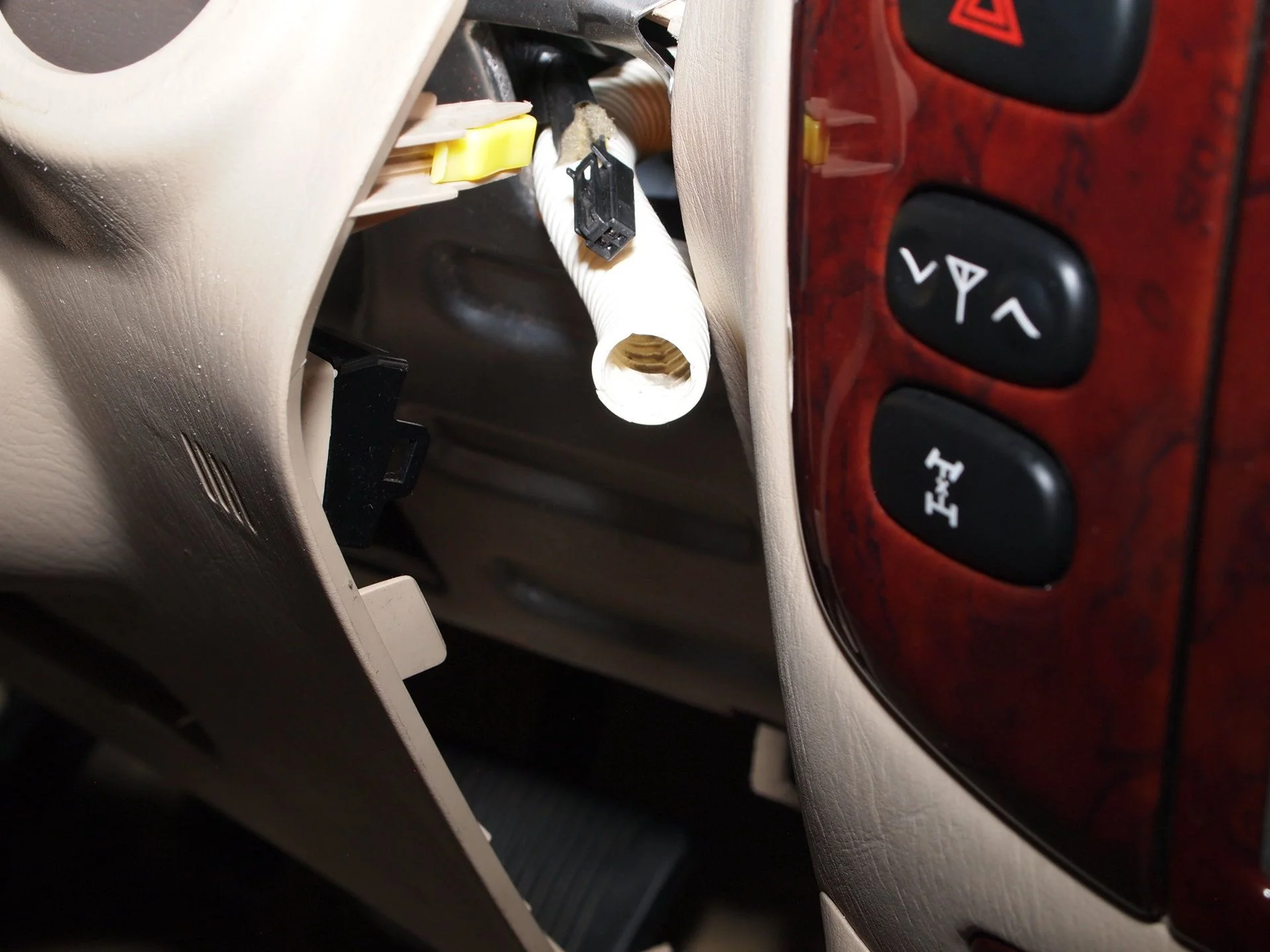

See if AC works on max cold. If so look to see if cabin hose and sensor are connected just below IG key. You'll see 1" squar vent below IG key. Behind is where these reside.
Max cold AC has not worked, but I was going to check that sensor out as well. Thanks for the photos 2001LC!
