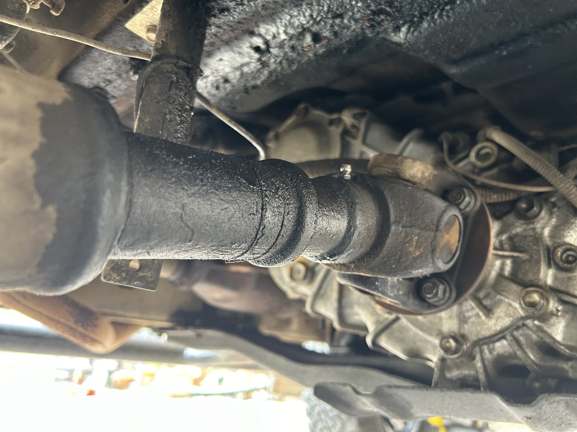

I just pulled the 4* shims out while the driveshaft was getting worked on. It is a pain. If I put them back in I’ll be about 3.5* out of parallel, flange wise.
I wish I would’ve waited to pull the shims until after I put the refreshed ds in. Oh well.

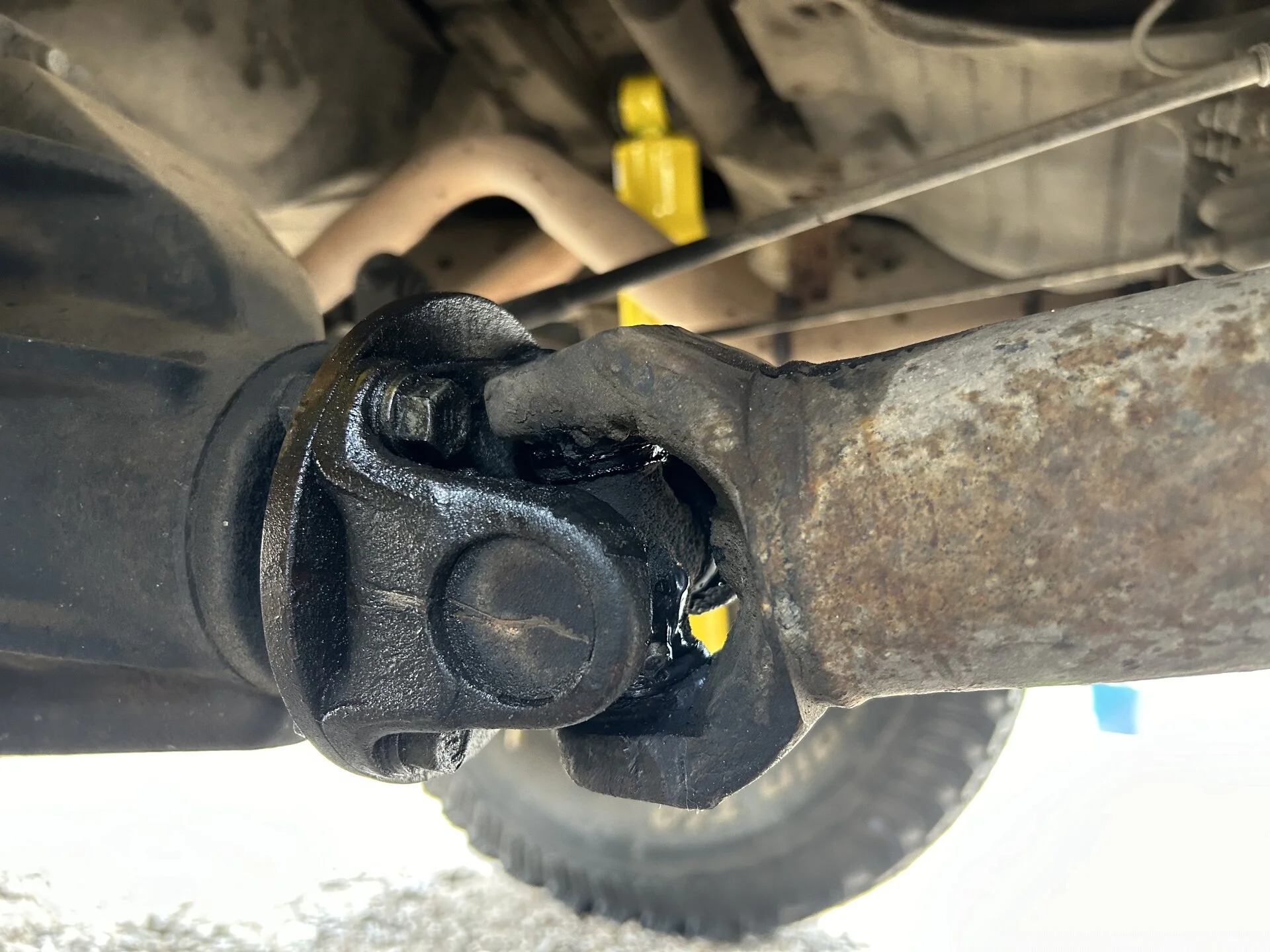

Phasing?
So now I’m wondering if the phasing is incorrect.

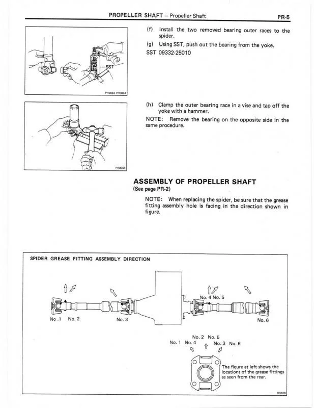

When I pulled the ds the yokes were 90* from each other, as I’m researching I’m finding the opposite is true according to the FSM. For some dumb reason, my copy of the FSM lists the Propeller Shaft section but it’s greyed out and not included.
How it was prior to pulling.
From another thread
I really thought I read that they were supposed to be offset but here we are 🤷🏽
Looks to me like they are 90 degrees out of phase. Assemble the drive shaft exactly as the manual shows; that is the correct phasing.
It’s how it was in there so I Ass-u-me’d it was correct. I’ve just 90’d them and about to take it for a spin… wish me luck.
Sweet Jeebus on a popsicle stick. Unsurprisingly, the vibration is gone. Never ever trust a PO’s work.
On the plus side, I know a butt ton more about driveline geometry.
The angles just need to match, if tcase output flange is 2* down, diff flange needs 2* up.

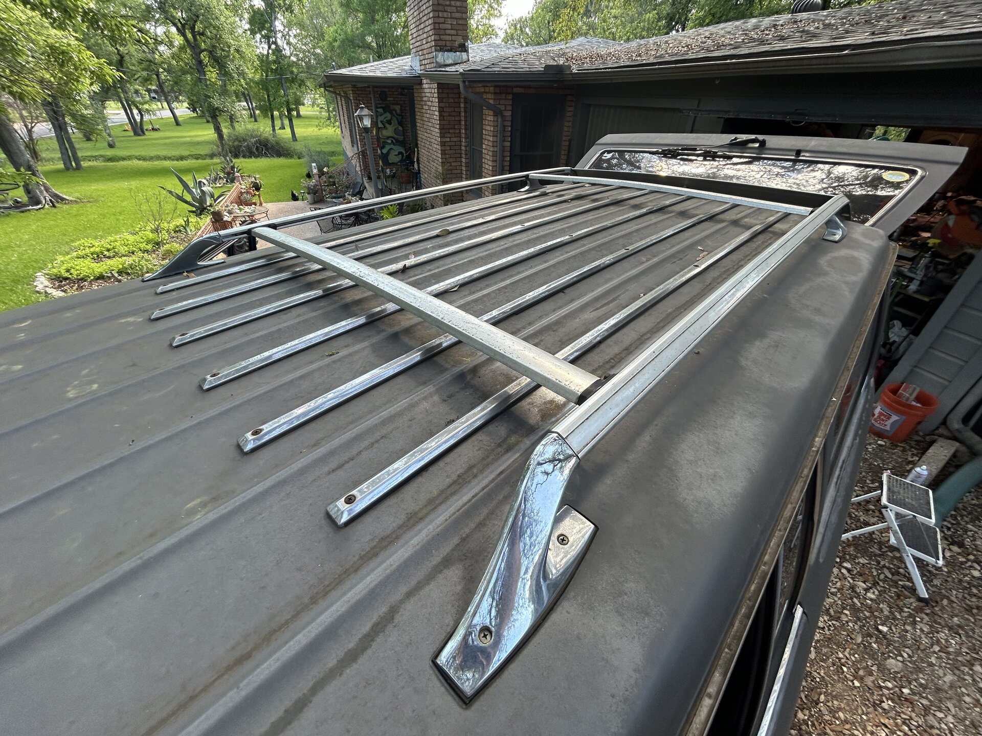

Is there any desire for this original roof rack? Believe it was a dealer installed option.
I’m going to pull it off and RTV some stainless screws in and eventually install my ARB Baserack from my truck topper.
As far as this forum knows, there are no 'factory' racks - only generic dealer-added junk. Likely valued as scrap, unless you know a desperate person with an Oldsmobile station wagon.
If you caulk some screws into the holes, keep an eye out for rust forming under the caulk over time. UV light is hard on caulk.
I only meant original to the truck and did say it was likely dealer installed.
I’ve used UV resistant urethane sealant on aluminum travel trailers and RTV on the roof rack on my truck. Both have held up for many years. I would never just “caulk” the holes.
Ok, so one vote for: no one would want this

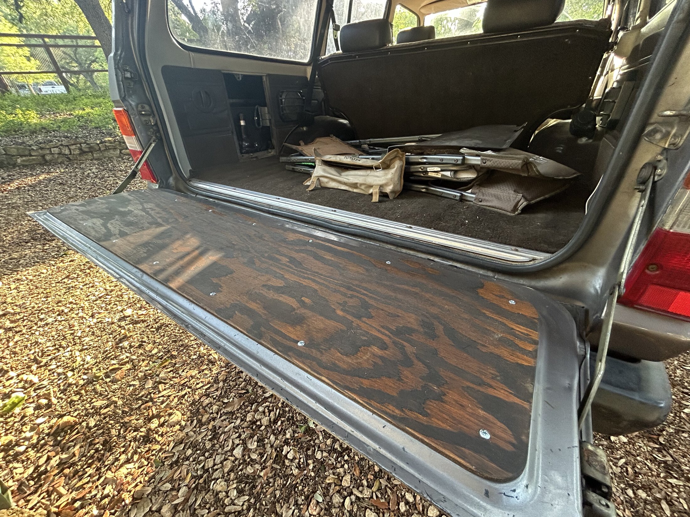

- made a quick and dirty tailgate cover out of 1/4” ply. The carpet was fine but the masonite was pretty floppy and cracked. Used 5mm rivnuts in the existing holes. Worked great.

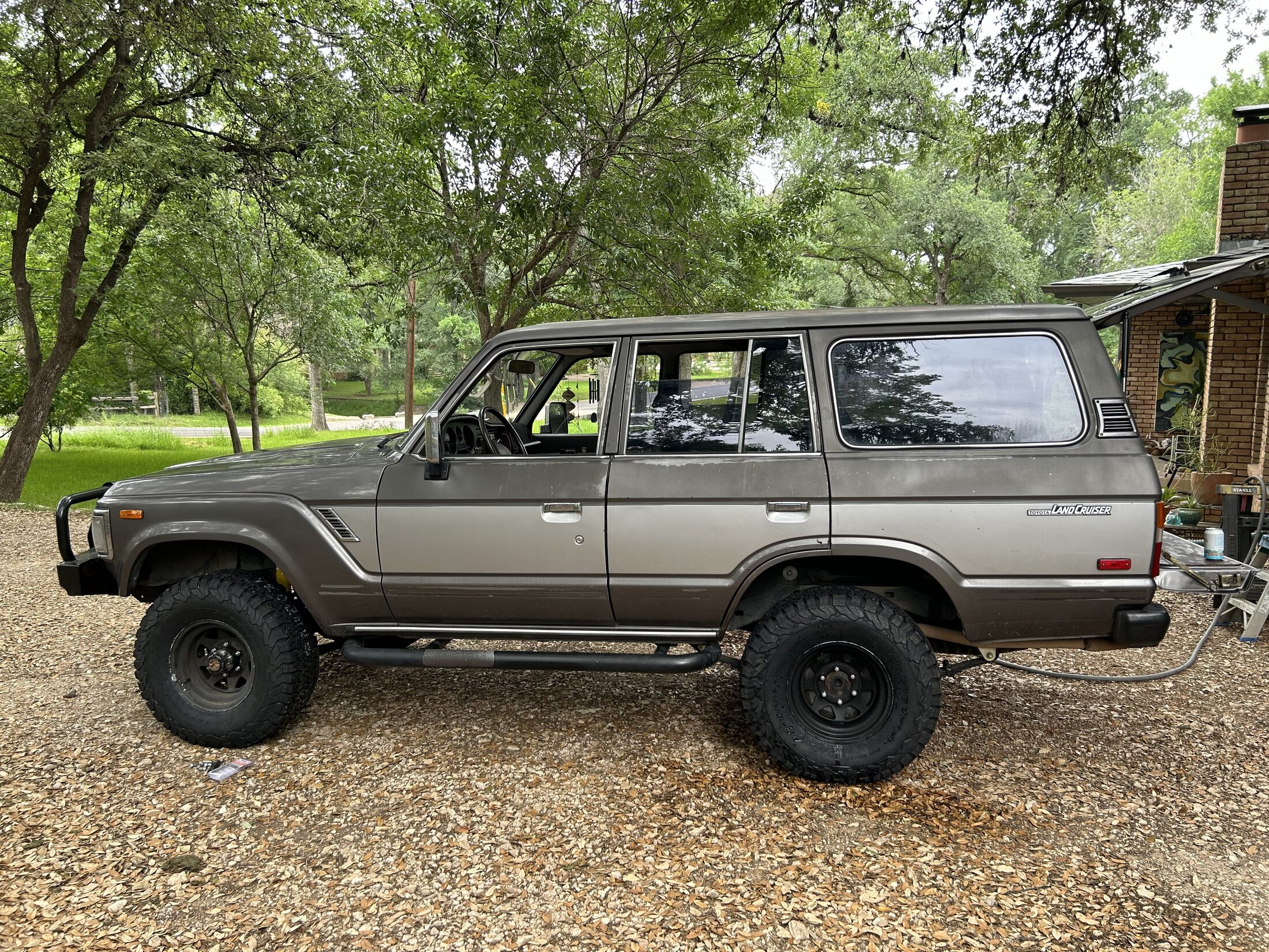

Well, she’s finally mine.
We worked out a great deal based on the condition I picked her up in.
Just got back from the title place getting registered and TT&L all done.
We’re now legal and bonded together by the state.
Now I can change her name from Billy Goat to something better and more appropriate.

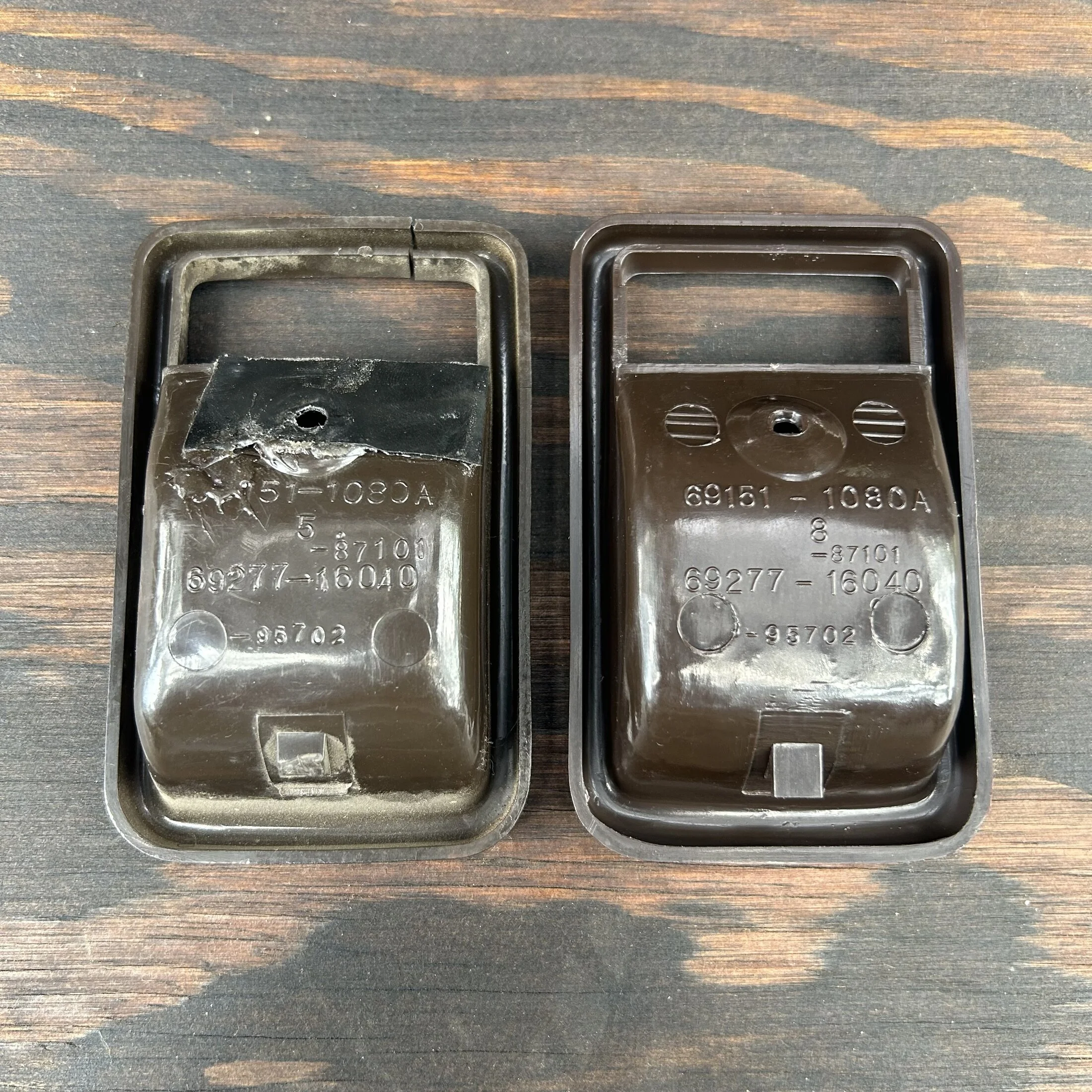

Interior door handle scoops
A couple things. Billy Goat is now Paul.
I never loved “Billy Goat”. It was the PO’s name and in my mind never fit.
Here is where and why I arrived at Paul.
1) the keys I received had “Paul’s key” stamped on the door key.
2) my grandfather’s Americanized middle name was “Paul”.
3 I officially took ownership of this LC on my grandfather’s (RIP) 100th birthday.
Paul it is. And to keep with the theme, “A Girl Named Paul”

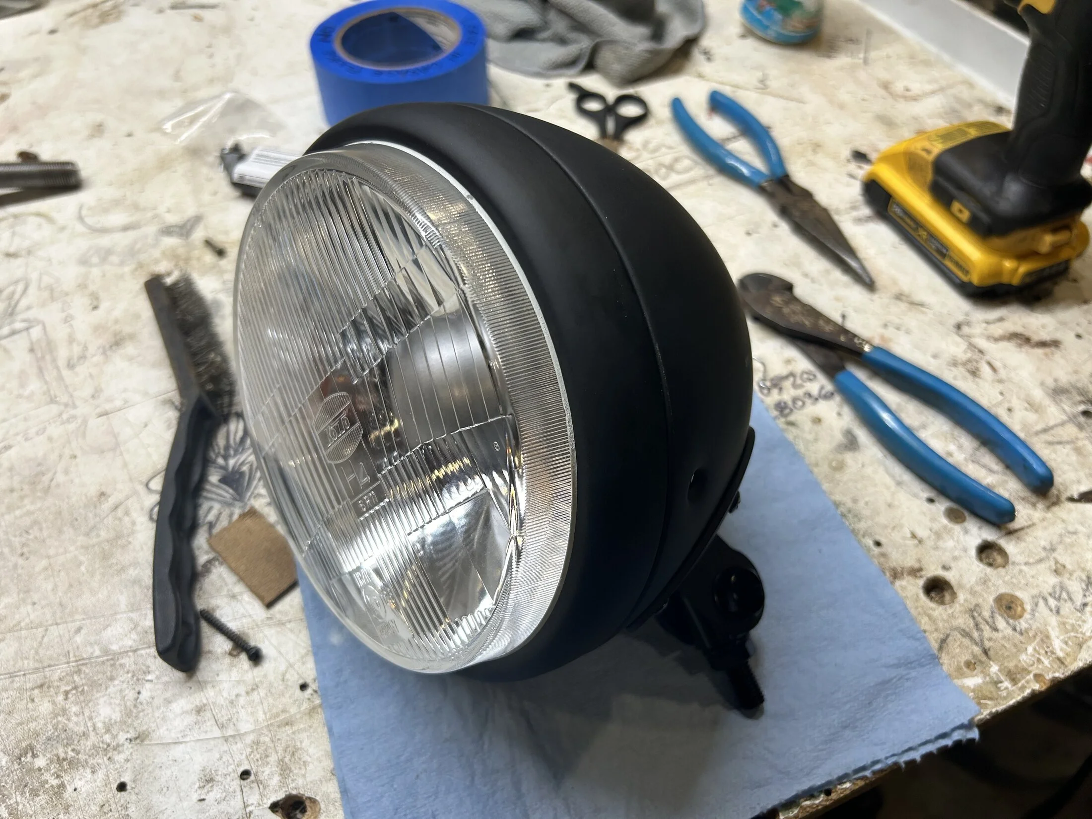

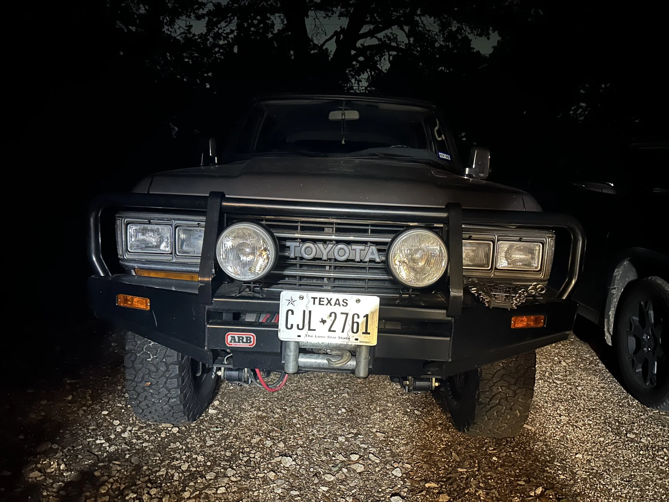

Second thing, I bought 2 of the badass H4 headlight kits for a total of $42 for both. One set is on my 40, “A Girl Named Norman”.
The other set I found a set of motorcycle headlight buckets for and plopped these in. Now these will be my aux lights on Paul.
