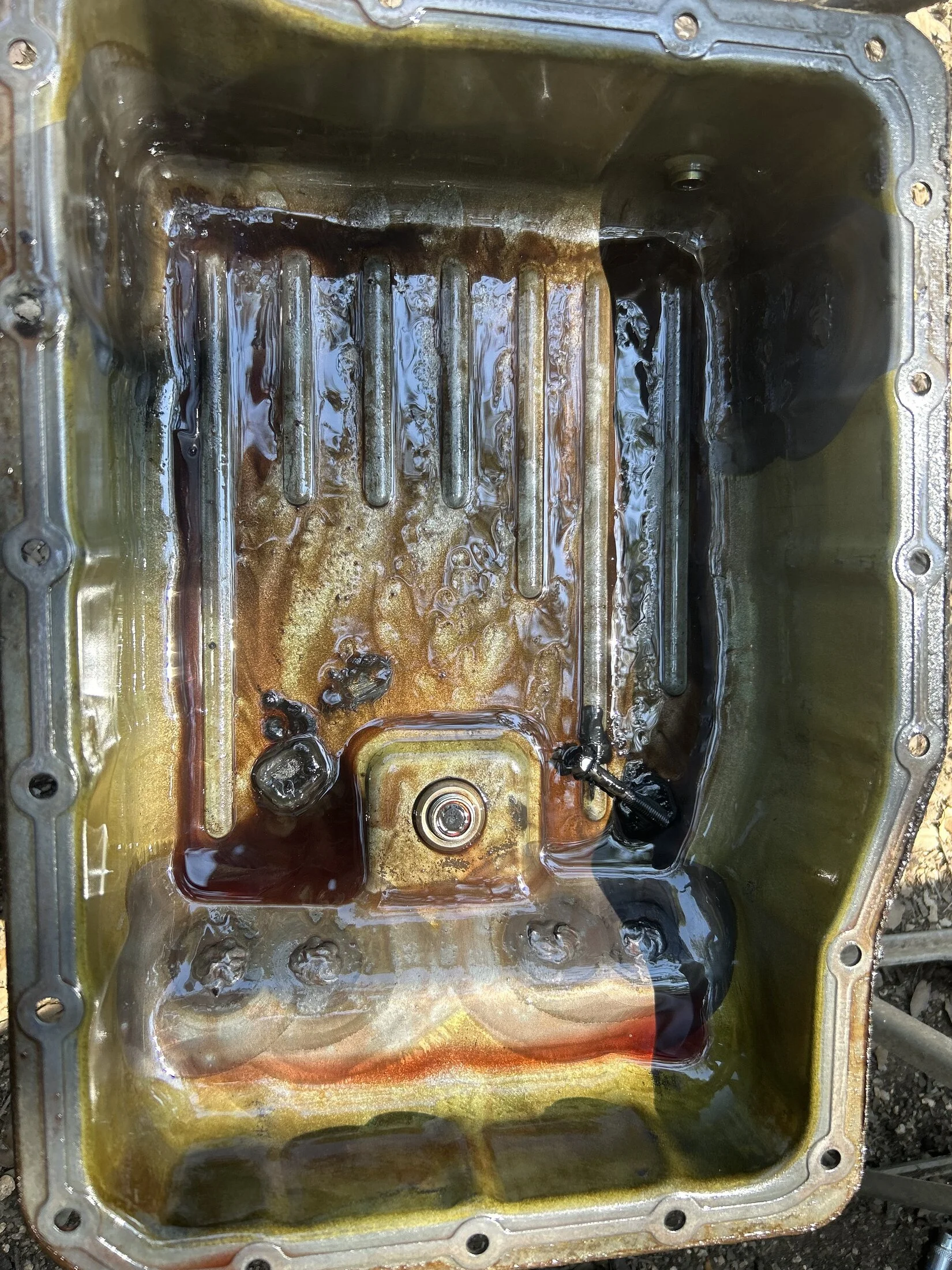

Yesterday I finally decided to dig in.
The pan:

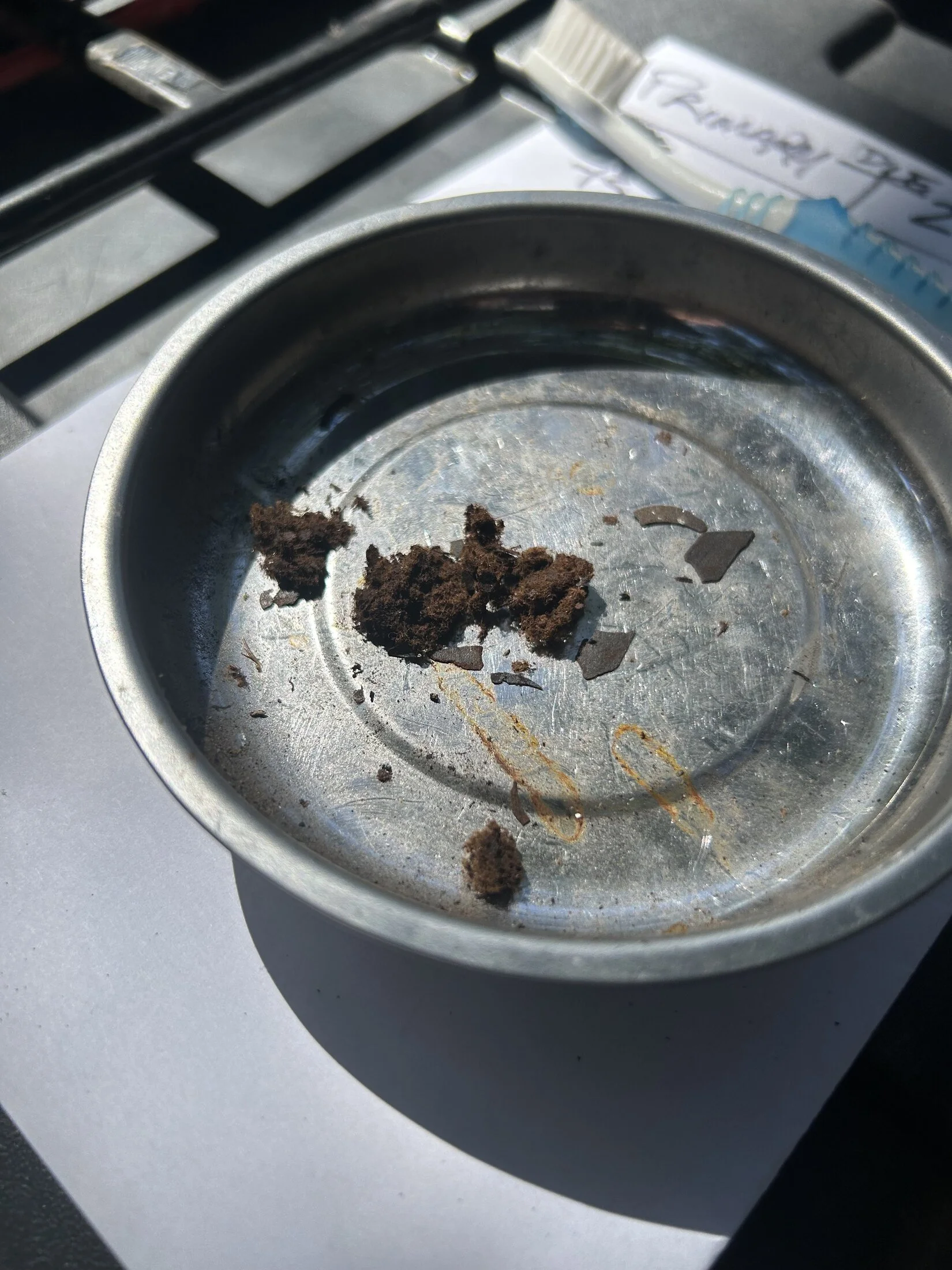

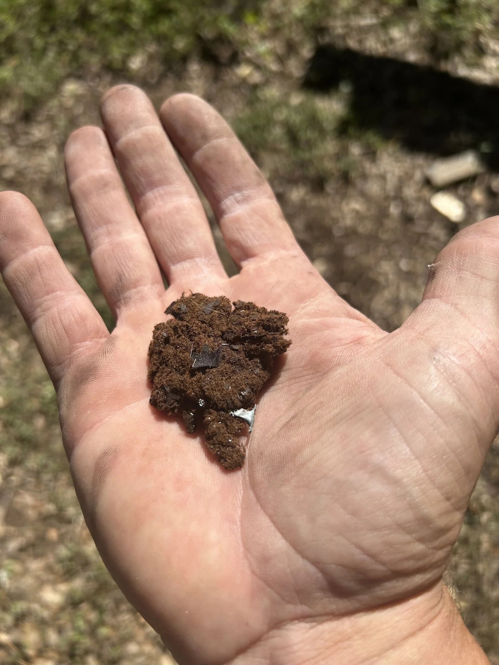

A decent amount of fines and one of the bolts that hold on the filter/screen. Whatever jack wagon that was in here last left me a 7/16” bolt forced into one of the pan bolts that promptly broke next another broken bolt that was left to be extracted by the next yokel (me).
I still had some hope until I pulled the filter and found this lovely pile of (insert word here).
Some of what came out of the filter:
It has the consistency of the shredded beef jerky we used to pretend was chew back in the day except glitteryer. Assuming it’s the better part of a clutch disc.
If your first inclination is to tell me to put an H55 in, pm me for my address so you can send me the check or I’ll give you my Venmo if old school ain’t your thing.
I’m just sharing this sh!tty tale…
Not really sure what happened other than when I drained the fluid for the baseline, it was burnt to a crisp.
No real indication, just poof.
The pan:
View attachment 3721444View attachment 3721445

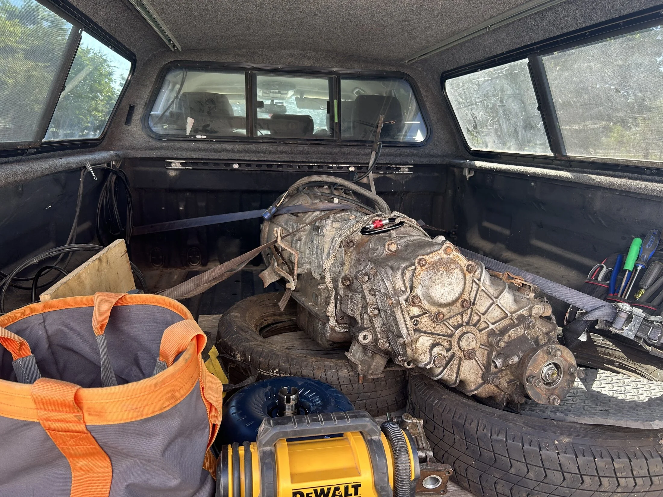

Did the cannonball ball run up to CD’s @ceylonfj40nut with the boy yesterday to snag the donor A440 trans for this girl until I land in H55 land in the future.
Easy drive really, enjoyed road time with my son and seeing CD’s winning smile for a short spell.
I’ll be heading down to @CenTXFJ60 Jimmy's barn here shortly to start making a mess. But figured I’d let this marinate on here for a bit.
So this transmission came out of an HJ60 and will go into an FJ62. All my research says it should work, just need to swap out a few things:

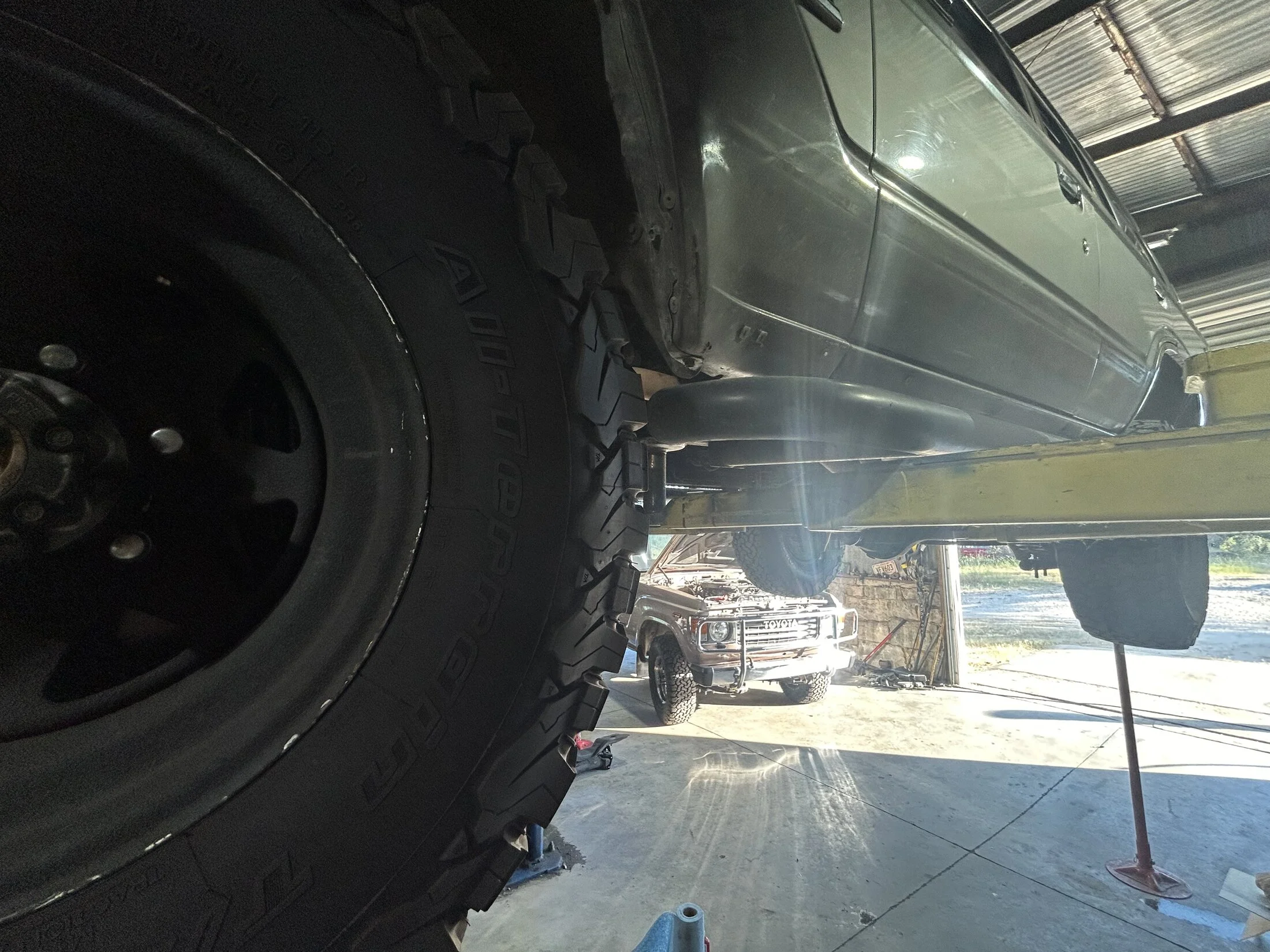

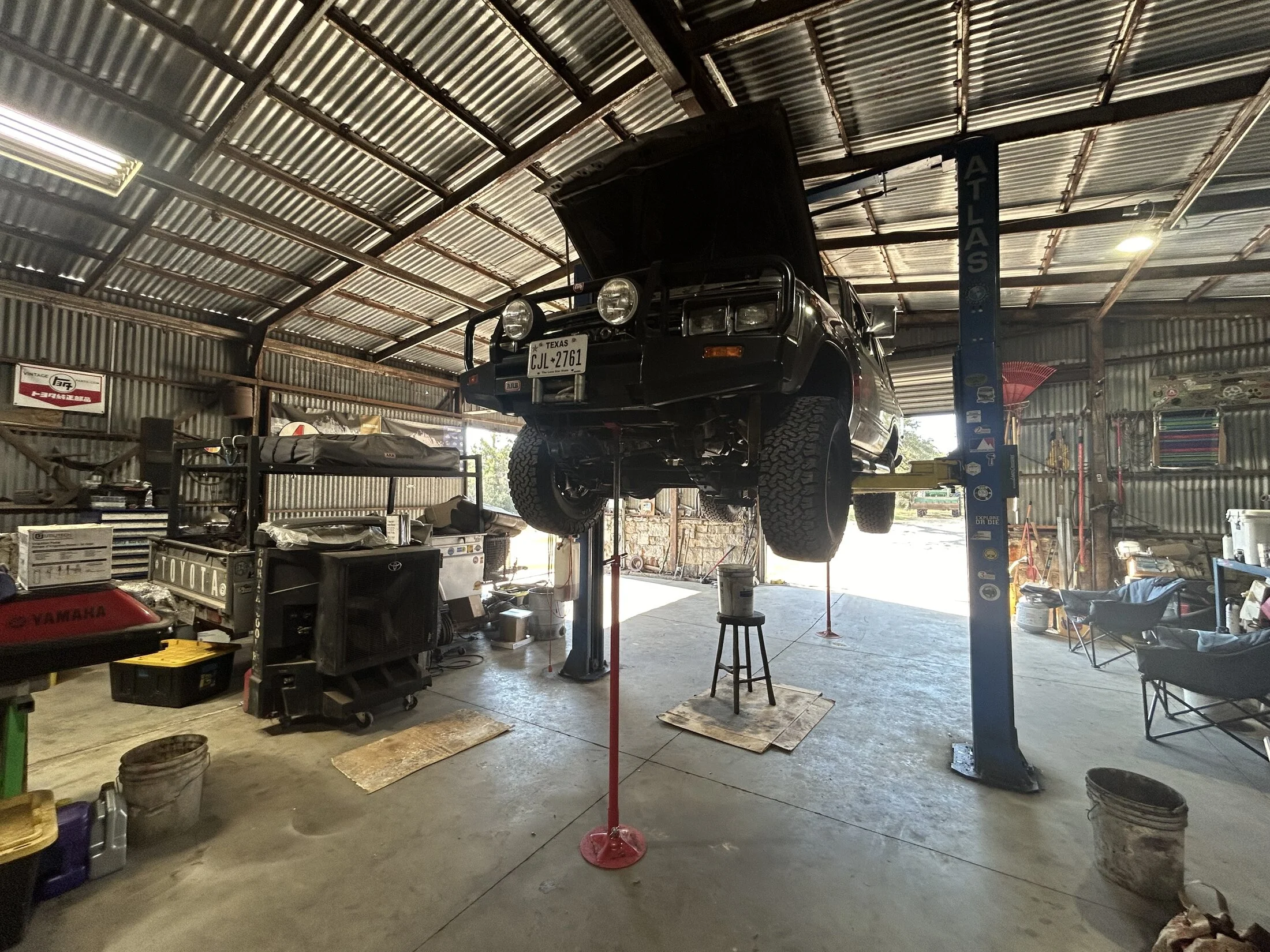

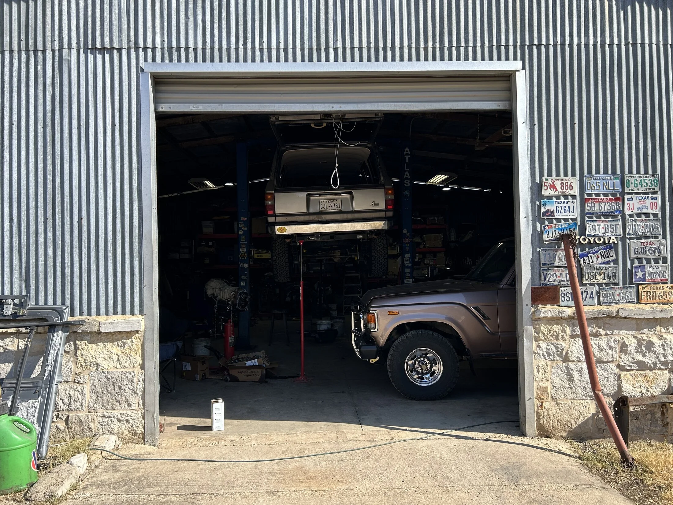

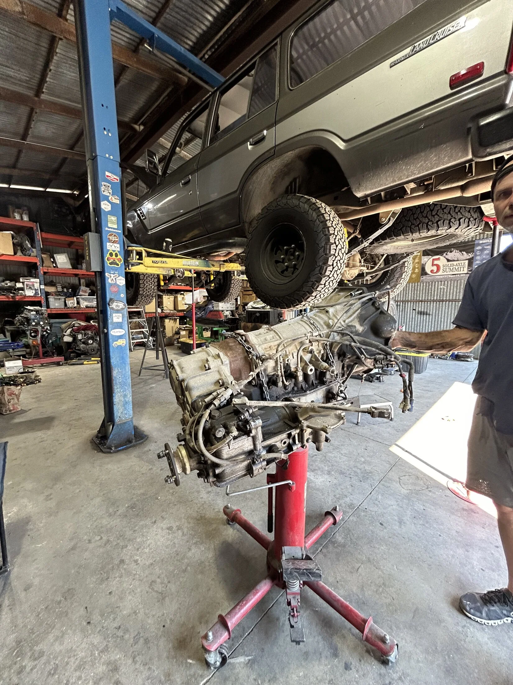

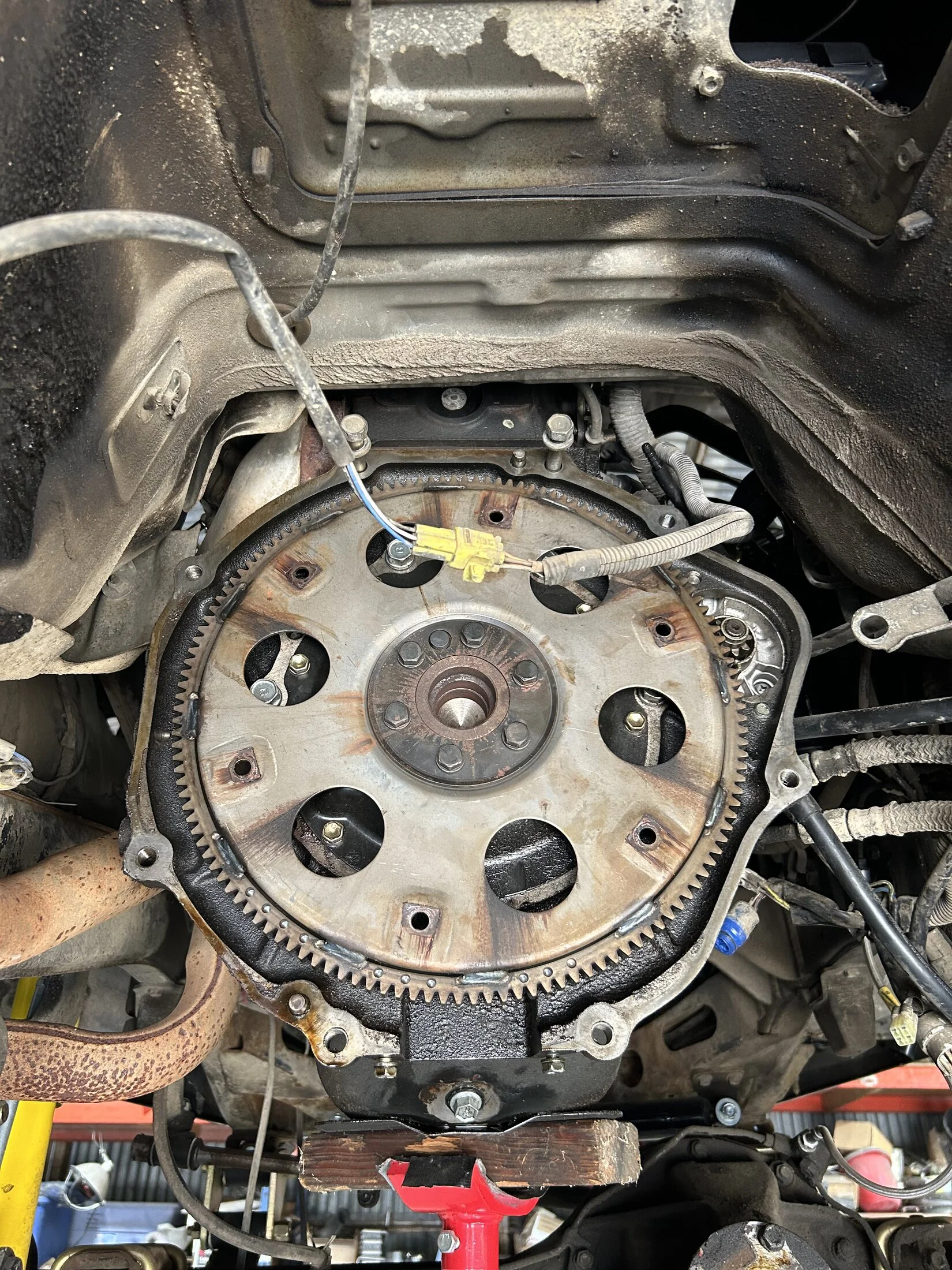

Spent Saturday and a good chunk of Sunday in Jimmy’s magical barn working on the transplant.
Got done:
- Old trans out

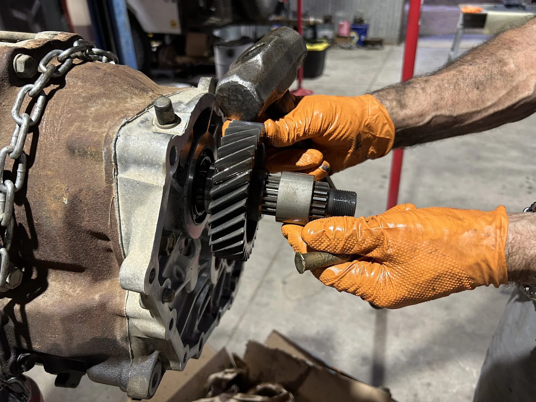

- T case off, disassembled, mostly cleaned up and ready for a rebuild kit from Georg @orangefj45

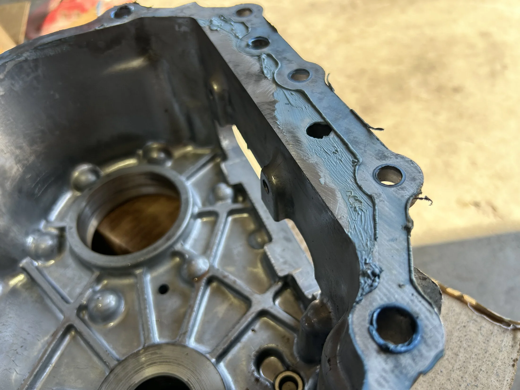

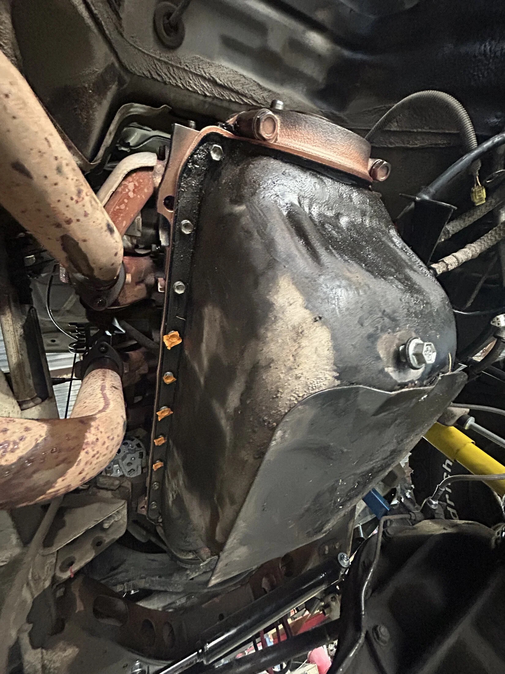

- speaking of Georg, installed new oil pan gasket using his excellent write up
- replaced the really hard to get to O2 sensor. The “easy” one is giving me fits.
- got the “new” trans out of my truck finally. It had tipped over and spilled ATF all over central Texas
- painted the timing marks on the flex plate.
So I decided to go a different route with the trans. Found one that has “around 100 miles on a fresh Valley Hybrids/Cruiser Bros refurb”. I should change the name of this truck to Georg.
