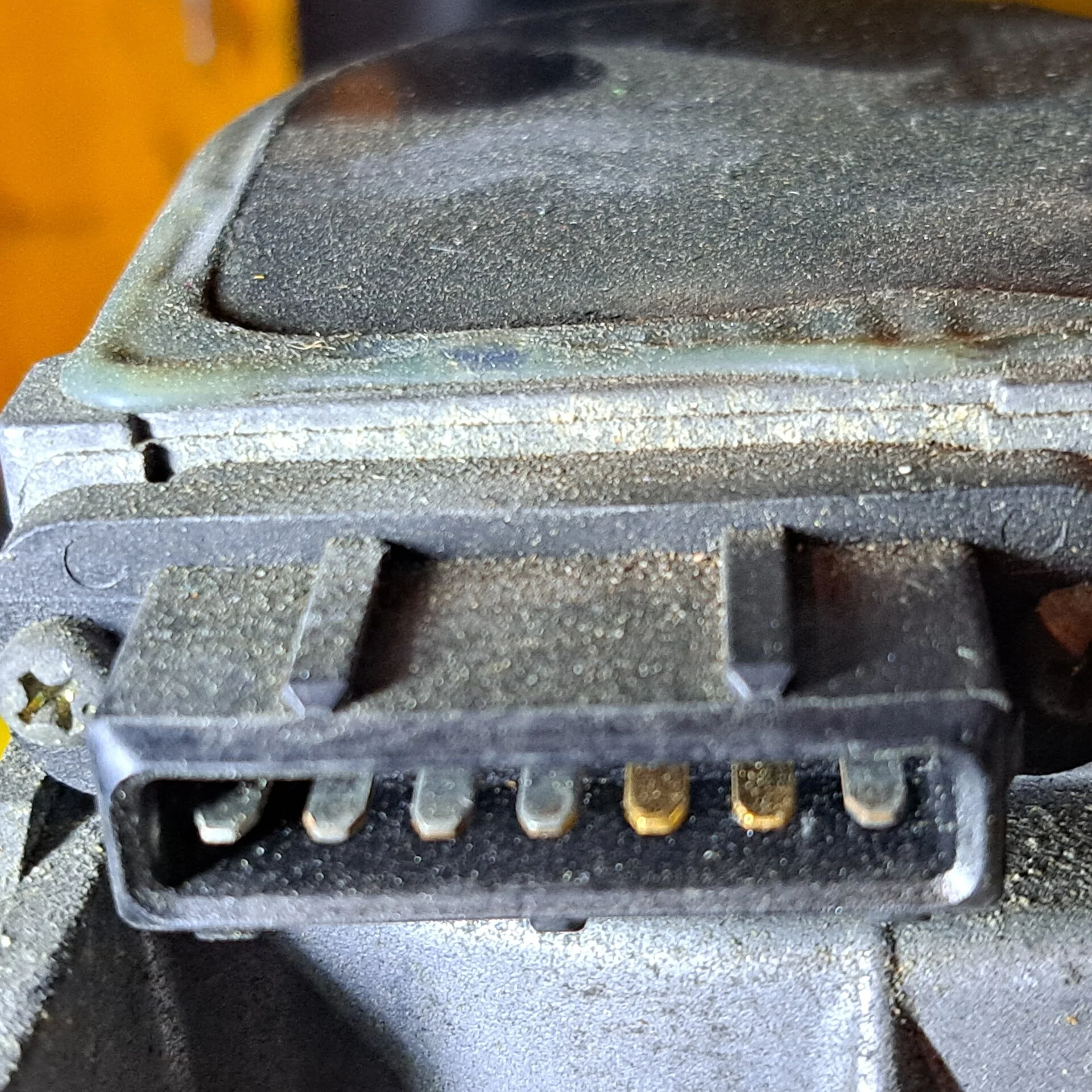

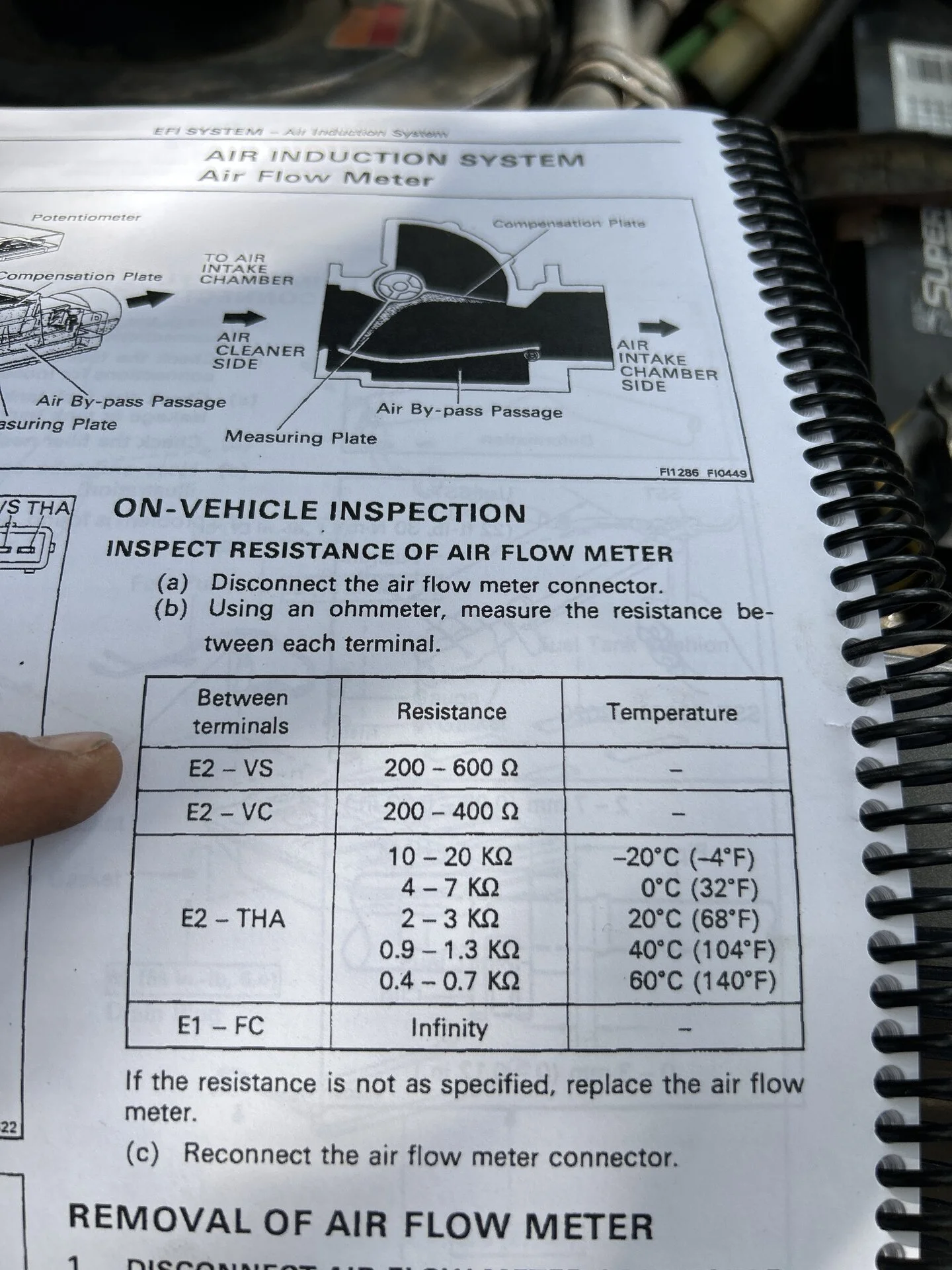

Going through the FSM I tested the resistance on AFM and am getting nothing on the E2-VS and E2-VC terminals. The rest check out fine.
Searches come up with a lot of info about the MAF on later models but nothing much about what I can do here.
Clean it? It NLA as far as I can tell.
Still popping away at this, stuff is getting better but she rarely starts in the morning. Mid-70’s.
Go to your local Pull-A-Part and pick up a newer AFM from a Camry... sorted A LOT out for me... also have you checked Fuel pressure regulator? I ended up refreshing ALL of the fuel components and inevitably it ended up being the AFM...

Well, none of my local pick and pulls have one so I’ll keep looking. A local cruiser guru @aljollano said to try MAF cleaner so I’ll try that.

For the record… the AFM that was in my 62 before I replaced with the Camry V6 one… it was probably from a Corolla. 👎🏾 even after passing all of the AFM tests in the FSM… my issues only got fixed when I replaced it.
