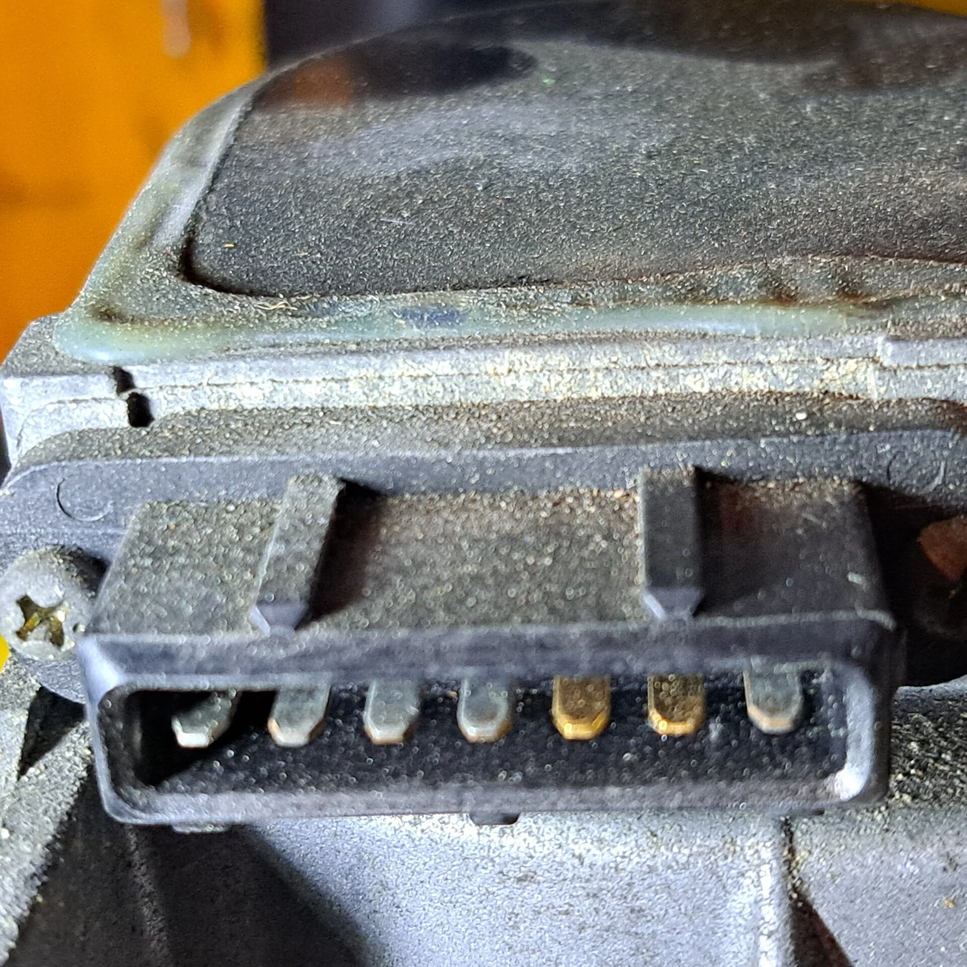

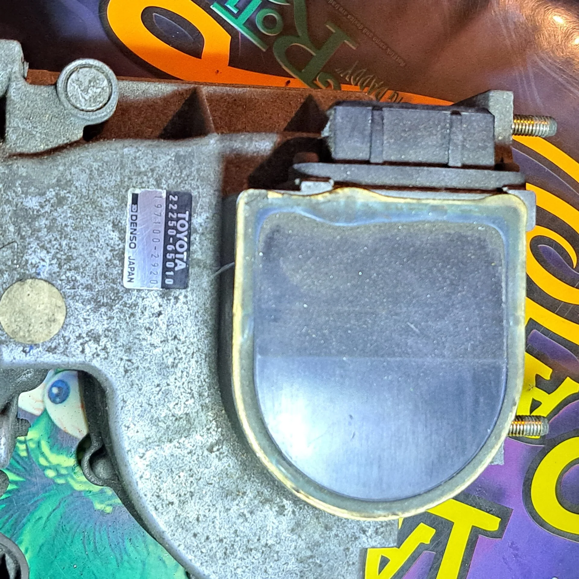

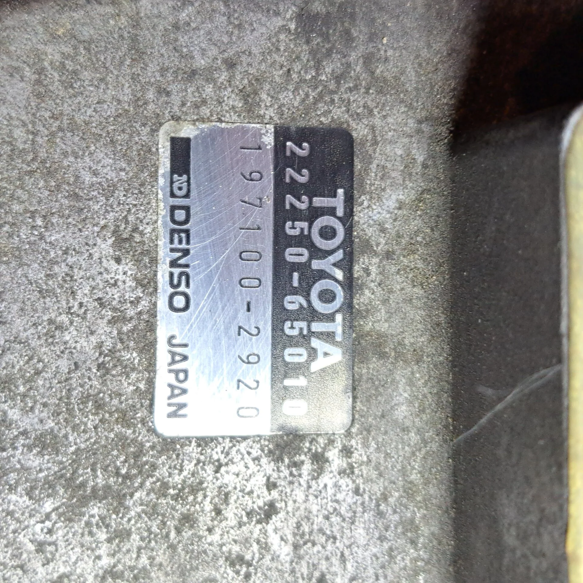

I have a couple FJ62 MAF’s if you don’t find something else.
Right on, appreciate it.
What would want for one?
Ian
Hey Viper,
What would need to happen for this to go down?
Also, you said, “it is sealed and never been opened” ?
Thanks,
Ian
I would try what @Ocho77 have since it is for a 62, mine is for a V6 truck/4runner.

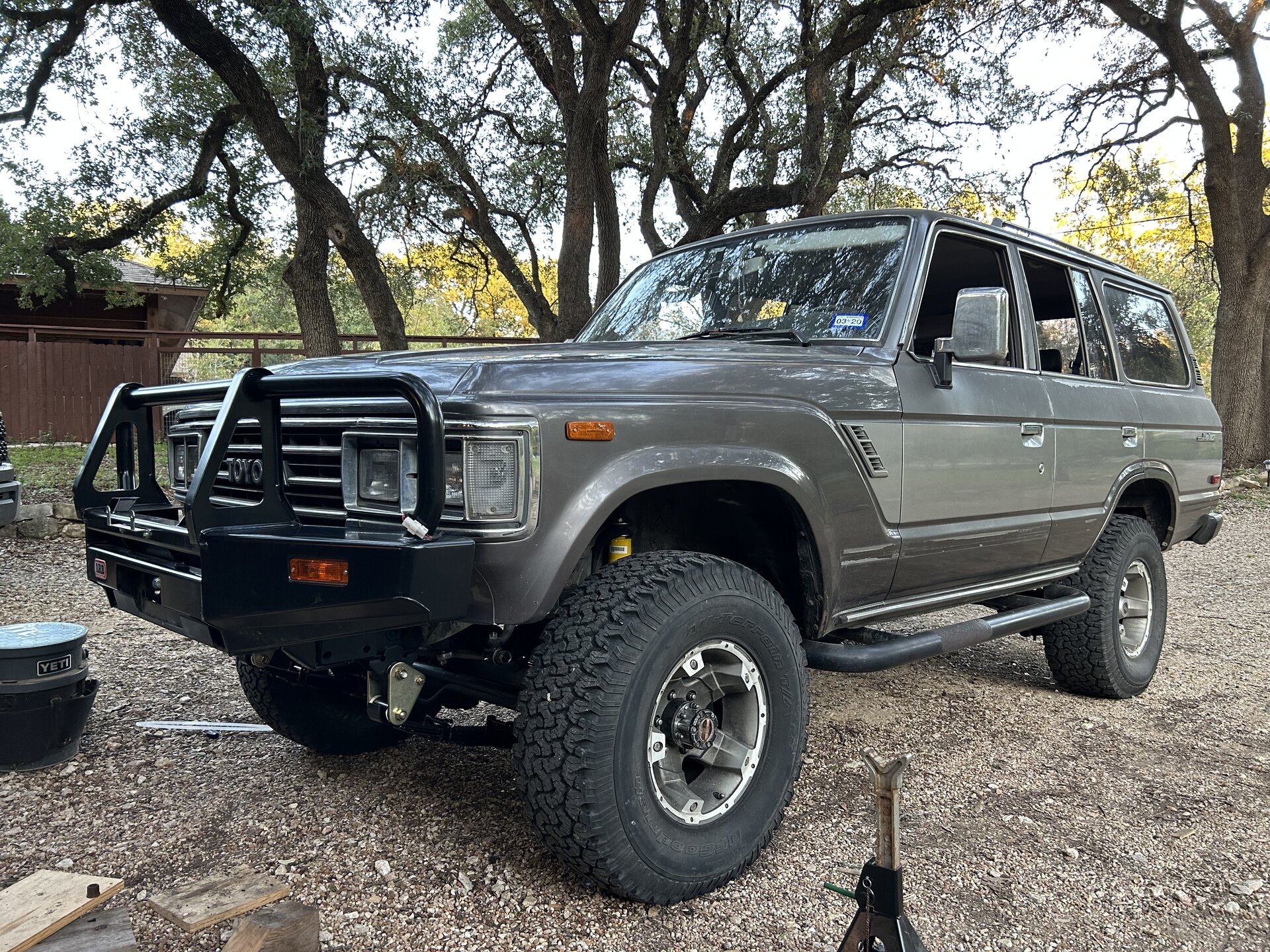

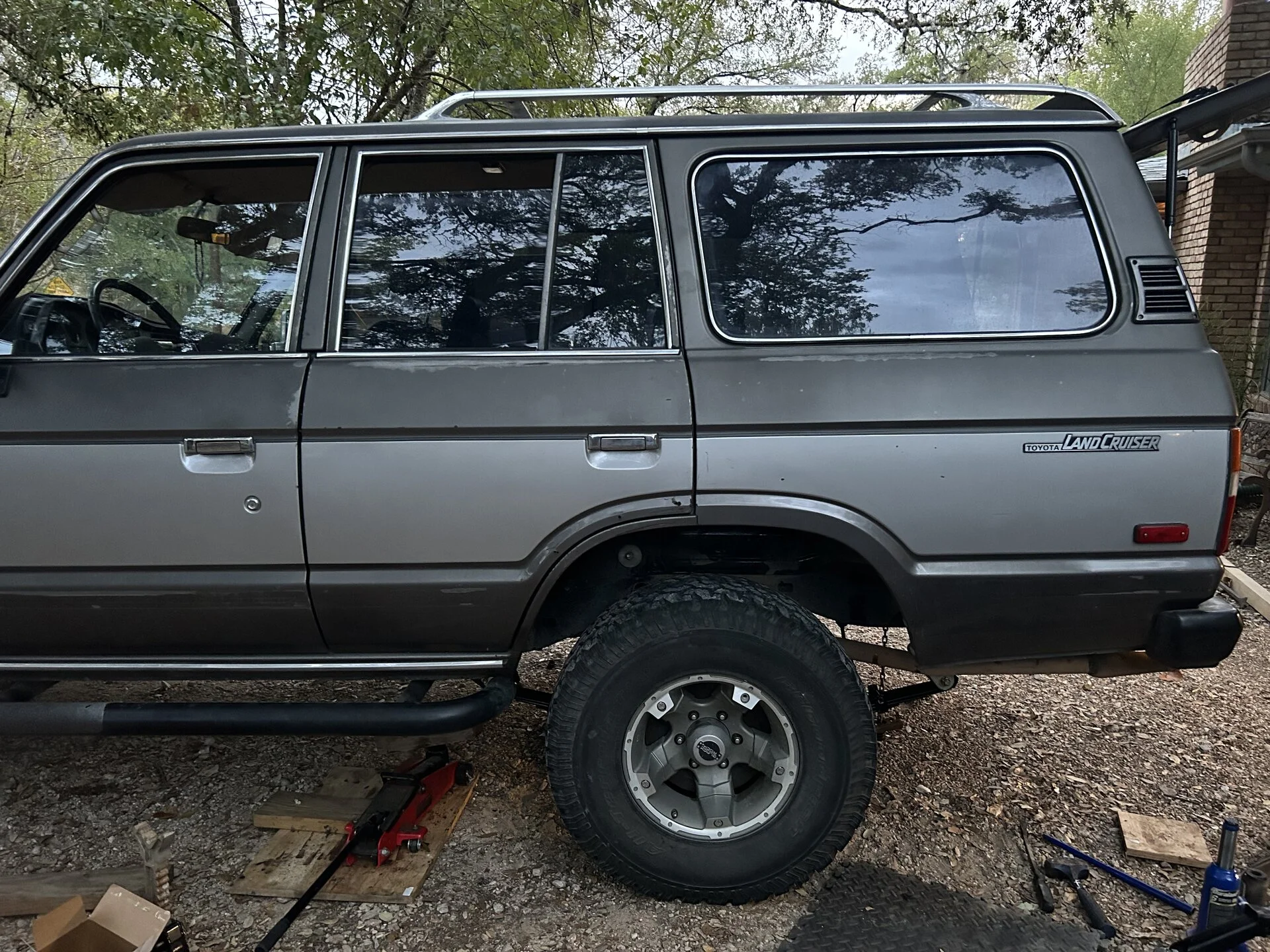

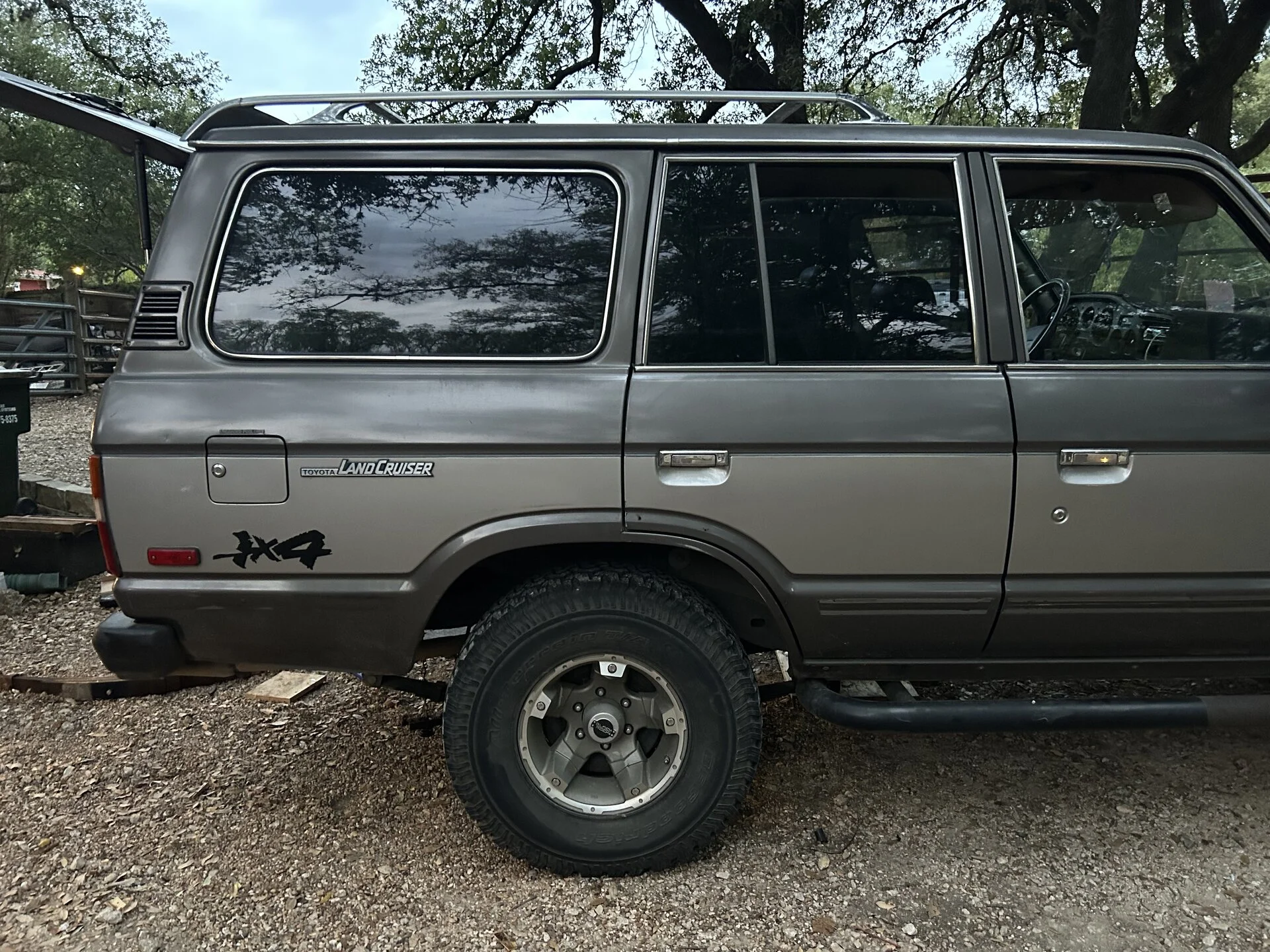

Currently 25% of the way through a Dobisons full suspension install.
Done corner
Not done corner
I know, I don’t like the wheels either…
Banner day for BillyGoat.

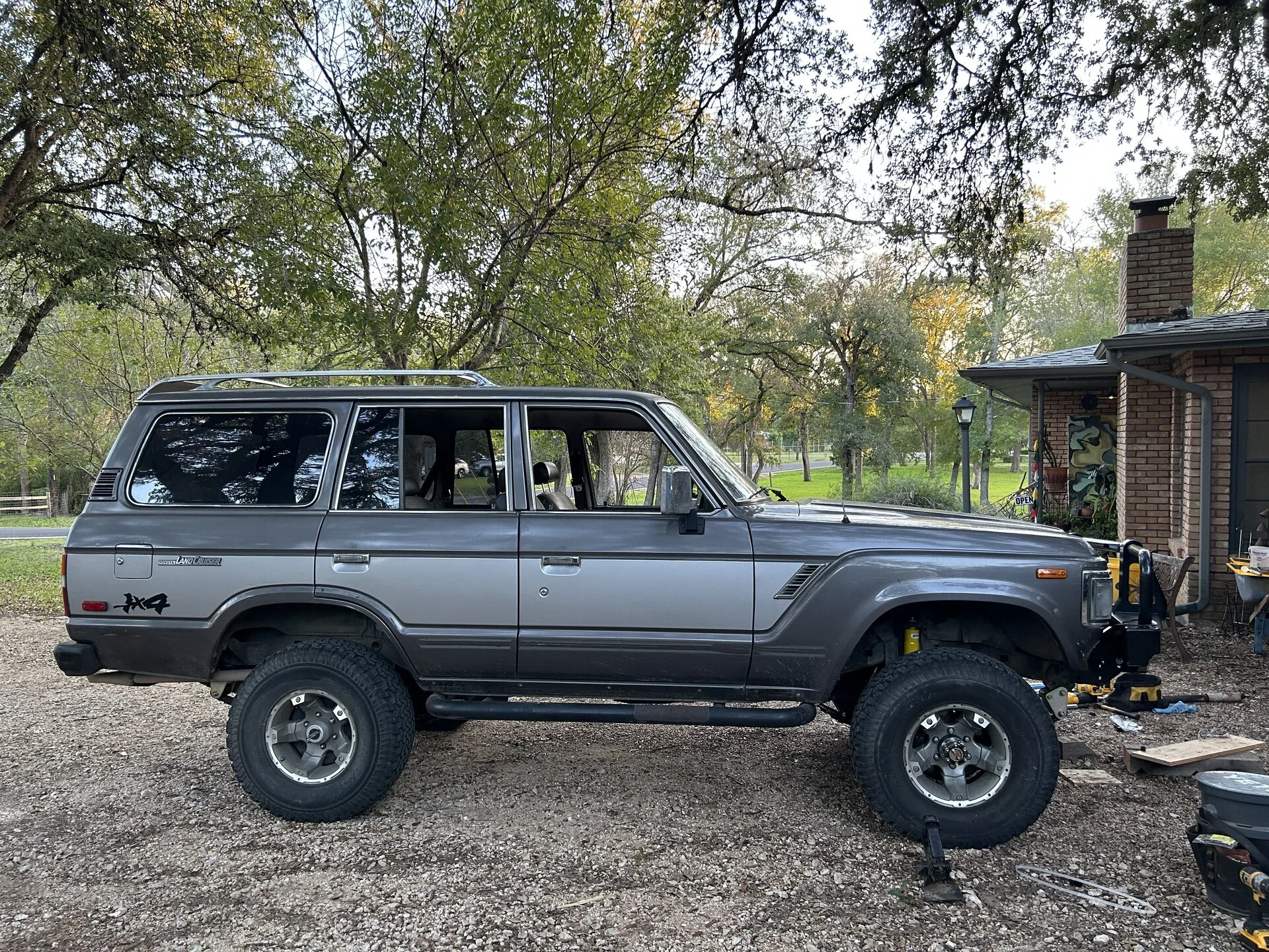

Wrapped up the Dobisons suspension and put on some long need mascara…
Thanks to @CenTXFJ60 for harboring said mascara and Ben (can’t recall his call sign here) (edit: thanks Jimmy) @BigHighBlue for the accommodating sale.
Before:
After
Be needing some bigger tires

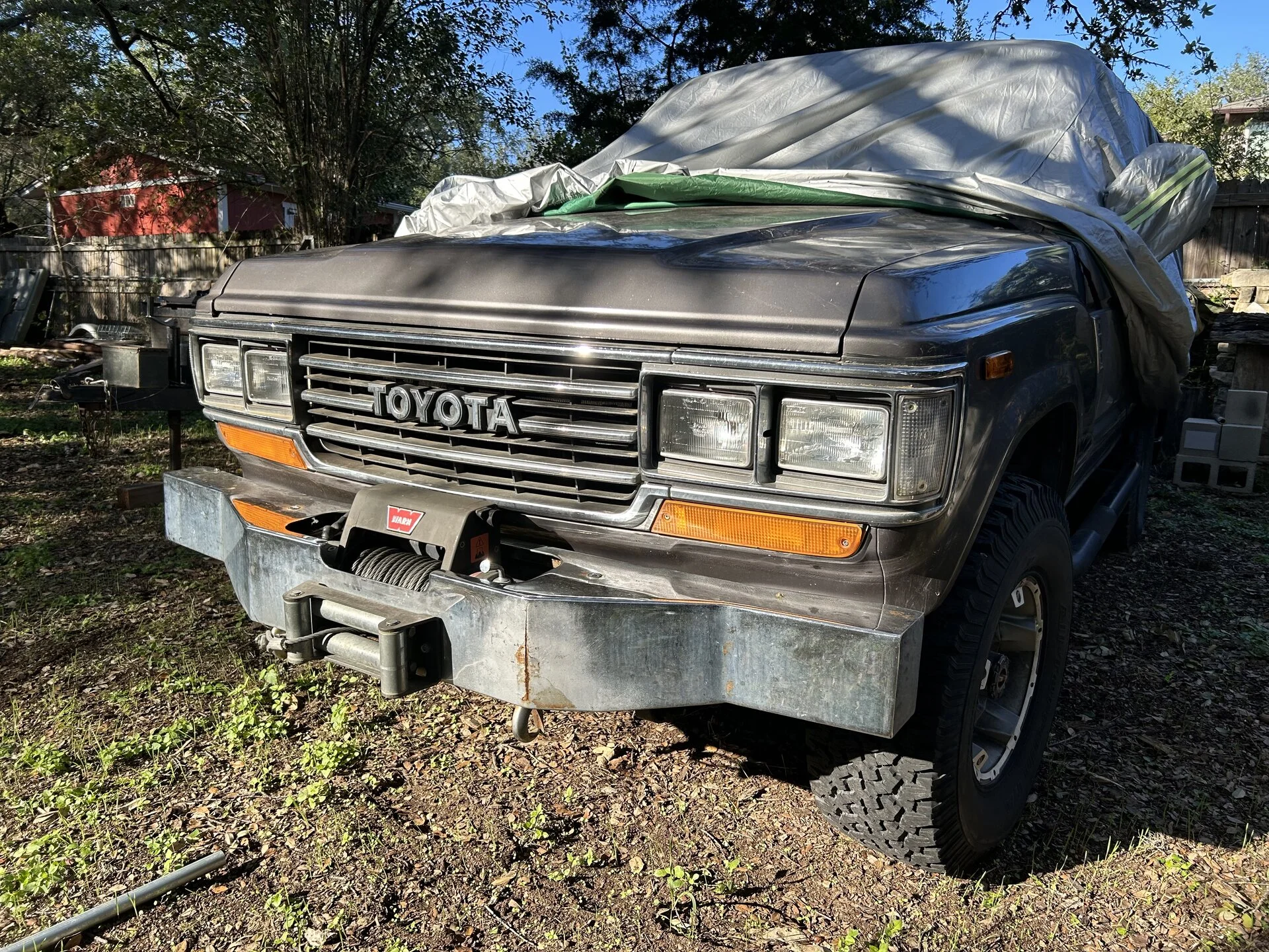

Hey y’all.
Good news is that the owner and I struck a deal on this 62. Now mine.

Looks great! I actually like those wheels, never seen them before. Wheels are so hard to get right on these 60s.
They’re for sale. Very affordable for mud members.
They’re Black Rock or something like that.
And thanks for the compliment. I could use it. The 180 driveshaft thing no worky. Almost sounds a hair worse.
