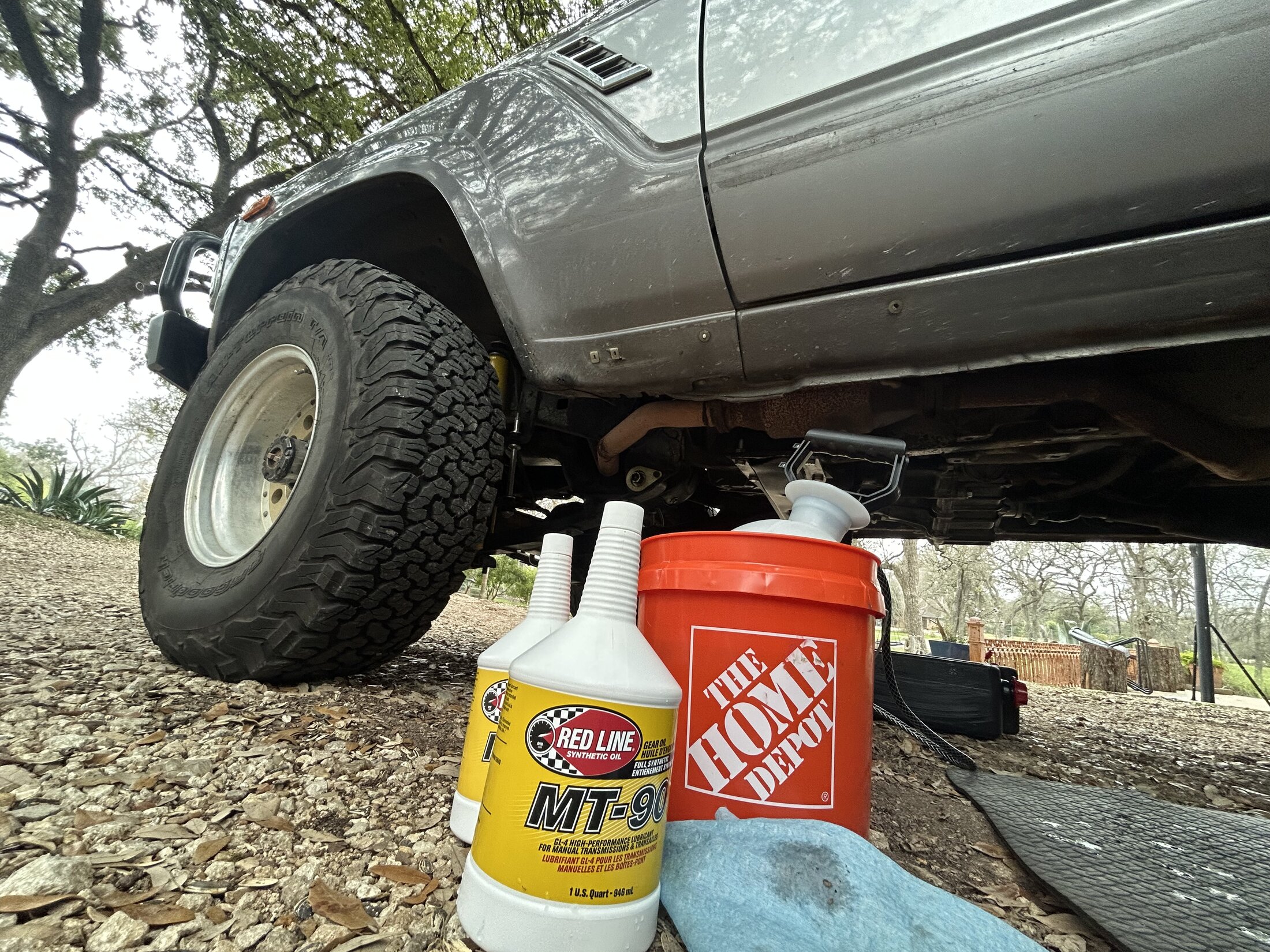

Gear oil
I loathe filling a transmission or t case with the stupid pump things from the auto parts store. I made this. Works well, if not a bit slow. At least I’m not covered in gear oil.
That’s how we do it here at the shop as well
Easy solution
With a Home Depot garden sprayer?
I had the idea the other day when I was pumping gear oil into Galen’s HJ61 down at Jimmy’s and the F’ing hose flew off the bucket pump. Spent a 1/2 hour cleaning gear oil off of everything. Looked it up and of course other people have done it, I’m not that smart.
It was pretty cold today and even though I’d stored the GO inside I ended up putting the pump in a bucket of hot water. I’d say it took about 10 minutes with a few pump pumps here and there to re-pressurize the dude. Good lord does it beat the syrup pump thing, especially with more than 5 liters.
