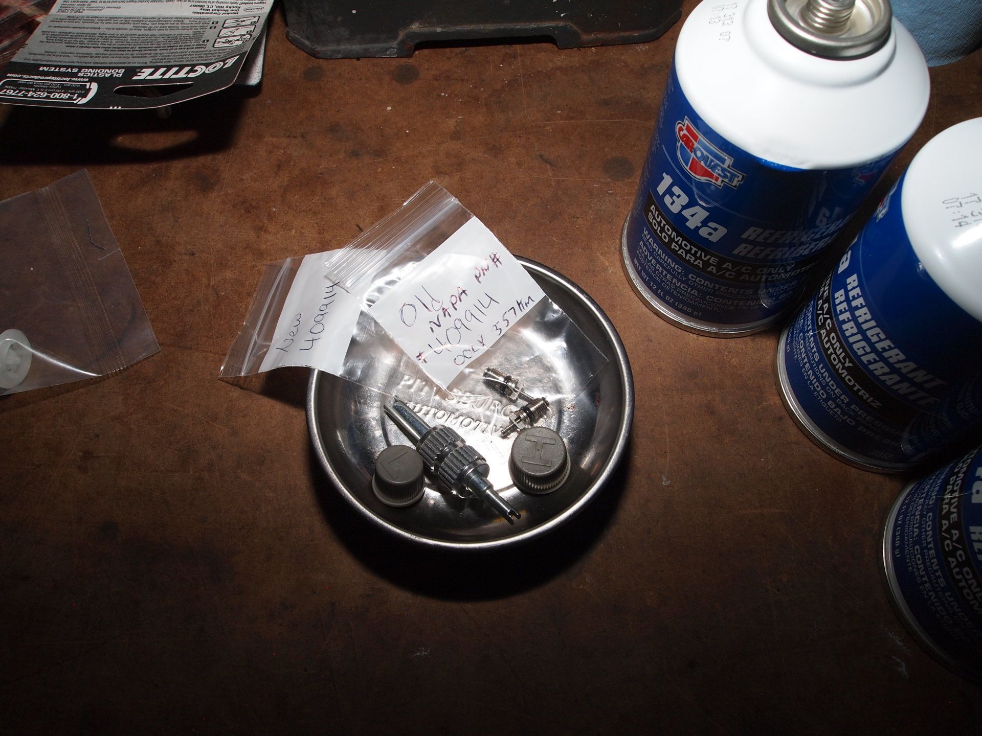

Thanks @medtro. Lucky I drove the rig to NAPA, as we had to pull the schrader valves and match them up. My old looked like new and further test (pulling vac) didn't reveal they leak, but replaced anyway.
NAPA PN # 409914.

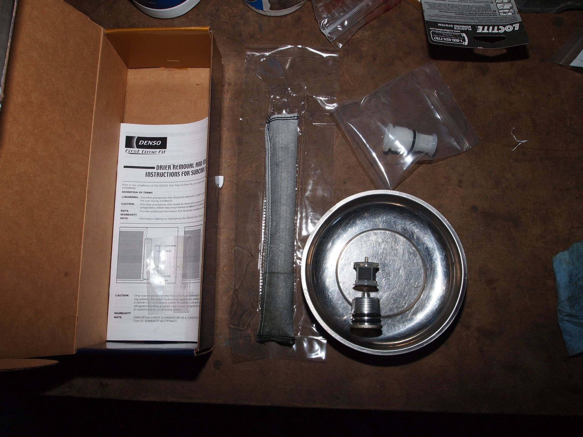

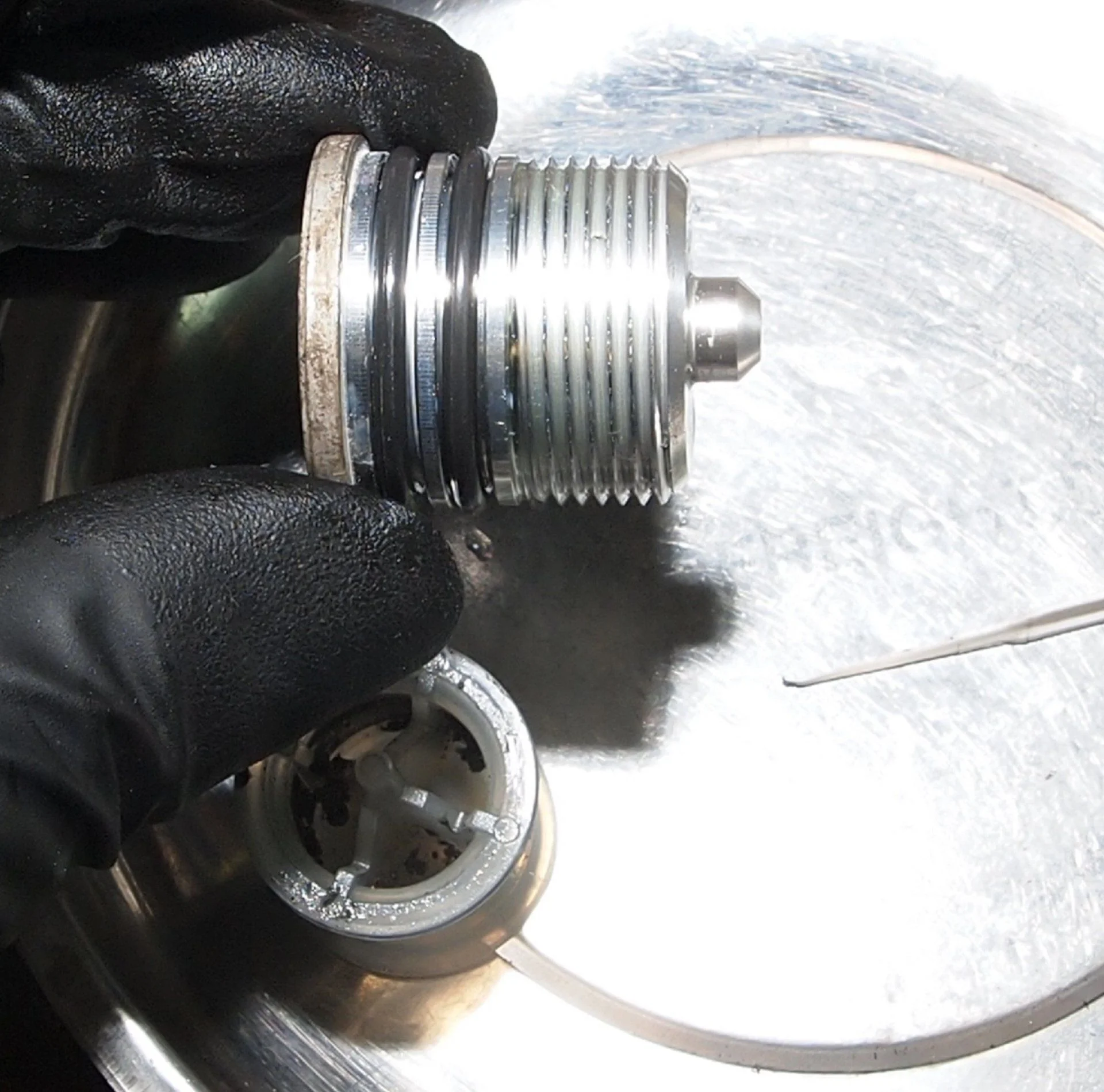

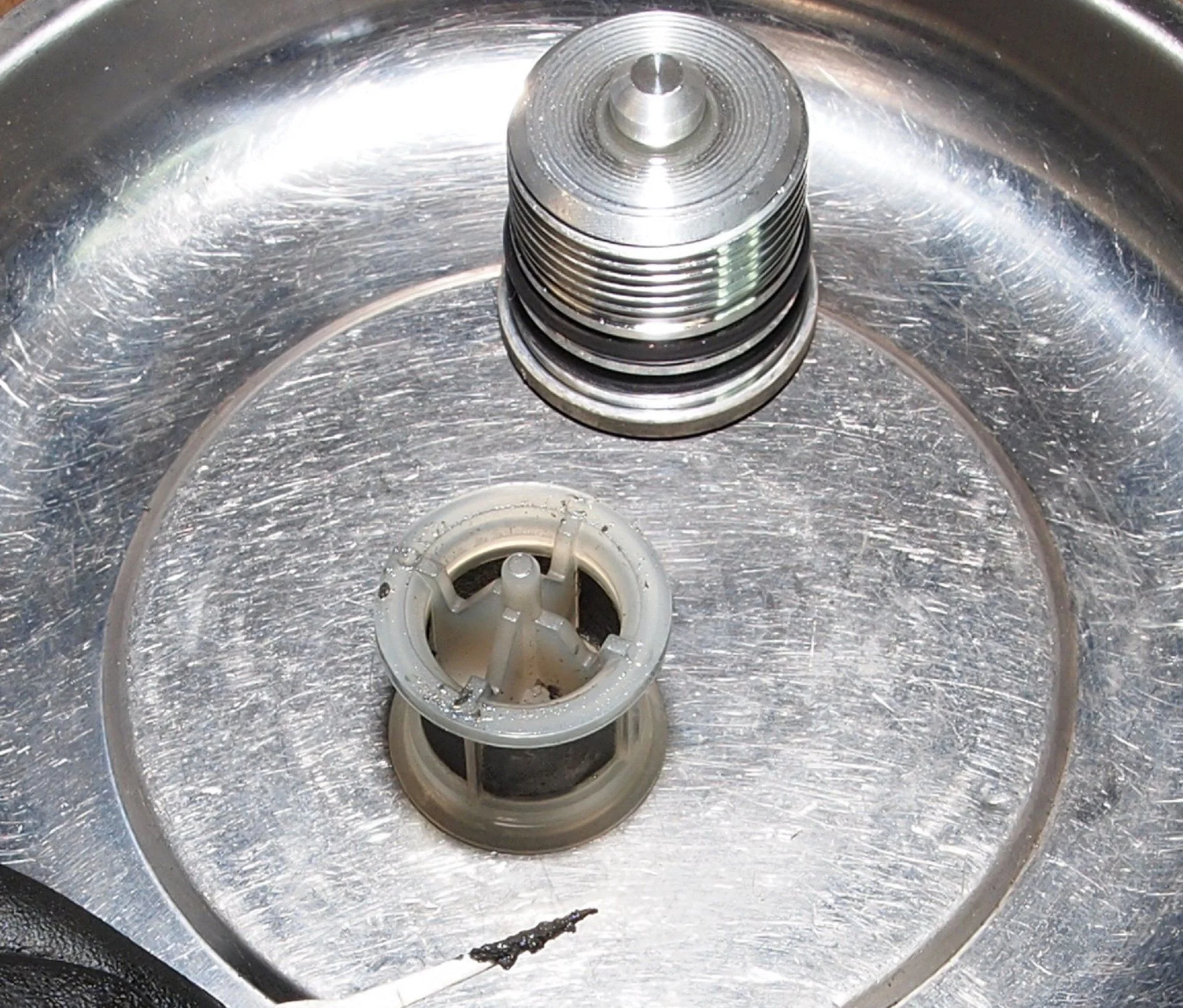

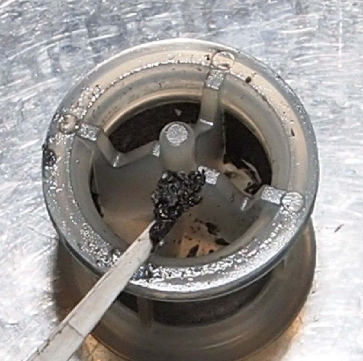

I replaced the Dryer, again using a Denso 478-1500. This time I found (in the Canadian 00LX) two piece aluminium plug with double O-rings and plastic filter, so that's what I used here. Earlier in the thread the 07LC had the one piece plastic plug w/single O-ring & filter. So I'm wondering if this was factory or a replacement. No record in history of being replaced.
Filter was gunked up on this one. The system history indicates into Lexus twice for charging, but didn'T specify if stop leak used.
What could it be?
Old Double O-rings look ok.

Hey @flintknapper what's your thought on the receiver filter gunk?
Anybody's guess. But certainly an element that has broken down.
Some possibilities:
System previously 'flushed', flushing agent not completely removed.
Broken down dye or stop leak product.
Remnants of severely heated lubricating oil (previous compressor failure).
Sometimes a desiccant bag will rupture....but that is usually brown or gray looking and sort of like powdered sediment. So probably not that.
I can't really say, except it doesn't belong there.

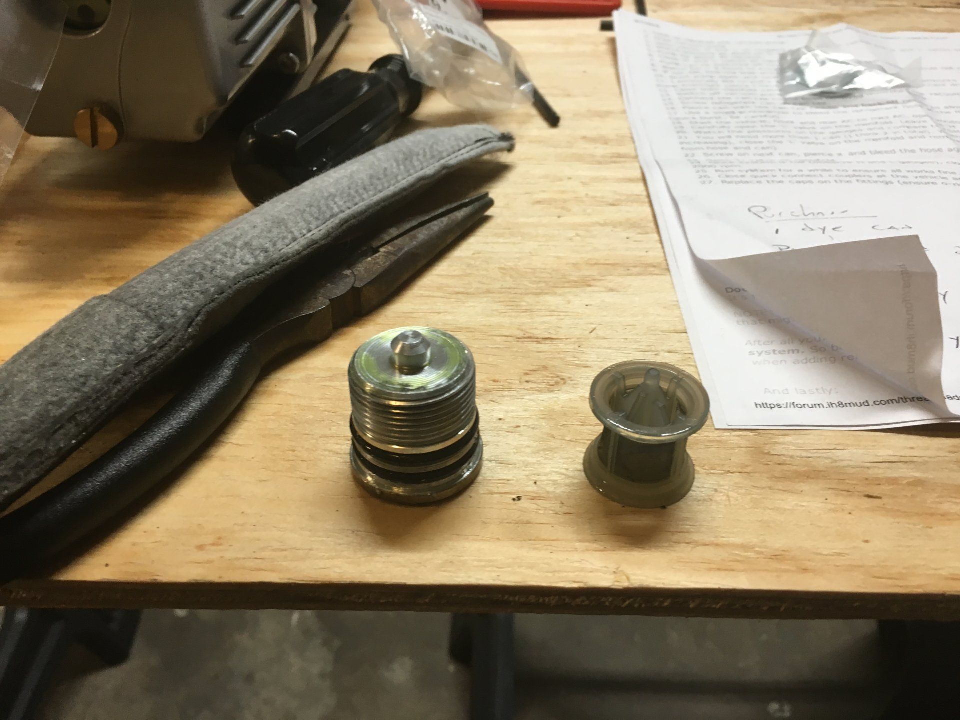

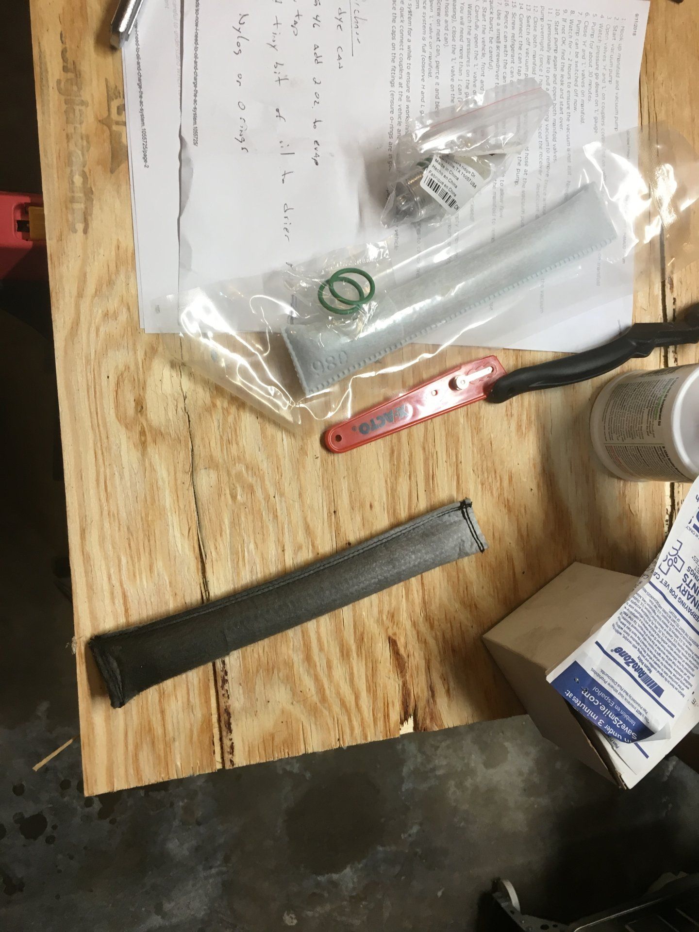

This is what mine looked like next to new. Id say it was original.
Lexus/Toyota history & parts records did not indicate dyer being replaced in this 00LX w/357Km nor in the 07LC w/127K miles done in June. So I'll assume factory switch to the plastic one piece sometime after 2001 and we're both seeing factory installed two piece with double O-ring.

Thank you, that's what I wanted to know "I can't really say, except it doesn't belong there". I didn't know if age alone could produce this.
History of Lexus maintained states at first evac & charge: "Not blowing as cold in slow traffic as as on HWY. System .5 low recharge with 2.45. Parts list: 2 002630013401 r134w warranty.
Next recharge a yr later in 2015 with much less info and nothing on parts list. Again note of service dep indicated "cool" just not cold.
So I'm guessing someone added dye and or stop leak at second recharge or the son sometime after. As son had the rig for last two years possible had done elsewhere as Lexus history of service stop with his taking over ownership.

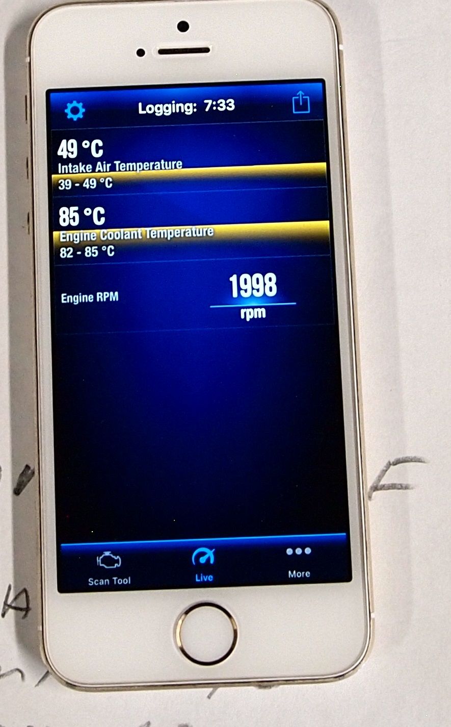

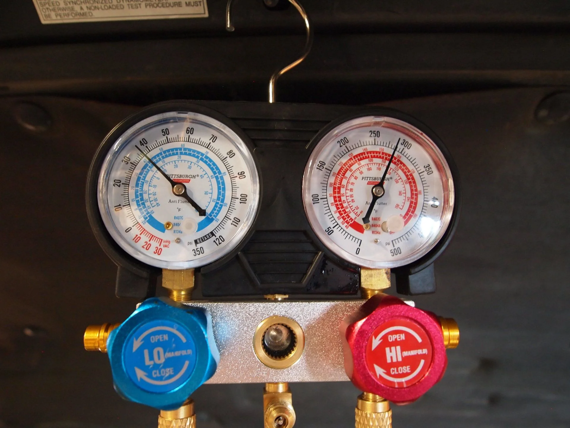

Sight glass turn clear after about 2 1/2 cans. Low gauge read 36 PSI & High 280 PSI as last oz went in with OAT of 108 F
Once done charging, I ran RPM at 2,000 then turned off A/C. A few seconds after A/C turned off, sight glass foamed for about 17 seconds, then turned clear again.
It was hot in the garage today. I did this A/C charge mid afternoon during record breaking heat in Denver. Garage reached 108 f engine coolant temp hit 190 F with intake air temp hitting 141 F. So I'll check PSI of L & H with manifold later when OAT of garage cooler.

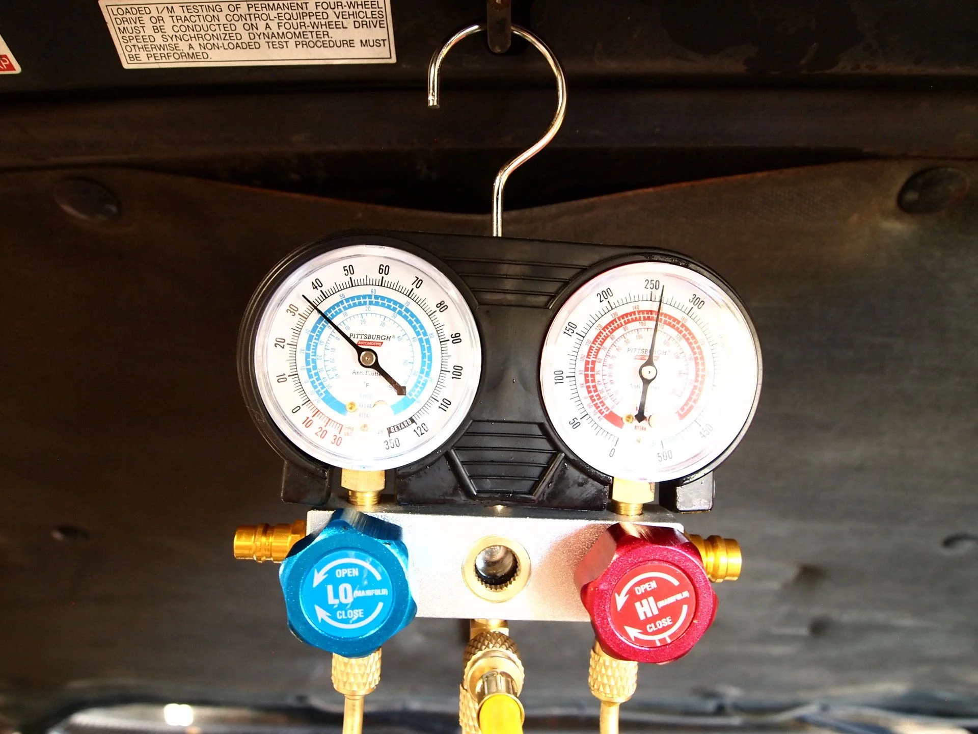

I've got a problem with High pressure 250 to 275 PSI

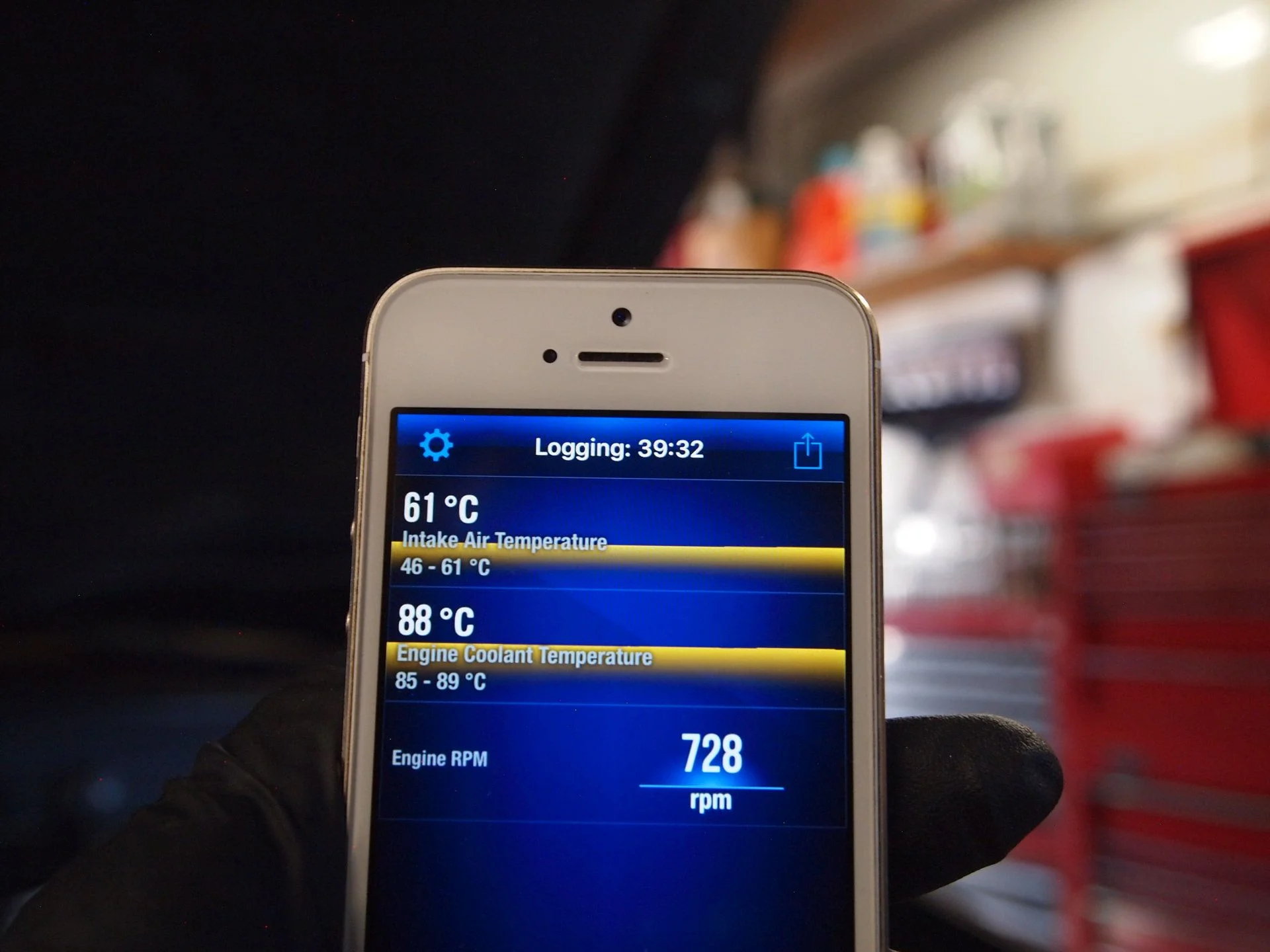

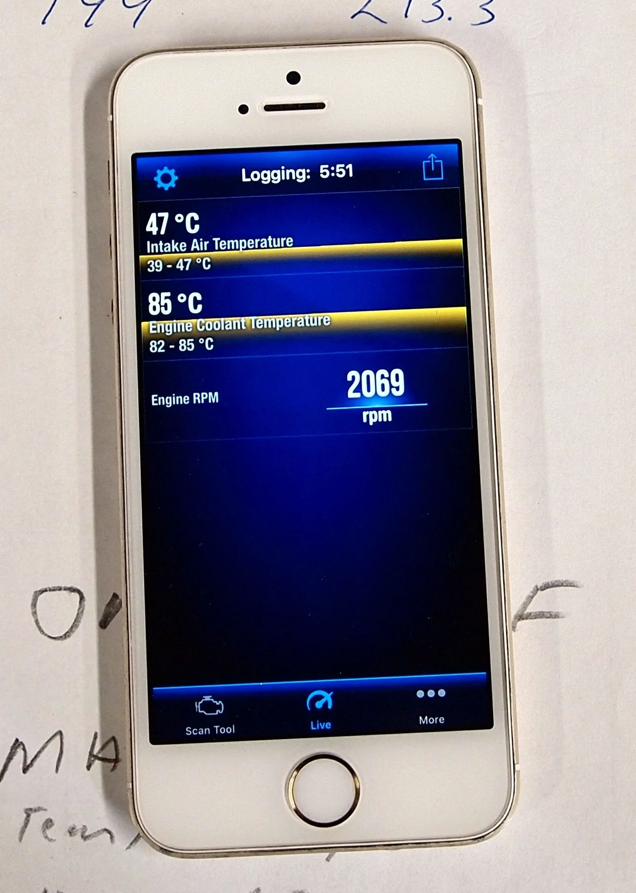

I rechecked today with OAT of 93 F in shop. Air at intel for HVAC may have been a bit hotter from heat of engine.
Why is my "H" pressure so high, ranging 250 to 275 PSI?
Would volume of oil affect pressure, say if to much would it raise pressure?
Is there any danger of damaging system with these pressures?
Should I bleed some off from H side engine off, L side or just see if it hold these pressures?
FSM (if I did my MPa to PSI conversion correctly) is:
L 21.33 to 35.55 PSI
H 199 to 213.33 PSI
Low stabilized at max recommended ~35 to 35.5 PSI so good pressure there. But high is ranging 37 to 62 PSI over max.

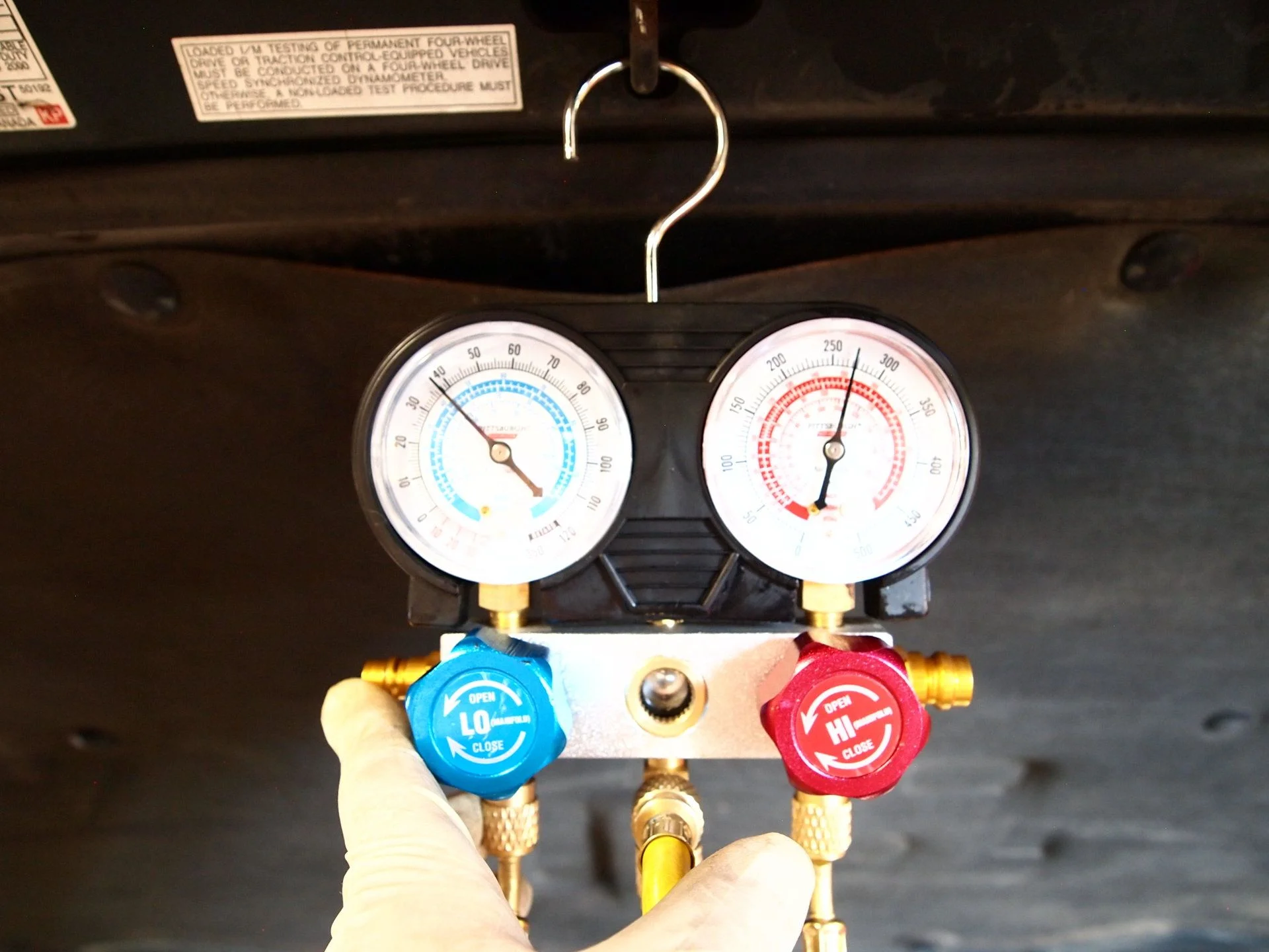

Hooked up manifold with A/C on full, windows open, RPM 2K. At first engine was not quite yet to operating temp, A/C just turned on I get reads of L 37.5, H 275 PSI
Over next few minutes "L" pressure stabilized at 35 to 35.5 PSI. High dropped also, but only to 250 PSI then climb some to 275 PSI moving around a bit.
After about 5 minutes seem to stabilize around L 35, H 260

I'll be doing some more testing with IR gun for temp readings and manifold for pressures. I'll report back here.
