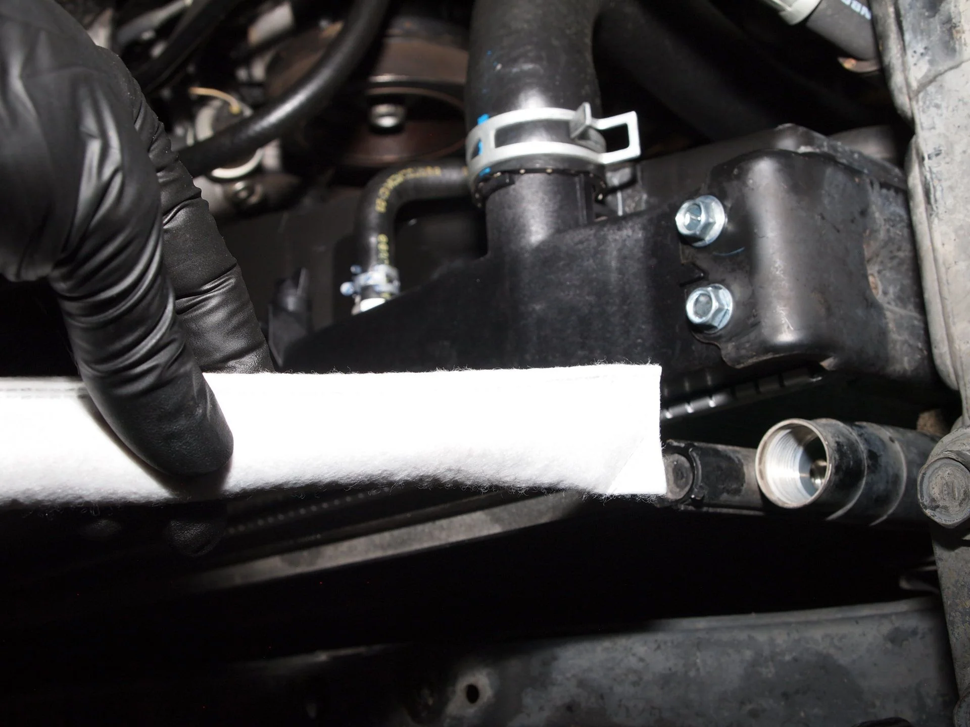

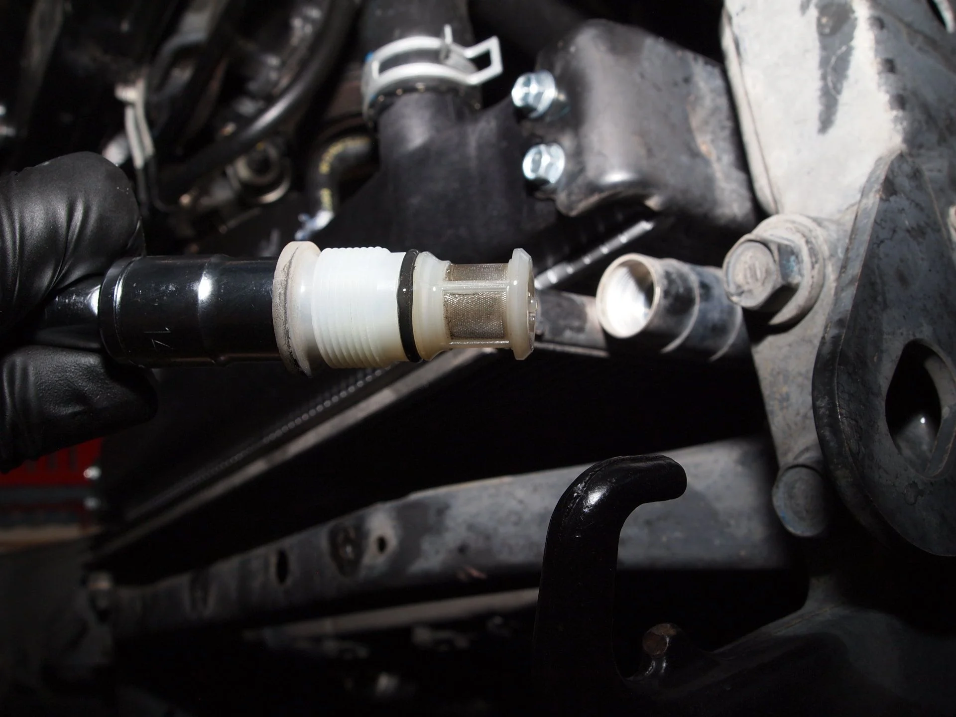

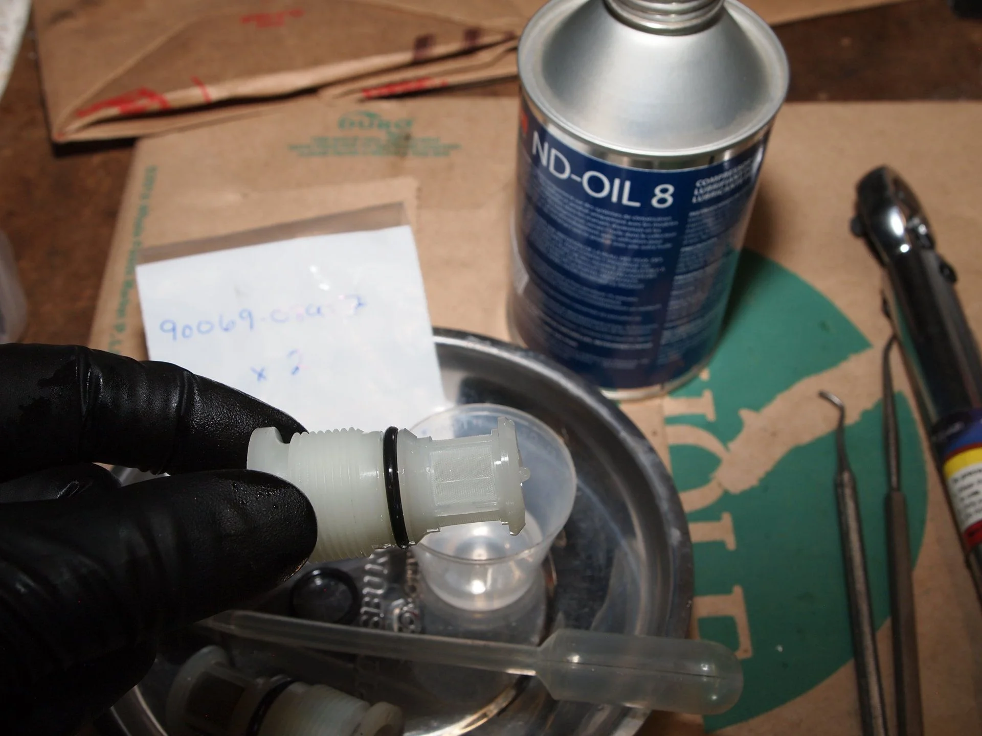

So I replaced the Dryer with Denso and the 2007 uses the larger single piece plug. I couldn't find a torque spec so just snug up plus a little after I felt resistance from O-ring seating. The old plug was a little oily, so I oiled the New O-ring that came with it and cover the plug screen with oil.
The bottom of old Dryer was oily, so I also oiled new a little bit too.
View attachment 1697332 View attachment 1697333
I had removed the discharge tube at condenser and the return line at compressor. So added some oil to compressor (3/4 oz) and some into discharge tube (3/4 oz). I replaced both O-ring with new OEM O-rings after oiling them. In all I added 1 3/4 oz (~4 TLBS) which is about double what I lost.

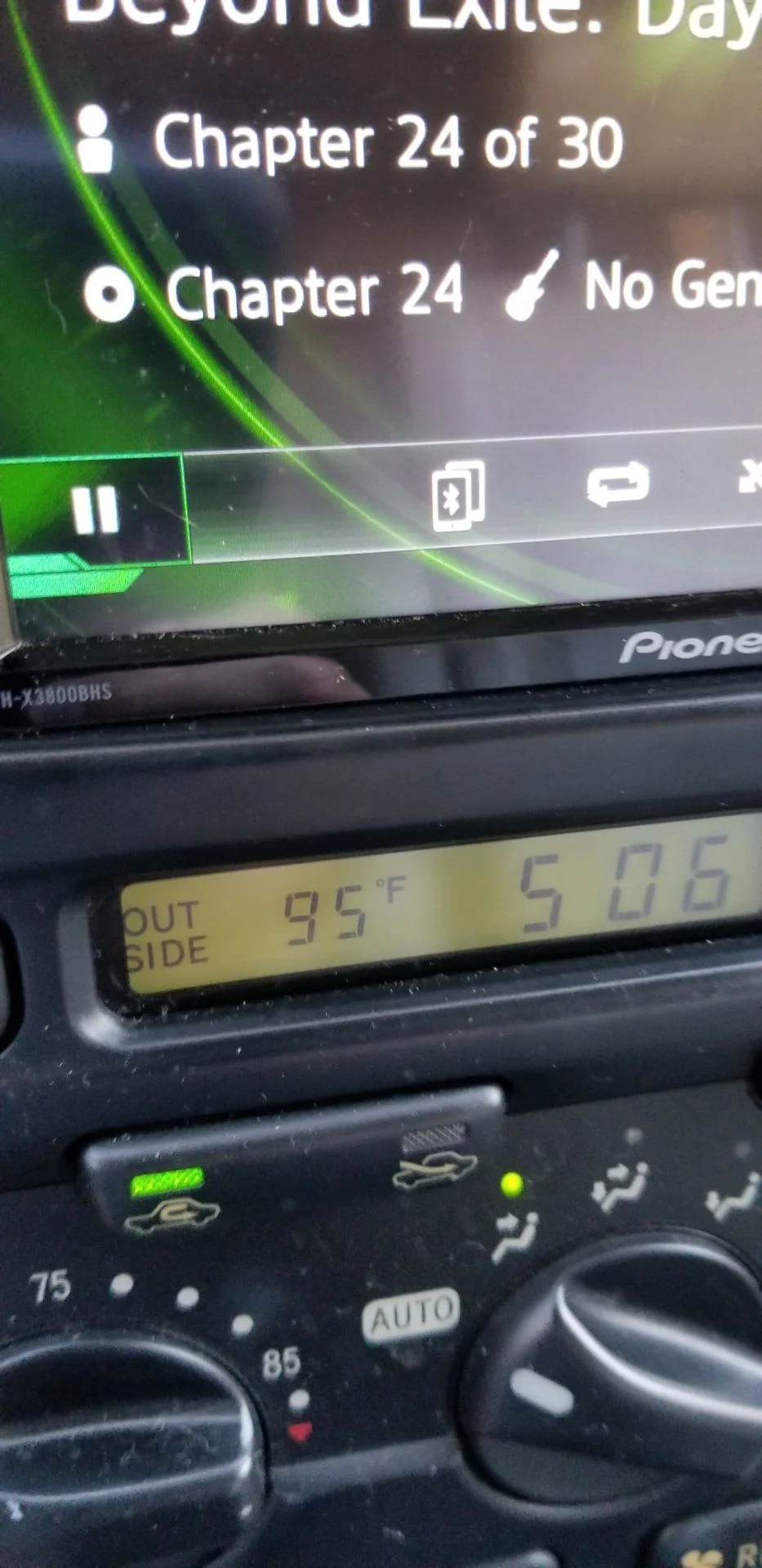

Fyi.... post leak check and refill... the replacement of the core is successful. Yesterday was 95 degrees with 100% humidity and the system was blowing between 38 and 41 degrees at the vent depending on the rear AC being on or off.
Does the variation of temp mean that th he shop didn't place the right amount of Freon in? They said after the vacuum they placed the right amount of freon based on the factory recommendation. Really, it seems ok but the temp variation makes me think that they perhaps didn't put in enough freon.
38-41° is excellent...! Do NOT touch a thing. Count yourself lucky. Many folks would love to have those temps.
Vent temp fluctuation is normal with changing temperatures and/or the operation of the rear unit. Keep your fingers crossed that nothing changes and enjoy your cool air.

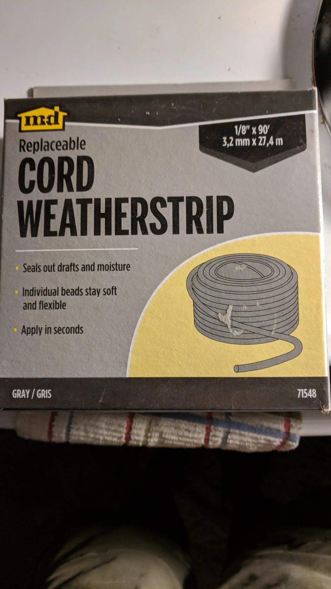

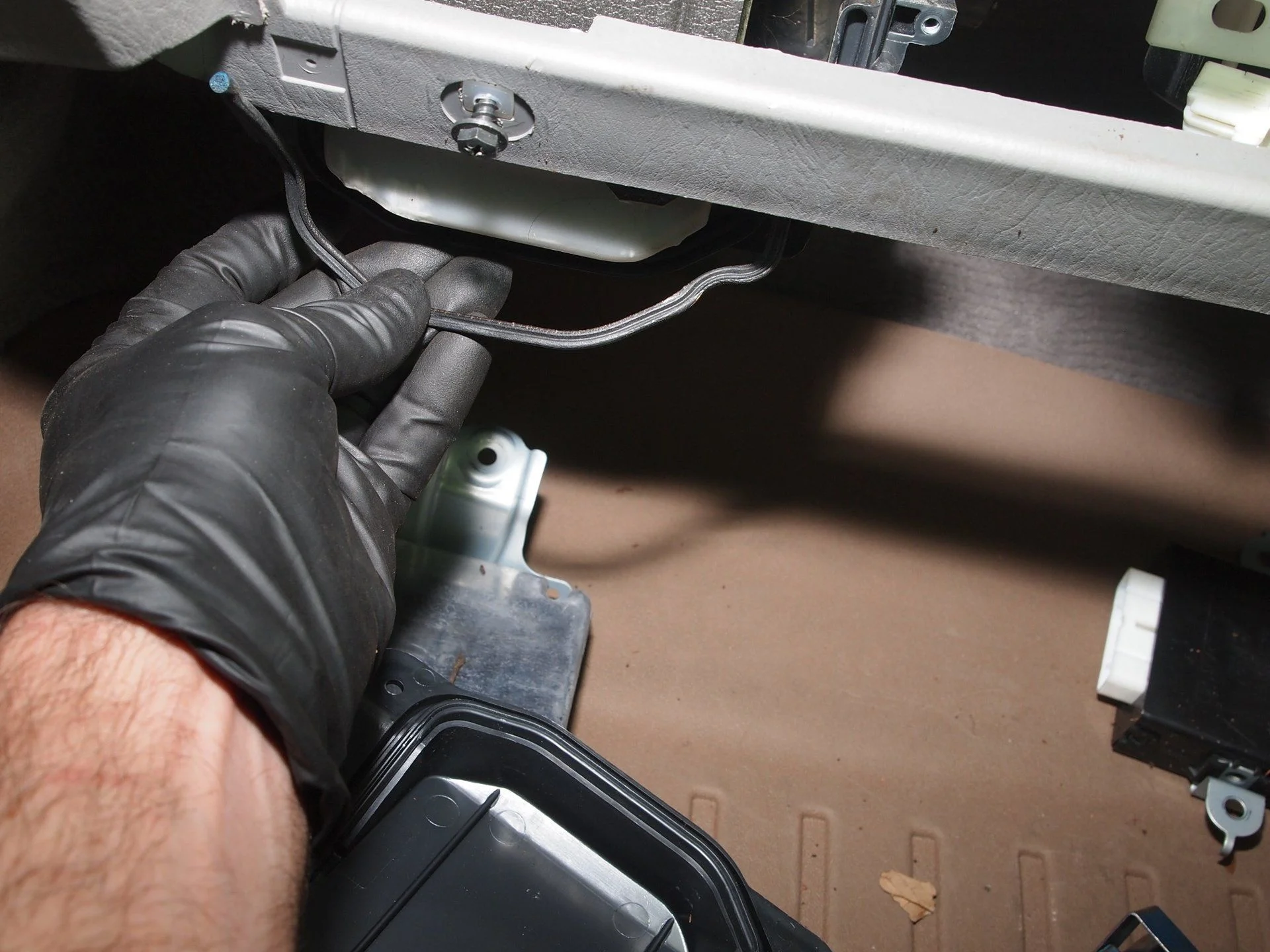

I noticed the bottom of the cover for the evap coil has a small space that allows small drips of water onto the carpet. Was I supposed to put a silicone seal around the cover?

Today was hot. Still have some annoying dripping on the bottom of the evap cover. It's bolted tight but is still dripping water onto the carpet now. Makes me think that maybe there's a seal or something I'm missing that seals the cover. For now, I just put a bead of silicone on there to prevent dripping.
@fooldall1 I use this on the evap door. The toyota part works well also. Silicone will eventually fail pretty fast. Frost king makes some cording also. It's in the HVAC section at lowes and HD.
Thanks! That cover was hard enough to get back on there without having to keep cording attached.. but I will give it a shot..

The factory screws won't hold the cover tight enough once they have been in and out of the plastic a couple times. Can't remember what size I bought, but just go down to the local hardware store (Lowe's for me) and get some STAINLESS hex-head sheet metal screws that are slightly oversized from the factory screws. Those will tighten the factory seal down enough again so that it won't leak.

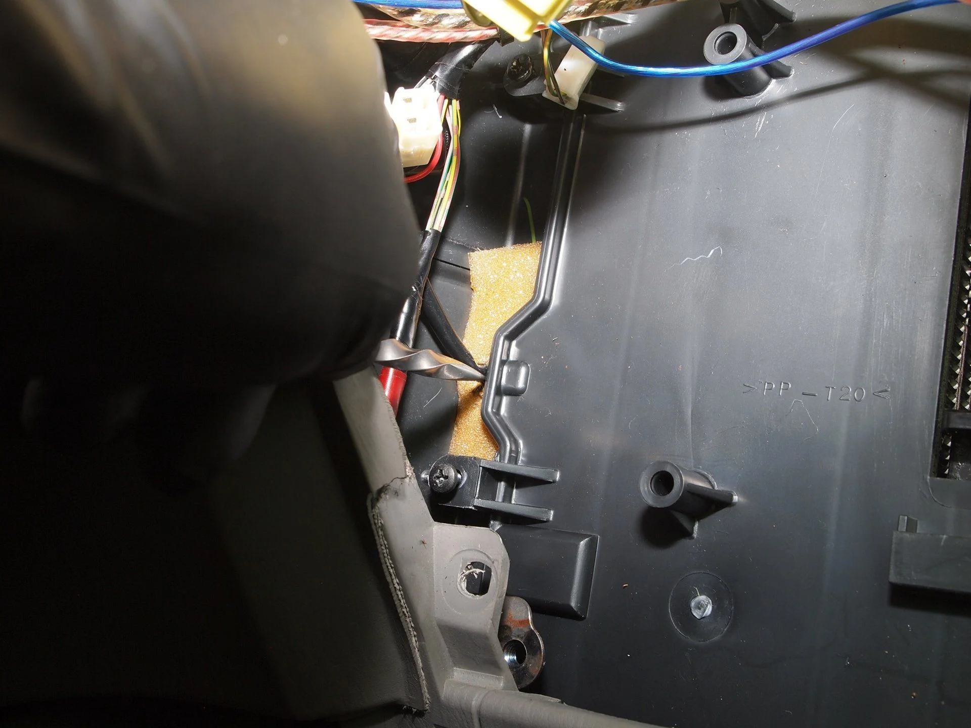

No need to cut dash/frame to remove faceplate of HVAC.
Here you'll see I removed bolt from under carpet to get more wiggle room, I've since done without.

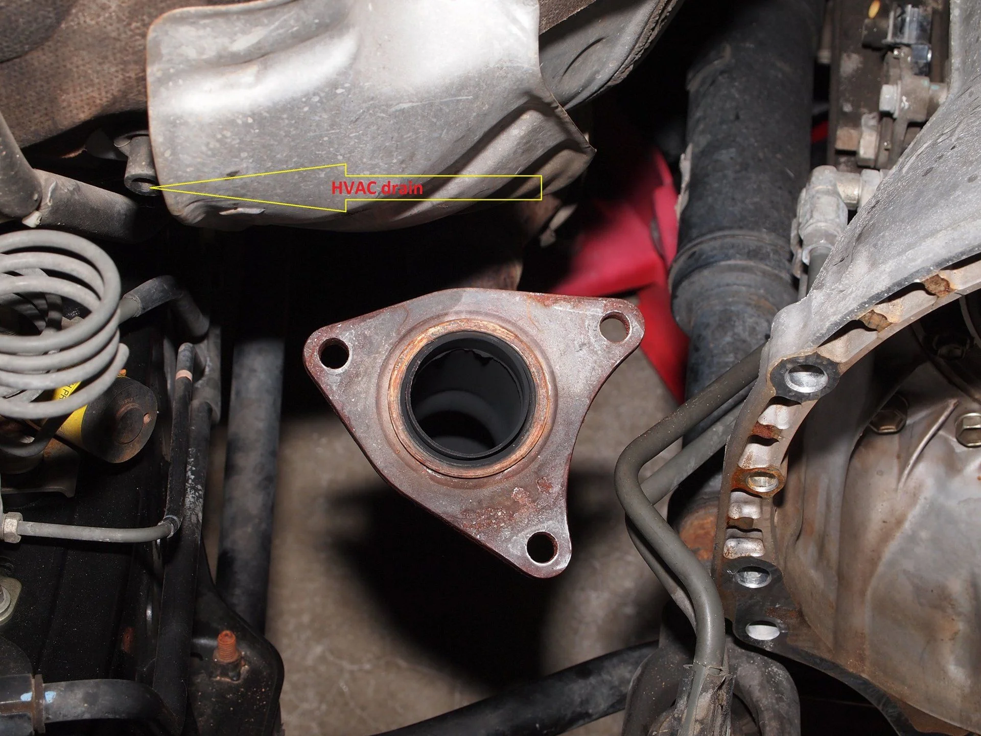

There is a drain which gets clogged, it comes out firewall. If you don't see water puddling under vehicle on hot day with A/C on high, it's likely clogged. If you search mud you'll find many ways to clear out.
Leaves/debris may be clogging that need cleaning out.
The factory seal at bottom of cover may need aligning or replacing. If you're careful when removing/installing screws they will last a lifetime. If they get cross thread or stripped out, it enlarges to hole which a plastic filler will correct. A second choice is large screw, but using a large screw may damage case.
Also make sure wire is properly routed or faceplate doesn't seal well.

The factory seal at bottom of cover may need aligning or replacing. If you're careful when removing/installing screws they will last a lifetime. If they get cross thread or stripped out, it enlarges to hole which a plastic filler will correct. A second choice is large screw, but using a large screw may damage case.View attachment 1806663
