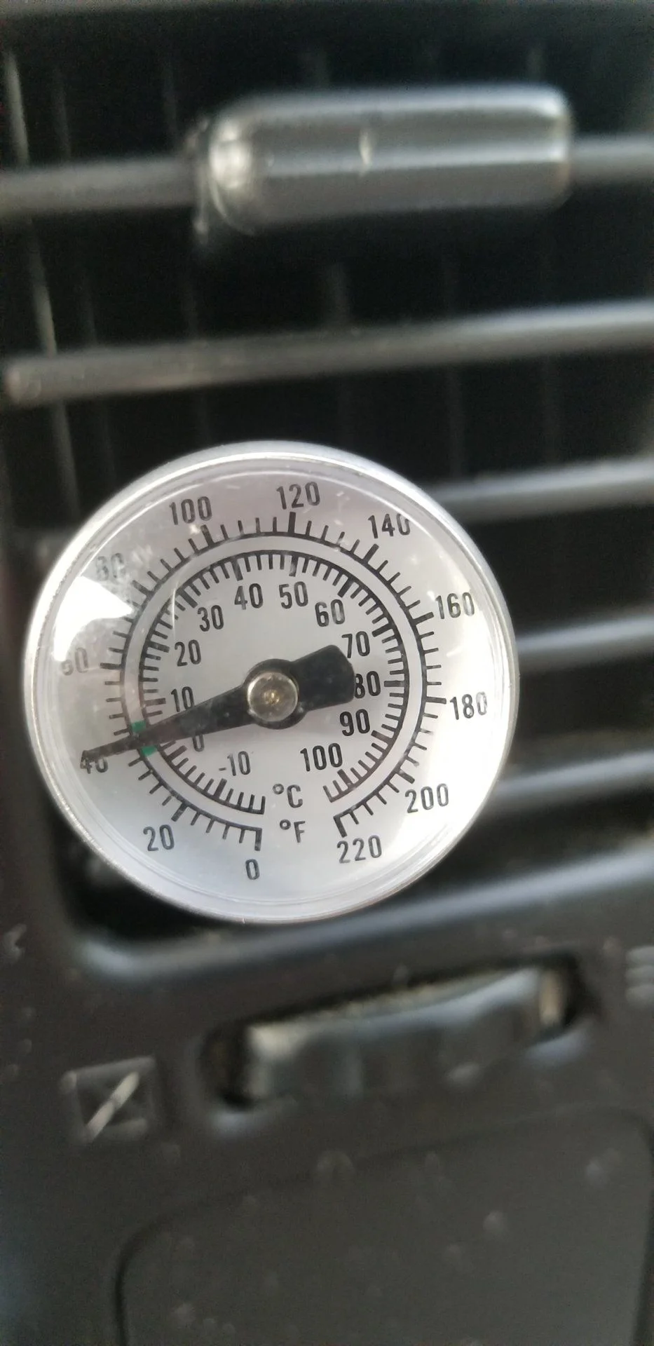

Experts: So, the Garage put in the factory amount of refrigerant, and it gets cold (as you can see). But, I recall seeing a fill chart somewhere that indicated filling the gas to a little HIGHER low side pressure for high-temp and high-humidity locations. For example, I think I saw the pressure on the low side at ~36-40. In the guide I saw, for this truck they went a little higher to 45-50 and got better performance- safely. Basically as @bucfl pointed out- you have to drive around a while to get pressure built up here (maybe its just the crazy humidity) to make it work at what I would consider cold. With a new compressor, and Evap core- I would assume that the performance should be better than I have for the first few minutes after start-up.
Am i just expecting too much?
^^^^^ Yes, 'expecting too much'. It is normal for the system to take a bit to drop the vent temps. The reason for the common (but unreasonable) expectation that you should have cold vent temps immediately stems from a misunderstanding of how the A/C systems works.
Your system is one giant 'heat exchanger'. You Aren't pumping IN cold air, you are REMOVING heat from the cabin air. This takes time. You will need several complete air 'exchanges' before things begin to feel very cool.
Also, the higher your engine speed and the more air moving across the condenser (read highway speed) the better the system will work. It is not reasonable to expect the system to work as well at idle as it will at higher speeds.
There are two things going on every time you activate your A/C. First (and foremost) the system is removing the heat load (and humidity) from the cabin air (via the evaporator). ONLY after the system has had a chance to remove the bulk of the heat (keep your system on recirculate) does the effect of having air from the blower motor across the cold evaporator result in cold air being distributed from the vents in an effective way.
I know the two notions seem to contradict one another. Yes, when you first crank up your properly operating A/C unit...the air from the vents does feel cooler than the ambient, BUT at this point if there were no air exchanges...it would never get any cooler. With each air exchange you REMOVE heat. The absence of heat is what results in what we think of as cooler temps. As the heat load is slowly removed the system works better and better (to a point). Eventually...the vent temps 'can' approach the temperature of the evaporator and at that point...yes you are now blowing cooler air across the evap and out the vents.
Sorry to labor the point but it is well for folks to understand that an exchange of heat (moving it from inside the cab to outside the cab) is what is taking place. You are not (can not) just 'pour in the cool' with respect to refrigerant charge or vent temps.
There ARE (sometimes) gains to be had by 'optimizing' the refrigerant charge. IF you have the time and inclination, you can adjust the charge and see where it works best (it might be a bit under or over the factory recommended amount). But if you have 40°F. vent temps at highway speed (stabilized system) I wouldn't mess with it.

Thanks for the reality check. I can only compare with my wife's lexus ls460 that blows cold pretty much immediately out of the vents even when it's been sitting closed up in the hot sun for a few hours. Cools QUICKLY. You're right, though. I think I'm just being a bit too persnickety about it.
I think you and i are in the same thought process and im expecting too much. Mine never blew exceedingly cold from initial AC ON, but after a few minutes or more blows cold to the point i have to move the AC vents away. I think im looking for perfection and checking the pressures too much, seeing a fluctuation and thinking something is wrong. When i think its just the ever changing heat causing my self inflicted headache.
Reading the manual the other day it states 30-35 pressure in 86-95 degree. Mine is around 30+- and is blowing cold so far. I need to leave this sh*t alone! Im going to give my wife the gauge and tell her to hide it.

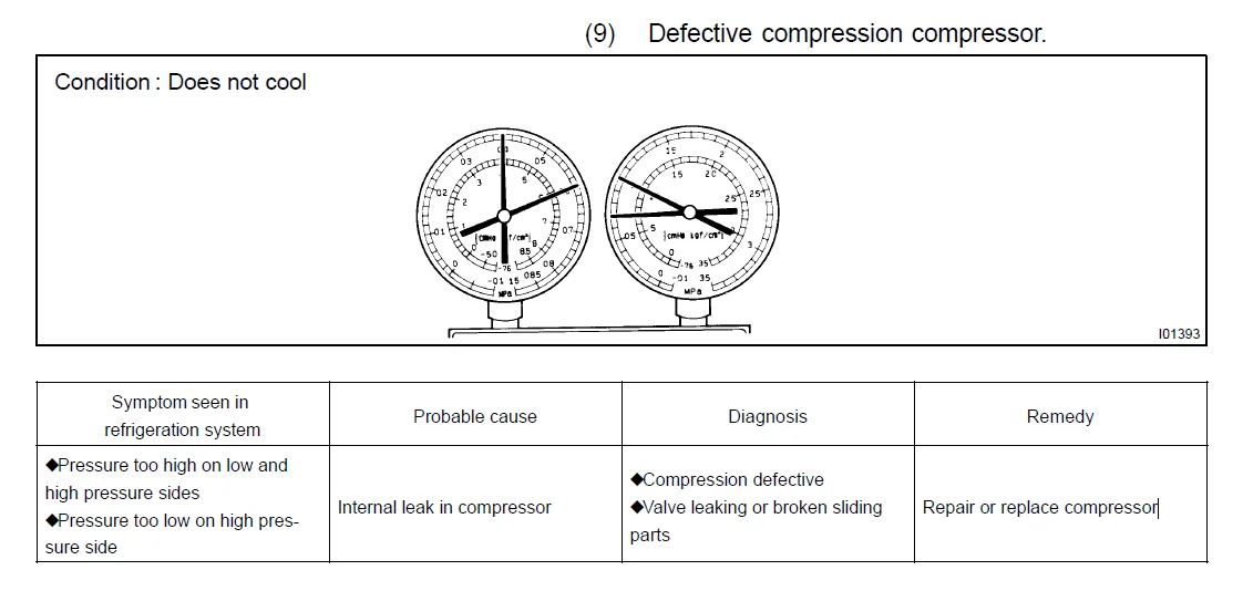

I seem to have a new symptom. After two weeks of no issues, yesterday it blew cold then just cool the rest of the day and been like as of this post. I stopped by to check pressures at autozone and i have 30-35 L and 50 or less H side. I came home and lightly tapped the compressor with a hammer. Turned car on and heard it engage, off then on and engaged again. But still no cold AC blowing.
This is after replacing evap, exp valve, and dryer. I checked sight glass and see good flow of refrigerant and dont notice bubbles.
Does this look right?
Looking at FSM AC page AC-8 (9) Defective Compressor Compression:
If you aren't getting cold air from the vents, you know the manifold gauge is accurate and high side pressure won't build...then yes, replace compressor. You can block the condenser with a piece of cardboard (impedes air flow) and watch to see if the pressure rises significantly, if not...the compressor is knackered.
