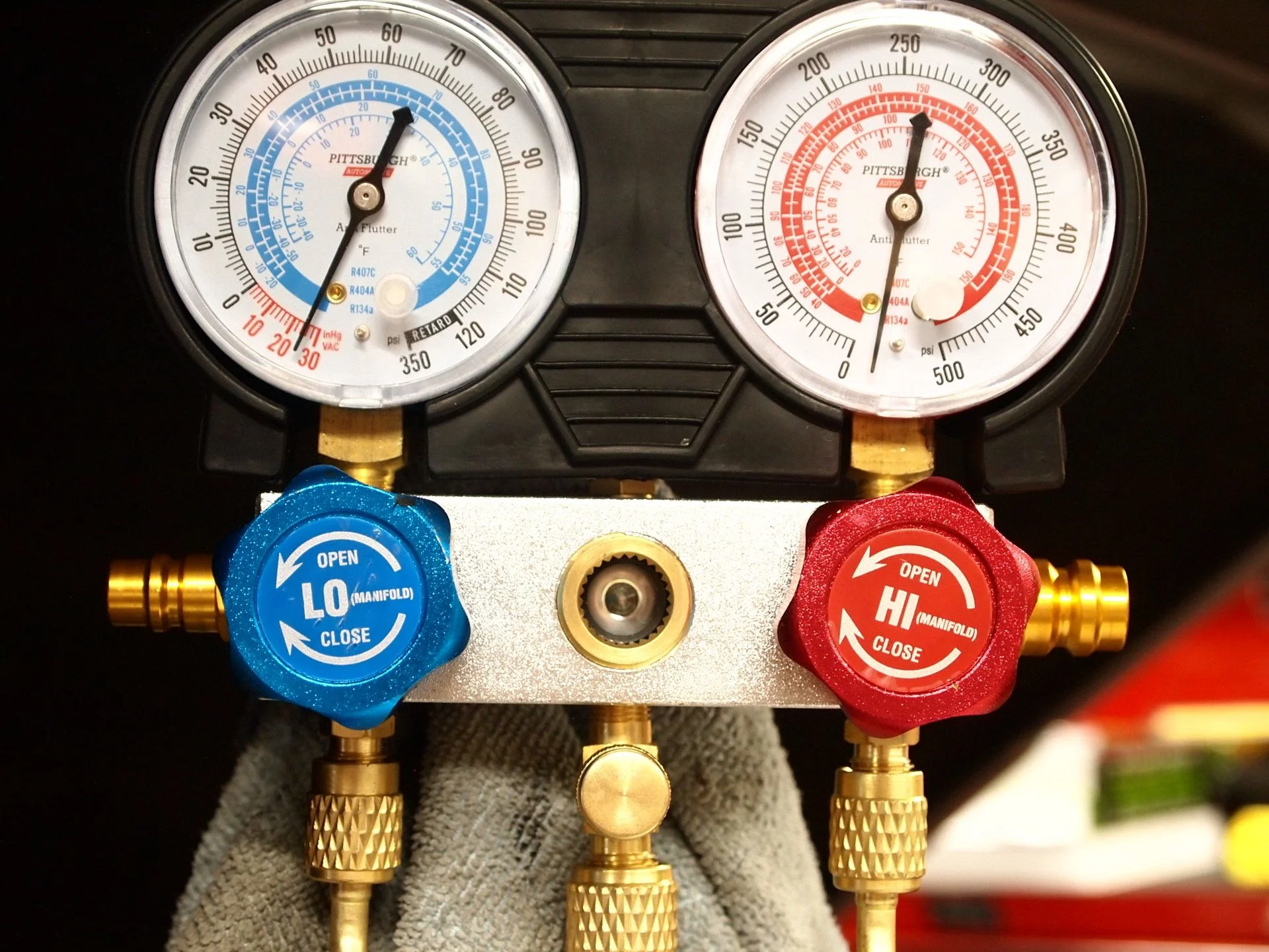

I spoke with Advance Auto about their manifold gauge set, which they said is not very good. So I just picked up another new manifold, again from HF. Cleaned threads and lubed seals with Nylog again. I started pulling vacuum on just manifold with hose connection slightly loose. I then kept snuging down connection until all leaks stopped, finally. New vacuum pump seemed to be working good. The correct O-ring in place with Nylog on it.

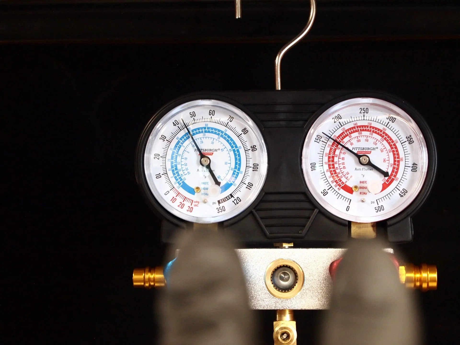

Doing long term test on my AC system, with manifold disconnected until I check vacuum.
Also testing manifold while disconnected from my AC system, to see if it also holds vacuum.
2 hour test, holds vacuum.
24 hours test vacuums hold.
48 hours test vacuums hold.

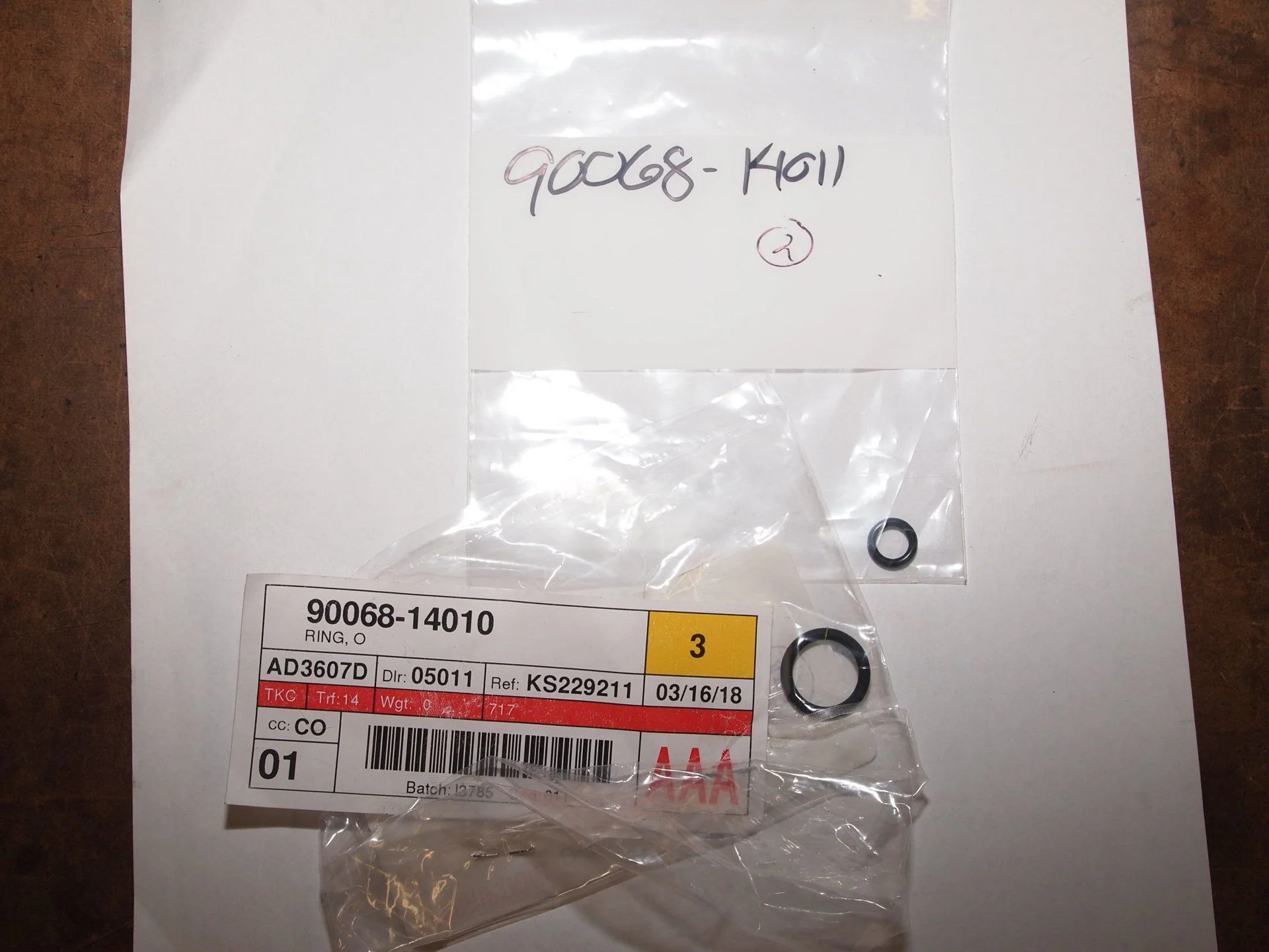

FWIW worth here is what we found about Toyota O-ring. Basically this o-ring is not or improperly label on the Toyota internal parts system.
The diagram show a # 2 (pink highlight), then denotes 2 (small 2, pink arrow) 0-rings. In looking we only see two O-rings on this section of pipe, so assume same for both ends. With no separate parts number for the one I'm looking for (red arrow). This means they're the same, this is wrong.
The number # 2 O-ring is way to small, seen here in PN 90068-14011 which supperseeds the 90099-14120 as current replacement O-ring.
The correct PN # is 90068-14010 or #3 of AC system. Which you can see is much larger than #2. We confirmed this by looking at a rebuilt compressor in the box. It include two O-rings in a package. One was what looked like #1 discharge tube and a #3 suction tube O-rings for connections on compressor.

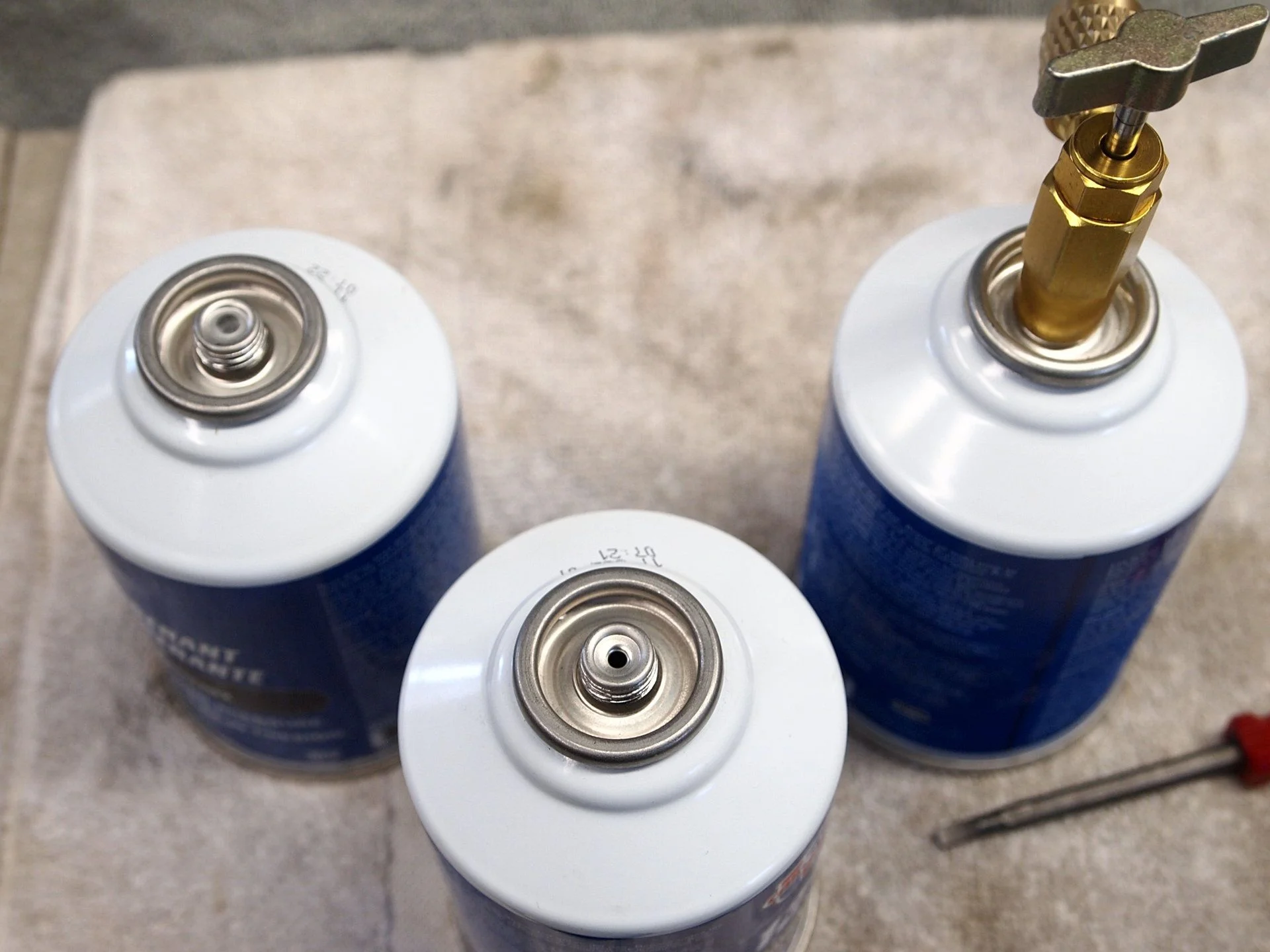

So now that I have a radiator in, I'm able to run the engine and began filling AC.
So last night I add a 12oz can of R134 to H side (engine off). I kept the L side close at manifold and at my AC system side. I could have open system L valve but didn't as I had no reason to. Also I'm still holding a vacuum in L hose, and wanted to keep it that way.
Once I had the whole can in, I closed all valves and just let sit overnight.
So today, as OAT raise to 80 F, I'll be add 2 more 12oz cans to L side with engine on and H side off at manifold (H open at AC side).

I noticed you appear to have a print copy of the epc, seems to be outdated, online there is an updated image of the diagram with that correct part number listed.
Very cool, Thanks. I see this diagram you've posted, actually has PN's (although old) listed on it, and it is correct for the one we had so much problem with.

Thanks guys, but I didn't wait to hear from you guys as it was getting late for me. I just went ahead and charged in one more can into L at idle. AC started right up blowing cold in front but not as cold in rear, just from the one can in H side the night before.
I didn't track my time, but I'm sure it took more than and hour, to do just this one can into L. I rocked the can from 12 to 3 o'clock once and awhile, more so near then end as can became very lite. I deicide to stop (pause) charging after this second can, as I really don't like idling so long. I'm also burping the coolant system and most likely a little low on coolant. So pause will also give me the opportunity to add coolant to radiator. This new CSF radiator is hold mayby 1/3 gal more PINK, than the Spectra I just pulled. So I'm cooling down until this evening, after a 5 mile drive to pick up some more Toyota SSL (PINK).
Anyway, that now makes 24 oz minus a faction for bleeding of yellow hose, based on published weight on can.

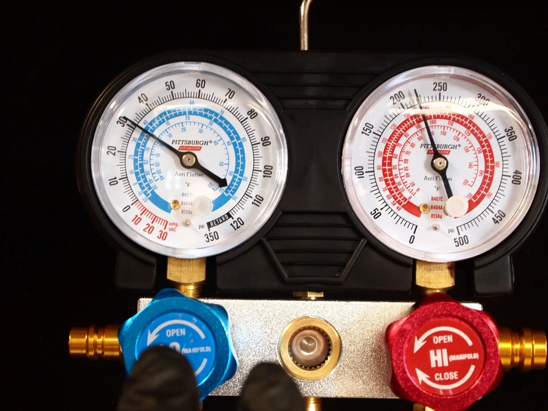

Once I had 2nd can in, I ran engine up to 1,500 rpm to inspect sight glass (foaming) and watch PSI of L & H. I turned off AC and saw it stayed mostly foamy. I then turned off engine and looked at the thermometer I had setting in in AC vent, which read ~50 F. OAT at the time was ~85 F.
I've worked diligently to get every drop out of the 2 cans of R134, into my AC system. The system calls for 35.2 OZ minium, and I've only 36 OZ total. In fact; I held can upside down with hose and can above manifold, once it felt empty (no rattle, not cold when inverted or shaken). I then closed the H valve, disconnected AC of my system. I then opened H of manifold hold both H hose and yellow hose w/can needle valve turned tightly in (closed), above the manifold.
I then closed all valves, and hung manifold up away from my rig. Manifold is still showing various PSI in H & L.
Adding the last can I assume will take even longer, but almost done and already blowing cold.
Starting to add second 12 OZ can.
As I near end of second can, I'd rotate 12 to 3 o'clock. Sounded like switching took place in AC system, I assume pressure switch. L would jump and H would drop just for a moment.
Second can in RPM at 1,500, pressures were stable.
FSM: At OAT of ~86 F
L 21.30 to 35.55 PSi
H 199.08 to 227.52 PSI
Needle turn all the way in, closing yellow hose.
Done all three cans in (36oz). AC seems to be working fine. Seeing clear in sight glass mostly at 1,500 RPM, foams as I hear it switching occasionally. Foams as I turn off AC then clears.
