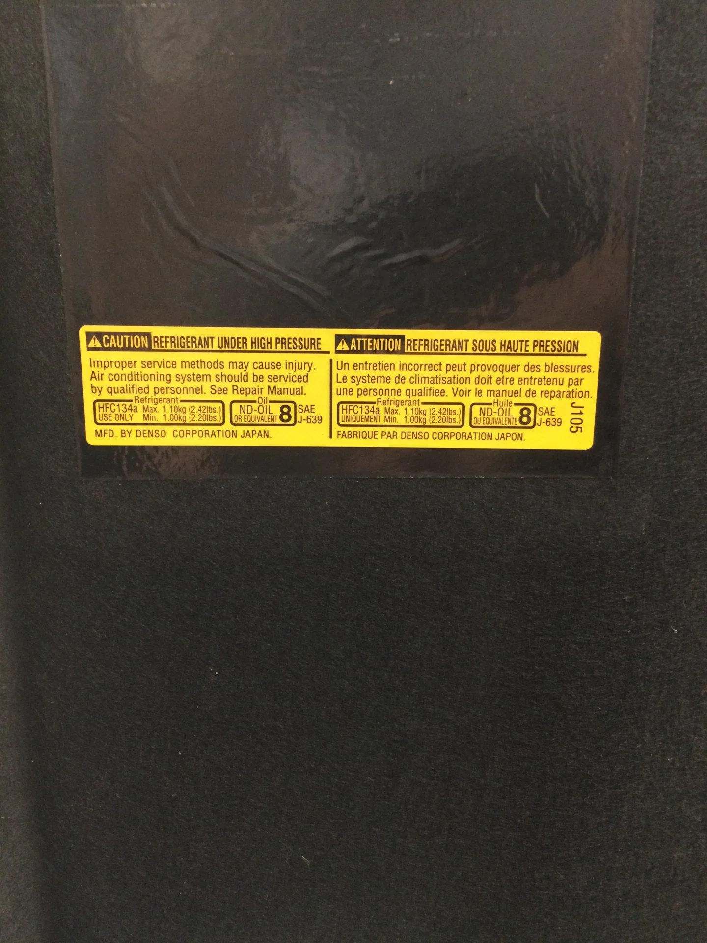

PAG-46 oil and R134A refrigerant. I think the amounts are listed under the hood. The amount of oil to add depends on how much oil is in the system still. Were the lines flushed? I guess you could just add the FSM amount? Too much is better than too little.

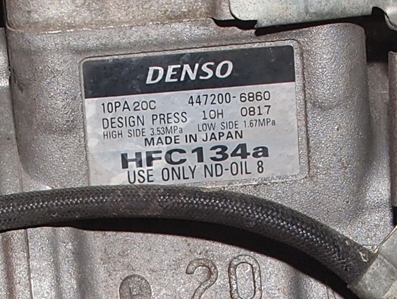

2) ND-OIL 8 is spec in FSM for AC oil and Denso oil is my preference to insure compatibility with factory oil. But nowhere does it say to add oil to compressor. It repeatedly in all FSM (01, 05 & 07 hard copies and current TIS), but does state to add 1.4oz to condenser and evaporator, and all coat o-ring(s) when replaced.

My FSM calls for ND-OIL 8 or equivalent. I would use PAG 46 if this was mine.
I can't find oil info for the compressor too. However, I found the following from the 80 series FSM, this should give you an idea on how much to use in the 100 series.
Compressor oil - ND–OIL 8 or equivalent
When replacing receiver - 10 cc (0.35 fl.oz.)
When replacing condenser - 40 cc (1.4 fl.oz.)
When replacing evaporator - 40 cc (1.4 fl.oz.)
When replacing compressor - 120 cc (4.1 fl.oz.)
From this web site: http://www.denso-am.com/media/corpo...essor-oil-and-refrigerant-mixing-old-and-new/
"DENSO uses ND-oil 8 for its R134a type refrigerant compressors, a PAG 46 oil."
So it seems that ND-OIL 8 is just a brand name for PAG-46 oil. Denso sells it in 250cc containers, part# 997635-8250, but a quick Google did not really reveal any online sources.
Simply purchase ANY PAG-46 oil, it doesn't matter who manufactures it. All of it is produced to provide certain standards and properties.
Based on the link to Denso, must be more than brand name. It states the ND-12 has additives specifically for the new R1234yf:
"DENSO uses ND-oil 8 for its R134a type refrigerant compressors, a PAG 46 oil. The new refrigerant type uses ND-oil 12, also a PAG 46 oil but with additives specifically for the R1234yf type refrigerant."
So we can use either, but I'll stick with ND-8 PAC 46 oil SAE J-639. Very good chance Denso sources from Exxon. So I look for Exxon under manufacture if I can't find Denso.
So that's a lot more info then the 100 series. I assume 80s have Denso compressors as well?
