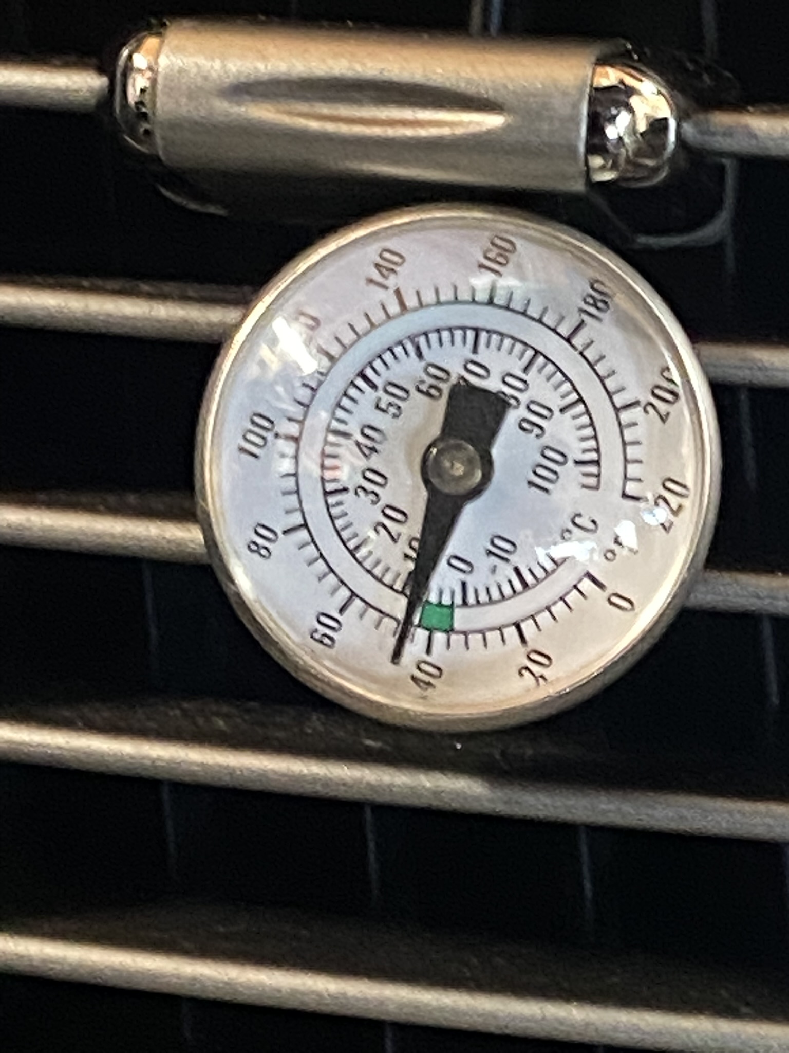

So I did get to around 45F. After re vacuuming and charging. Used a new: yellow hose and 134a resealable can tap. At first I got the same (52F) then bought new thermostat and saw improvement. But still not 45F or less. Then I add 3 more oz of 134a. Tmep hot ~43F. Seems I was underfilling, by using 3 16oz 12 oz cans. Likely due to loss while bleeding air from H & L lines to manifold and bleeding yellow between can swaps..
Now that COLO requires reseal cans. I can easily stop and store partially used cans.
~45F actually saw it hit the green (~44F) at L35PSI H220PSI
The good thing about charging the system yourself (vs. taking it someplace) is that you can take the time to 'fine tune' the system.
'Chase' the last 2-3 degrees of vent temps. Adding or subtracting small amounts of refrigerant until you reach the point of diminishing returns.
A 'shop' is not going to do that. They want to get the vehicle in and out as quickly as possible.
When you get the vehicle up to highway speed and have had several cabin 'air exchanges', you should see even better temps. Good Job!

Ambient temp reading between 91-93F
At a stop saw 45-50F, while driving saw 43-47F
Coolant temp 193-197F

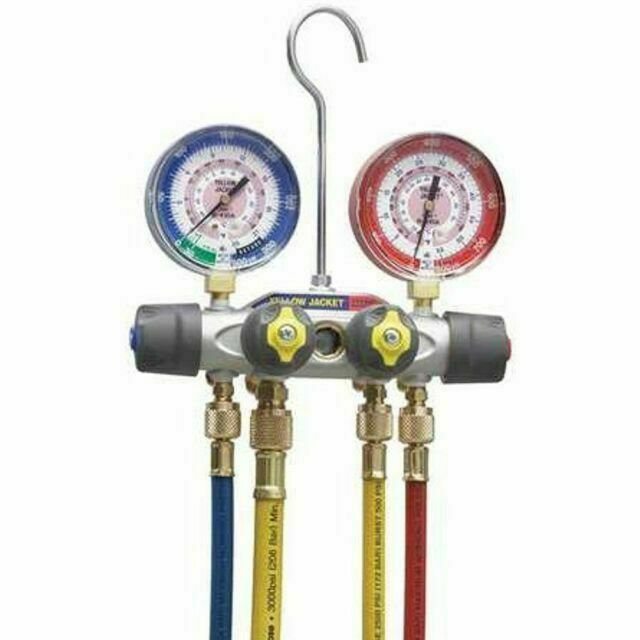

I'm pretty sold on the 49967 set. It is a good quality analog set with all the features you might need.
To go 'up' from there, you are talking the newer digital sets that can run well over $1K
A good manifold set with good hoses and a 'good' 2 stage vacuum pump is all a person needs to get started IF servicing vehicles for a living. The DIYer/home mechanic that works on systems infrequently can do with less of course.
Most sets don't include the High/Low side connectors....as there are different styles and folks like to choose their own. Don't scrimp there and create a weak link in your equipment.

Be sure to get a set that includes R134a.
Yellow Jacket 49983 TITAN 4-Valve Test and Charging Manifold 3-1/8" Gauges (psi, F) for R-22, R-134a, and R-404A​
Oh NO! I just look to see the 49967. Now I see the listing heading states 49967, but picture of box shows 49867.
Is it just a matter of using/getting R-134a hoses for the manifold?
No, the gauges themselves need to have a R134a scale on them.
