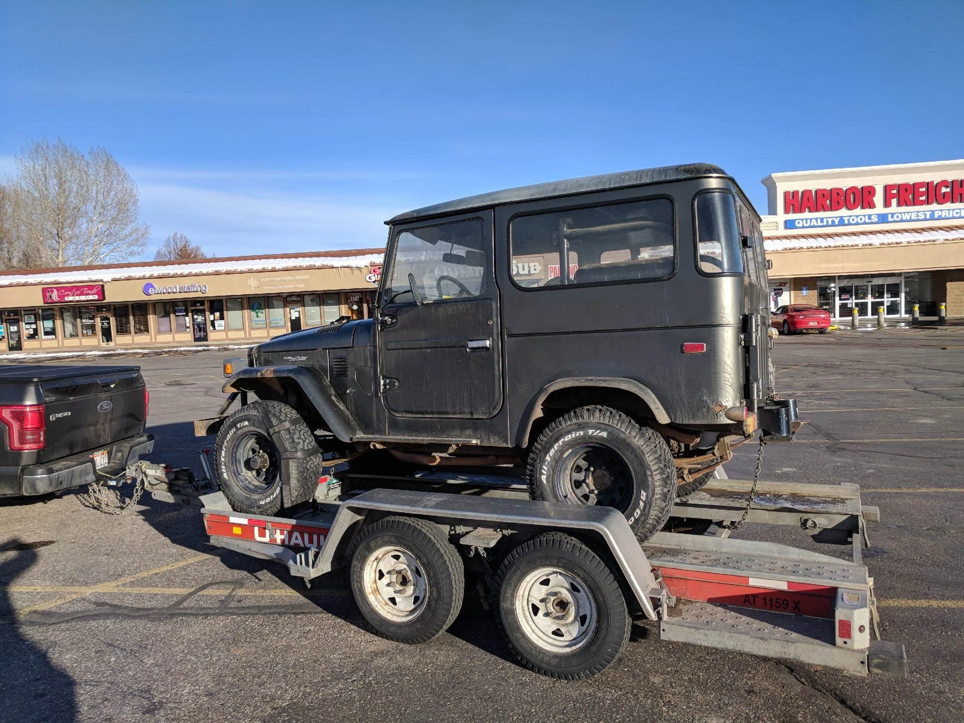

I'm a dad of 4 kids. Since my first son was born, I planned on someday, when the time was right, to rebuild a car chosen by that child. For me, that time has come.
My oldest son is 13, and he has looked forward to the day that we could start working on his car together. Although maybe a year or so premature, he decided that he wanted a 70's FJ 40 for his project, and it so happened that a family friend who has owned his for 30 years was willing to send it to a good home.
So this past weekend, we hauled this '76 FJ from Colorado to it's new home in Heber City Utah.
Here's the thing, although I certainly have some limited experience in mechanics (I rebuild a '69 Mustang as a kid), as I read through all the Mudder projects over the past few months, I'm quickly realizing that I don't have an fraction of the knowledge about how to tackle this project compared to others! To say I feel overwhelmed is an understatement:)
So I'm hoping that you guys can get me started on the right foot. Before I remove, grind, or replace anything, I am taking the next couple of months with my son to ensure that he understand how the truck works, what the different parts of the engine are, etc. So that gives me a couple months to really outline a rebuild strategy (hopefully with your help)

Make it drive, steer, and stop straight first and enjoy for a while. Have him help make a plan.
Lucky boy and good looking cruiser there!
Why swap the tub? I see some crusties but nothing horrible. More filler than it shows?
It actually doesn't have any filler, but the rear right corner has some significant rot...
Just curious. That panel is available and a whole lot less involved and $ than a body swap (esp when you add paint) Plus id venture to say if value is in mind the original body will be worth more in the end depending on direction of build.

The body looks pretty good to me. I'd think hard about fixing what you have instead of an aluminum tub.

Looks like a good start with that truck... with the noncruiser color it was done over at least once before... and what looks like bondo on the front fender i’d dig around
The rear panels could have already been replaced... not that that’s a bad thing ... but... you want to poke around
Looks also like OME rear springs ... can’t really see the front one...
You should post up LOTS more pics for us to evaluate what you got :)
But as of right now I can tell you you got a good truck to start with and since you came to get a 40 and not a heep your already teaching our boy well... orrrr did he teach u by asking for the cruiser ? Lol

For the record, I have both welded in new panels and swapped a 3/4 aluminum tub. Welding in new panels is MUCH easier and less involved than swapping in a tub. I'd choose that route any day if the steel is salvageable.

That picture tells a tale. I see you are close to Harbor freight. Get used to it, you will see that store a lot. Nice vehicle and a great one for a young man to learn on.
