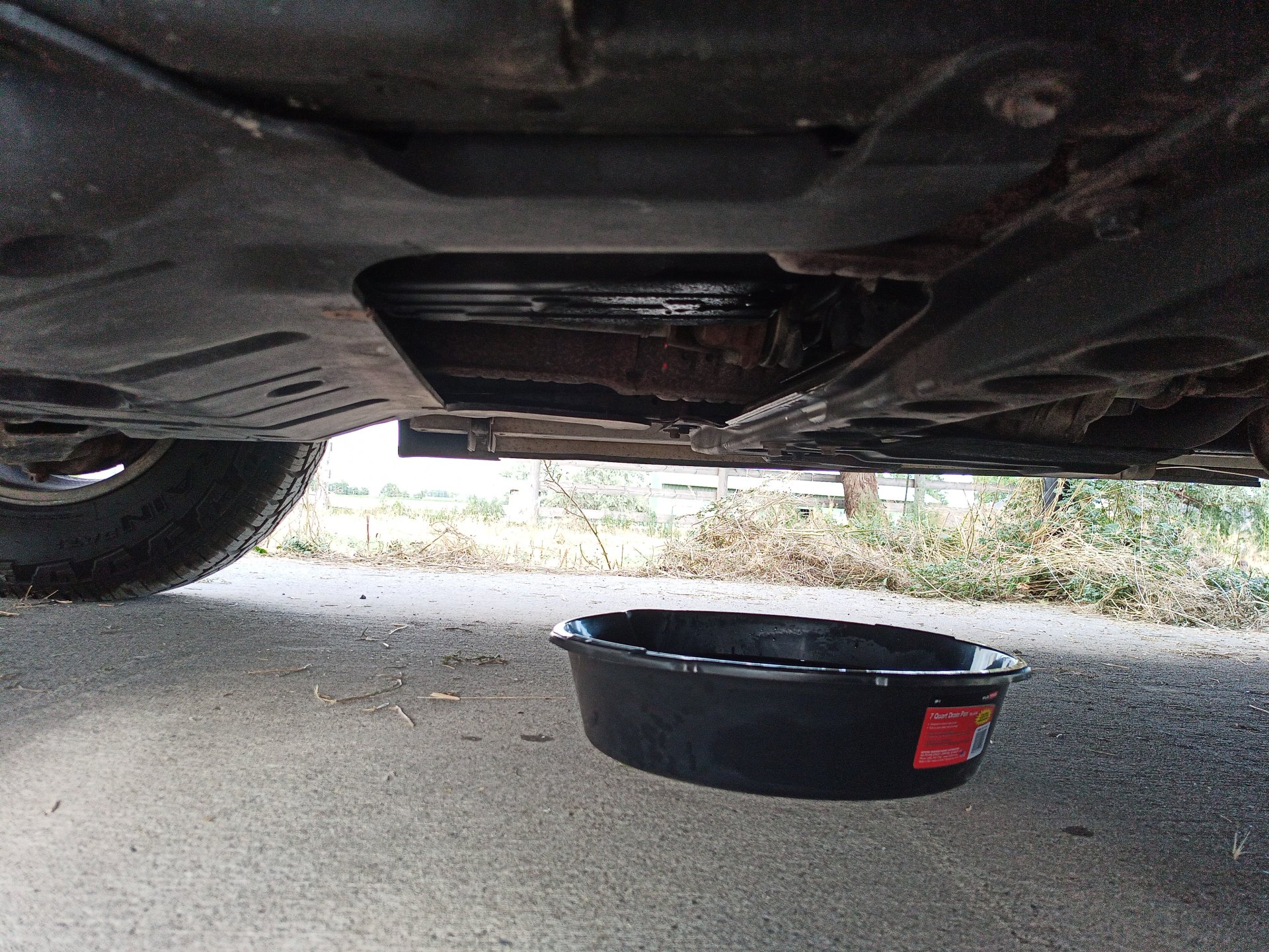

Seems to be going okay. Of course I got some on me and the ground.
There wasn't a gasket on the drain plug so I used a 12mm spare I had. Seems to fit.
Went with Valvoline Max Life Full Synthetic.
I couldn't get it to go into diagnosis mode so just idled it for 20 min and then opened the drain plug to let out the excess while still idling. Ended up over-torqueing and cross-threading the drain plug, it doesn't tighten to a stop and keeps spinning but it doesn't seem to be leaking. Also spilled a ton of the atf and had to do a lot of clean up. It seems like I ended up putting in less than I took out, but it's hard to tell.

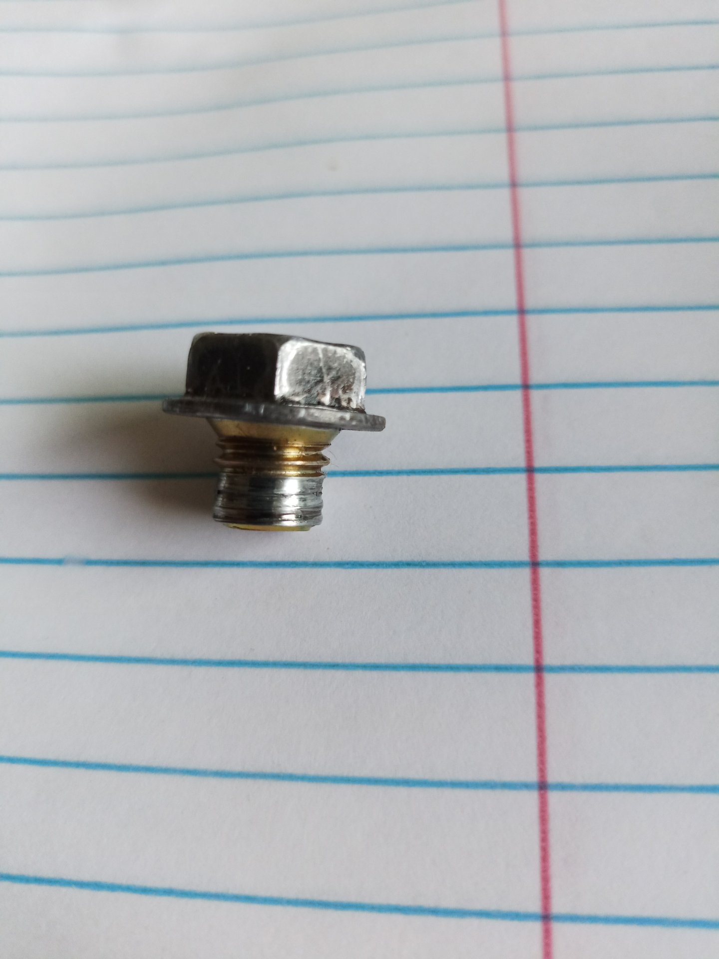

The drain bolt tends to get stripped out, I don't think there is very much meat to the threads in the drain hole.
This is exactly what happened to me, now I'm stuck trying to find a replacement.
I'm worried I may end up needing to get a whole new pan, and I'm having trouble finding one.
In the meantime I may have to get one of those tension plugs they sell at auto stores, but I'm not sure if those are a trustworthy solution.
Does anyone know the size of the transmission drain plug and a source where I could get a new pan if it comes to that?
The drain plug is softer metal than the pans capture nut.
Buy a new OEM drain plug and gasket (crush washer). Use a thread chase, to clean threads of capture nut.
Tip: By adding grease to threads of chase tool. You'll capture (most) metal practical in grease, that are cleaned from threads.
Toque new bolt to 13ft-lbf.

I ended up running a chaser through it and just using a same sized bolt since I didn't find the actual plug local. It's a bit longer but it fits. Gonna let it sit overnight to see if it holds. I need to get that torque wrench checked out, make sure I am actually getting it to the torque it says it is. I feel like the click isn't always obvious. Anyway she ran smoothly this time with the 3.5 L in, if the bolt holds in 200 miles she'll get another drain and fill. Hopefully it does so I can get to addressing the alternator and the rusted out muffler.
Rock auto had the plug size as m10 1.5 so I went with that and it seems to be correct.
I use only OEM drain plug. As I'm reasonable assured, drain plug thread's metal softer than pan female threads. I also use new OEM washer/gasket, every time. But washer can be non OEM.
Yeah that is a worry. The new bolt is definitely harder than the oem plug. Maybe I'll order an actual plug in for the next change so the pan is protected from stripping.
