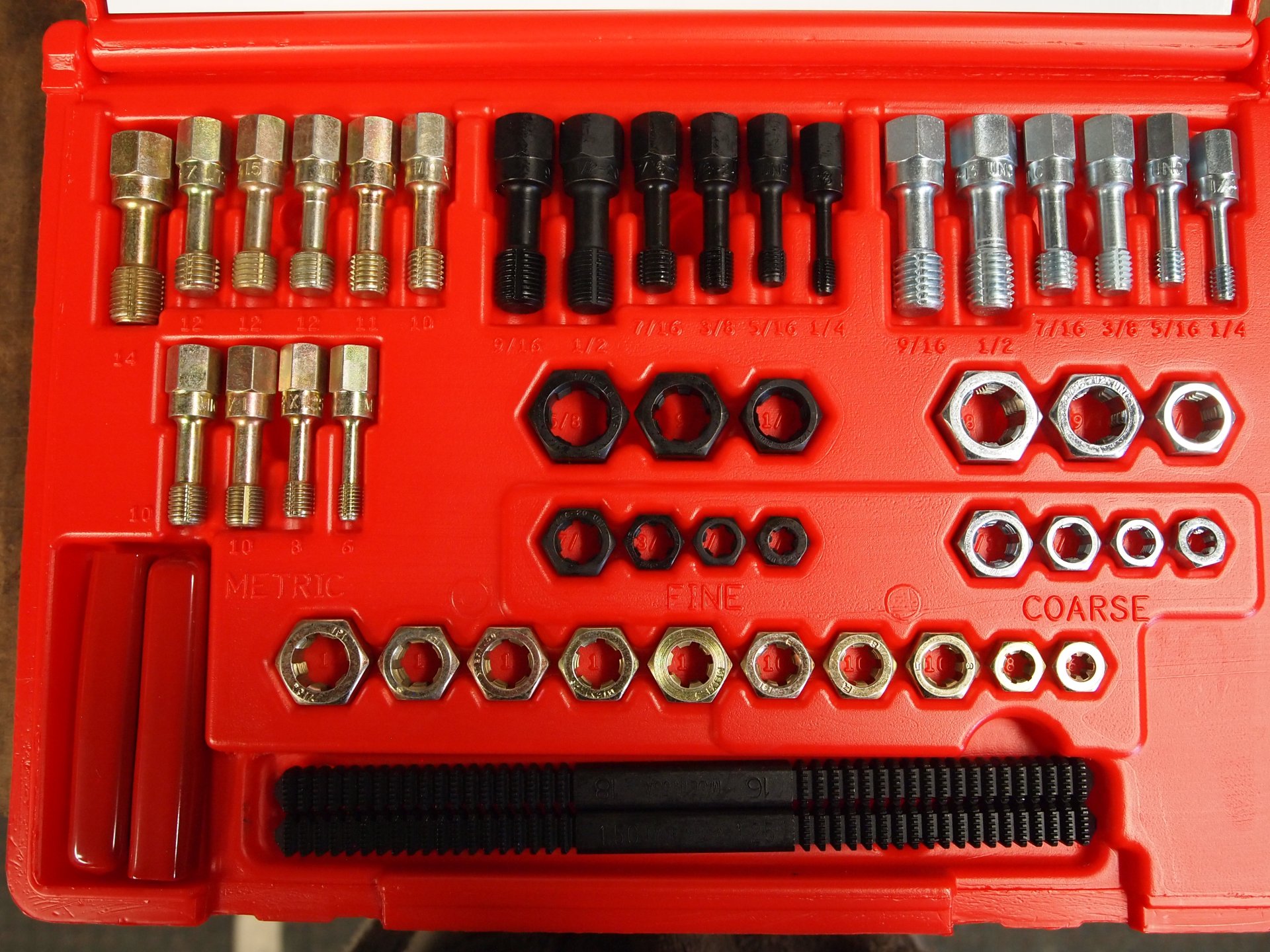

The drain plug is softer metal than the pans capture nut.
Buy a new OEM drain plug and gasket (crush washer). Use a thread chase, to clean threads of capture nut.
Tip: By adding grease to threads of chase tool. You'll capture (most) metal practical in grease, that are cleaned from threads.

Parts store rent chase tool kits:
