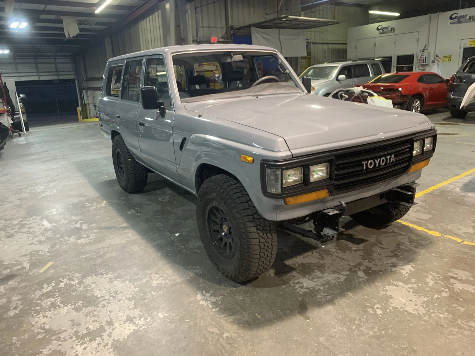

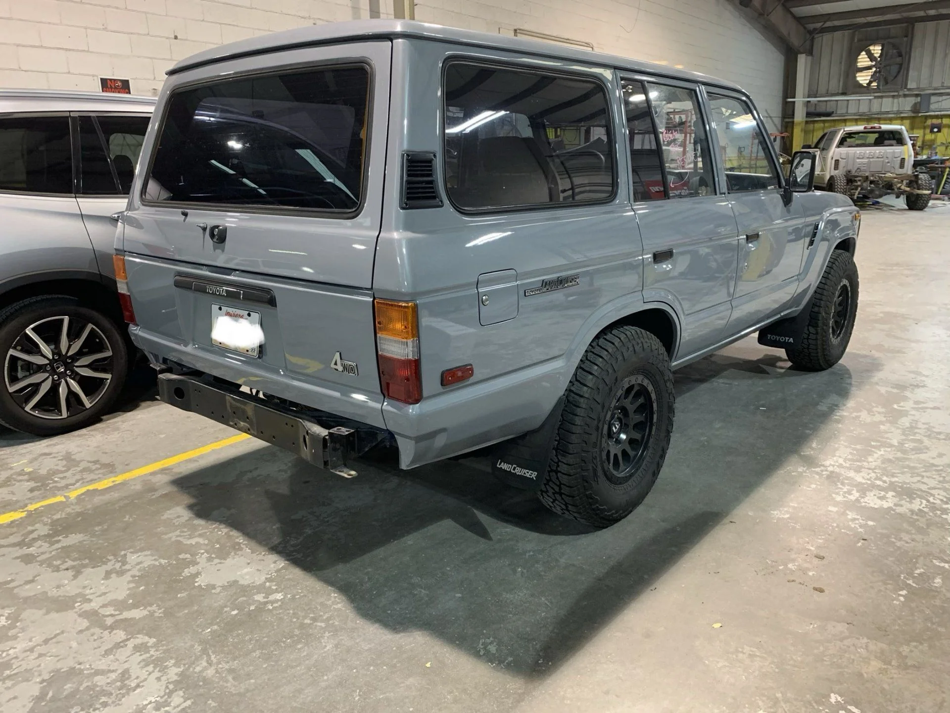

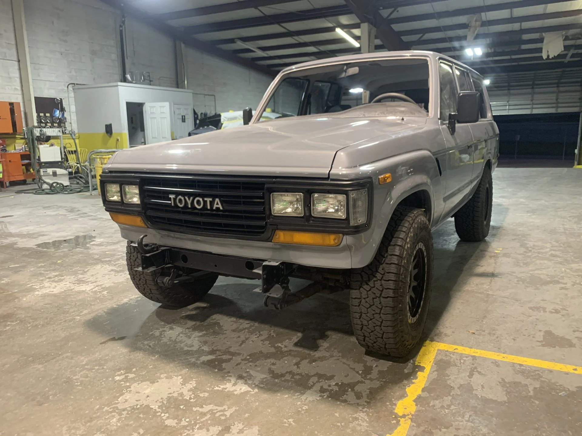

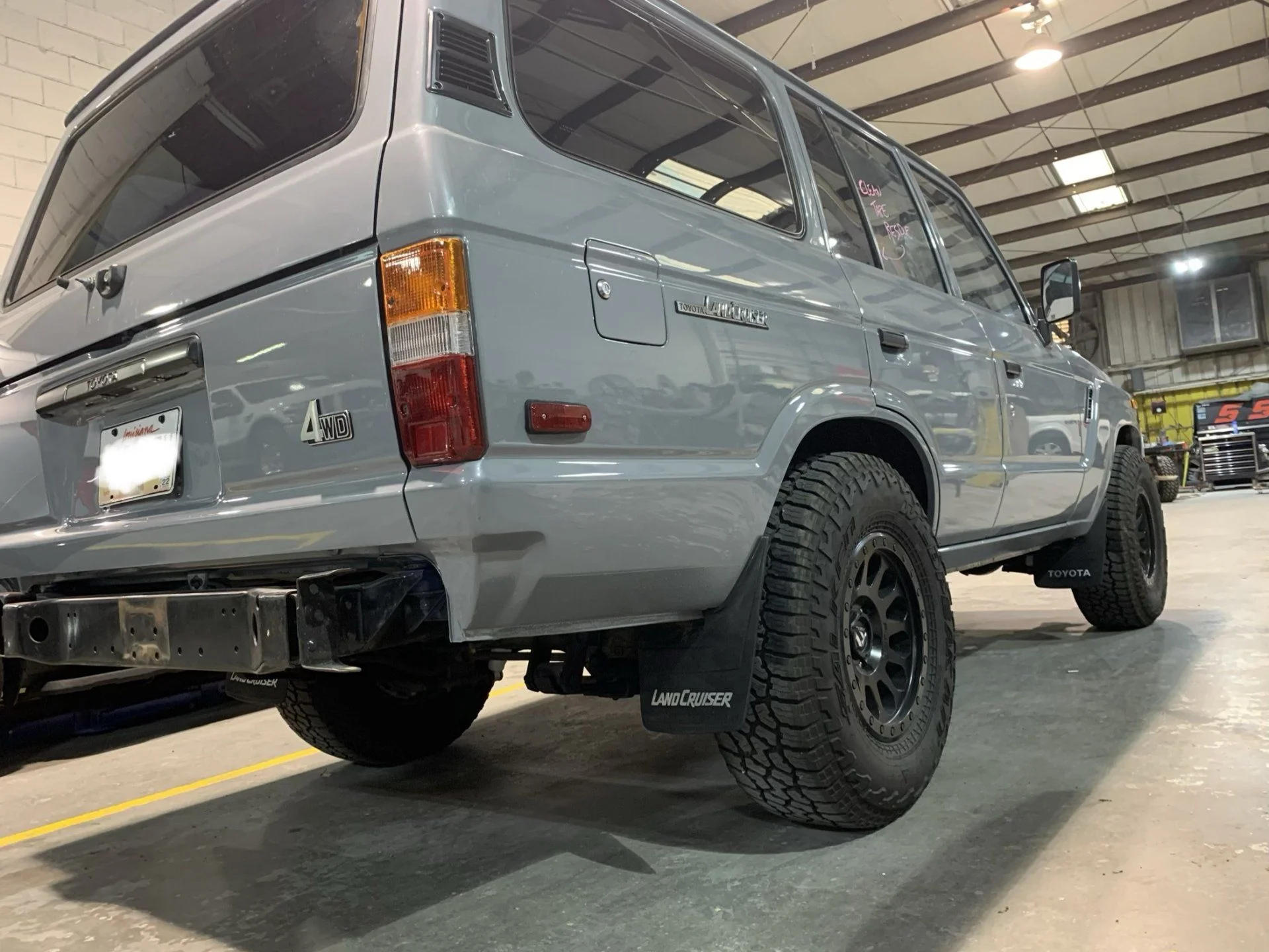

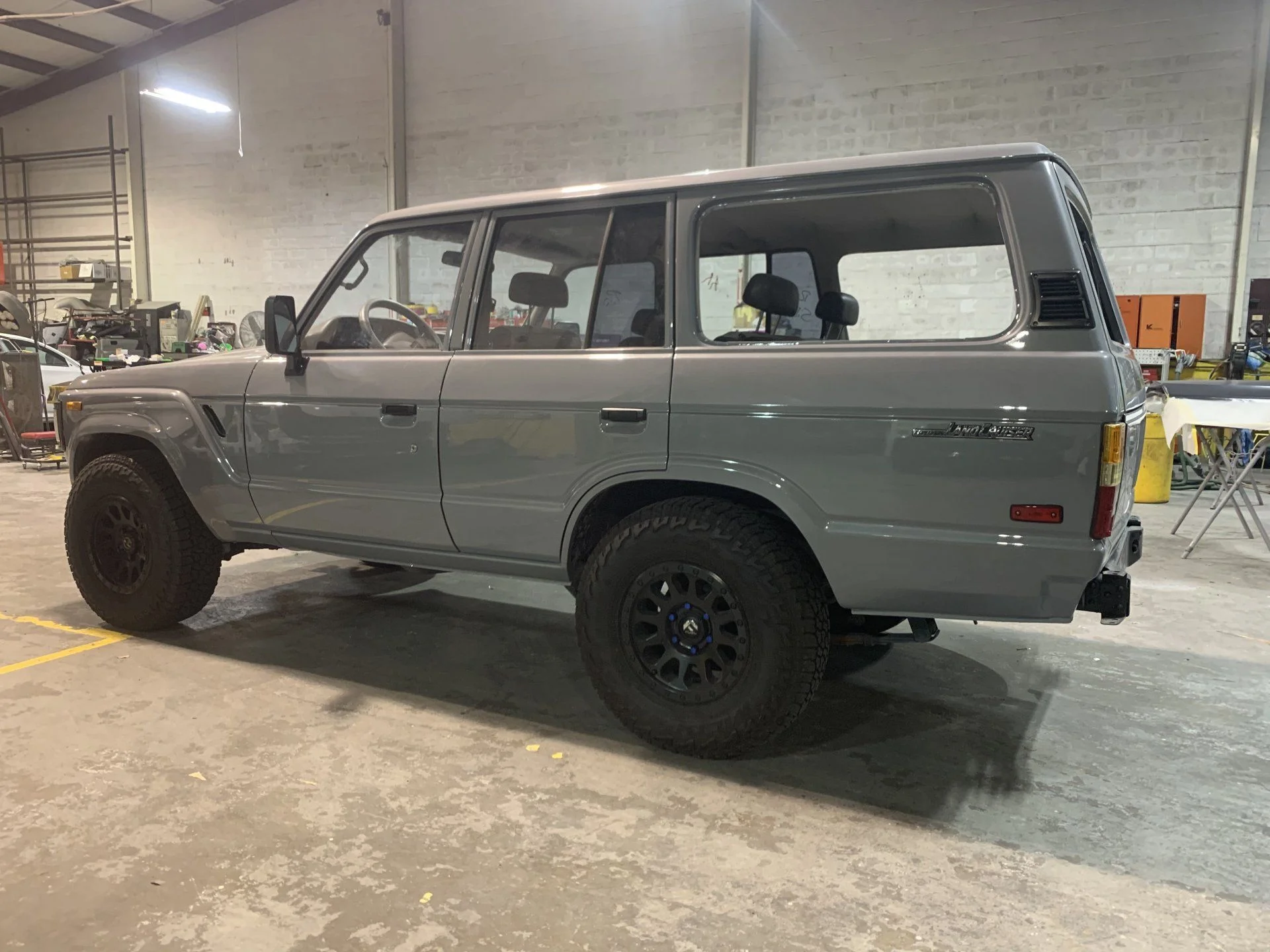

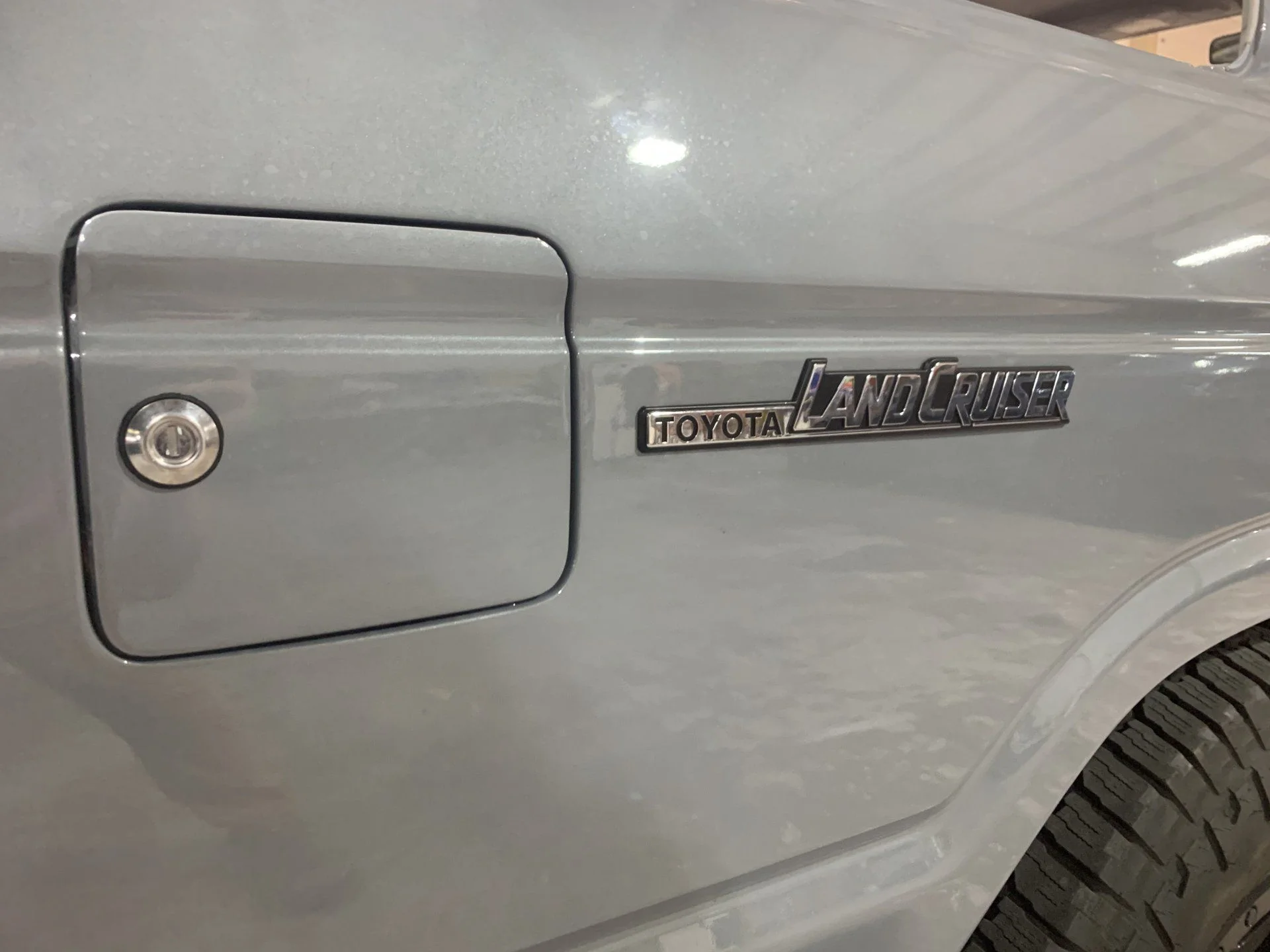

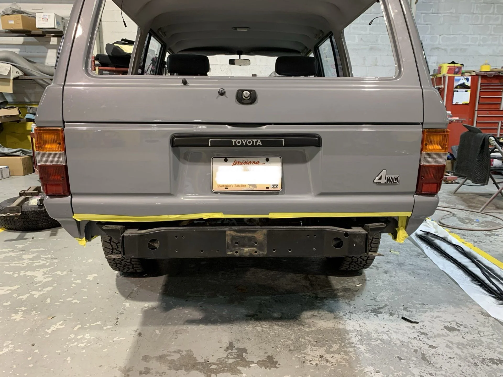

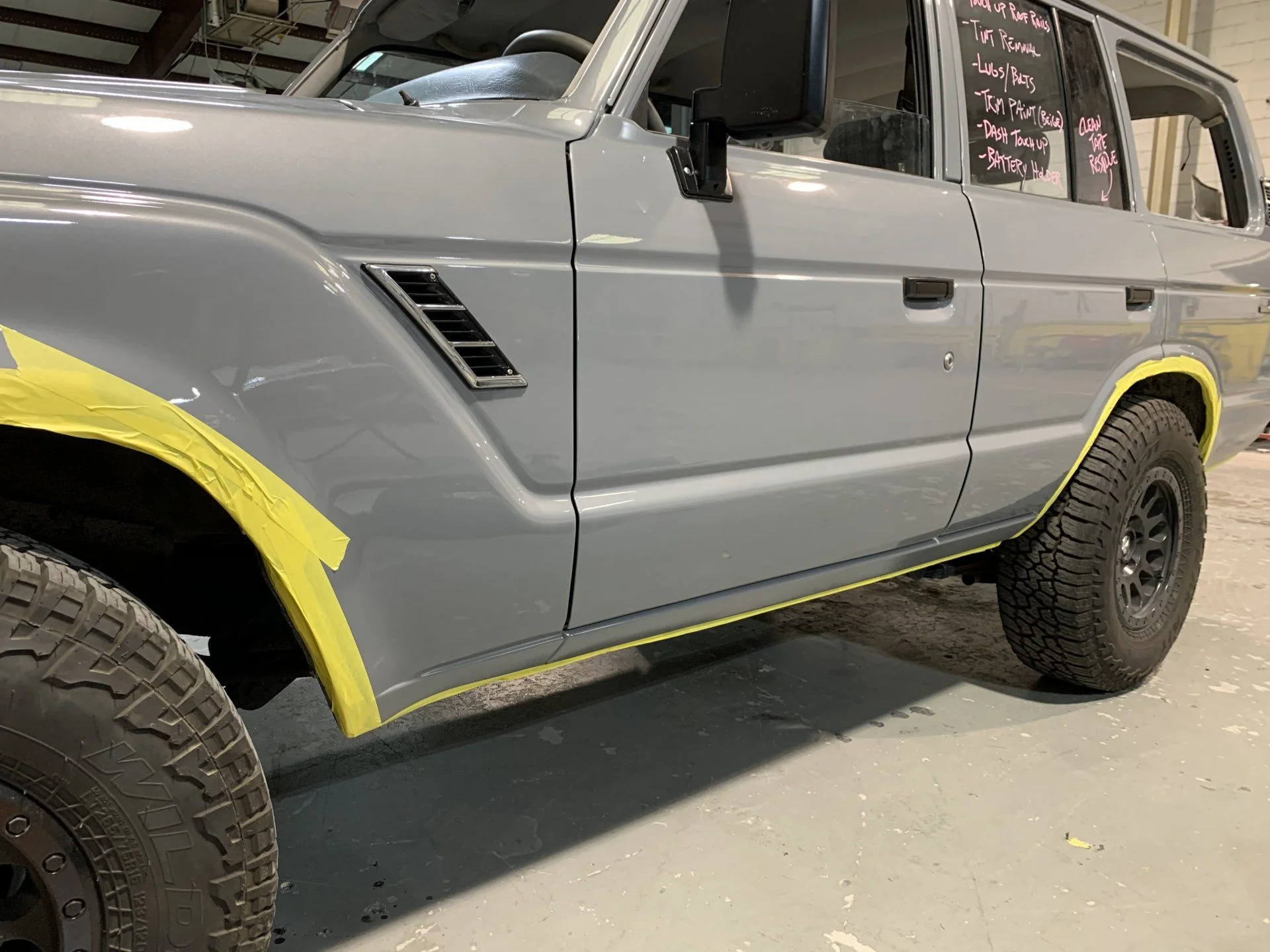

88 FJ62, in process. Stripped, epoxied, 2k primed, based, and glamour cleared - color is Toyota Cement Gray... any suggestions on resto-modifications? TRD running boards, roof rack, etc?
Looking for any suggestions, thanks.

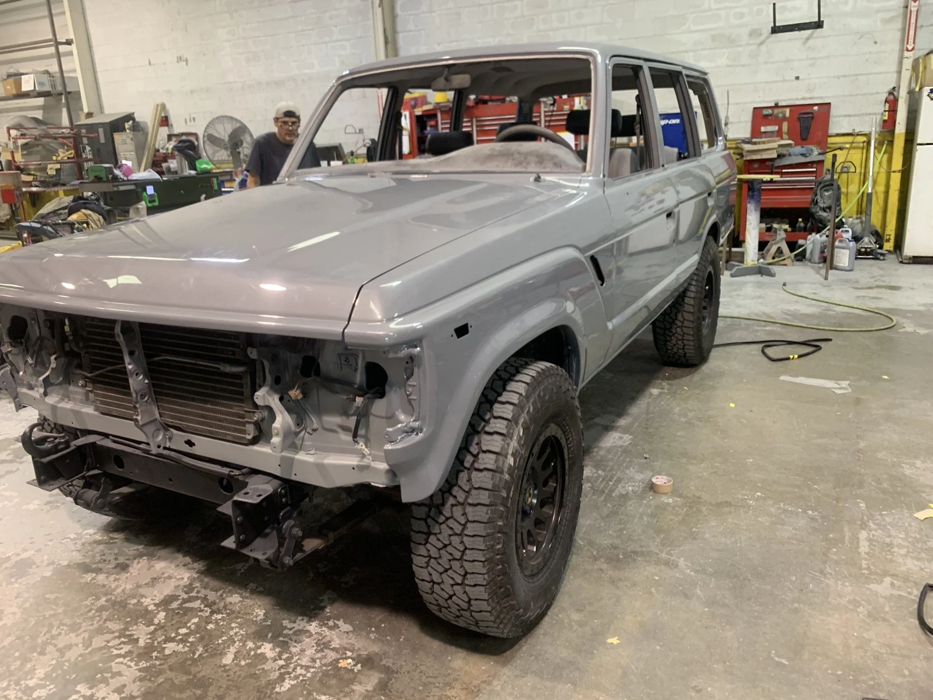

Looks great. Curious...why not just pull body right off the frame?

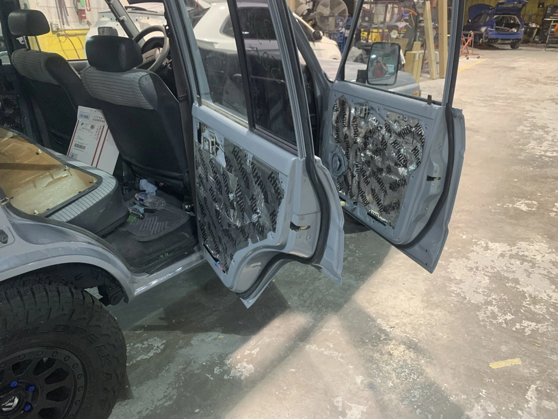

oh man you're just itching to jump into the rabbit hole with that question? i guess before going to crazy whats the intended use of this truck? honestly you can make it cool and spend a bunch on stuff you'll never use or make it functional. making is reliable is the first place id start but as you're asking about accessories id say a tire carrier bumper is a nice touch and gets the spare out from under it. i like the look and function of a good roof rack. interior function like upgraded seats, sound deadener and some real cup holders make for a nice long drive. there are so many things you could do so let us know what your intended function is and im sure we can help spend your money!! look out for @TRAIL TAILOR. he's the real deal enabler!! but you'll end up with an awesome truck

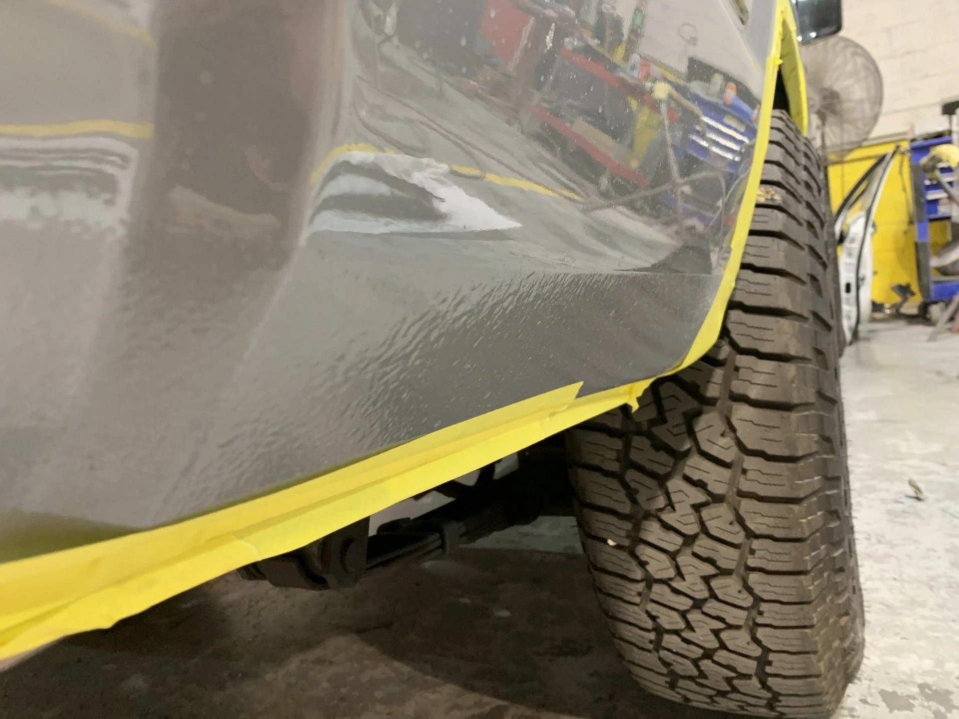

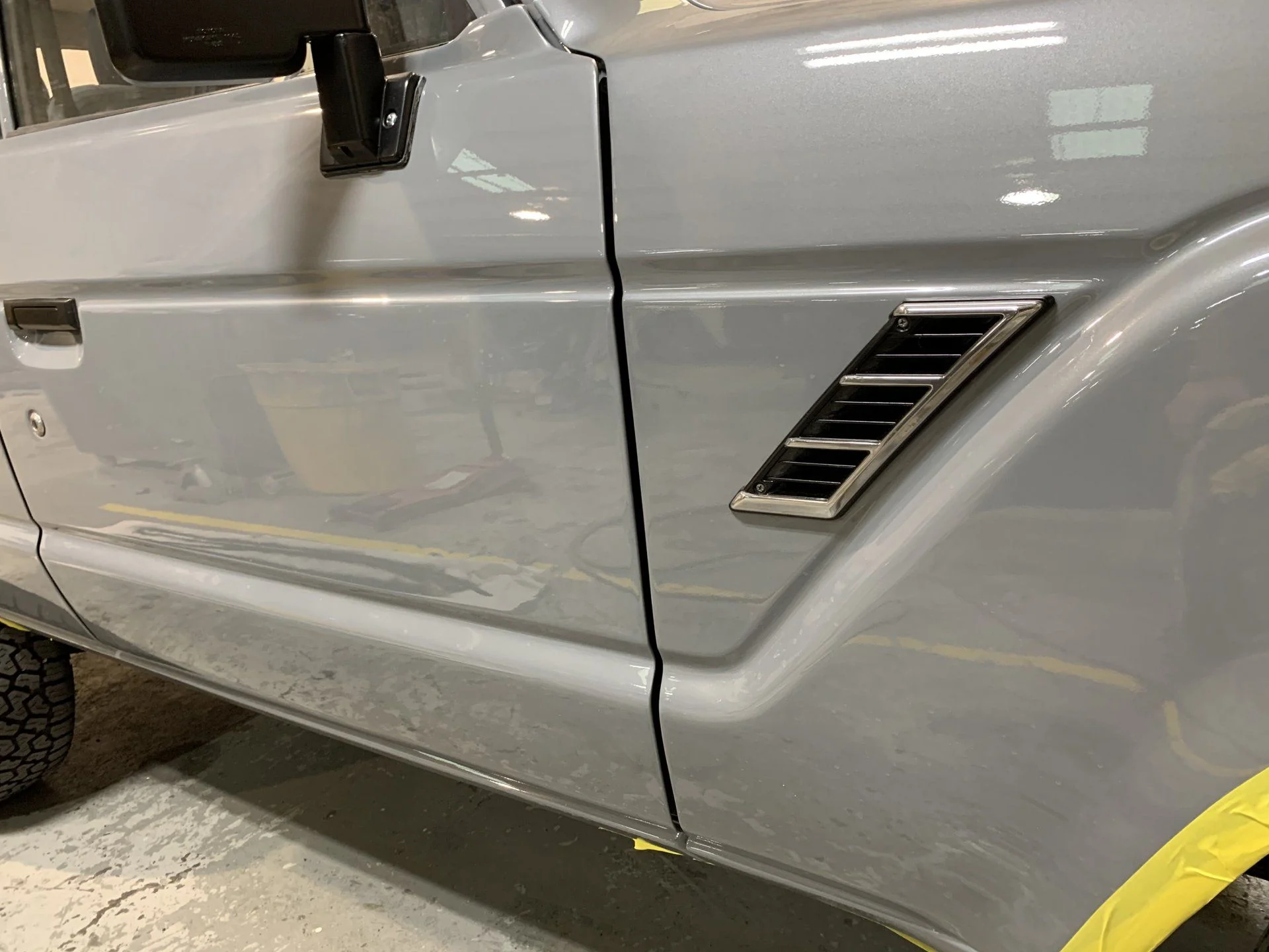

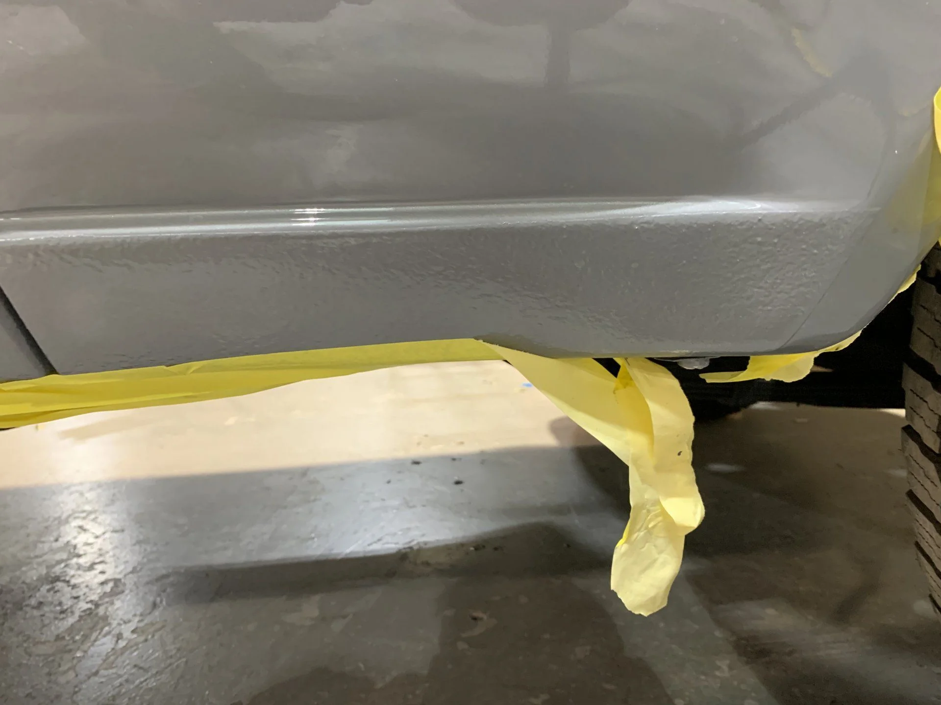

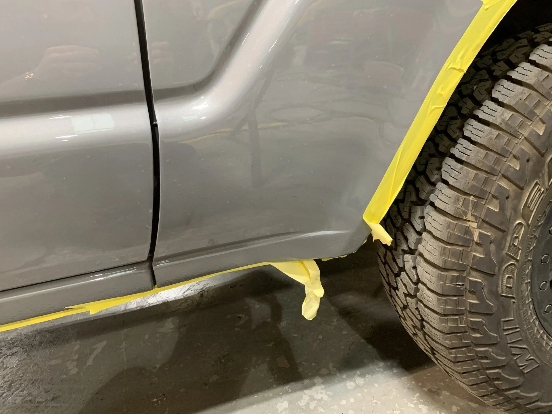

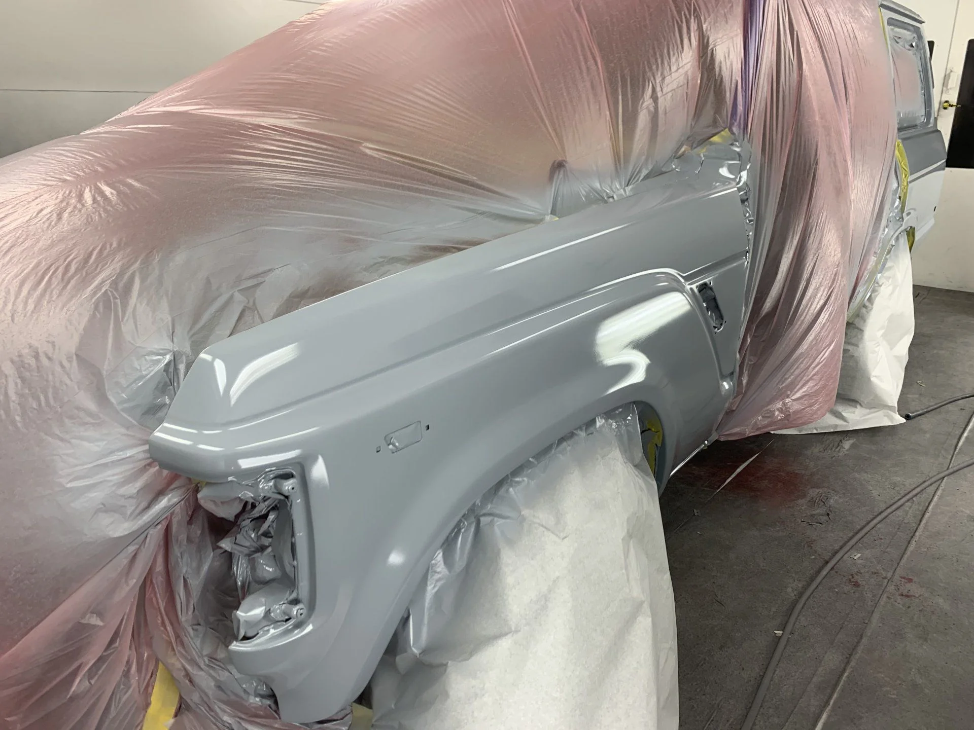

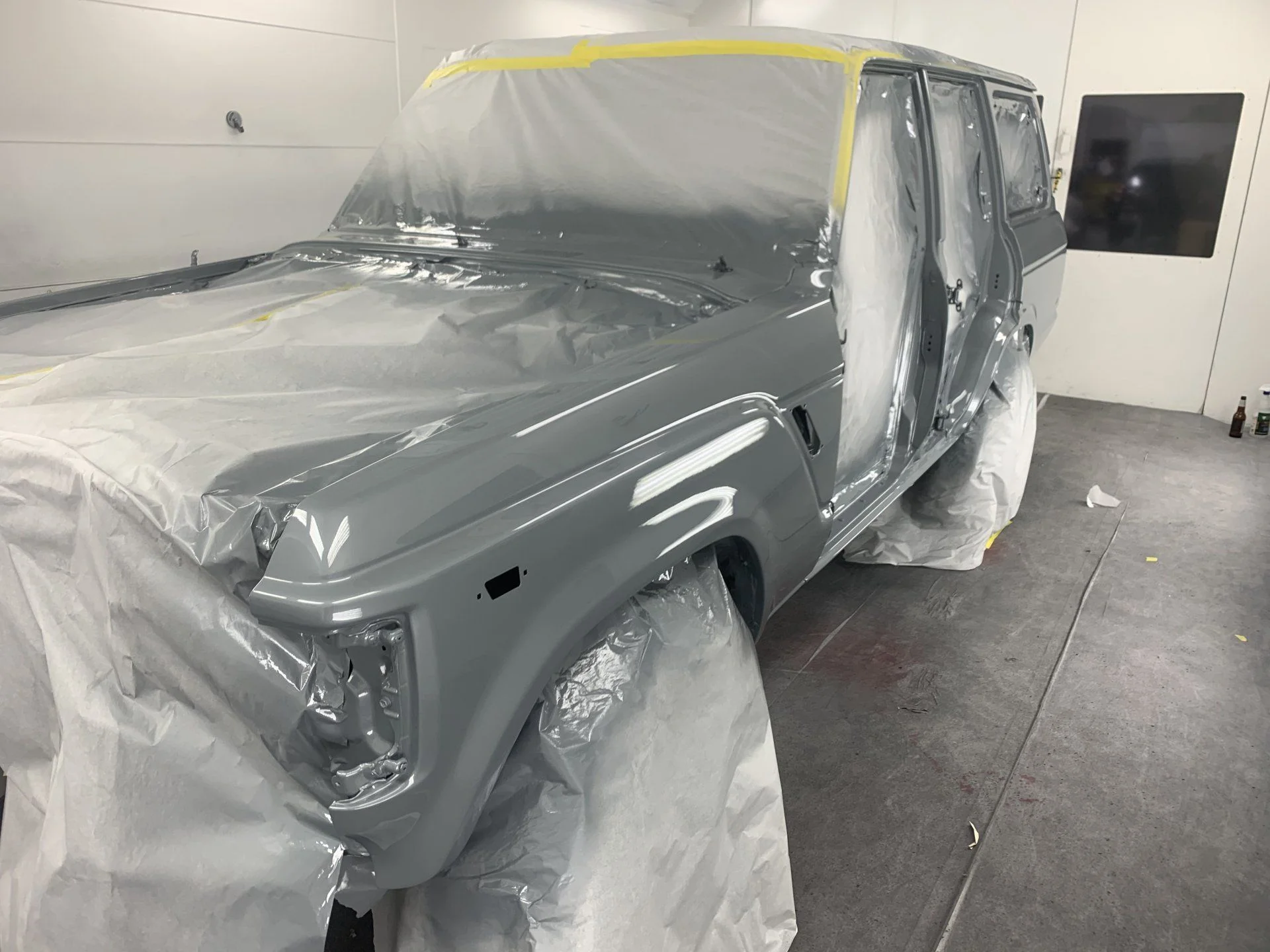

So i’m close to having it driveable, finally... after a 2+ month process of stripping the entire truck, shooting it with Toyota’s newer Cement Grey, and a glamour clear finish (previous owner painted it like a Chevy Camaro blue, SMH)... it did turn out beautiful

@Seth S - no need, the vehicle has never left New Orleans, the only rust we found was some slight surface rust on the body panels from the previous owner paint job. The interior is perfect, so we just masked the hell out of it. We were able to basically paint all panels off the truck in one booth, body in another...

H55f 5 speed conversion will give you the get up and go you want....the best thing Ive ever done to my truck. Small things like new cats can increase performance in small but noticeable increments. With your gear box dont run larger tires. Keep with stock 31's. It will save whats left in that beast a440. Mines a 88 as well that I shot with grey...love the cement grey. I converted the front end to a round headlight 60 setup and added LED headlights. So much better. You can get the rectangles in LED as well. Old Man Emu 2"ish lift is what most people go with since its easy to get, easy to install and makes for a better than stock ride height and firms up everything and should help with your sway. The full kit includes shocks and a steering stabilizer. My first rack was defender from smittybilt. Its cheap and does the job but I now have a custom one I got from mike stanceworks insanely well done 60. Its perfect for a roof tent. Lots of options just depends on what you want up there. Gobi makes one that is just so rad and modern looking but you gotta have some money to throw up there. ARB makes one as well. Frontrunner makes some cool racks and gear. 4plus products in AZ makes great bumper/tire carrier options if you are going that route. Smittybilt and Tuffy are good options for a way better center console setup that is actually usable.
