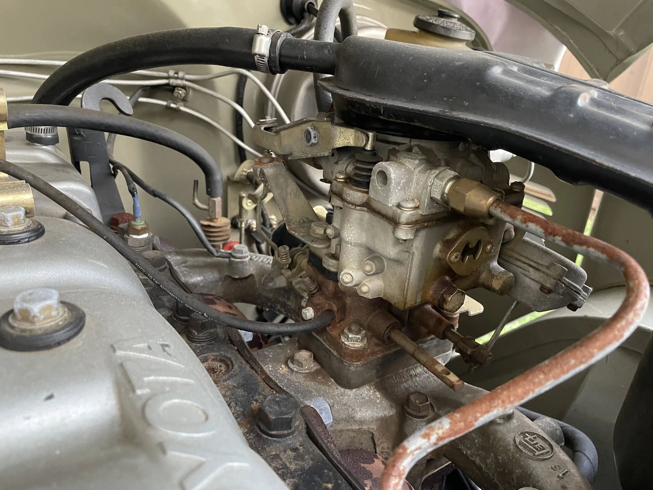

Hi - I have a 81 FJ-40 and when I start accelerating at any gear the engine start hesitating/bucking until it die. After a couples of seconds I can restart the truck without problem but as soon I accelerate in gear the problem repeat. In neutral I can accelerate as much I want with not problem. I already change the fuel pump, filter and most of the fuel lines. Also I tried driving it without the fuel tank cap and the problem persist...Do you guys think it is the carburetor ? I'm not a "mechanic" but I can do basic stuff. Please help me.. photos for reference.

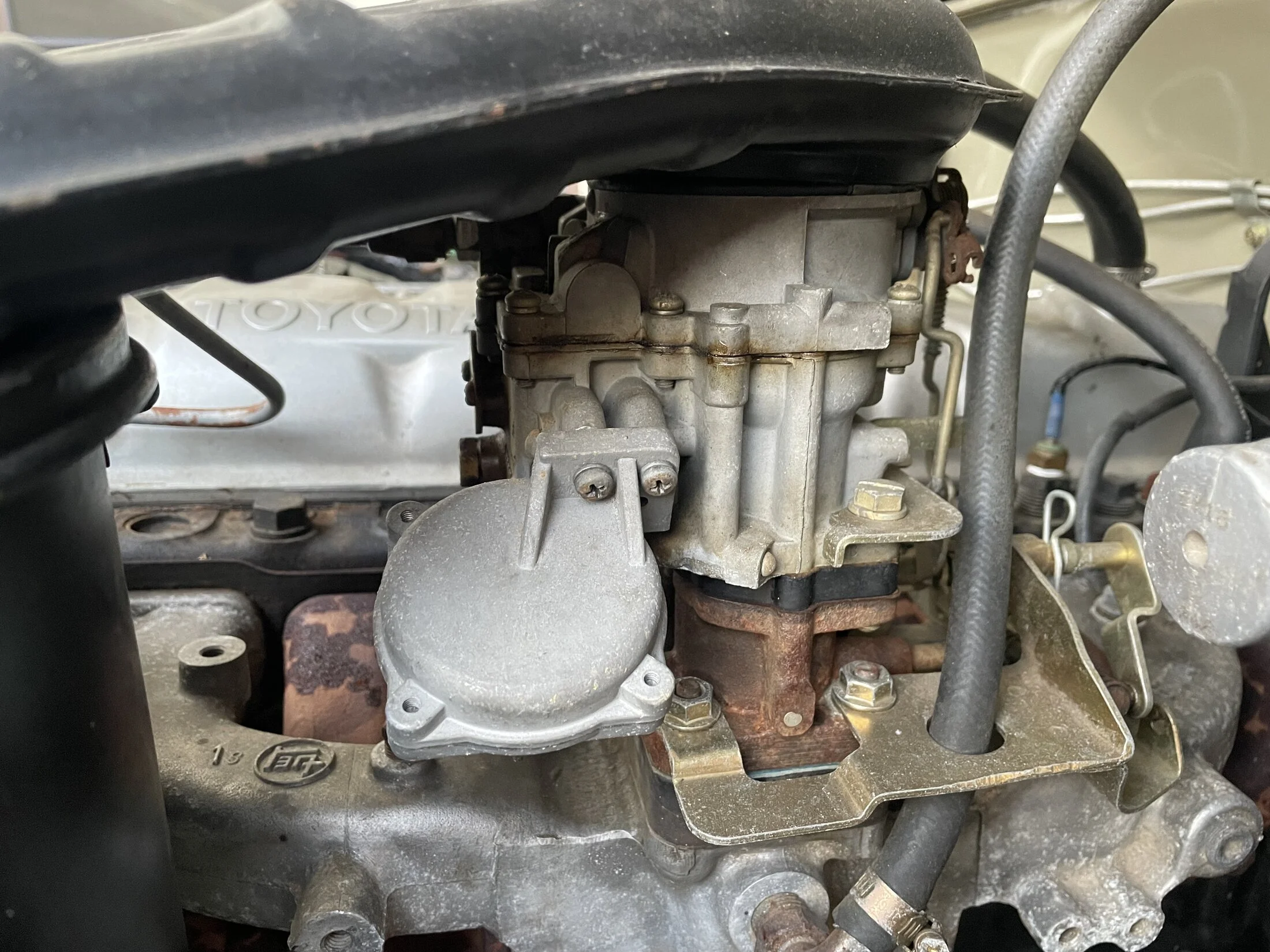

You are missing a vac cap on that barb, closest to the firewall. I've never had luck with rubber caps, aside from OEM, but, the silicone seem to be better, I think. A bit of a vac leak will go away if I'm reading the photo correct.

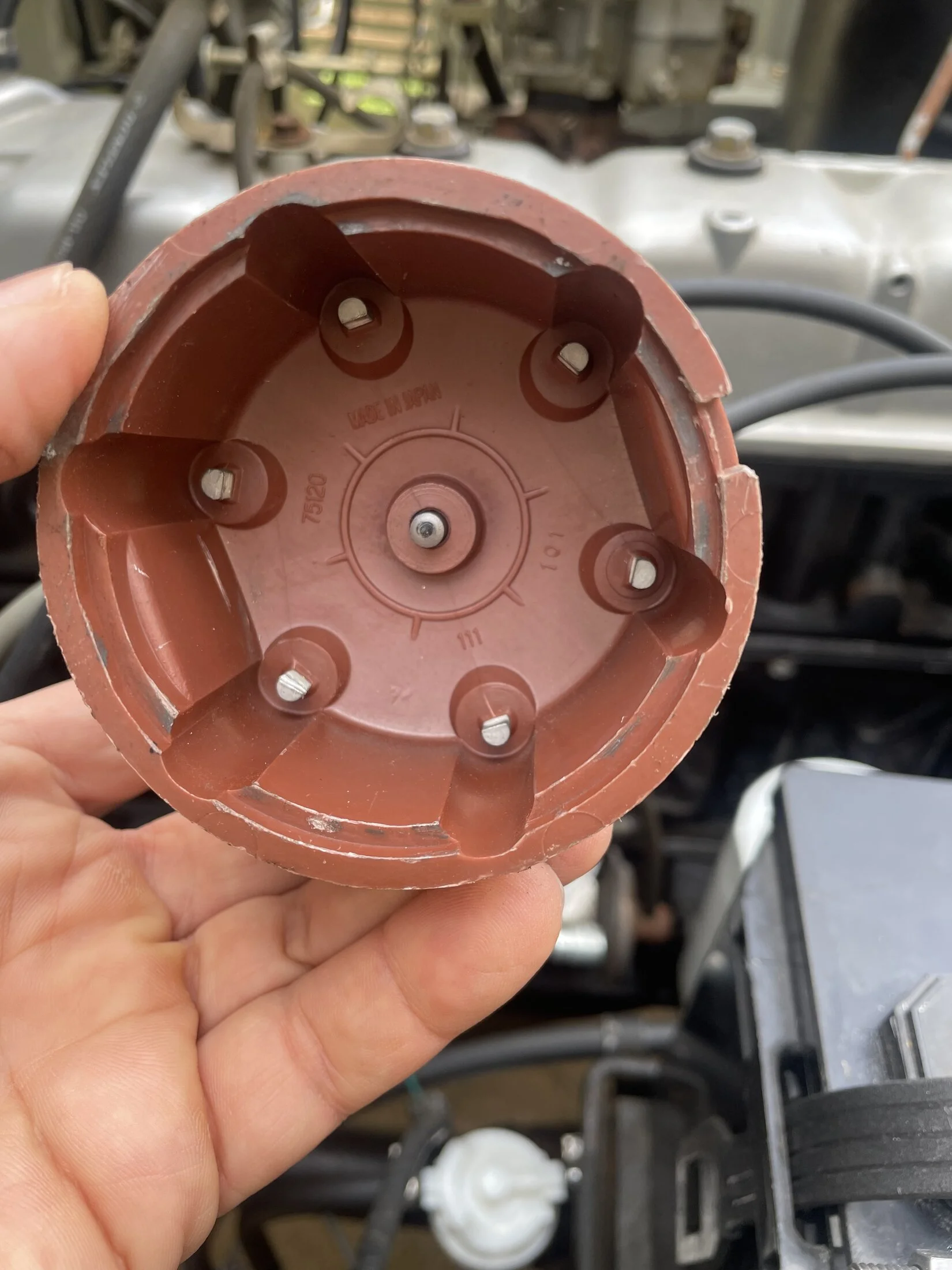

Pull the battery negative cable. Open the distributor cap. Inspect rotor for off-axis play, and inspect / clean cap-electrodes.
The carb needs love. It is possible that corrosion is collecting in the bowl, or inlet screen. Rebuilding one isn't that hard. Get a Vessel or Toyota JIS screwdriver. I can see the burrs on this carburetor from someone using a Phillips. I don't see a choke cable or idle cut solenoid wire hooked-up? Both of those items might be a cause for a lean-condition.

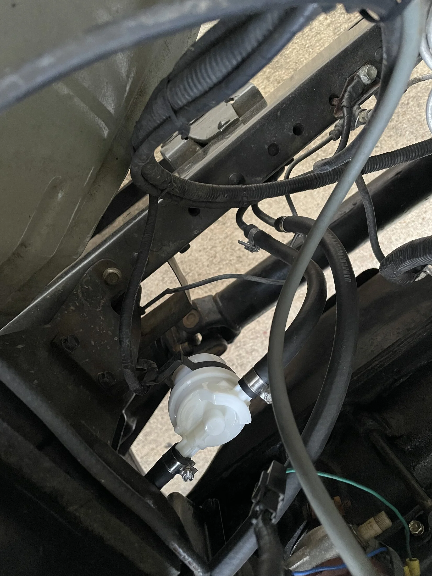

Your picture #2…unless I’m disoriented and I may very well be, can’t really tell just from that one picture, but to me it appears as if your fuel filter is facing backwards.??
Thanks to everyone, definitely I need to learn more because I don’t really understand most of the items you guys are suggesting. I will Google the items mentioned and trying to figure out. The only thing I know is correct is the fuel filter. Because the carb is in back shape I’m wondering if it’s better to buy a new one ?

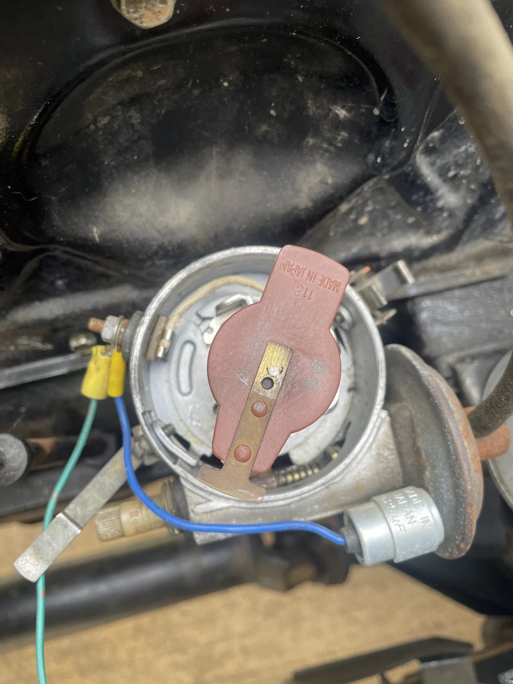

I opened the distributor. I saw a guy checking the vacuum advance by sucking the hose to create a vacuum and confirm that the vacuum advance is working properly. In my case, no matter how hard I tried, the distributor didn't rotate. I even tried to rotate it manually and could barely move it. I'm thinking the vacuum advance diaphragm is bad and needs to be replaced. Can you help me identify the model and replacement? How difficult is it to replace?

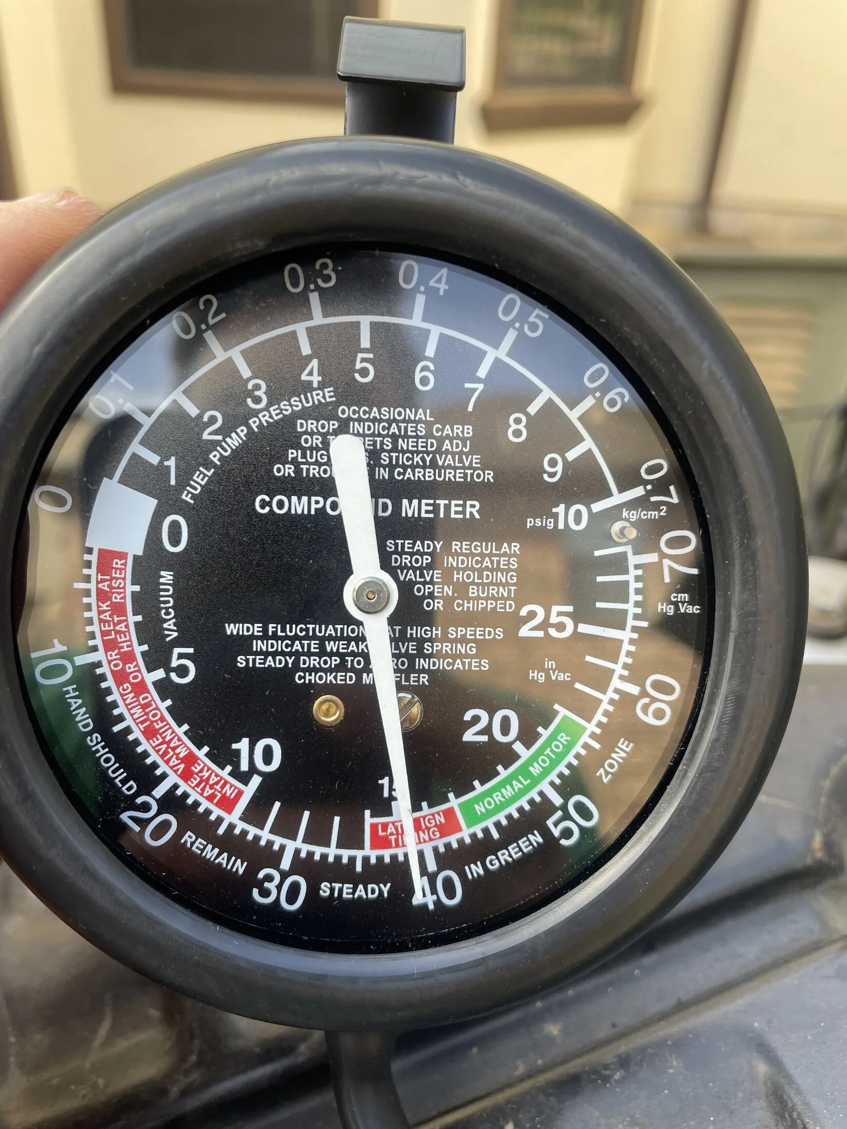

I connected the vacuum gauge to the connection on top of the intake manifold that was missing the cap. I started the engine from cold, and it took almost 2 minutes to get to 15-16. After that, the reading was stable during acceleration. According to the gauge, the engine has "late ignition timing." What do you guys think? I also bought a cap.
I connected the vacuum gauge to the carburetor connection that goes to the distributor. As I accelerated, the readings moved from zero to 10 and up to 17-18.

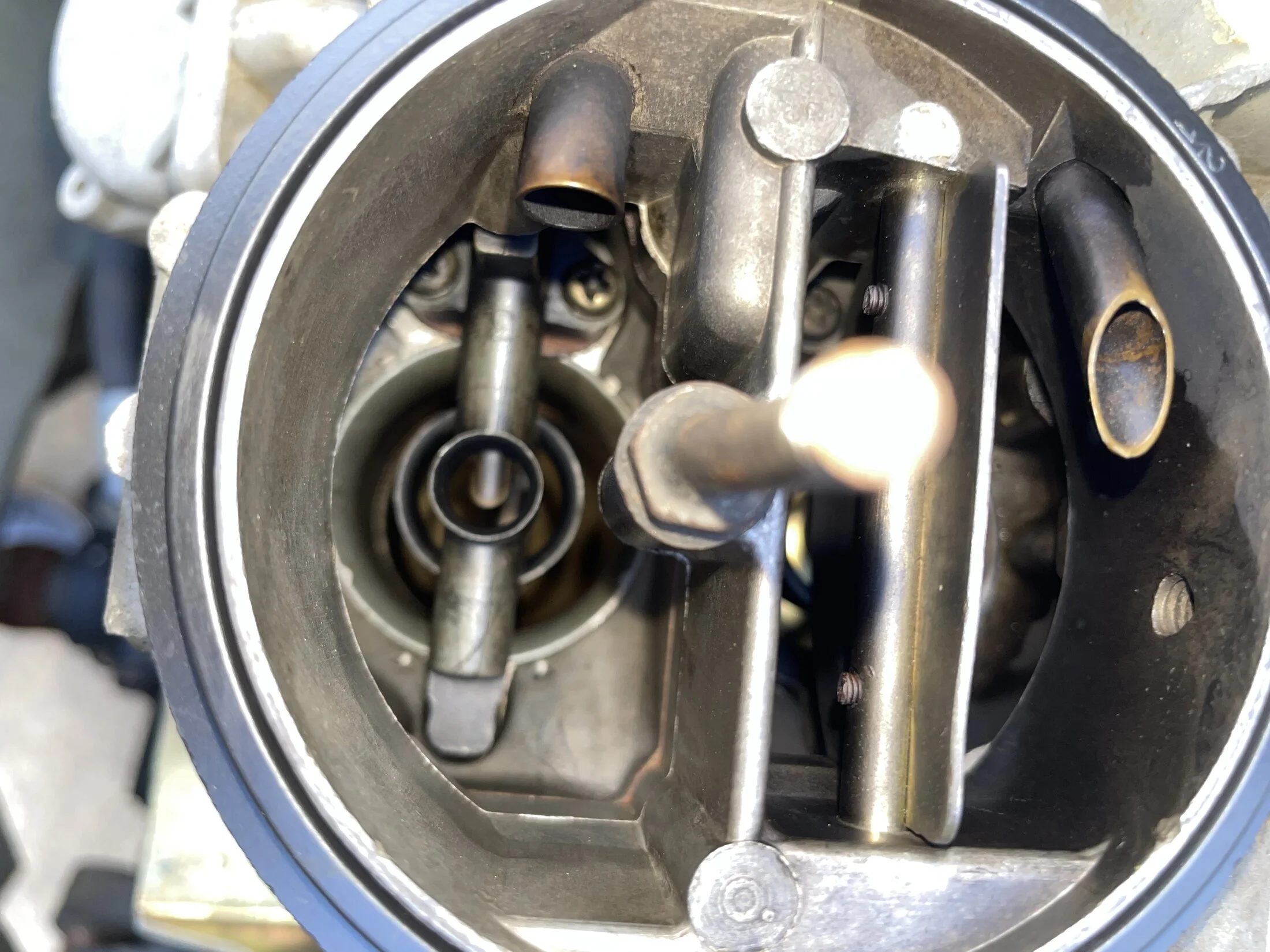

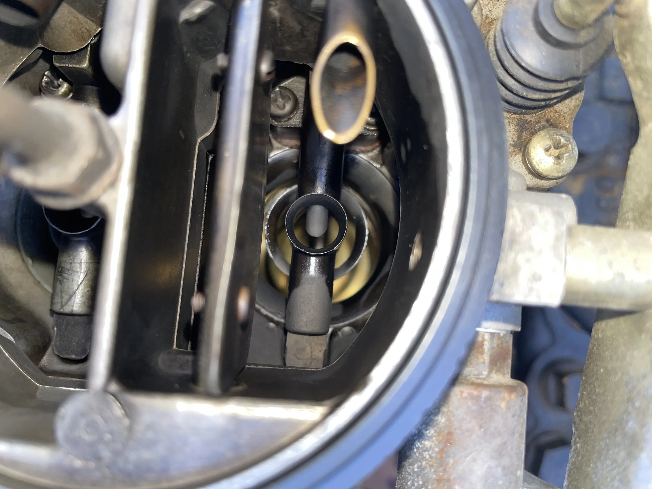

I took a few photos of the inside of the carburetor. What do you guys think? One more question, Can I replace the carburetor bolt that hold in placed the air filter box..somehow is stripped.

A vulnerable part of the vacuum advance system are those tiny ball bearings in the sandwich that composes the breaker plate. I've seen them sooo rusted on my distributors, and the grease was caked with rust. If it is stuck the diaphragm can't perform vacuum advance. To rebuild it takes patience - you carefully move the bearing with a blob of grease to a greased bearing race. Mine is a '75, and your distributor is a different style. It might just need penetrating oil to regain function? I imagine that the other distributor parts need to stay clear of something like WD-40, but, if you can isolate the breaker plate from the rest of the distributor, it might be worth doing an inspection, at least.
^^^^^^^^^This^^^^^
If you can suck air from the vacuum advance diaphragm, then it's bad. If you can't suck air, then the diaphragm is good. If the advance plate doesn't move when vacuum is applied and the diaphragm is good, then the plate is stuck or frozen.
Does the fuel level in the carb stay constant between the two points on the sight glass at all times (idle and accelerating in neutral)? Does it idle steady with vacuum readings about 18” of vacuum when connected to intake vacuum?Does the vacuum gauge needle stay steady at idle?
Pls report findings from above.
^^^^^^^^^This^^^^^
How can i confirm that the plate is stuck ? Should the plate move if I try to rotate it with my hands ?
I believe you should be able to move the plate at least a little by hand (so you know its not seized). Under vacuum it should move, release the vacuum it should go back.
More importantly then the vacuum advance is the actual mechanical advance. If that is stuck then the truck will run like garbage.
^^^^^This^^^^^
Mechanical advance and initial timing are the most important. To check mechanical advance you can slightly twist the rotor easily and It should move slightly and snap back when released.
