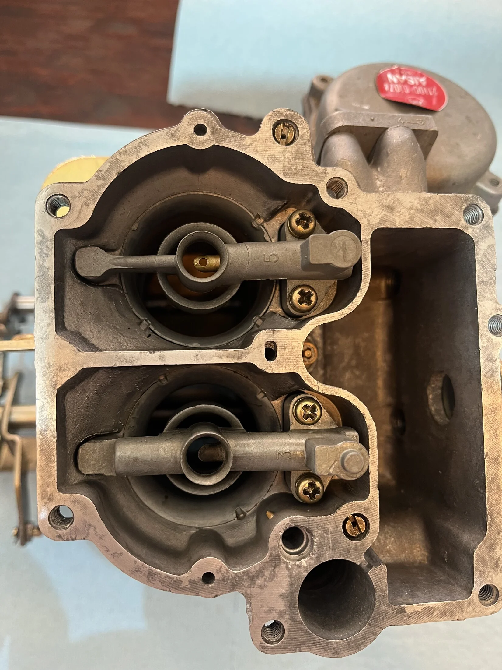

One other thing that popped into my head… Are my nozzles backwards? I read this thread (2F Aisan Carburetor Jets and Venturi question/help - https://forum.ih8mud.com/threads/2f-aisan-carburetor-jets-and-venturi-question-help.975566/) and it looked like for his carb the main nozzle was a 5, secondary was a 3. Mine seems the opposite of that (see pic). I have the shorter tube on the primary side (stamped 55).

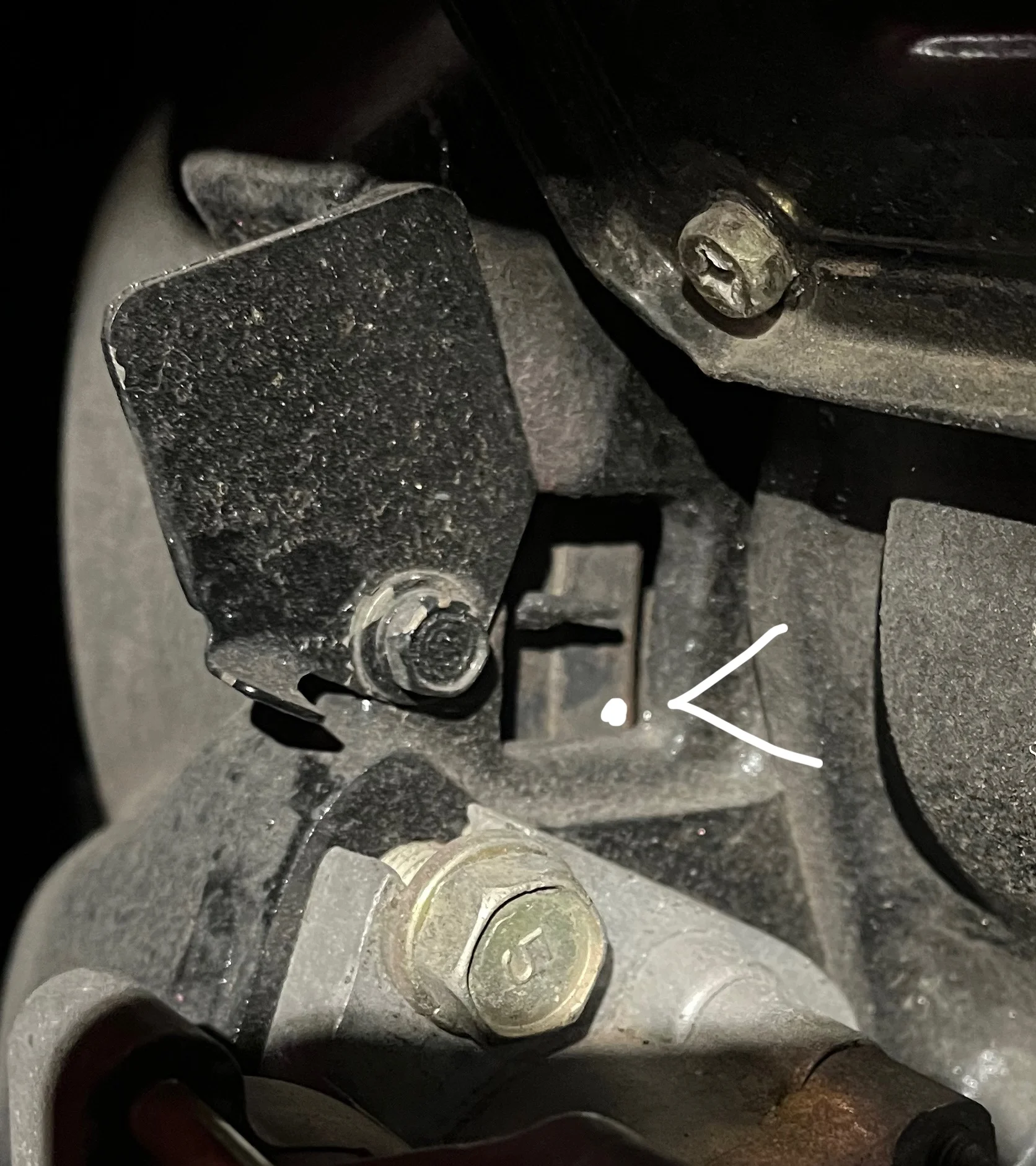

OK, I checked the timing light hooked up to the lead on cylinder #1, and I could see the BB… gonna chock that up to user error. I adjusted timing (again without the vacuum advance plugged in) so the BB was in the lower part of the window.

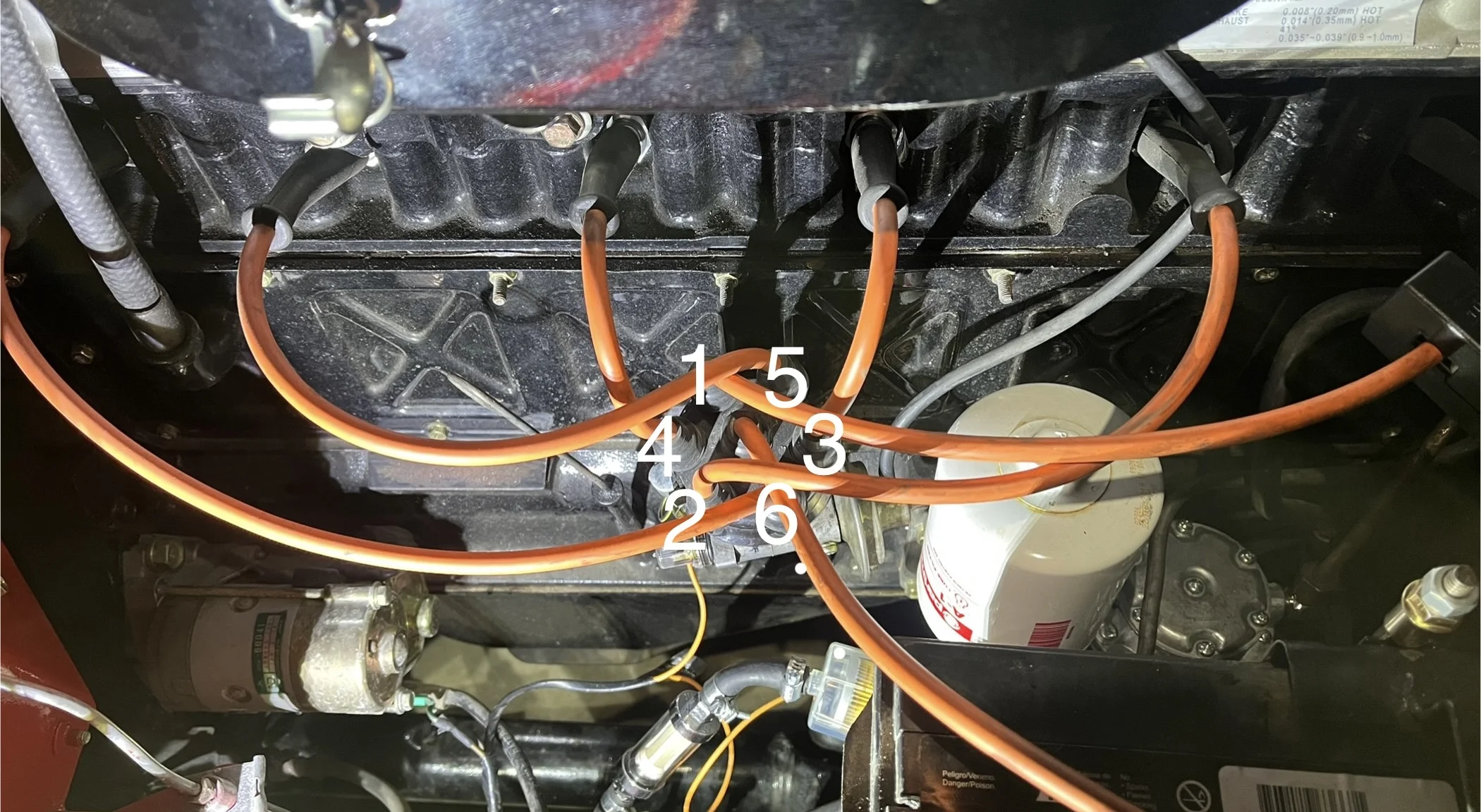

Also mapped out the wires, see below:
I think your cap wires are in the correct position. Look at the contacts inside the cap. Aluminium ones can get a heavy layer of oxide build up - its an insulator. You can take the small blade on your swiss army knife and scrape off the oxide. I prefer caps that have brass contacts NAPA Echlin for example were that way. Also make sure its corrosion free inside where the plug wires go in. On a dark night open the hood and start the engine - look for dancing fire sparking out of the wires - old insulation can have micro cracks that leak and reduce spark at the plugs. Make sure the center electrode on the plugs is square - I use a flat needle file to true them up and then gap them.

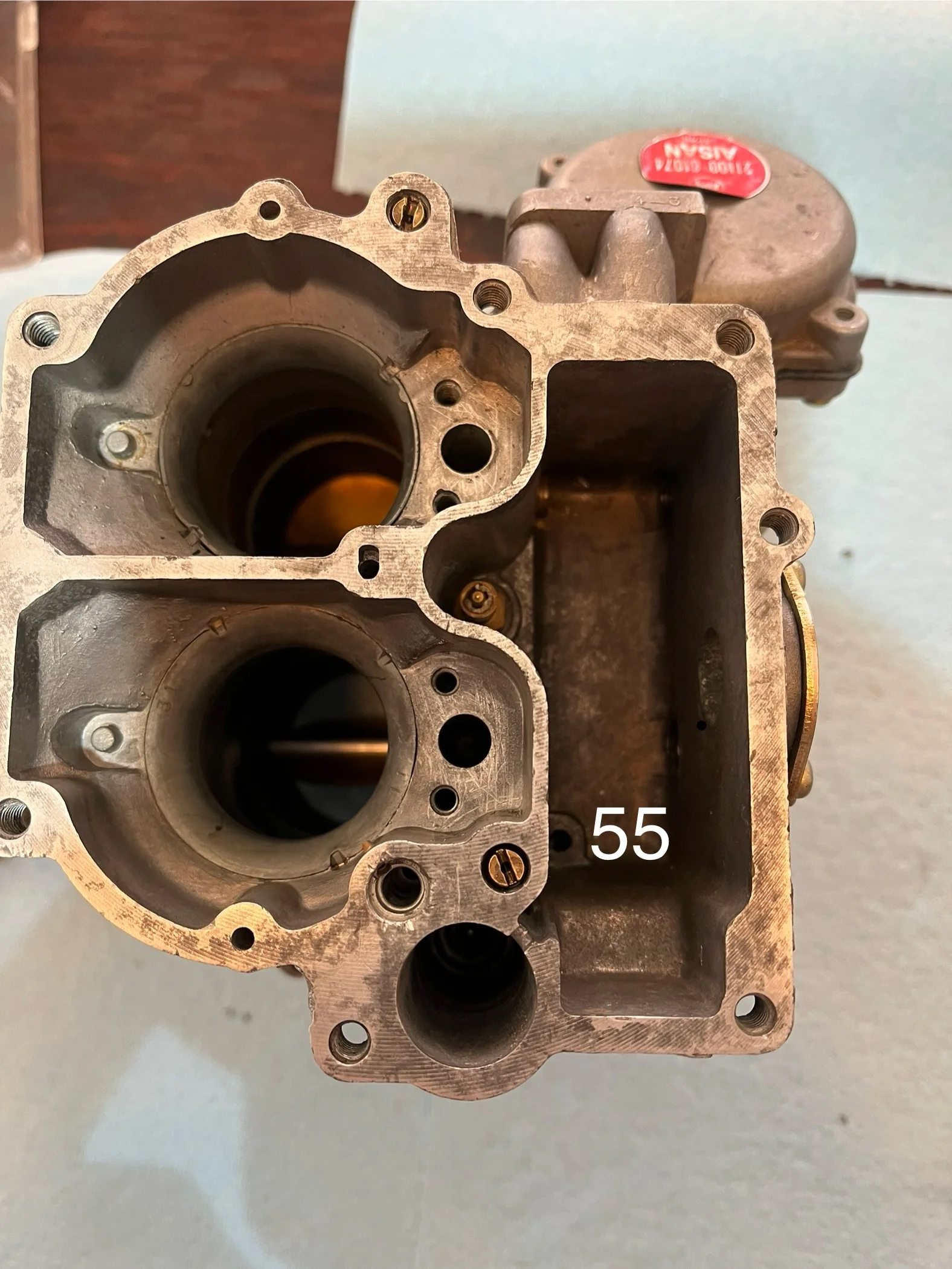

I then took the top of the carb apart (for 3rd time), and adjusted the float to 4mm off the cast surface. After re-assembly, no difference in fuel level in the bowl. Then I took off the first inline filter temporarily and blew compressed air back into the tank until I heard bubbles. Re-connected, and bam, fuel level increased in the bowl. I definitely have crud clogging up the pickup. That said, it still didn't solve the acceleration issue!
Next up, I decided to go after that bee in my bonnet about swapping the #3 and #5 venturis... Took the top of the carb apart for the 4th time and swapped em. Ya that was a bad idea... truck had no power on acceleration (not just stumbling). Took top of carb apart for 5th time and put em back.
