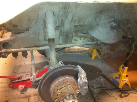

I decided to go ahead and do the tires and suspension sooner than later. I managed a great deal and service from Kurt. These are heavies so I will have to reinforce my kidneys but I'd rather have the leaves and decide not to use them then vice-versa.
The first corner came out easy - 15min. The rest were ok but it's always the last one that fights back isn't it? Had to use the grinder to assist with the last hanger pin after prying and hammering for a while.
one in - the u-bolts are still on the way so the old ones can hold it together for now.

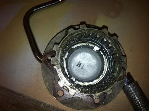

Today I got bored and took time to figure out why I'm running two wheel drive. I opened the drivers side lockout and the damn thing looks like it has never been used.
well there's your problem! The clutch was stuck unlocked in a rust soup.

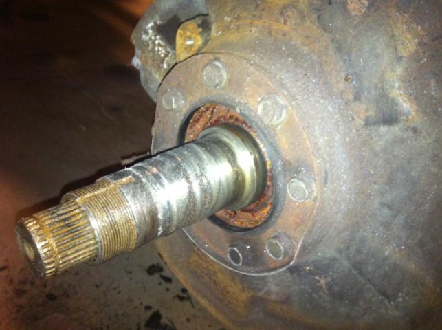

Ok, so this bearing is toast obviously. The spindle will be fine at least.
I was bummed at first that I couldn't put her all back together until I realized I had a bunch of parts I bought for the 45 axles to be rebuilt. Looks to be the same bearing and seals as my 1978 FJ45, at least for the front. Actually the 45 full floater is the same bearings too. So I have four sets of bearings/ seals/ gaskets here :cool:
New "problem". Do I just do the one wheel bearing and call it good? I have the parts here to do the knuckle wipes and the trunnion bearings and even a set of Marlin super-dooper axle seals. I have a drag link kit, center pivot thing kit and a set of TRE's on the way too. I will, of course, feel the need to paint the hubs but I think I can refrain from doing the knuckles.
So lets have a vote. One wheel bearing or the whole shebang?
oh, and what's the service limit on the discs? I get 0.752" and 0.765" on my brake rotors.
Like those marlin seals alot, he even thought about making one for the transmission to transfercase...
Whole shebang, you got the wheels off already your half way there:meh::cheers:
