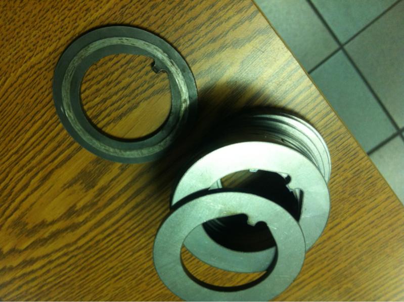

'nuther day, 'nuther part
I need a couple of these as mine are beat up.
Done..
Blasted, primer, paint
