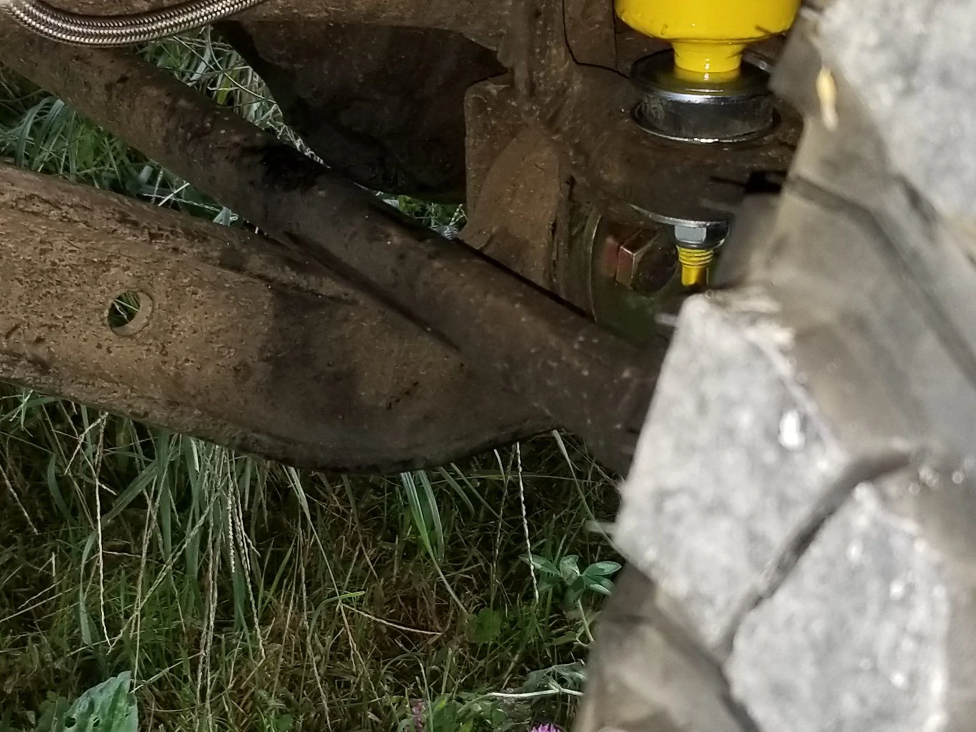

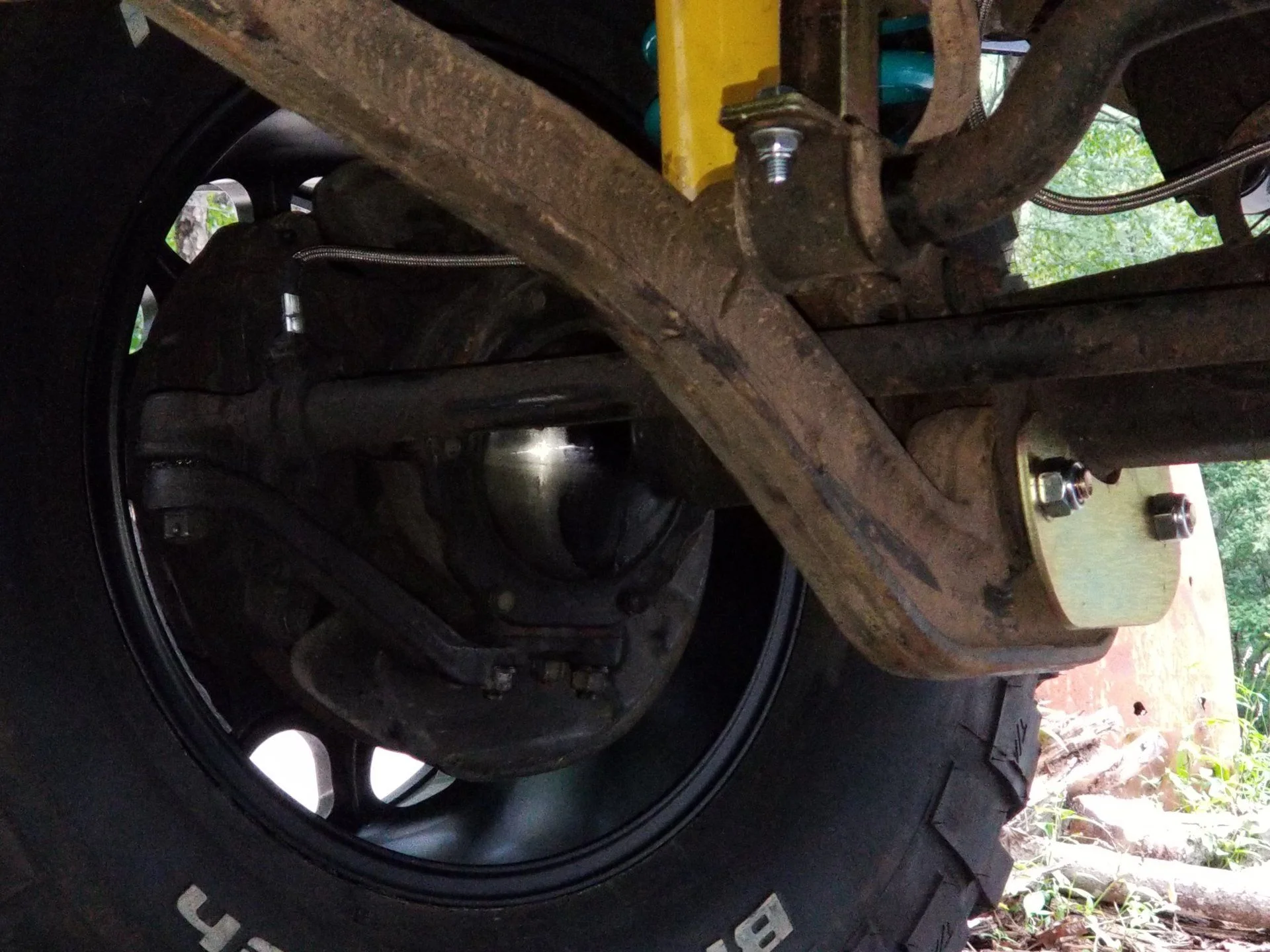

I finally got what I thought was all the parts needed for my 3.5:F - 3"R Dobinson's install and 37s, but now having an issue that I need some direction on.
The steering arm (I think that's the proper name) is hitting the radius arms on both sides. Can anyone offer a solution? It's severely restricting any down travel and is even making contact on driveway transitions.
Pass side
Drivers side
At this mild angle ...
I'm seeing it contact the radius arm fully
Any help is appreciated.
Changing castor plates to landtank/wits end style or grinding the arm are probably your best bets. Several have ground the arms but id not want to go through that top rib if it were mine.
Pass side
Drivers side

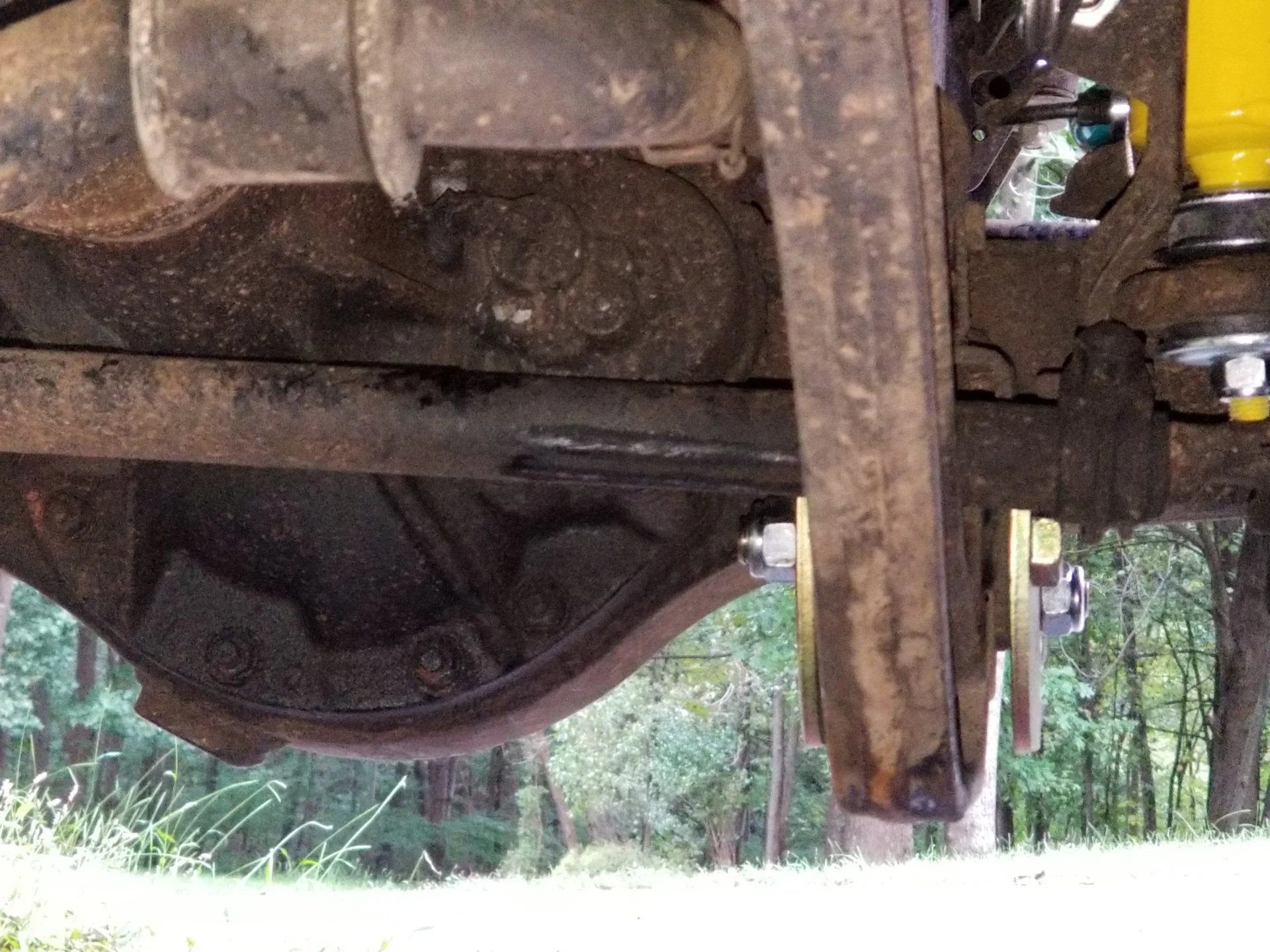

I run the same front spring with a 1” spacer on top wih Dobinsons long shocks and Slee castor plates. With a good bit of grinding on the top of the control arms my tie rod only touches the arm lightly when flexed as far as she will go. But, my castor angle is supposedly less than 1*. I’ve had it checked by only one shop. The Dobinson plates obviously dial in more castor angle.

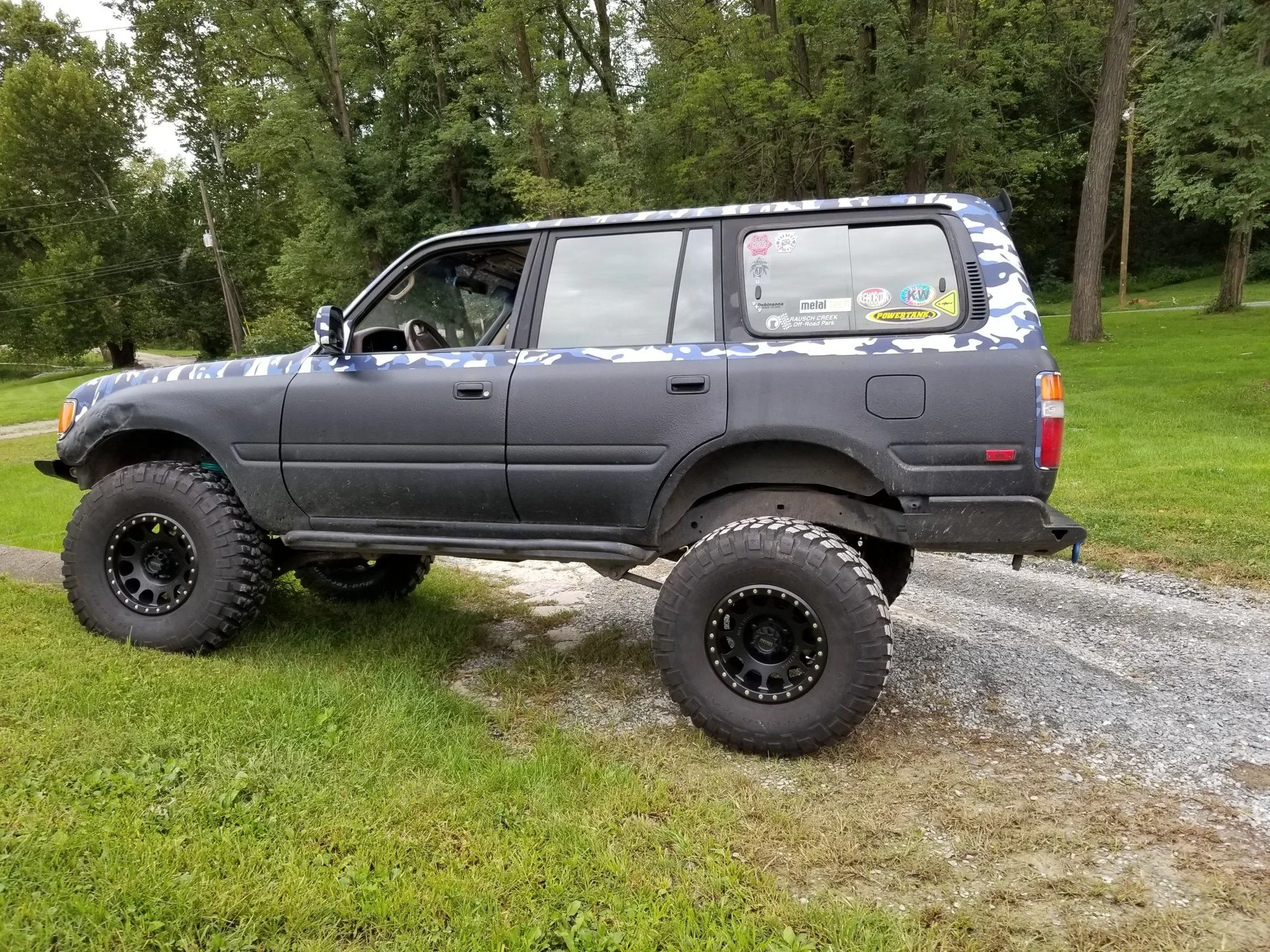

What tire size is that? 16in rims?
17" rims with 47x12.5" tires
This is only a 3" lift with a 1" body lift, Does the body lift even factor into the equation? I really was trying to keep this simple. It sounds like it might fall apart when I hit a transition in the pavement at speed. Not sure if that is normal or not.

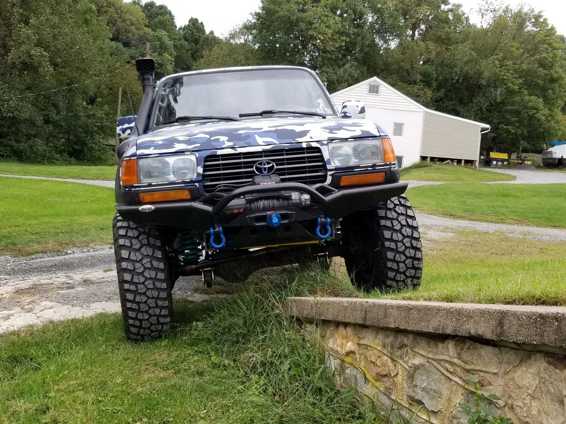

@GW Nugget - pics 1 and 2 are flat ground. Pic 4 is the contact at the slight incline in pic 3. Here are a couple more angles. After it makes contact can I push it more or will the rod just snap? I got this setup hoping to have the suspension really flex, so it bottoming out so soon is a real buzz kill.

I've got 3" Slinkys with the Landtank castor plates... no interference at all. Maybe give LT plates a try? You can see my clearance here:
