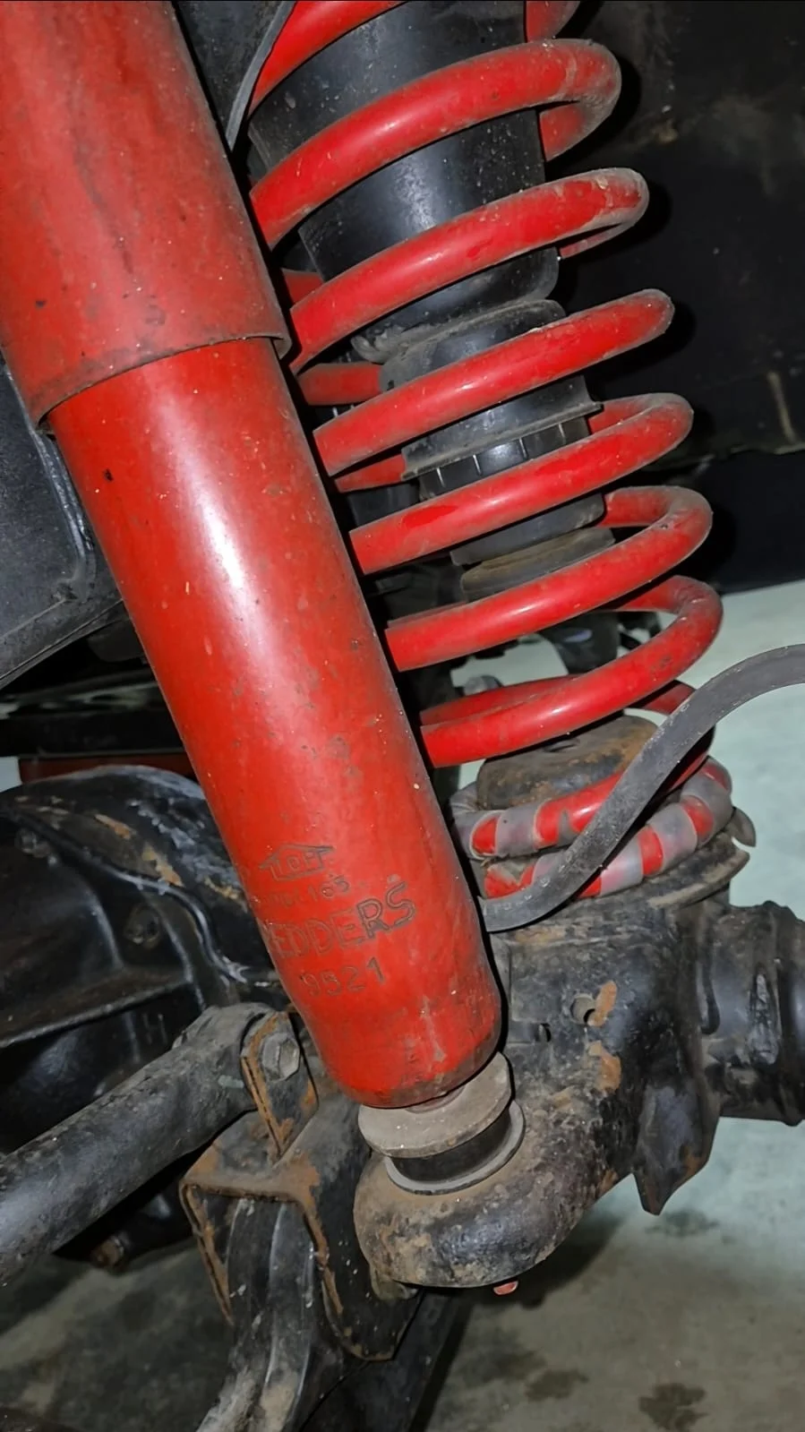

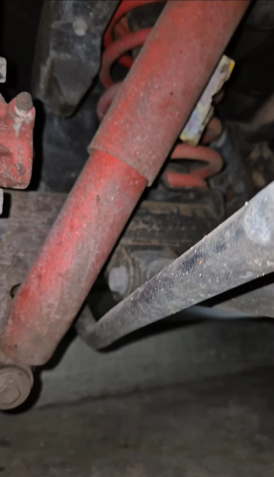

Hi all, I have a 1994 FZJ80 landcruiser (Australia) and I'm thinking of replacing my current shocks and springs. They've been on the vehicle since 2007 and have done approx 50,000kms (31,069 miles).
The current suspension is aftermarket from an Australian brand called 'Pedders Suspension'. It's got their standard height coils (they say about 10% stiffer) and their trakryder foam cell shocks (no lift—stock height). Car is running on BF Goodrich KM2 Mud Terrain tyres (manufactured in 2013) in 285/75R16. Unfortunately, 20 years ago when they changed the suspension, they didn't give dad back his factory shocks and springs, which would have still been in excellent condition.
The ride comfort can best be described as "bone jarring"—you feel every bump in the road. I know the aging muddies are probably contributing quite a bit to the harshness, despite the them still having tonnes of tread left, but I suspect the Pedders suspension is contributing to this too. Keen to hear your thoughts though.
