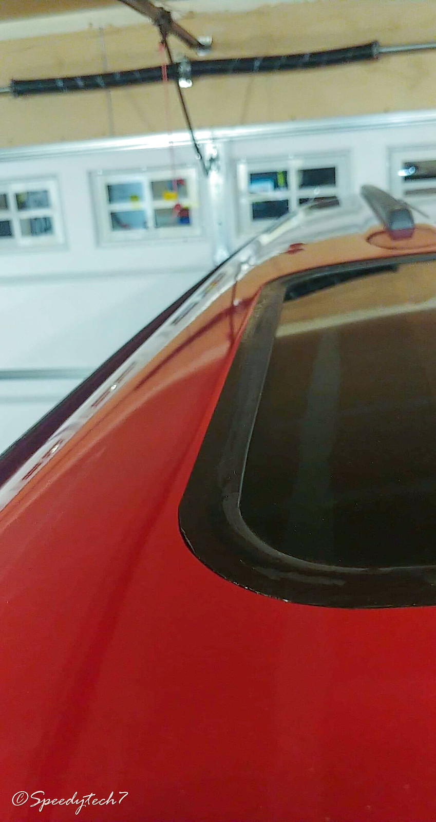

Sunroof drains are probably clogged. Open the sunroof and look down and you can see 4 drains, one in each corner. Snake them out and it should keep water from pooling and leaking inside
The front sun roof drains are pretty obvious. Easy to get to and unplug from the top. Their drains exit INSIDE the rocker panels so can't really be gotten to from underneath the truck.
The rear ones are way back under there. The best thing to do to start with them is to get under the truck behind the rear wheels. Look up and you should see the hose that exits from the two rear drains on each side. Take a thin stainless steel cable (like used on overhead doors) and run it UP from the bottom. You will probably have to then rinse some water into where it can drain to flush things, perhaps repeating several times before things are flowing well.

sunroof drains

I had this issue, I truly wish my LC was a tin top, I hate the sunroof, useless invention. I finally got fed up with it (I've changed seals, reseated it before) and sealed it shut, removed the electrical connectors. I think I did a nice job sealing it too, looks factory smooth.
