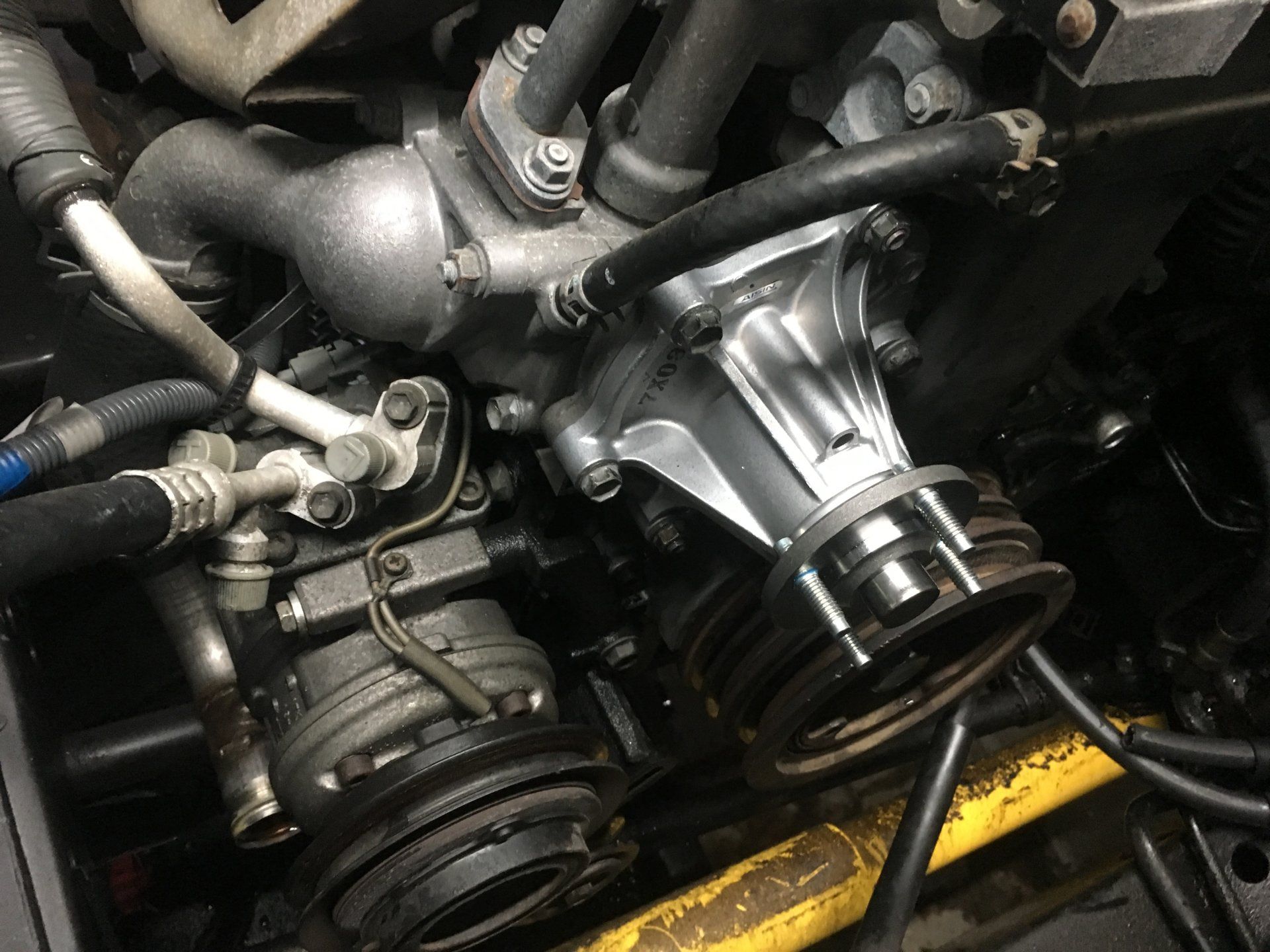

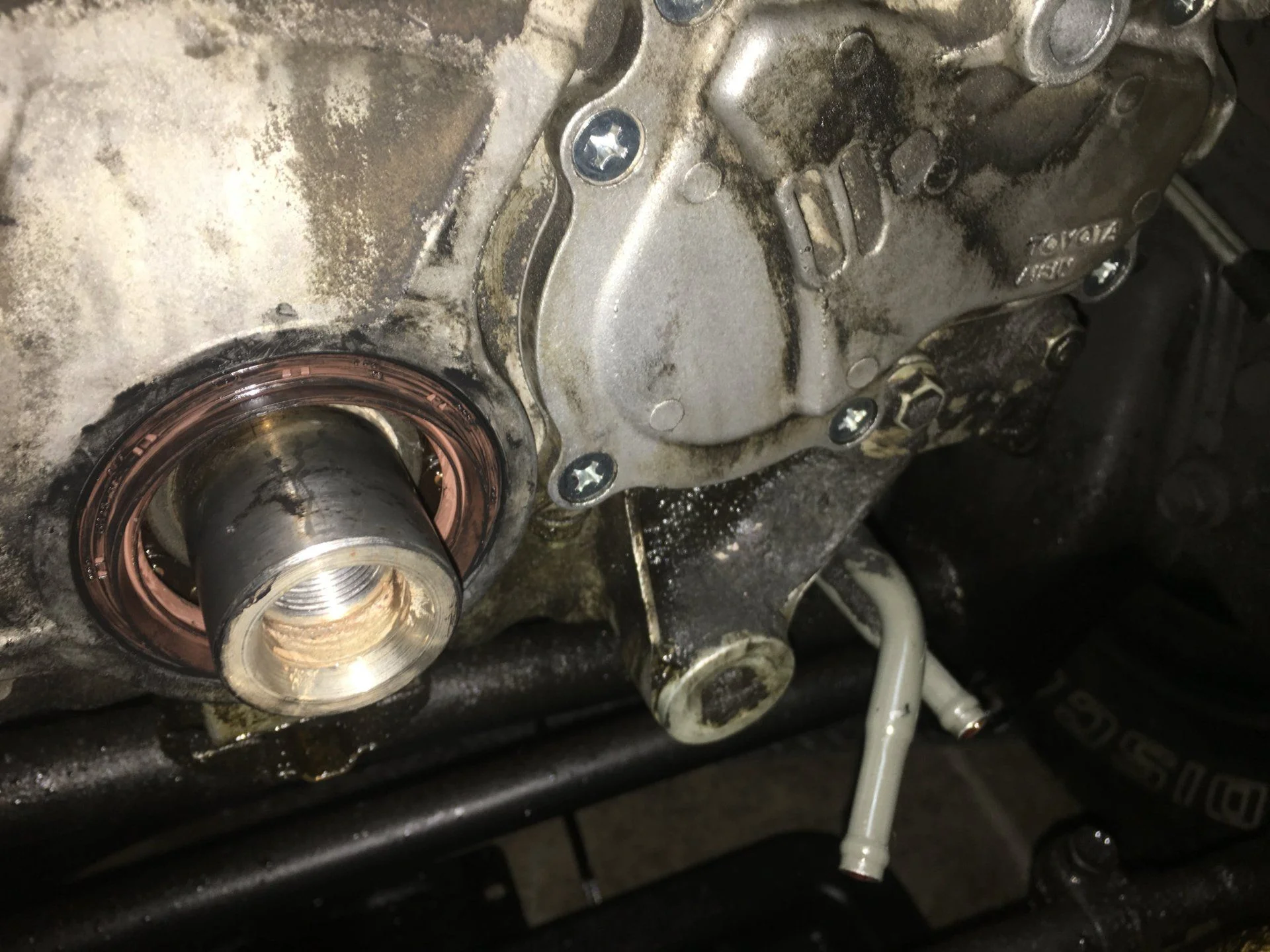

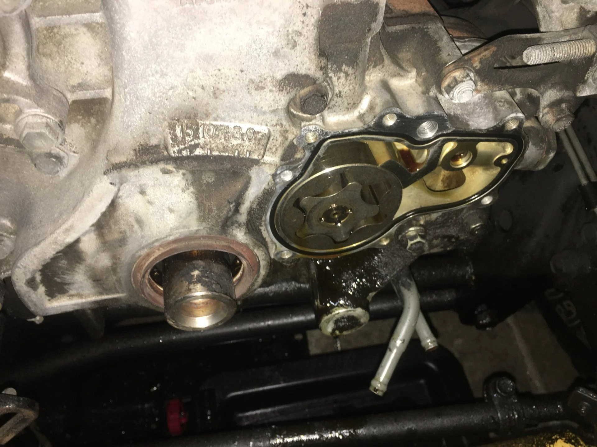

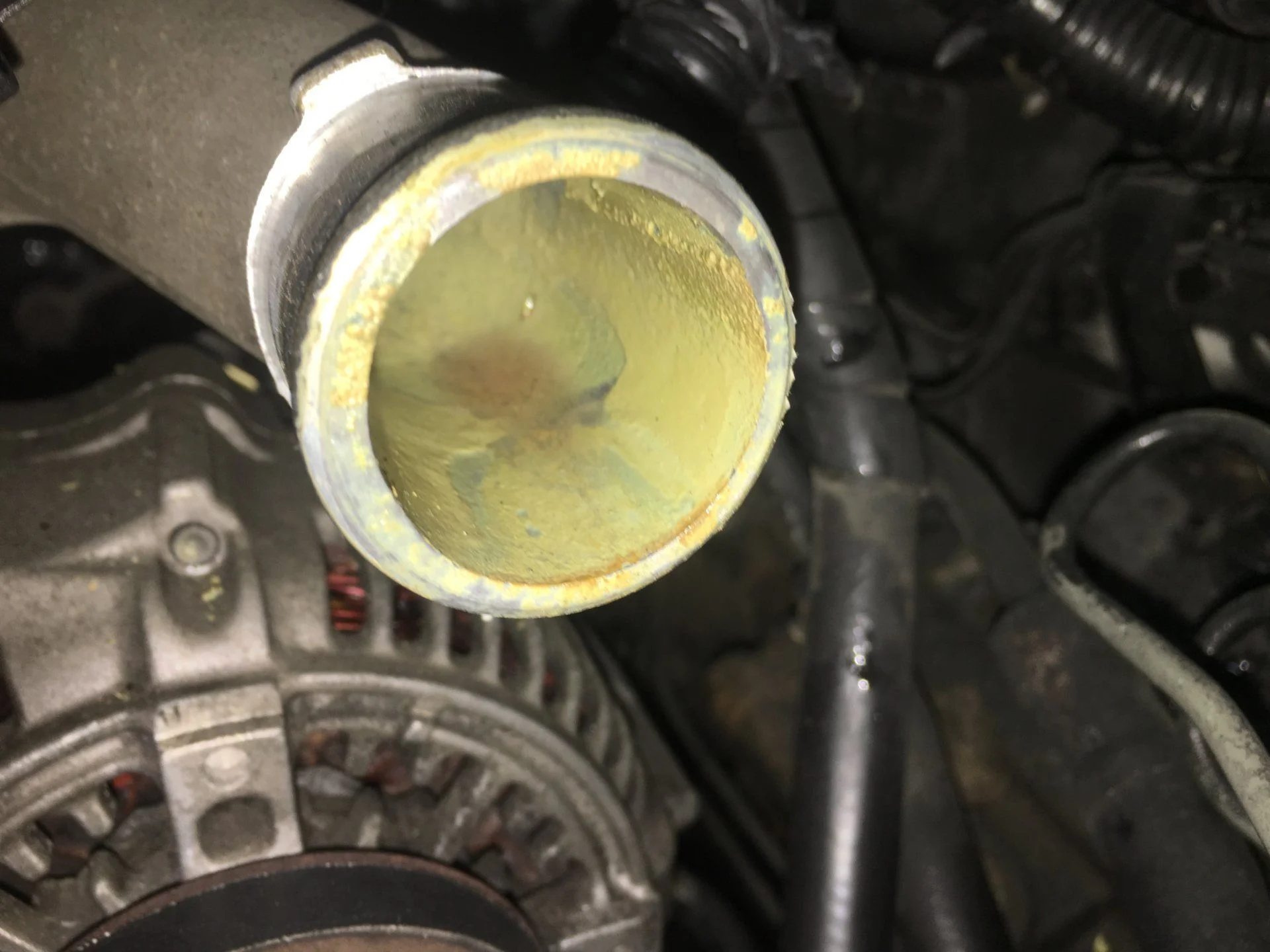

I had a couple of leaks, I noticed a leak from the oil pump seal and the transmission lines were leaking. Naturally those were the first to get replaced. While in there I decided to might as well get a new water-pump, and do a tune up (spark plugs, wires, PCV valve and grommet). A cap+rotor will soon to follow. I've replaced the radiator hoses as well, and was disappointing to find a lot of yellow (sand-like) residue in the block and also in the radiator. I flushed the radiator to the best of my ability and reinstalled with toyota coolant. A bypass coolant filter install will be soon to follow.

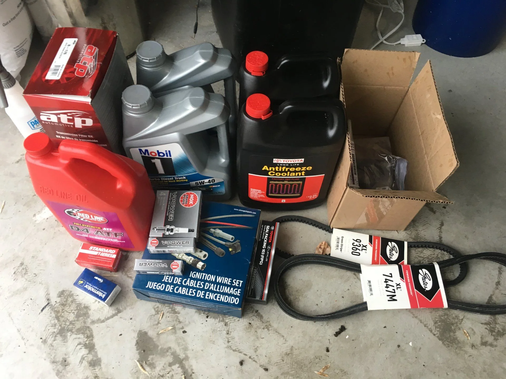

I keep acquiring more parts for my landcruiser! So far I have:
-Gates green stripe hoses to replace OEM hoses
-Baldwin coolant filter base and filter
-Front axle +wheel bearings/seals service kit from Marlin Crawler (I ordered from Marlin because initially I've learned that EcoSeals are great, but later I've learned that they are not so great for AWD, So I've ordered some OEM toyota ones)
-Silicone pesky heater hose kit
-passenger seat motor gears and caps
-Front and rear brembo brake pads and brembo blank rotors, while in there might as well replace parking brake hardware and shoes
-Bosch transmission temp gauge and a "drain plug kit" that I will put in the transmission pan when I replace the filter+fluid.
-Magnafine inline transmission filter.

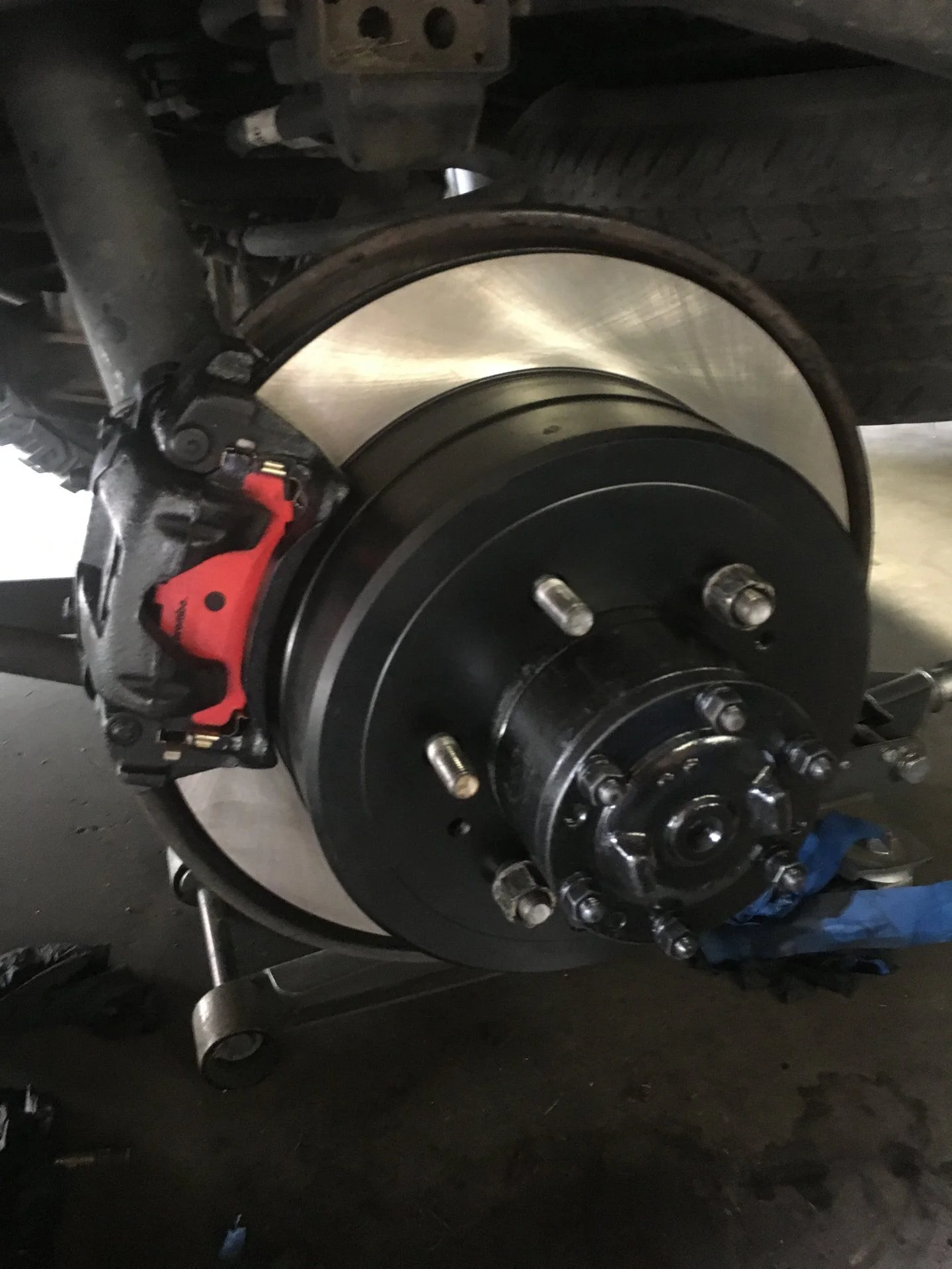

Replaced my rear parking brake shoes, brake pads and rotors. All new hardware and couple coats of paint. Brembo rear brake pads and centric rotors.

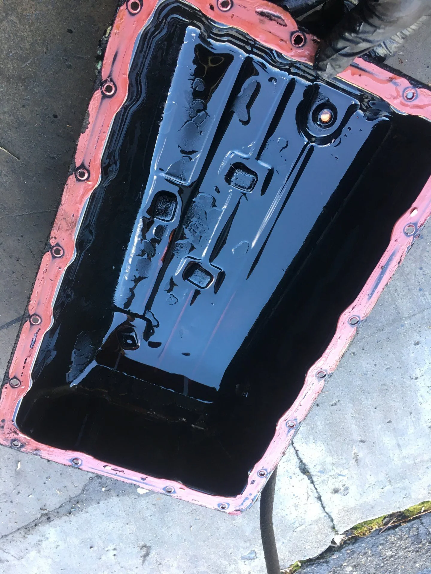

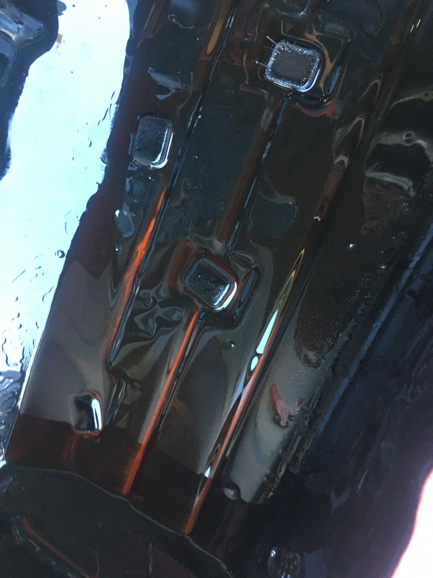

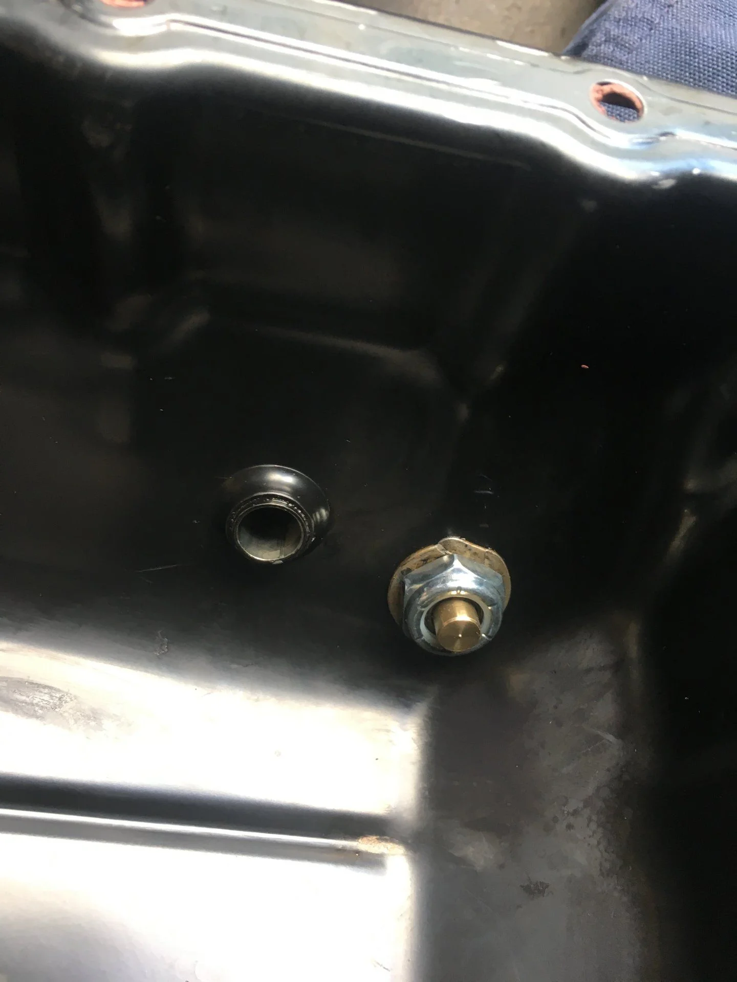

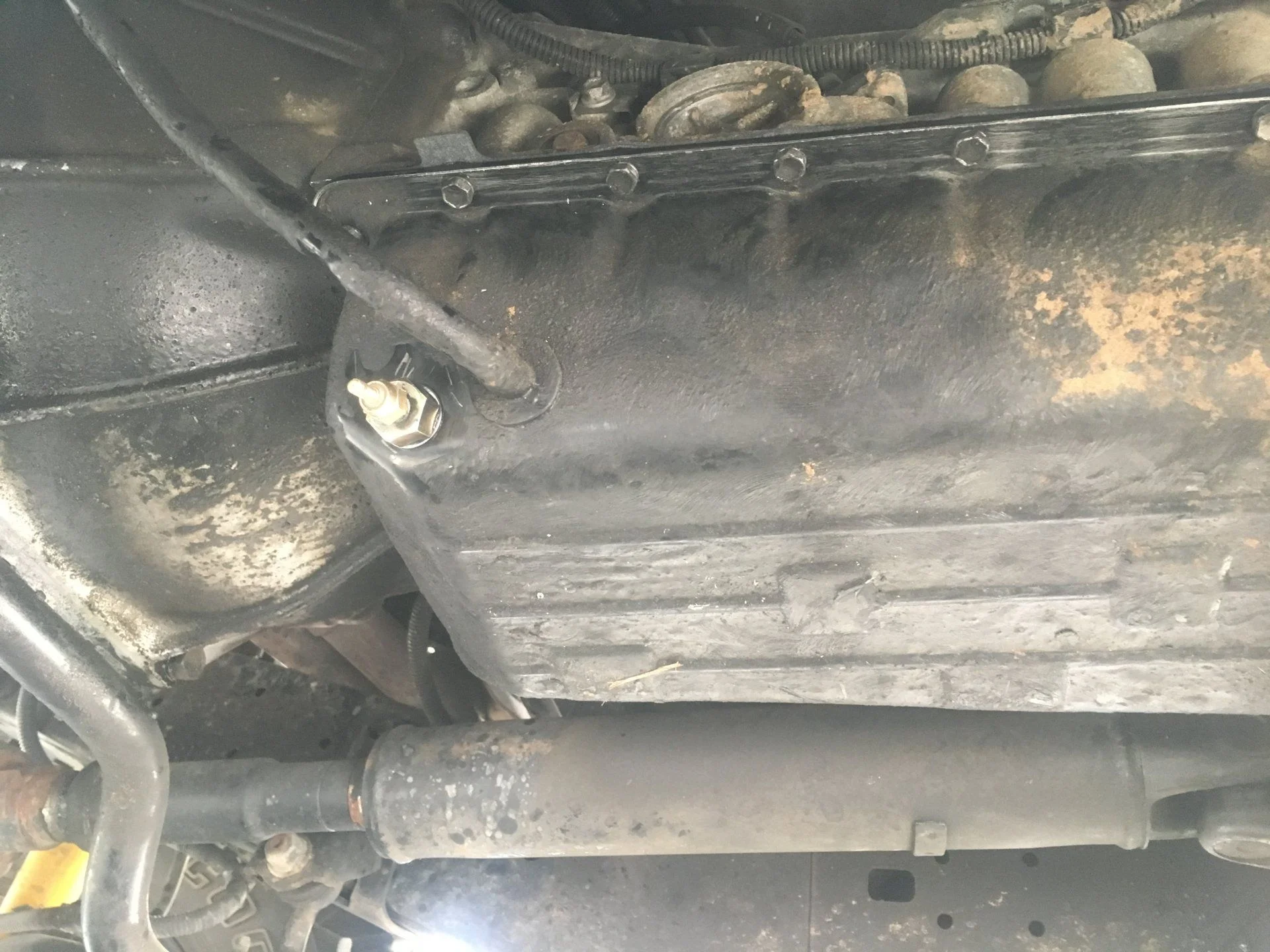

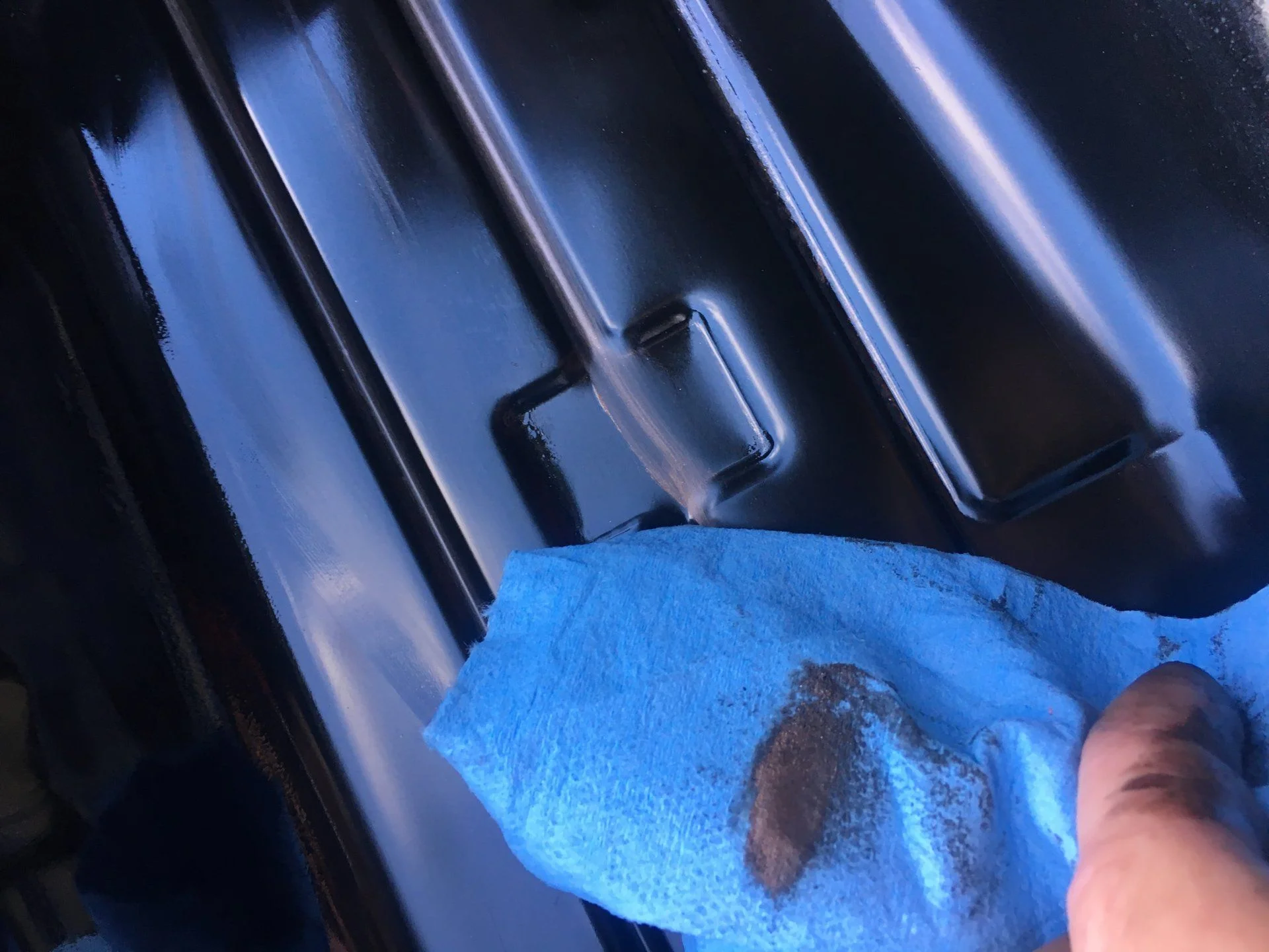

Took my transmission pan off to clean and replace fluid. Unfortunately the ATP kit i was sold had the wrong filter, so i just cleaned off the original filter to the best of my ability. The old fluid was nice and red, maybe a little dark red but still in good condition. I also installed a 1/8NPT bung for my trans temperature sensor (i threw the nylon gasket away and used two washers and toyota FIPG).
The transmission pan had very little shavings for 170k miles but I did see some copper-colored residue - my guess clutch material.
3/29/2019 177000
Installed my transmission temp gauge today. Run the sensor wire thru the rubber gasket on the transmission tunnel, and tapped positive, negative and dimmer lights off the PWR/2nd switch. I’ve used an B&M drain plug kit 80250 but I think you can make use of the thread adaptors included with the Bosch gauge and buy few washers/nuts separately. If I was to do this again that’s the route I would take.

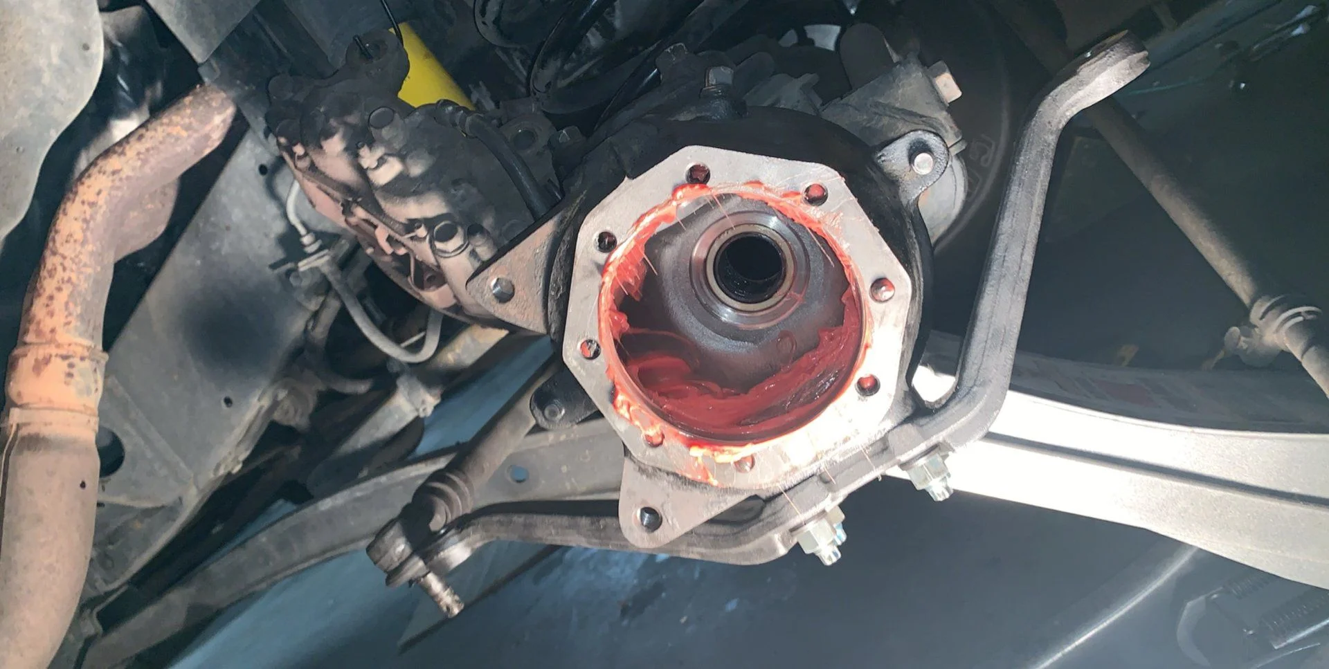

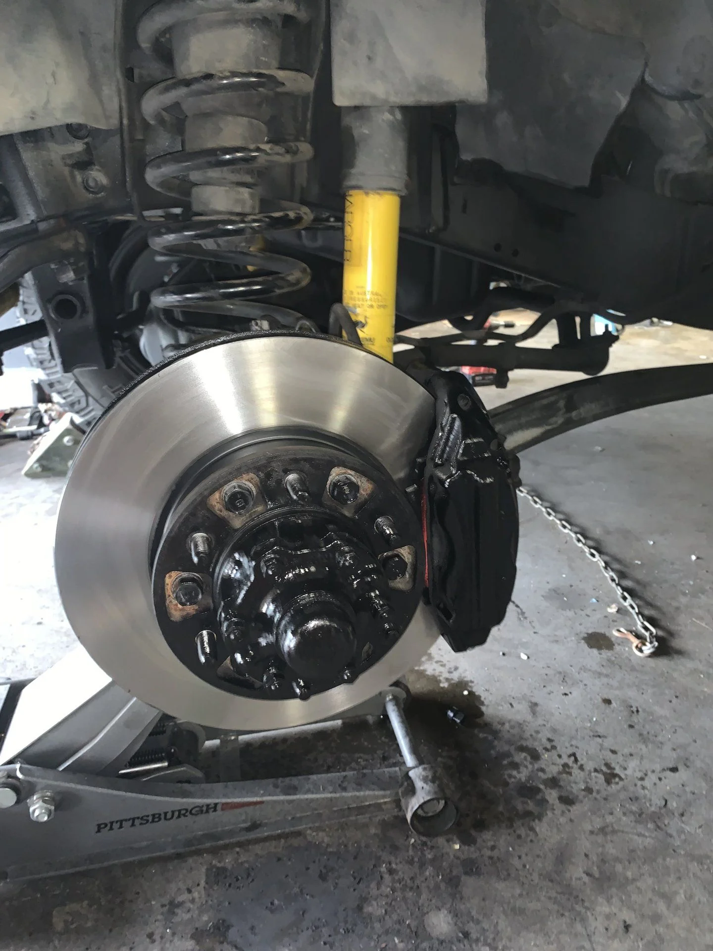

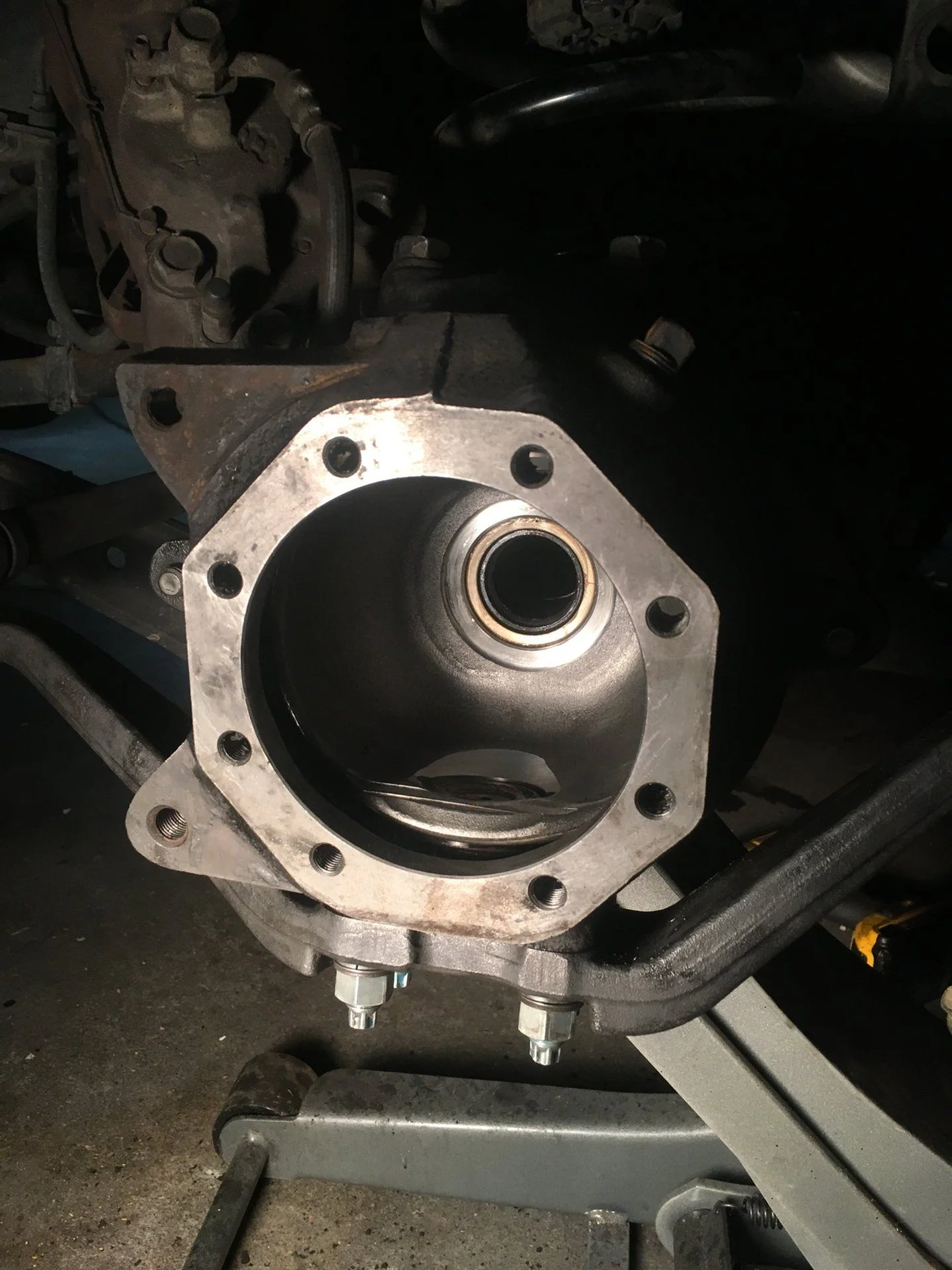

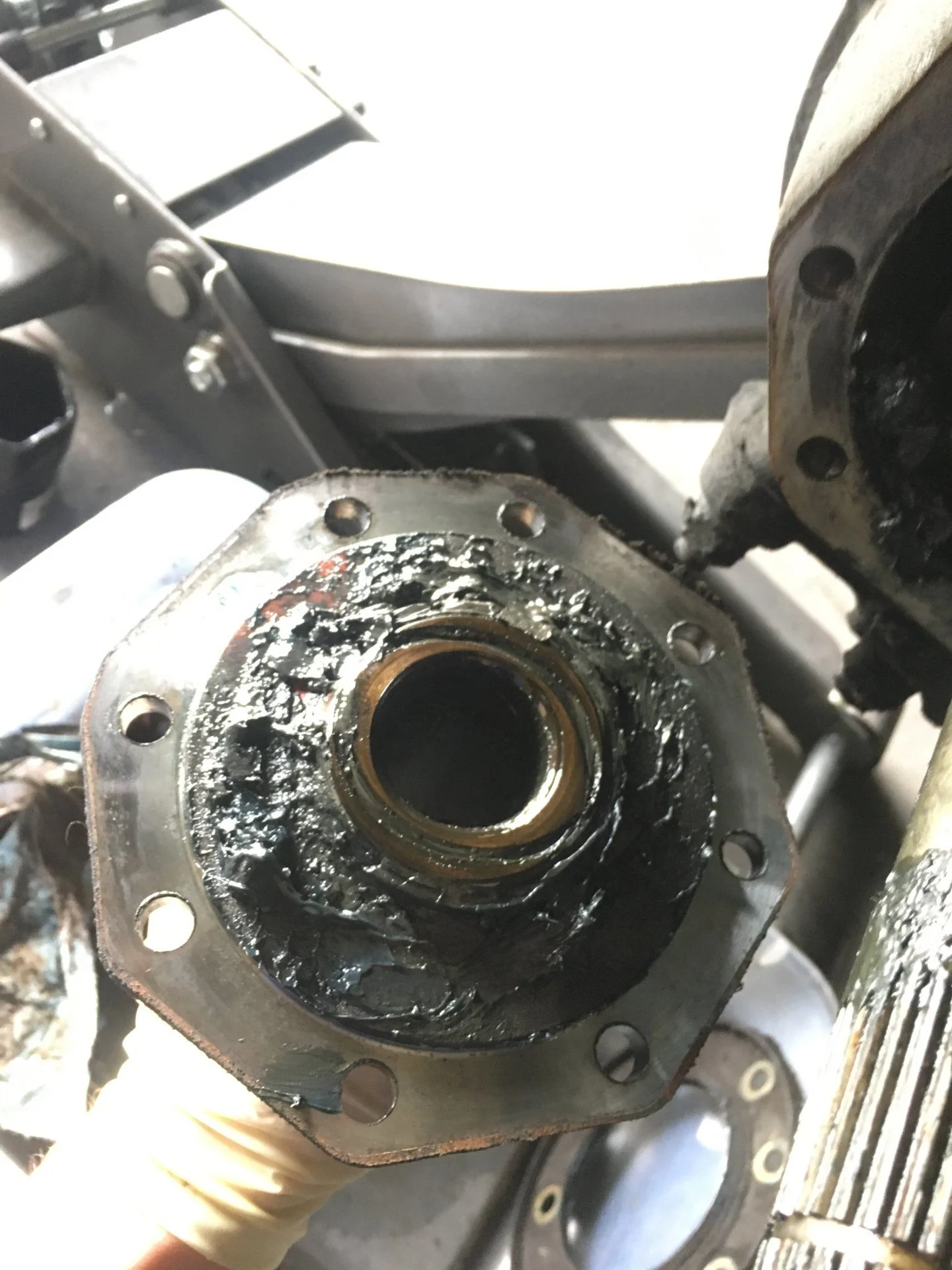

Did front axle service last night...pretty straight forward but took me and my buddy 12 hours lol
Looks like the wheel bearings have been replaced before because it had Timken bearings (when they were used to be made in USA lol). The steering knuckles seemed to be all original expect the grease, the wheel bearings and the knuckles had green-blue wheel bearings grease.
1943170
1943171
The grease in the knuckles was pretty toast, dried up chunks. In addition, my passenger side steering had two broken studs. Luckily, I ordered new studs and hardware along with a recessed axle seal driver from wits end. I've removed the backing plate as well as replaced my rotors with new brembo units and new 100 series brembo pads (which barely fit). Repacked with redline grease and good to go!
1943175
1943176
1943174
One thing that I didn't find any shims installed on my steering arms. Maybe they were taken out before? Regardless after the service the drag felt "right".
4/1/2019 177200 miles
There are no shims in the 97's knuckles, they weren't removed, just never there.

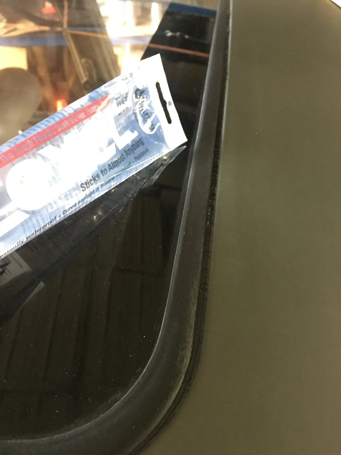

Did you silicone the sun roof so its not functional?
Thank you, I got confused because I thought they supposed to have shims for preload from factory.
Also yes, I’ve cleaned my drains, cleaned the roof and the gasket, conditioned the gasket, inserted spacers to raise the sunroof a little and nothing worked. If I was using the sunroof I would replace the gasket but for some reason all of the cars I owned came with a sunroof and I never use them.
